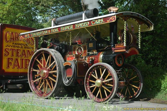

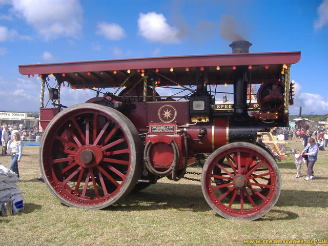

There are two types of Burrell Showmans Scenic Engine which were also built into Road Locos and Agricultural machines. Most were designed with 12 spoke wheels which were also of a smaller diameter and on some engines in my opinion look too small in proportion to the rest of the engine. This is probably as the early scenics were just upgraded showmans with extended boiler/conrods to make room for teh exciter dynamo. The other is the engine based on the Contractors type which was a generally bigger engine and sat much better as a scenic. This was mainly the case with the later engines built when the design had been refined to cope with the extra weight. As a result there are more engines about with 12 spoke wheels but when you see one with 14 and large diameter wheels you know you’ve seen something special as they look the nuts. Shocked
Burrells which were based on the Contractors type Loco have a few major defining changes to the original design thus giving it a better proportioned and powerful presence as a Scenic Showmans or Road Loco. The wheels were made bigger with two more spokes added on the fronts, the conrods were extended from (to scale 14" to 16") and the boiler was of different dimensions which with a 10" boiler would be fine. They all have 20 spokes on the rears.
The trend was also followed by John Fowler when he started making the B6 Superlion. The bigger engine needed bigger wheels. This is clear if you compare the “Iron Maiden” with “Valiant” They are both showmans but one is a smaller engine with smaller wheels. Valiant is a bigger rated engine and thus has bigger wheels.
The pride of the Burrell fleet were the scenic engines and in particular the largest engines in that catagory. They all had 14 spoke wheels.
If you stick with the 18" Front Wheels (to the rim), 14 spokes per Front Wheel, 16" Con Rods and 26" diameter Rear Wheels then you are designing a contractors type loco which is what Charles Burrell ended up using for his Scenics in the end as it was a better proportioned engine for it’s sheer size. Ex Mayor Reg 4000 is a perfect example of this type of design.
Your design so far looks very well proportioned and has the looks of the heavy end of the showmans family which is what you want in a scaled down version.
If you are going to start changing the number of spokes then you will need to make the diameter smaller which in turn will make the proportions look strange so the conrods will need to be shortened etc.
what we are all looking to achieve is producing a model that's going to turn heads and impress those who see it on the rally field and for you hopefully get orders.
Proportions are very important when it comes to scaling as you rightly know and personally I would want a model that is going to look the business.
I only know of one Contractors type Loco in 4" Scale and it looks very impressive and powerful and attracts a great deal of interest.
i’m sure you know exactly what I mean with the Horsby Chain Tractor.
If I had a choice of building an engine that is going to look that little bit different and more impressive in scale then I would choose the 14 spoke contractor type every time. especially in scale.
I was over joyed to see that you were basing the design on the largest Burrell scenic. lets face it if your going to build a monster you might as well build the biggest and best. When I committed to building this model I of course wanted to tell everyone I came across especially at rallies. Those who I know with full size and models have all expressed how nice it will be to see something that breaks away from the many similar engines you see. There are many Single Cylinder models out there, fewer compounds and only a splatter of 4” showmans, But there are only two interpretations of the behemoth which is the scenic showmans based on the contractors type engine that I know of and when they are out they always pull a crowd.
I hope you stick with your design even if it wasn't the trend. that’s what makes it desirable as you don’t come across them and when you do you just stand there in ore and say to yourself “I want one”.....
I'm one of the lucky ones who is....Very Happy

How many Scenics currently exist with the 14 spoke 4' 7" wheel? Very few were built with these but some of the RLs may have been converted to showman's spec.
What names do these engines carry?
Nick's points are well made, if you are gong to do it make it big, (useful to have a longer smokebox than the 4" TE for cooking purposes) but it would be nice to know some examples to have a look at.

There are definitely more with 12 than 14 spokes however in 4" scale the larger wheels make a big difference in how the engine looks and sits and having consulted engine owners and makers they hold the same opinion. If your going to build one they say, build one big.
You look down on a 4" model and with such a big engine plus the canopy as well the front end can look understated and sometimes strangly small depending on colour choice if your not very careful. The spokes can llo to far apart for the amount of metal that is hanging above them which is excentuated due to the scale.
The 14 spoke larger front wheels help this perspective massively balancing it all out.
You get a much better overall look with the bigger front end.

The only two extant Scenic Showmans with fourteen spoke, large front wheels. that I have been able to find are 'Ex Mayor' (http://www.steamscenes.org.uk/?pc=/engines/burrell/showmans-road-locomotive/4000/) and 'Edward VII', at Thursford (http://www.steamscenes.org.uk/?pc=/engines/burrell/showmans-road-locomotive/2780/)
'Edward VII' is quite a useful engine as a miniature, in that it does not have a rear crane to hinder footplate access. It was built in 1905 and so converted to 'scenic' form, probably by extending the smokebox. The exciter platform is of the earlier pattern in that it does not have a horizontal joint with bolts to allow easier removal to access the cylinder covers. It may have the longer connecting rods.
'Ex Mayor' is a bit of an odd ball because it only has single gear drive. Both engines have 7' rear wheels.
There were 43 Scenic Showmans made either new or converted: no two engines were ever alike...

Having read Michael Lane's 1971 book on Burrell Showmans RLs the SRL(S) that fits the current spec is 'John Bull' (2796) with double gear drive, built in 1906 and converted by extending its smokebox in 1920, along with an added rear crane.  This engine had a copper cap to it's original extra long extension chimney! John Bull was a popular name for a SRLs - there are several in the lists. I think the rear crane is a total liability and should only be put on cosmetically (as an option) as it totally gets in the way of driving.
Ex-Mayor (4000)  had rear wheels that were 18" wide as compared to the more normal 22" this is why the engine looks tall and I think not as  powerfully impressive as some others.
Other conversions were probably small wheeled.  All of the new builds (excepting 4000) had small front wheels & 6'6" rear wheels.
The large wheeled RLs probably started with single drive with later ones double.  I think there are some examples of later build RLs with the big wheels in the listings in Michael Lane's 'Burrell Style'.
Certainly seems that the good compromise is one of the converted SRL(S)s with a long smoke box and the RL with a short.  Having stood next to Ephraim, White Rose of York & Gladiator this w/e there is no doubt
that the bigger wheels are much more impressive.
The later build General Gough (3888) does have large front wheels with a lot of daylight between the spokes.  This would pretty well be your original design with 6'6" rear wheels.  The engine fell in to a cellar up to its
