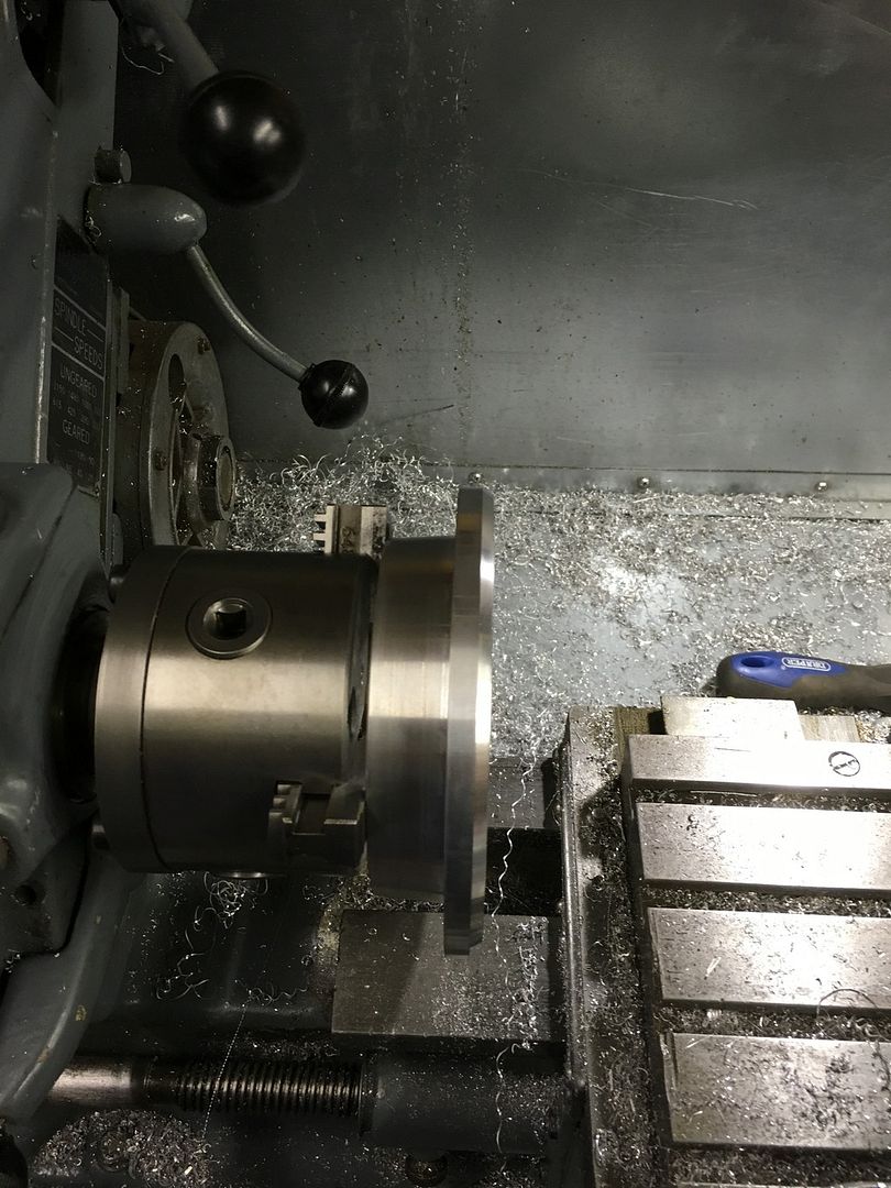

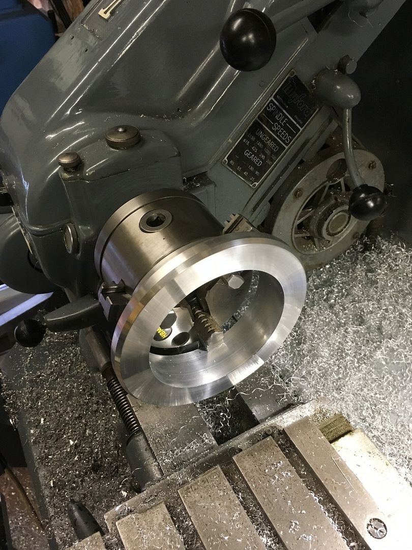

With Dad busy fettling and fitting the gears I decided to make a start on the extension chimney.
I purchased a long length of aluminium pipe of good old eBay and today I set about making a tapered collar to fit the pipe and sit inside the chimney.
What sort of length have you made your extension chimneys?????
Here are some photos of the tapered collar I made today

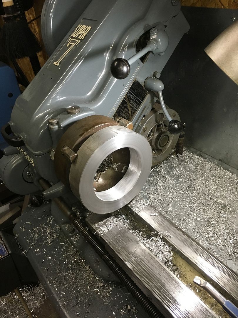

Post  Willsy on Sun 07 Feb 2016, 7:31 pm
Continued work on the extension chimney today

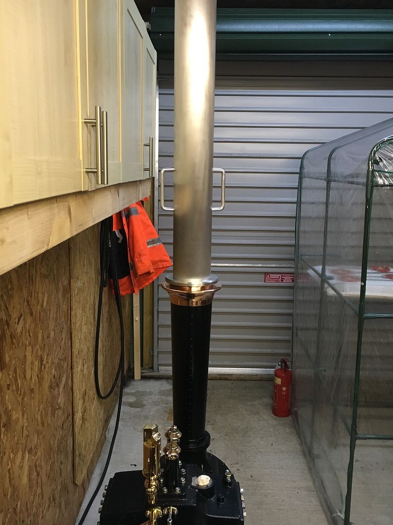

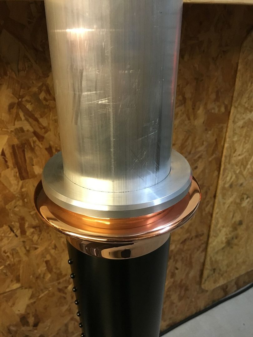

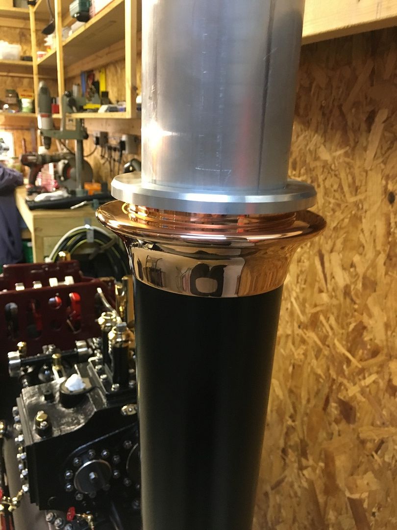

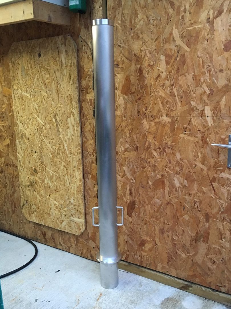

One finished lighting up extension chimney!
Post  Willsy on Sat 20 Feb 2016, 9:57 pm
We have put the finishing touches to the extension chimney today' this is the the finished article,

Post  Tim Watson on Sun 21 Feb 2016, 1:07 am
With that height Jon, you'll need permission from air traffic control at Newquay. Will the engine be at Bocconnoc?
Re: Lighting up extension chimney
Post  Willsy on Sun 21 Feb 2016, 8:00 am
It's only 4' 6" tall tim!
