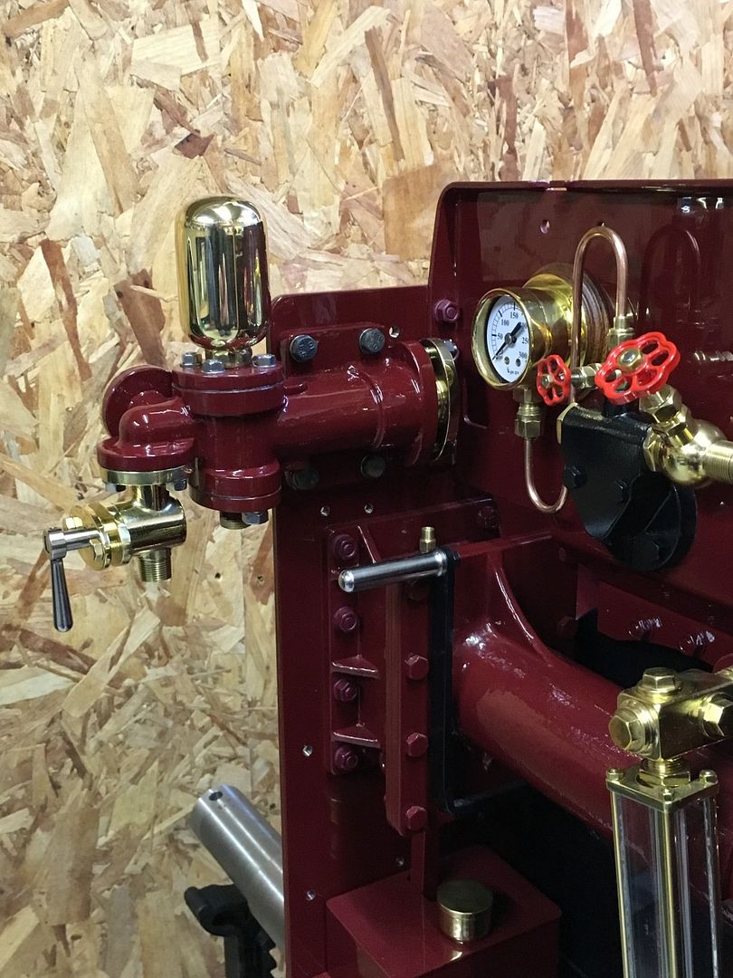

Post  Willsy on Fri 22 Jan 2016, 7:39 am
Hi all I've been trying to get to grips posting photos from my IPad, hopefully it works this time!

Post  Tony King on Fri 22 Jan 2016, 9:26 am
WOW, stunning piece of work there...keep the pictures coming!..... Great to see another engine coming to life. That magnificent paintwork is worthy of a Showman's Engine Twisted Evil

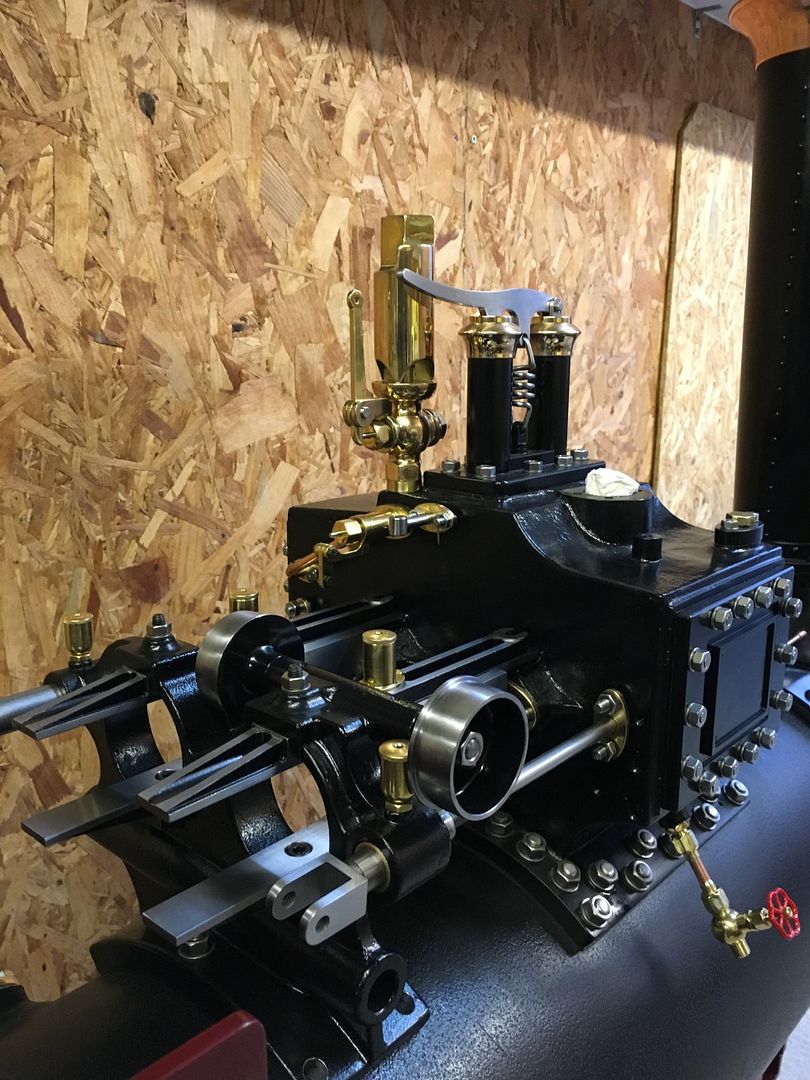

Post  Tim Watson on Sun 24 Jan 2016, 9:56 am
A very beautiful build. I like the plain nuts on the covers. Interesting to see that you have put an accumulator on the pump.  I haven't found that the pump knocks on the DCC, but did fit one to my previous engine, an agricultural.
What lining will the engine carry?
Re: Our build so far
Post  Willsy on Sun 24 Jan 2016, 5:17 pm
Thanks Tim,
We decided to put the brass vessel on the pump as we had one on our previous engine, I always thought it looked nice and I love cleaning brass 😀
Does the pump work ok with out any bleed screws?

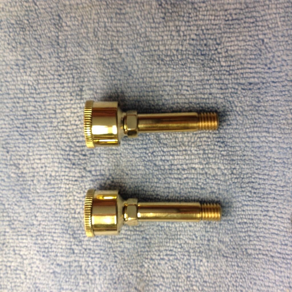

Today's efforts
Post  Willsy on Sun 24 Jan 2016, 6:36 pm
Having read on here that the oilers for the wheels throw out a lot of oil we have decided to use greasers,
We have made these for the front wheels'

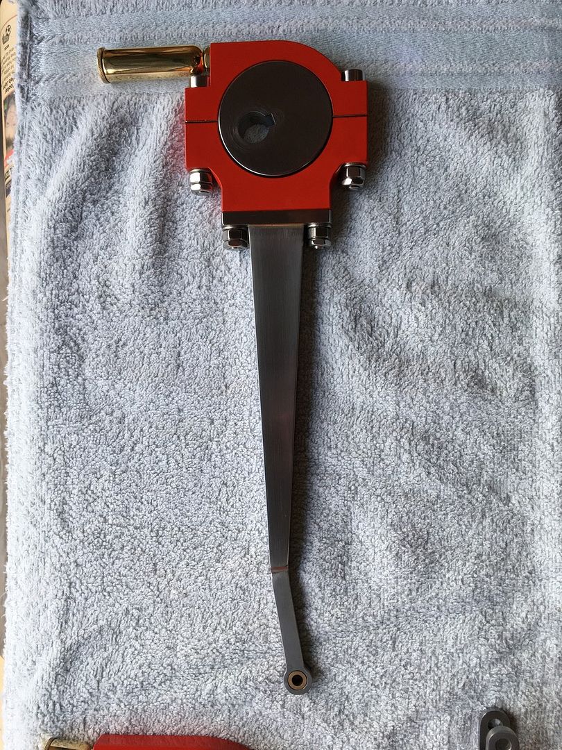

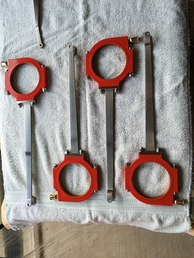

Post  Willsy on Mon 15 Feb 2016, 10:27 pm
Eccentrics have been finished off over the weekend. I must give credit to STW on there machining  they only needed a little lapping in.
The pump eccentric on the other hand was very tight and needed a lot of lapping in.
Dad decided to gap the eccentrics with shims for running in, these can then be taken out when we have used the engine for a season.

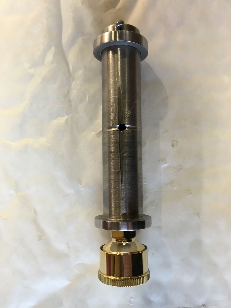

Front axel pin
Post  Willsy on Mon 15 Feb 2016, 10:31 pm
Another little extra we decided to do was to put a greaser on the front axel pin,
