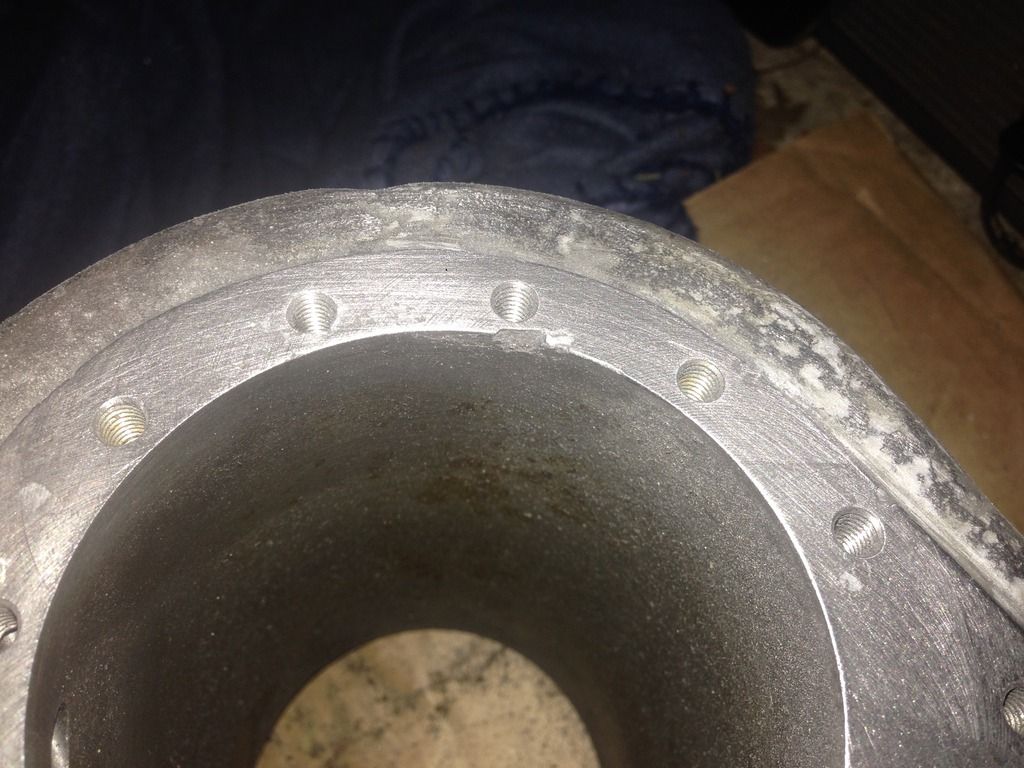

Post  storey on Wed 16 Sep 2015, 6:40 pm
So I was cleaning up my block today prior to painting and I saw this:
Is that going to be ok ? Or will that cause me problems ?
storey
Number of posts : 46
Re: Cylinder block
Post  gwr1475 on Thu 17 Sep 2015, 3:37 am
I would not worry about it, the gasket will still seal the joint.
