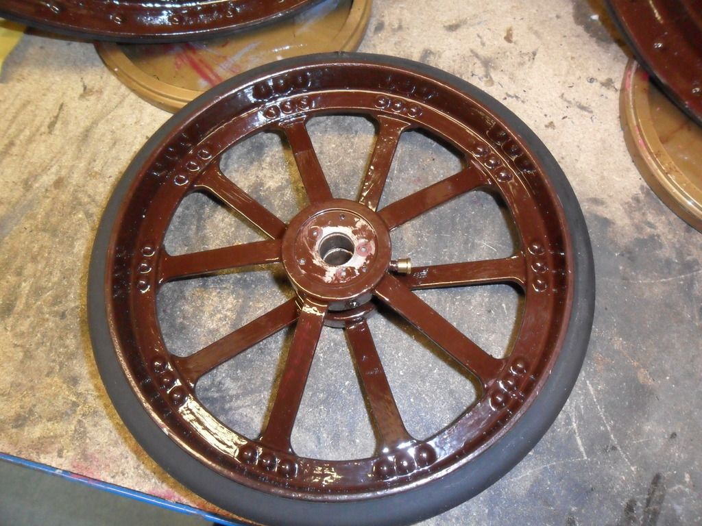

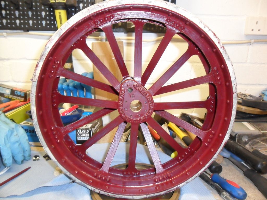

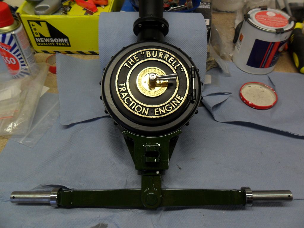

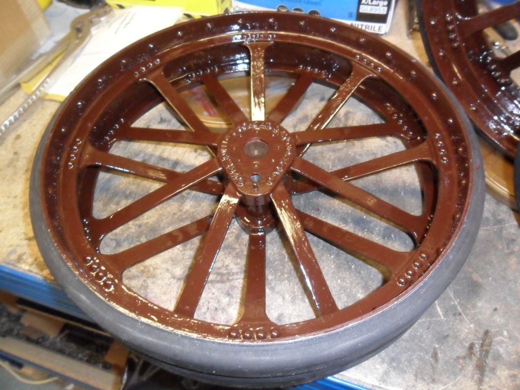

Hi all, a update of my progress. Second wheel finished, types on and drying. Got primer and one coat of undercoat on first rear wheel. A couple pics taken.
[img:fce9]http://i172.photobucket.com/albums/w10[URL=http://s172.photobucket.com/user/chas12154/media/SAM_0655_zps5ntdzdvq.jpg.html]/chas12154/SAM_0656_zpsg1gb0kem.jpg[/img:fce9][/URL]

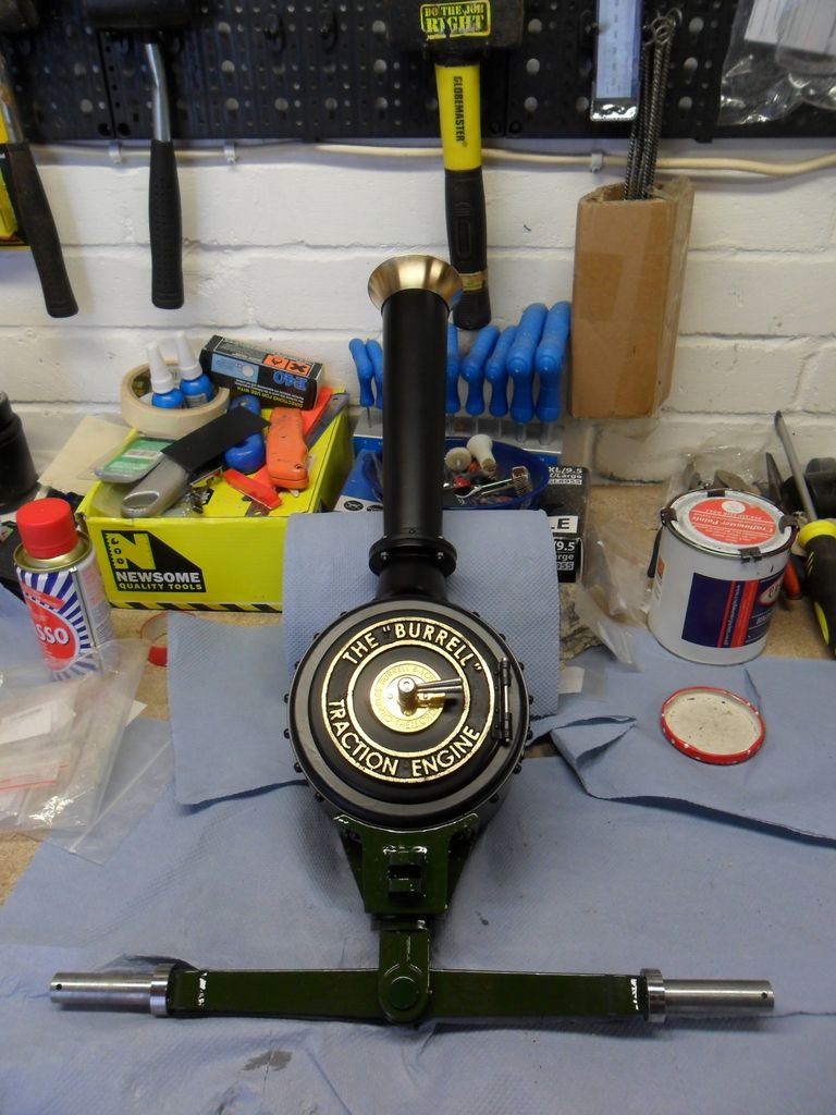

Have also varnished the front axle and perch bracket and assembled it, think its looking good so far:D
Couple of pick, see what you think!
Now a lot more painting to do, all the wheels to complete.

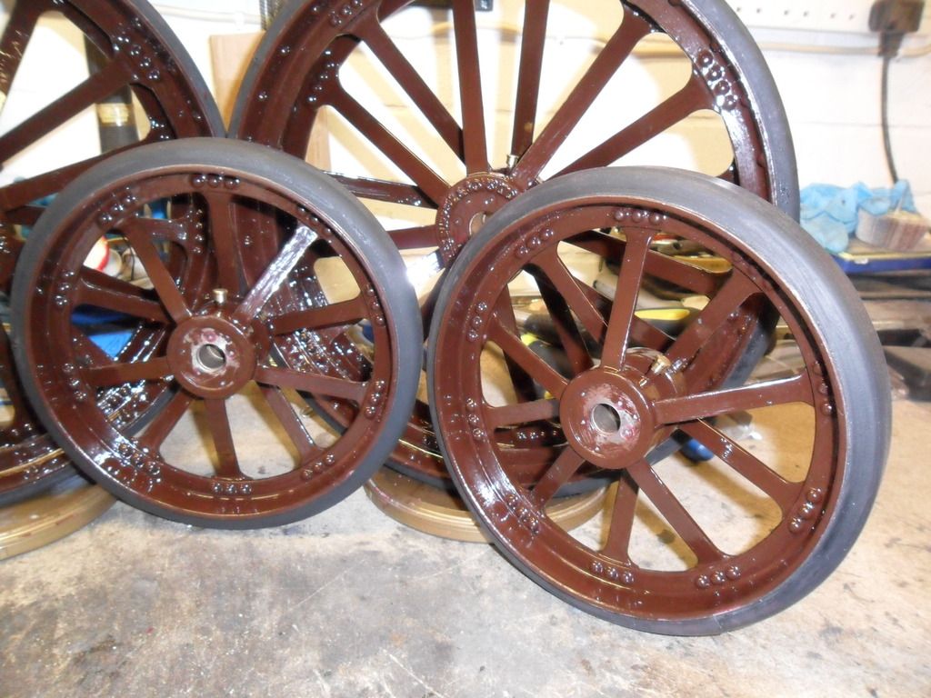

I've finished painting all the wheels, with top coat. They look good, well to me they do:)
Haven't decided whether to line them or not. Will pack them away, till a later date, when I've had a bit of practice lining.
Will take some pics of wheels before I pack them away and post them on here shortly, probably at the weekend, when paint has harden.

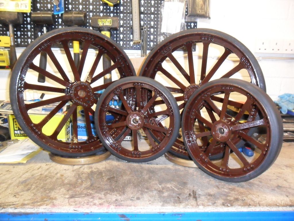

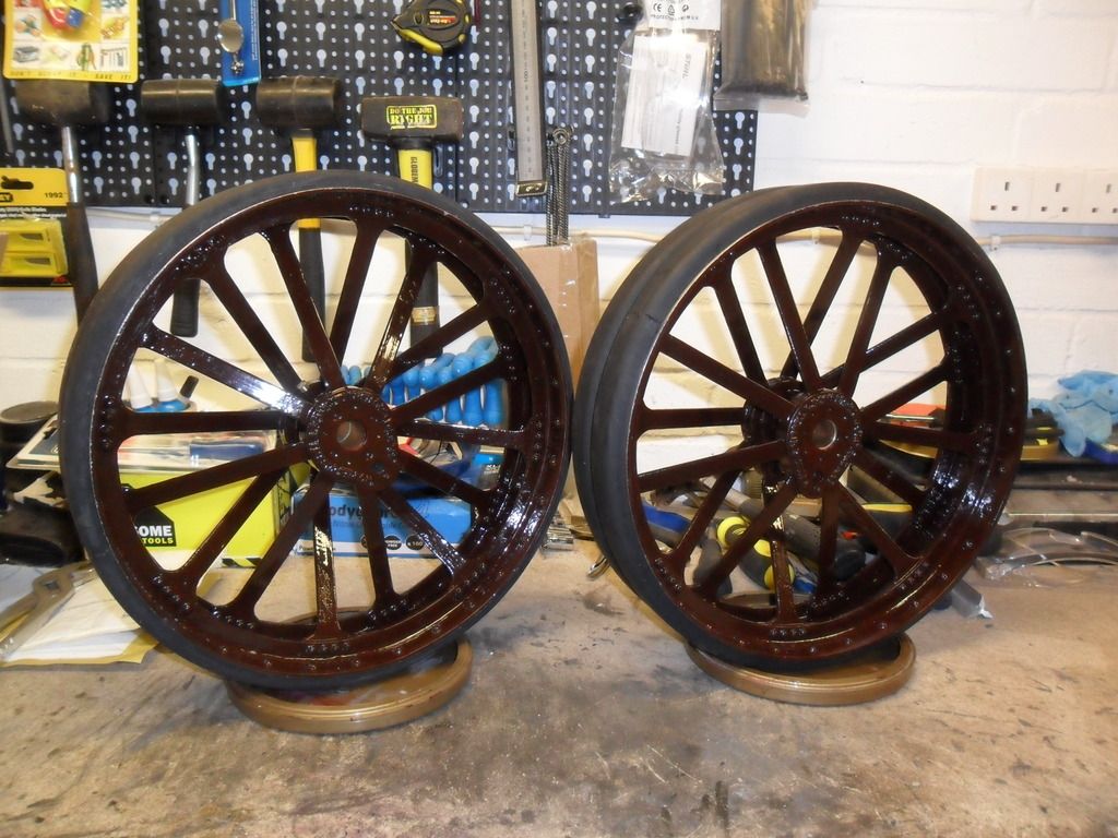

Post  chas12154 on Sun 01 Nov 2015, 6:26 pm
Evening all, few more pictures of my progress. All four wheels now in top coat.
Hope all pictures have loaded.
Its hard to get pictures to show real colour of wheels, they are Burrell Chocolate.
Now just started Kit 7
Will post more pictures in a few days

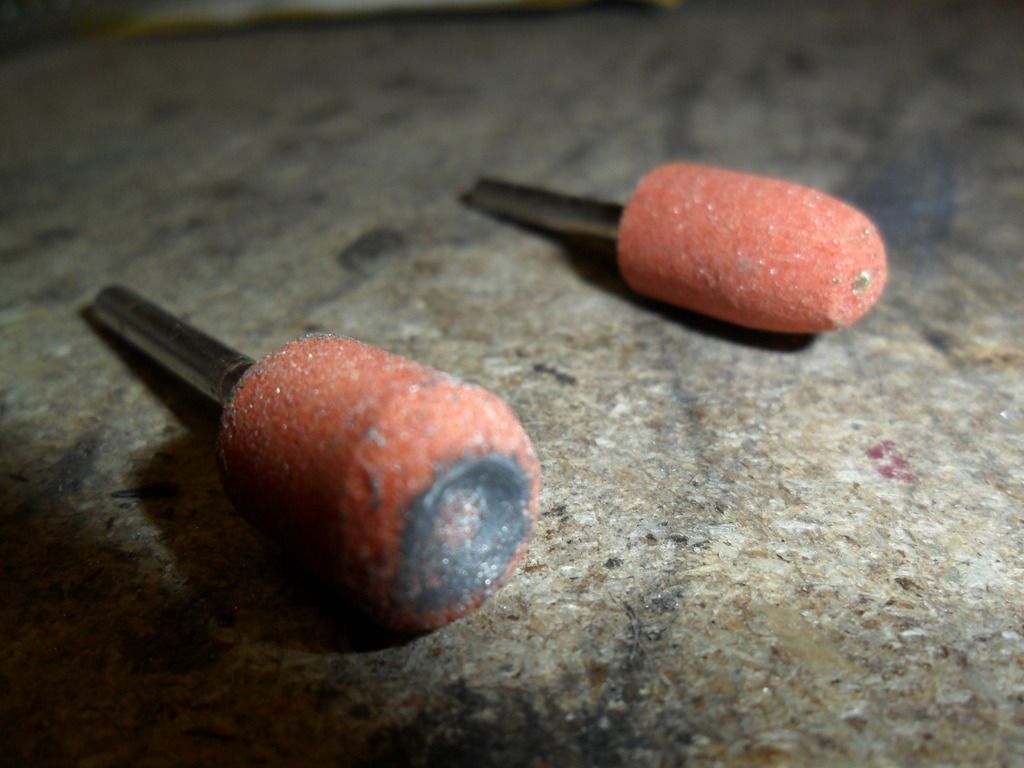

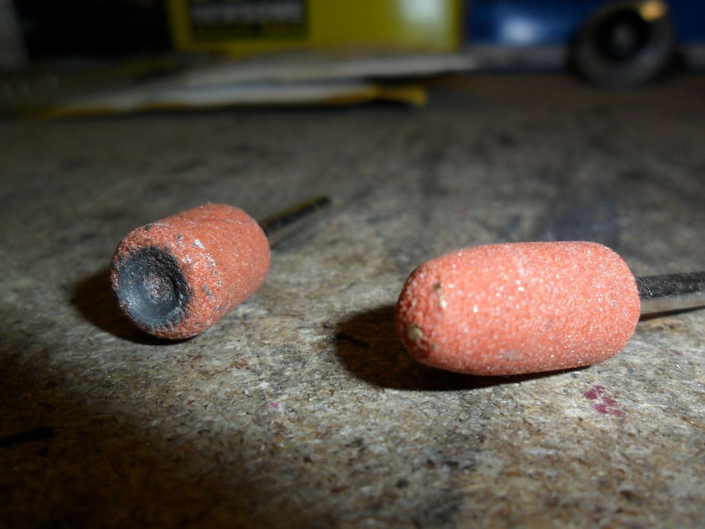

Hi. Just going threw your pictures, looking great. How did you get the wheel nuts to look like rivets. Just interested. Thanks kev.

Post  chas12154 on Mon 02 Nov 2015, 7:09 am
Hi Kev I used a small sandstone grinding attachment on my mini drill. I will put pic of it on here if I can locate it: lol!: lol!
Did take a bit of time, but think it was worth it to get the end result.
I have brush painted the wheels and still undecided if I will line them.

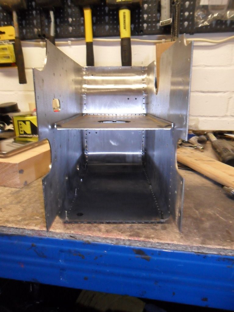

Post  chas12154 on Tue 03 Nov 2015, 7:40 pm
Hi Kev, found a couple of the stones I used, here are a few pics
Here are a few pics of the tender I have so far done
Thats all for now

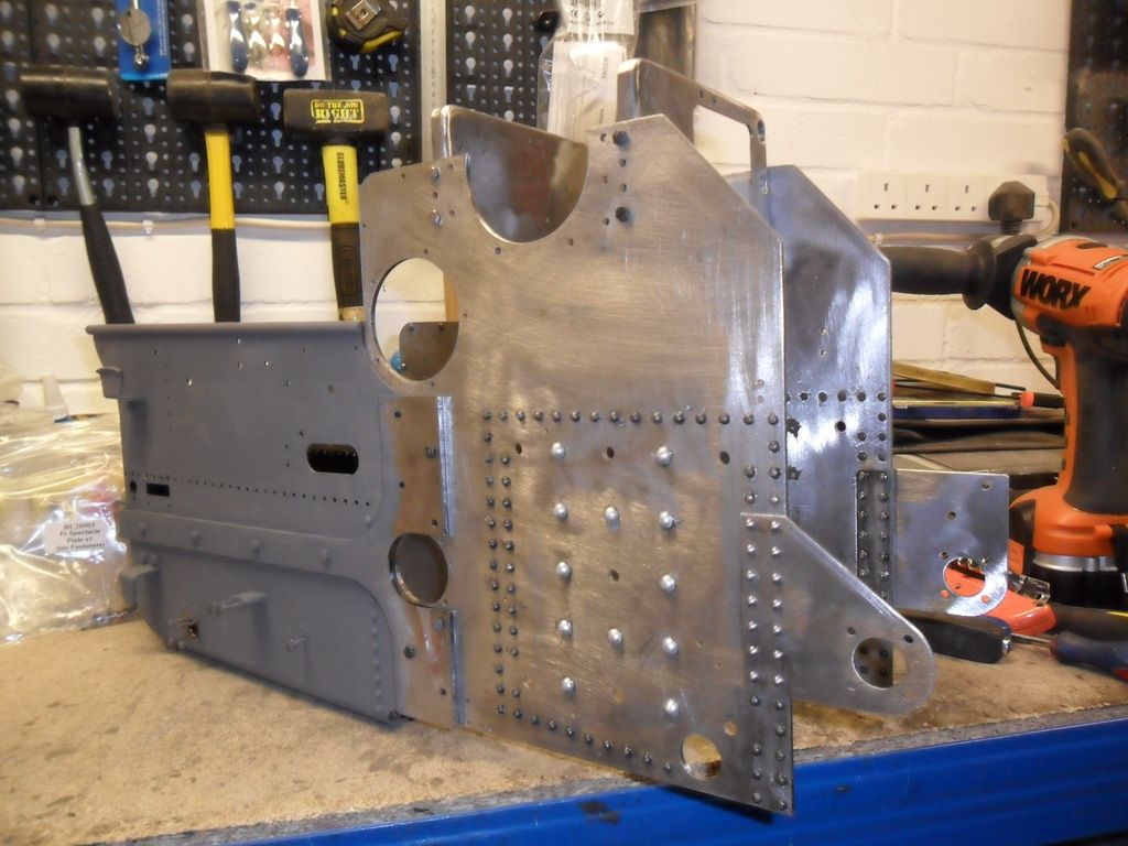

Hi all, the tender is a very fiddly kit Very Happy All those tiny rivet bolts to put in!!
Got most in now, went to fit the tow straps, too short! Rang STW, they sent me new set, came yesterday, bugger me, they are the same length as the ones I had.
I am right in thinking, the tow brackets do fit against tender first and then the tow straps fit over them, as in drawing?
If anyone can help, I would like to hear from you.
Charlie

Post  Mike King on Fri 13 Nov 2015, 12:12 pm
Hi Charlie,
                   Yes the tow bar fits onto the tender, with the tow straps on top. I had the same problem, the replacements were slightly longer, but not enough. I ended up thinning the tow bar slightly on each end. That worked. I suppose it depends how short yours are. I found that if i fitted the original straps to the tender, they were a perfect fit to go under the tow bar, but not correct.😤

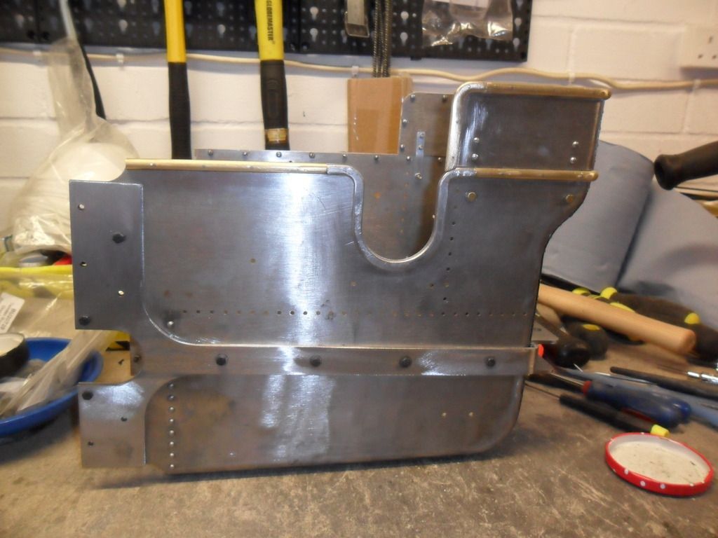

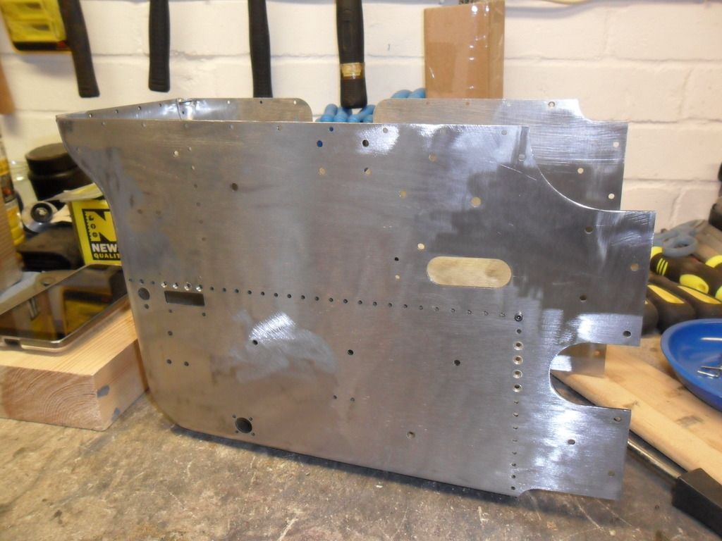

My Burrell new build
Post  chas12154 on Sun 22 Nov 2015, 4:56 pm
Hi all, just an update on my build.
Got a new set of tow straps from STW, but had the same problem with them. Couldn't get tow brackets behind the strap.
Rang STW again and spoke to Ian. He suggested that I returned the strap, along with my tender, so they could sort problem at the factory.
Sent tender etc back on a Friday, had tender back, the following Tuesday. Straps fitted and enough room to get tow brackets behind straps.
Now fitted, all bolts in place, really looking good.
Iv'e now fitted beading around the tender and filed off slotted rivet screws and shaped the "u" shaped beading to blend in with the brass beading.
Coal bunker extension to back of tender on too.
Now waiting for next kit with rest of fittings for tender before I will isoflex the tender.
Will post some photos tomorrow of tender.
Charlie

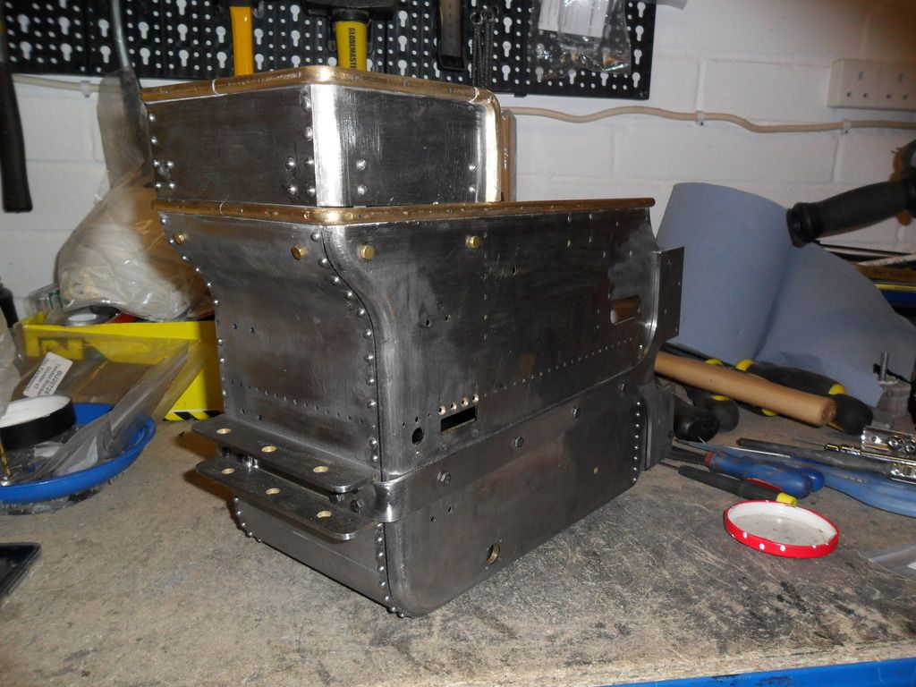

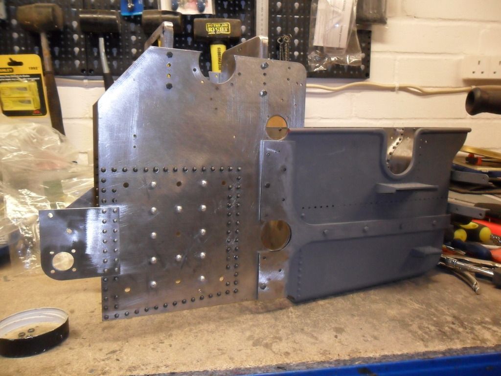

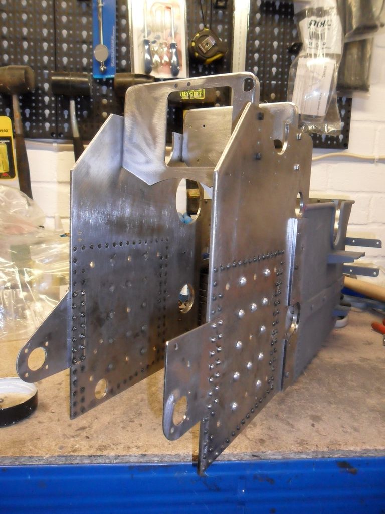

Post  chas12154 on Mon 23 Nov 2015, 6:32 pm
Here are some more photos of tender so far
Had text from STW, next kit8, being delivered tomorrow.
All for now.
Charlie

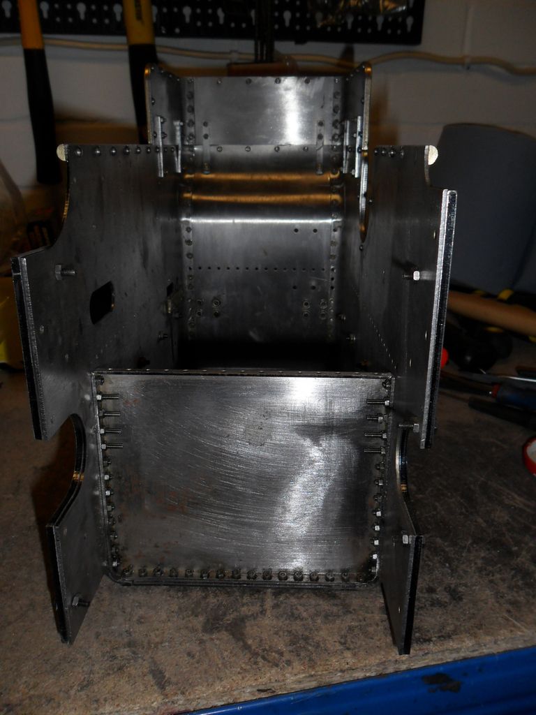

Post  chas12154 on Wed 02 Dec 2015, 3:42 pm
Afternoon everyone, got a question, that I hope one of you can answer.
On the right hand side of the tender, near the front of water tank, there is a threaded hole.
I can't workout what it is for, can anyone in-lighting me, to what it is for?

Post  Steve H on Wed 02 Dec 2015, 4:32 pm
Can't remember what it's for but sure it said something in the build instructions.
Steve H Very Happy
Number of posts : 179
Re: My Burrell new build
Post  Mike King on Wed 02 Dec 2015, 4:35 pm
Hi Chas,
              I am pretty sure that the one your are referring to is for a gear guard, to be fitted on a later kit. I have screwed a bolt in mine for now to protect the threads from paint etc.

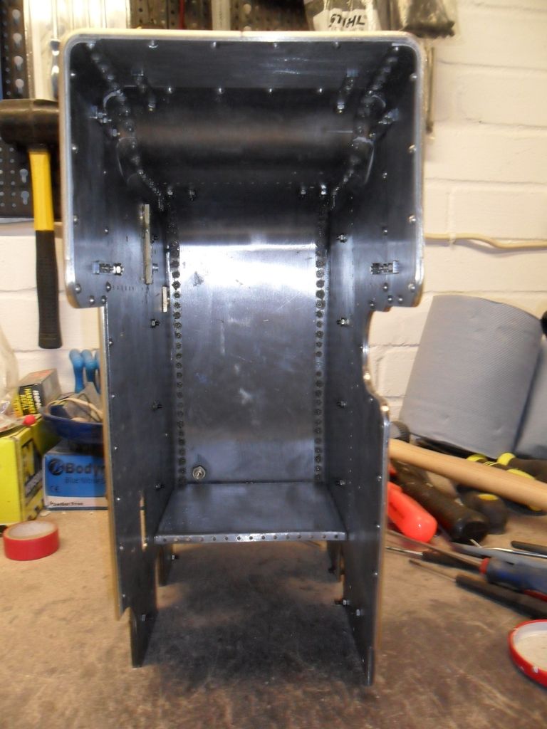

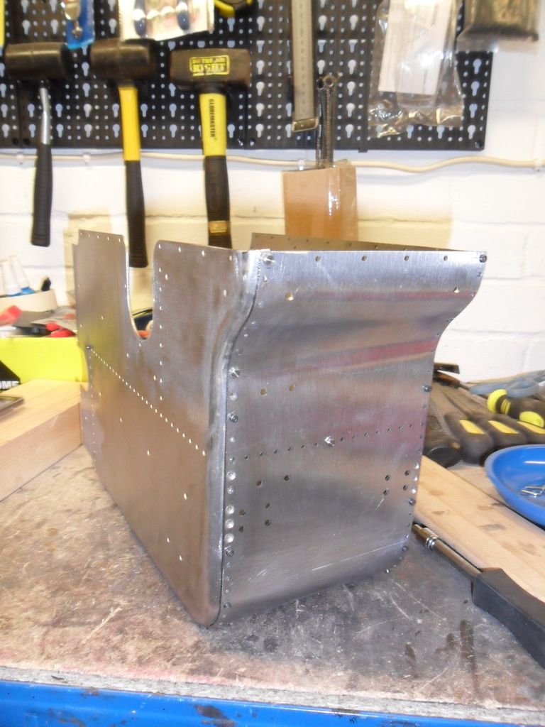

Post  chas12154 on Fri 01 Jan 2016, 5:11 pm
HAPPY NEW YEAR to you all.
Just a update on my progress over xmas.
Kit 9 arrived on the 17th Dec, have just finished and now ready for painting.
Took a couple of photos with hornplates attached to tender.
Thats all for now,
Charlie
