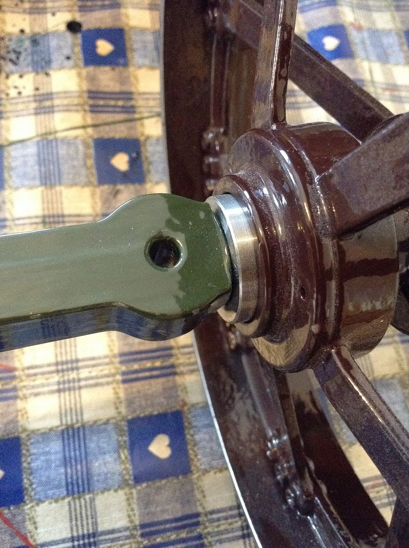

Axle Collars
Post  Pitpup on Sat 11 Apr 2015, 2:35 pm
Hi all...kit 2 has arrived. One quick question....the axle collars BU20202-2 they seem to have a curve on one side and not on the other. ....does this curve face in over or out over when placed onto the axle ?. The instructions don't give guidance on this. They seem to fit well when placed with the curve in over. Help please !!!.
Pitpup
Number of posts : 108
Location : Cleveland
Registration date : 2015-02-28
Re: My Burrell Build.
Post  Mike King on Sat 11 Apr 2015, 2:58 pm
I found that mine fitted flush with the curved side against the axle. If you fit them temporary, you will find that if you fit them the wrong way around, they will shorten the axle stub, and you will not get the retaining collar for the wheels on far enough to get the retaining pins through. Either way, it would pay to test fit the wherls etc with the retaining collars and pins.
Mike King
Number of posts : 309
Age : 70
Location : Hereford
Post  Crazy_jim on Sat 11 Apr 2015, 6:13 pm
These are my collars fitted and the pins dropped in with no hassle. Hope this helps. Apologies for the dusty axle and fronts they have been sat redundant for a while.
