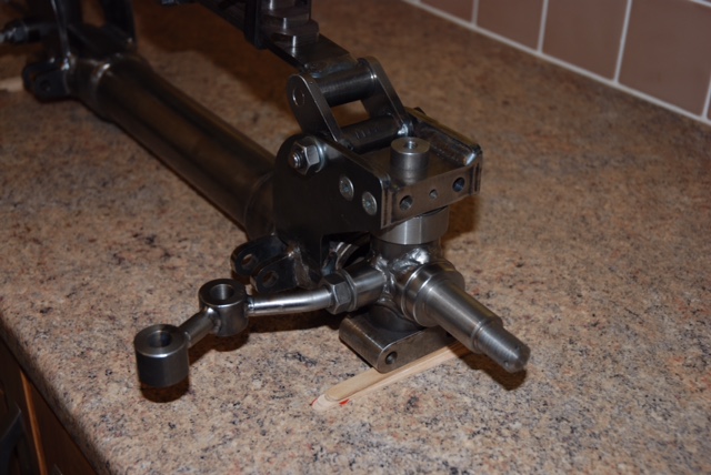

And started on the front axle stubs:

The front axle dry fitted (after a bit of fiddling).
And the last two are the axle stubs - Right and left.
The next job is to paint the above.

Just one picture this time of the front axle stubs.
