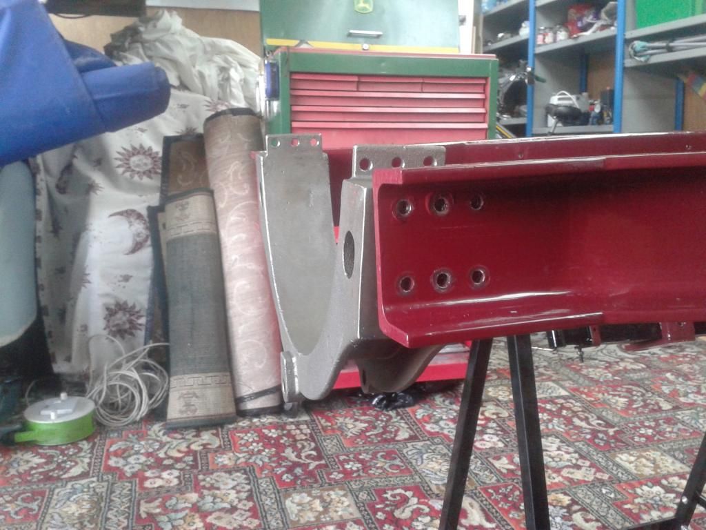

Hi Phil i had a similar problem with my cradle, upon removing it and lieing it on the bench turned out my cradle was twisted, might be worth taking a look at that
Here's some pictures i took to show Steve of how my first one looked

Post  phil gomez on Tue 16 Dec 2014, 5:28 pm
Hi Russ.
Thanks for posting your pictures which is always very helpful.
Chassis up-date.
The chassis channel and boiler cradle are being returned to STW for investigation (manufacturing issues).
