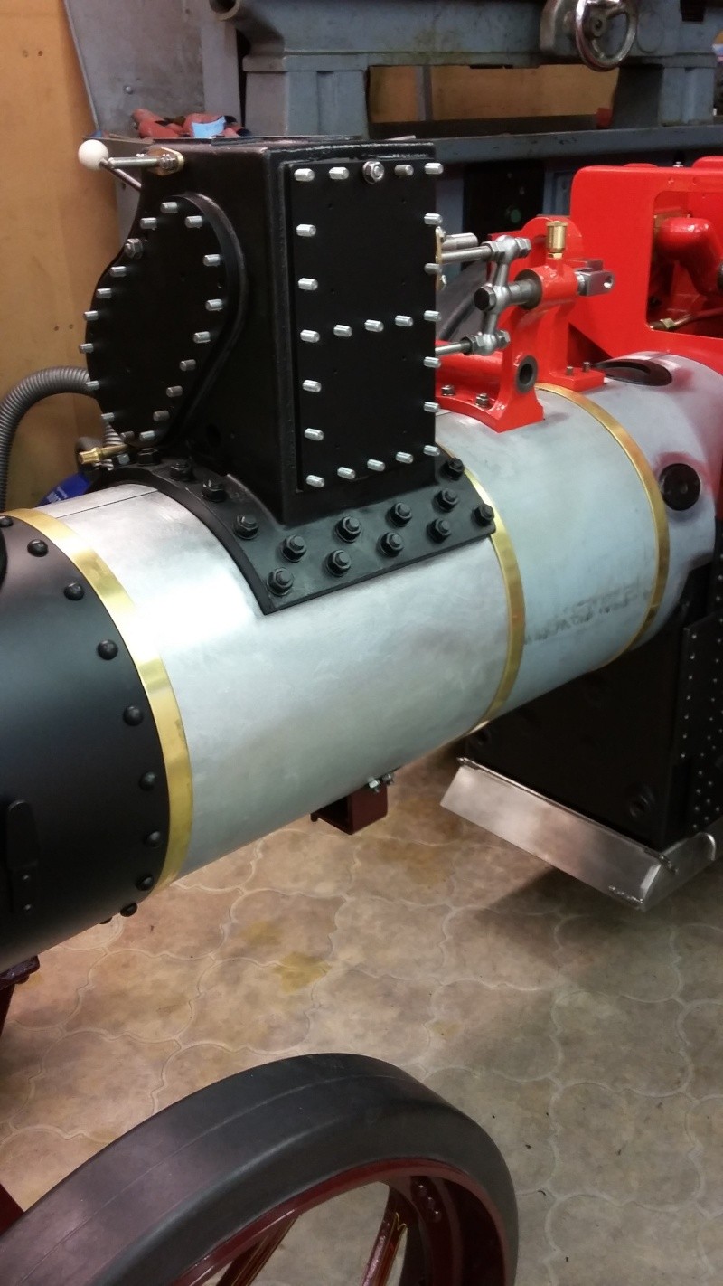

Post  TimV on Wed 30 Mar 2016, 6:15 pm
Fitting the cladding
Cladding painted & lined
Steering & ashpan fitted

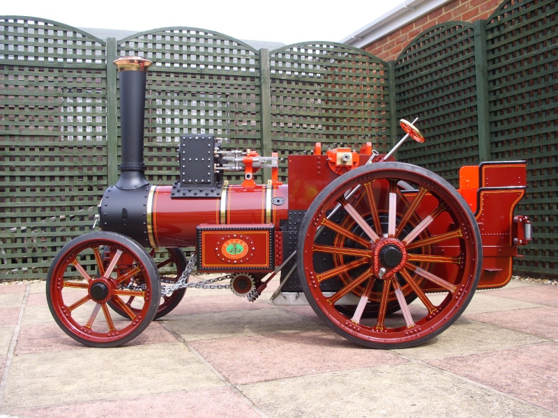

Post  TimV on Thu 10 Nov 2016, 6:25 pm
It's been a while since I put any pictures on but I have made some progress. So here are some pictorial updates. By the way don't get on the phone to STW asking where's my seat as I've decided to make my own!

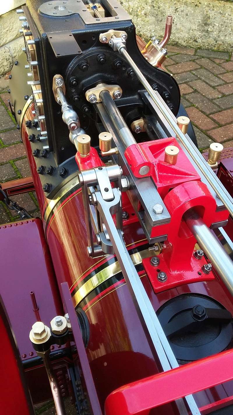

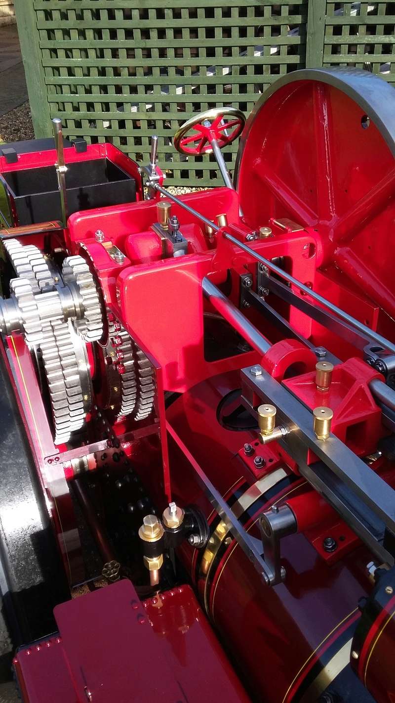

Some more pictures of 'Valiant'
Post  TimV on Tue 27 Dec 2016, 2:23 pm
I have moved oilers for the 2nd and rear axle shafts up to the top for ease of access.

I think the finish you have achieved on the bright metal work ( eccentric rods, slide bars) is spot on. What was the method you used to achieve that finish and do you have any advise for other builders?
Congratulations on a fantastic build
gwr1475
Number of posts : 60
Location : canada
Registration date : 2012-11-18
Re: Making a start on my Burrell SCC......
Post  TimV on Tue 27 Dec 2016, 10:17 pm
Many thanks to both Marks for your compliments, should not be long before I can run her on air, have done nothing special on polishing the bright work etc.. just lots of elbow grease, very fine wet and dry, metal polish !!
Post  TimV on Wed 28 Dec 2016, 8:17 am
Hi Mark, I didn't use a flap wheel on the eccentric rods instead I used a large flat file using varying grades of emery cloth wrapped round it drawing backwards and forwards all the time keeping it square with the rod until all machining marks had been removed, as for the guide bars I just gave them a light clean up as I didn't want to remove too much material on those, hope this answers you question.
Post  Alan Grant on Wed 28 Dec 2016, 10:40 pm
Looking great! Did you have any issues fitting your gear change bracket? With mine flush up against the hornplates nothing appears to line up, the axle won't fit through the bracket and yokes. In order to get everything lined up I need to add in a washer between the bracket and the hornplate on the rear bolt, even then it is still very tight.
