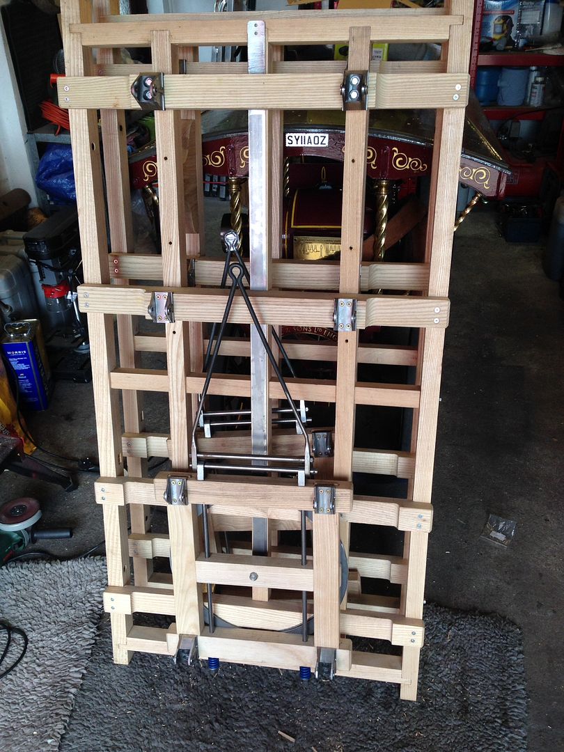

Then it was fit all the parts to the woodwork to get all the pilot holes drilled and to make sure everything goes together as per STW normal precision.

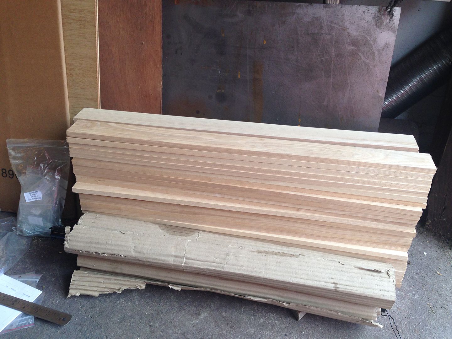

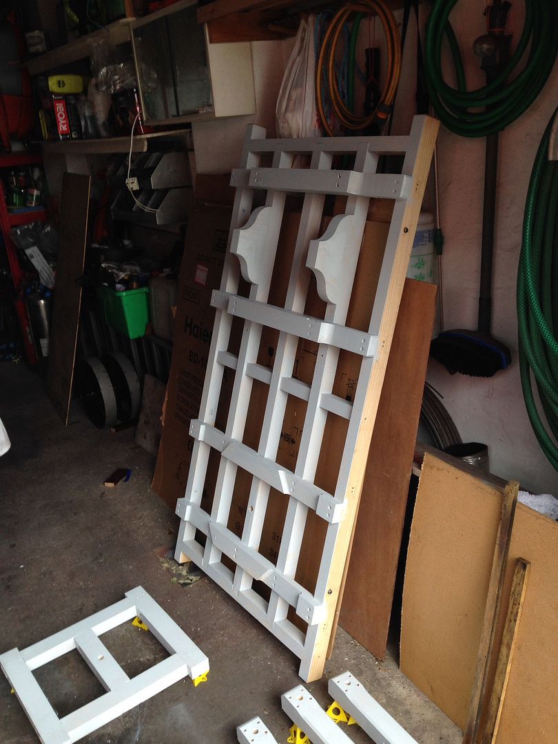

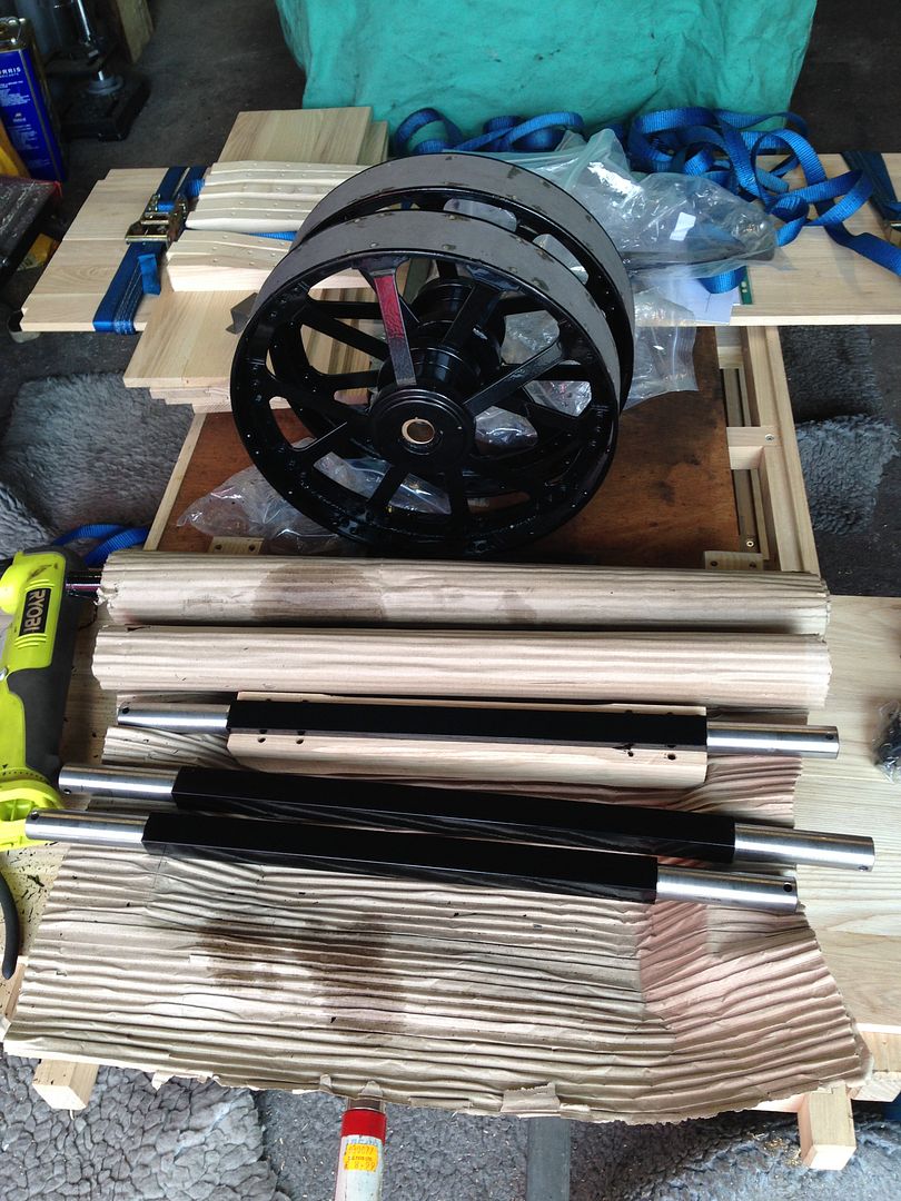

Unpack the rest of the wood to allow it to acclimatise.

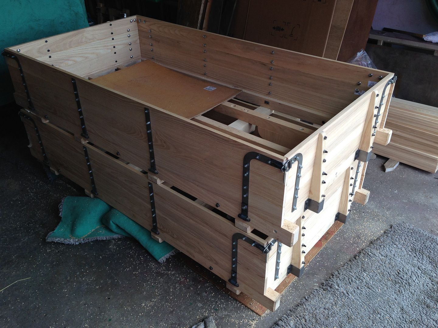

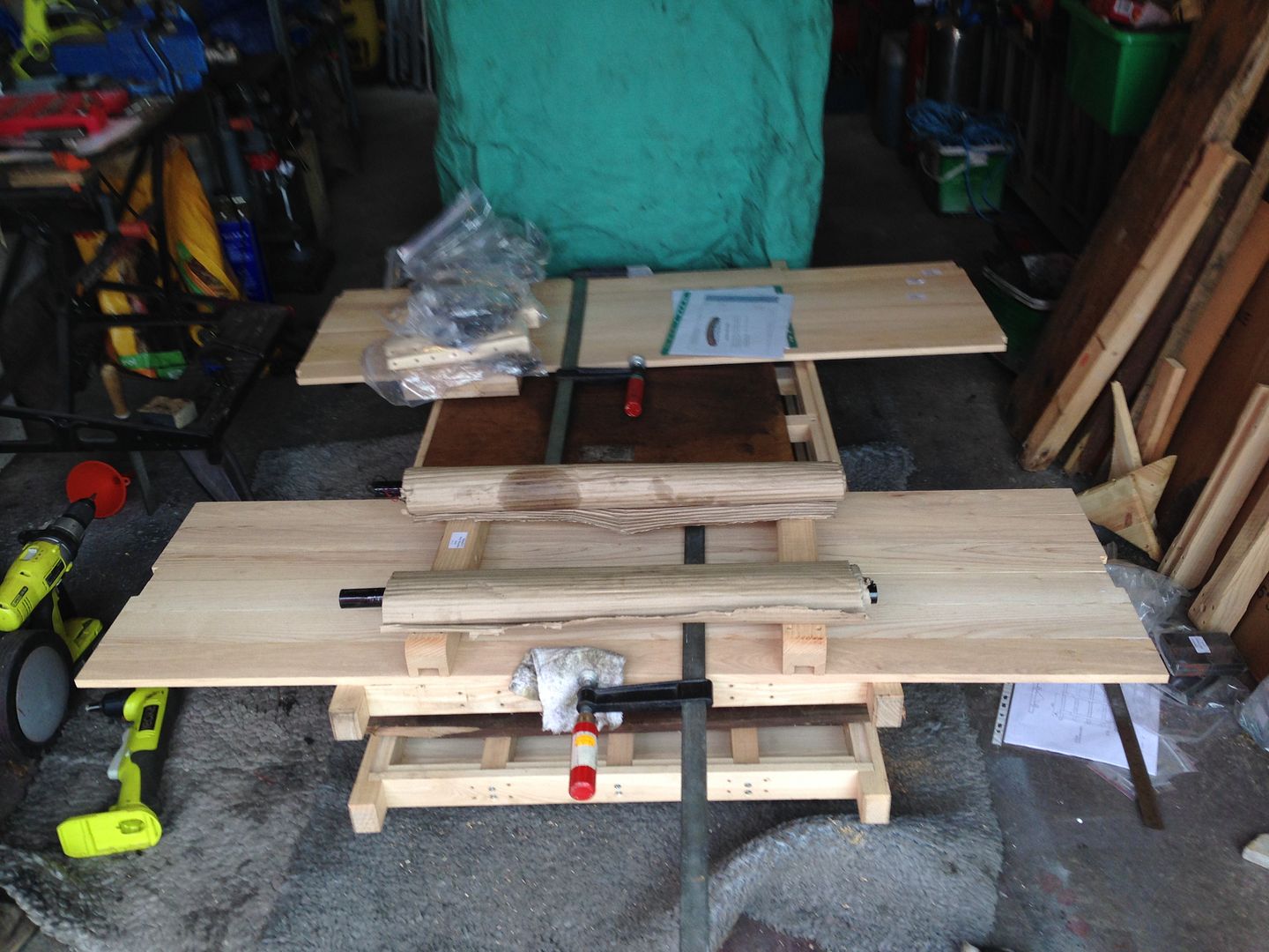

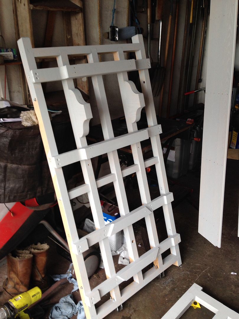

Glue the end boards together.

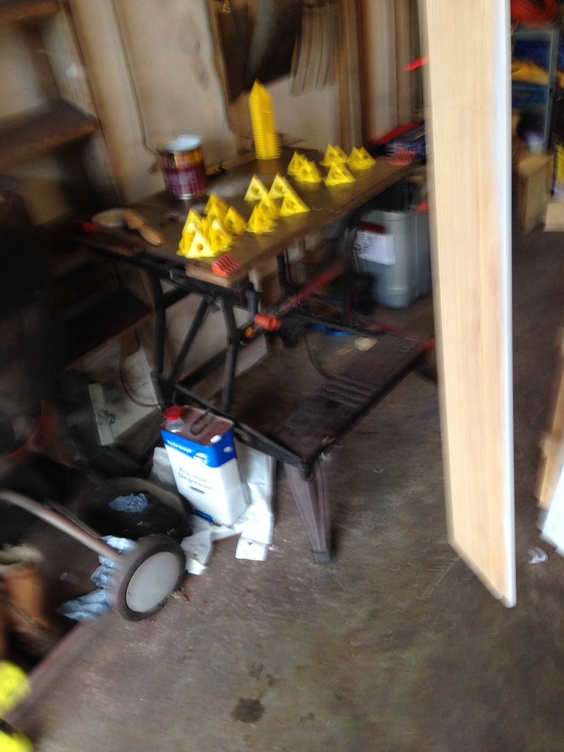

Using the odd weight lying around to make sure it sets up flat.

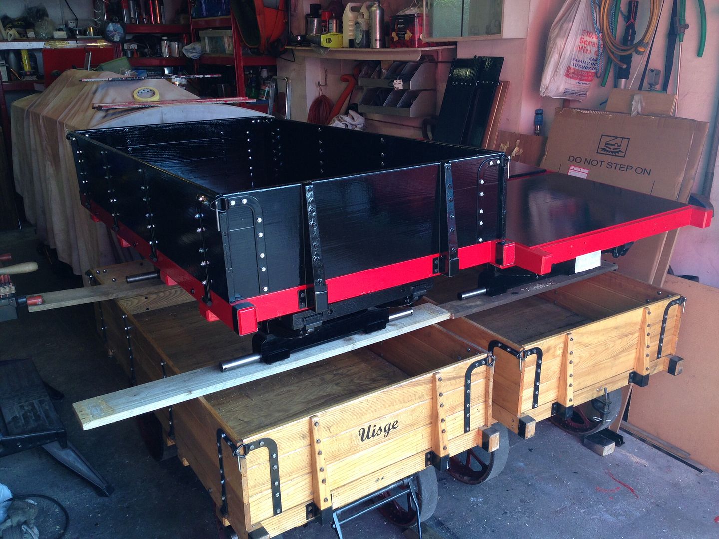

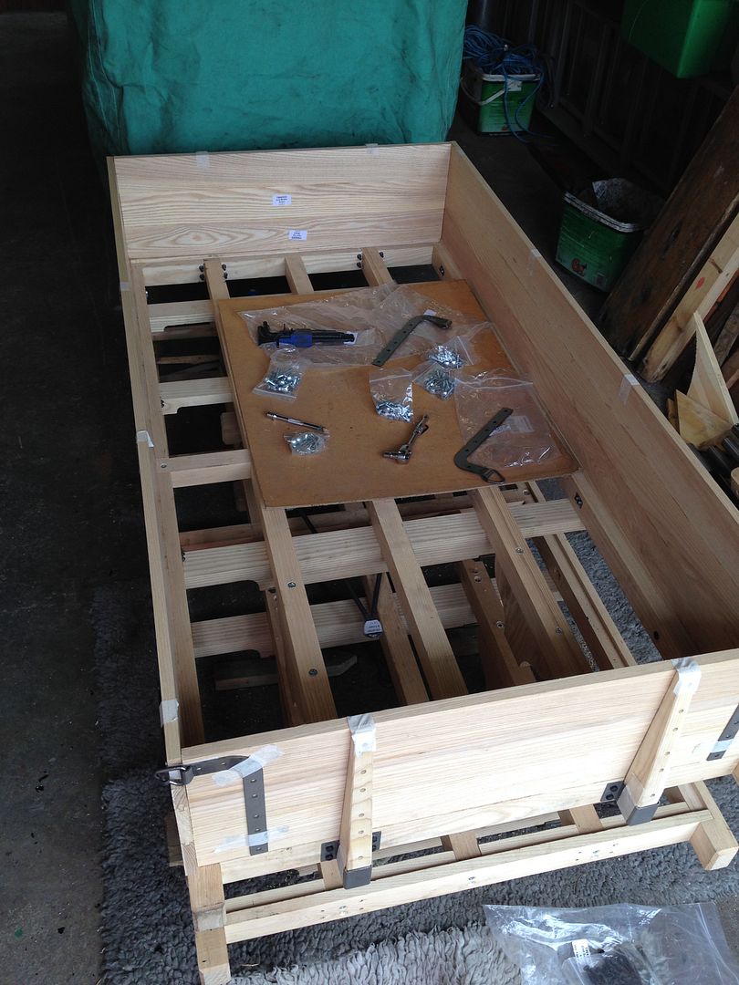

Now that the sides are glued up as well. Start sorting out the metal work and masking tape attach everything on.
Lots of drilling later and all the ironwork is on the wagon bodies.
Paint time.

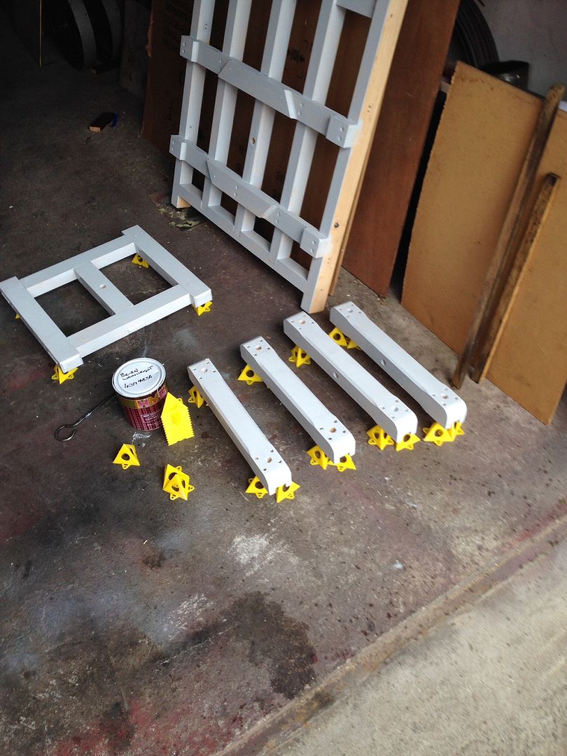

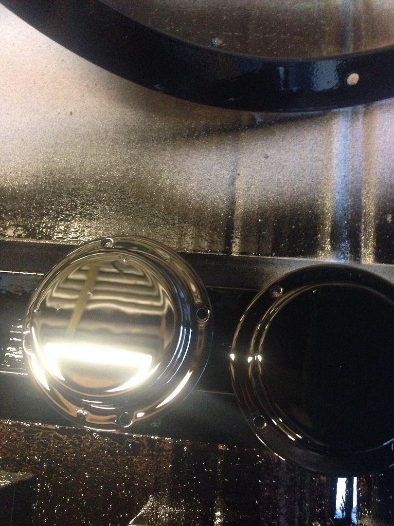

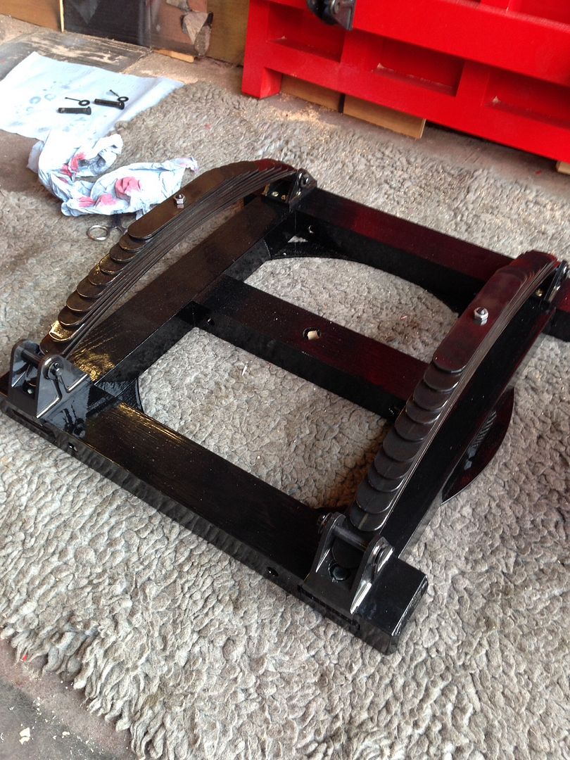

Turntable assemblies done. Needed filing in the tenons to allow a good snug fit. First coat of Black undercoat applied.

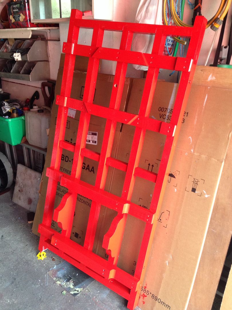

Have a change of colour. Going red undercoat now.

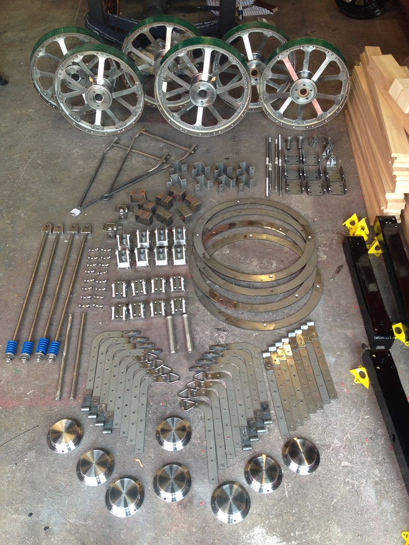

After a slight hiccup in the parts department. Namely missing 6 out of 8 wheels! Finally collected from North Yorkshire.
It is now wheel building time

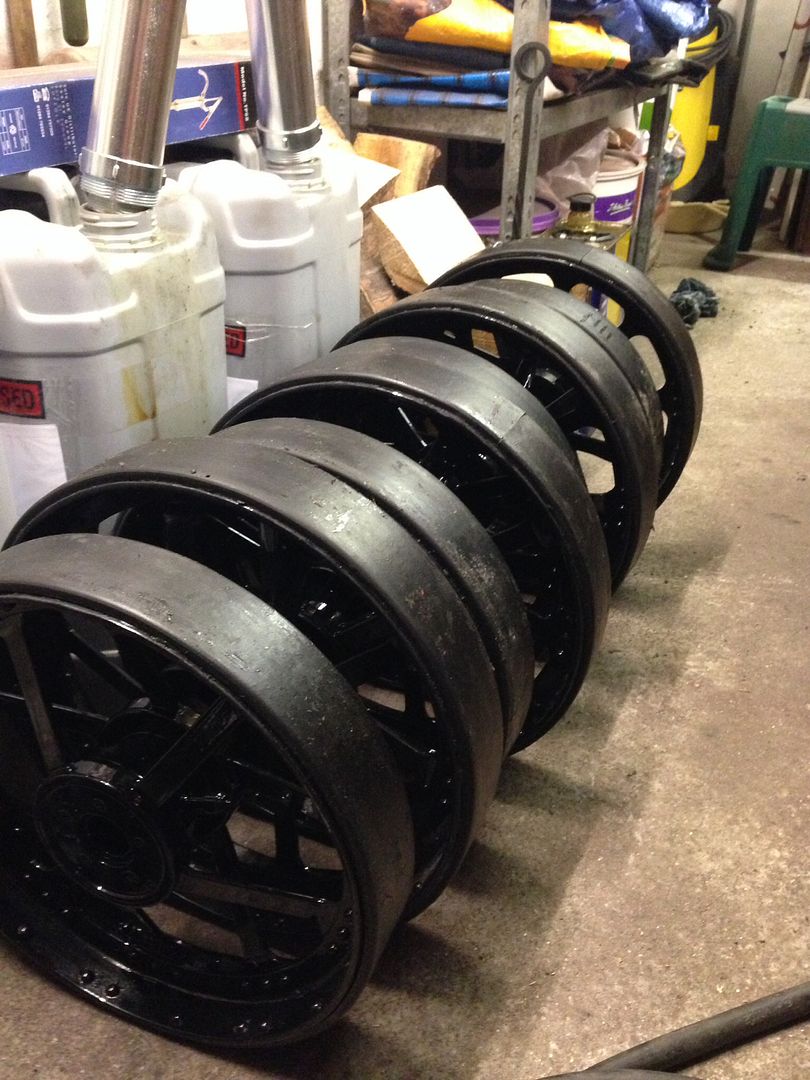

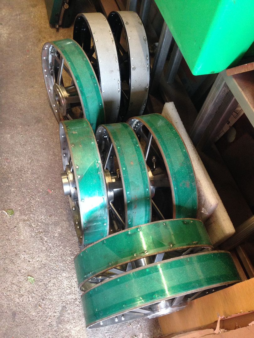

All the wheels ready now. They are going off to powder coaters.

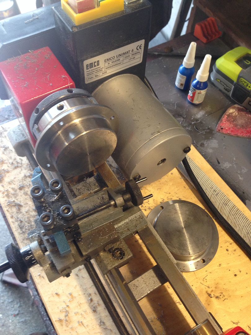

So the hub caps need a bit of a trim to allow for the powder thickness.

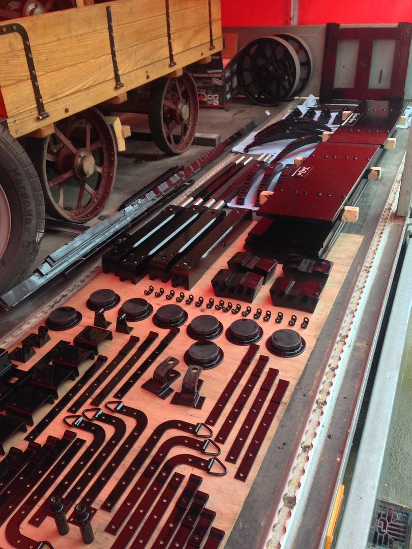

The metal part count is quite impressive when you are building two wagons at once.

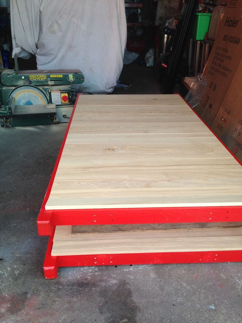

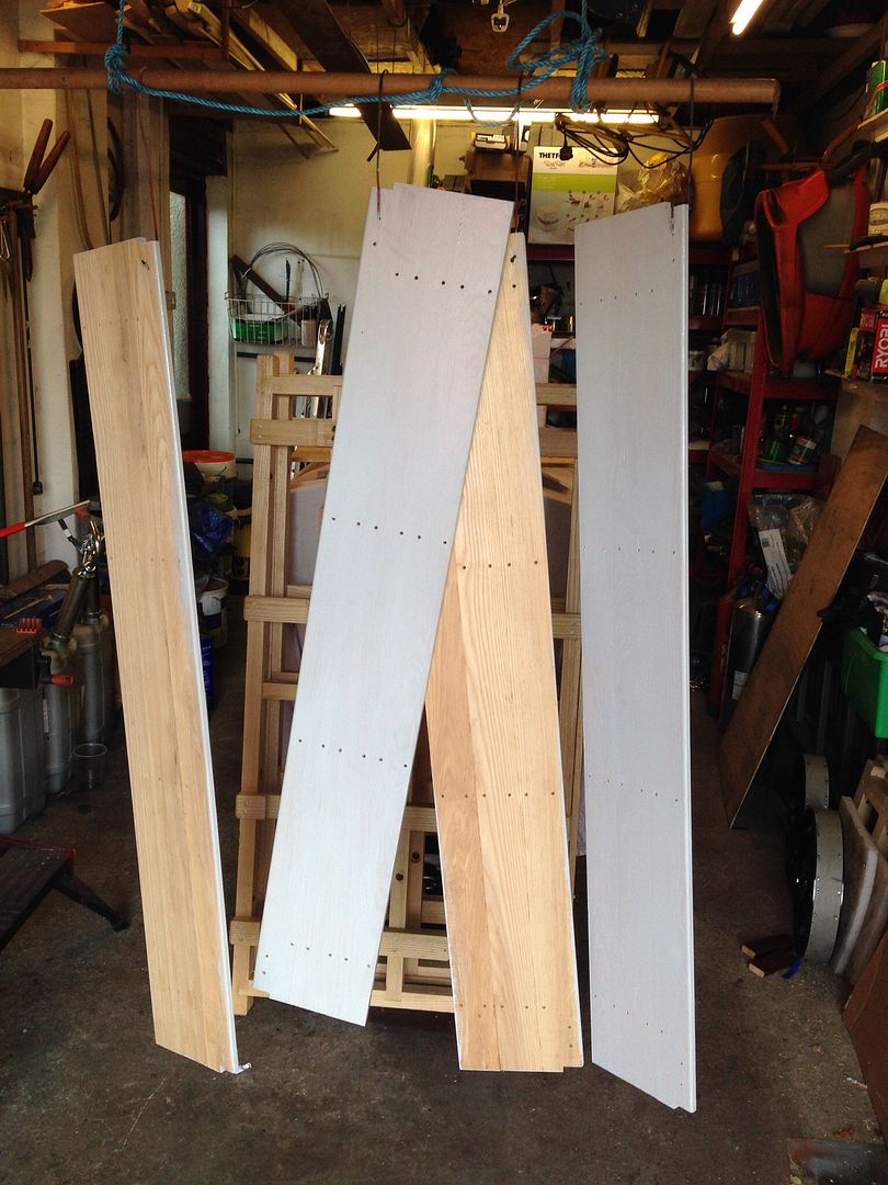

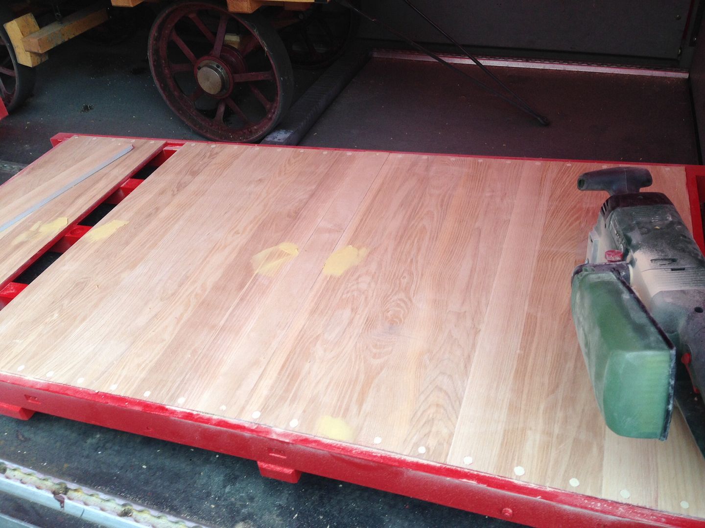

Back to woodwork. Using the table belt sander you can see. Trim all the floorboards to fit the chassis. Leaving the end board for when the rest are glued and screwed in place.
I made a jig up to get all the screw holes in a nice line. Then I filled them all in!

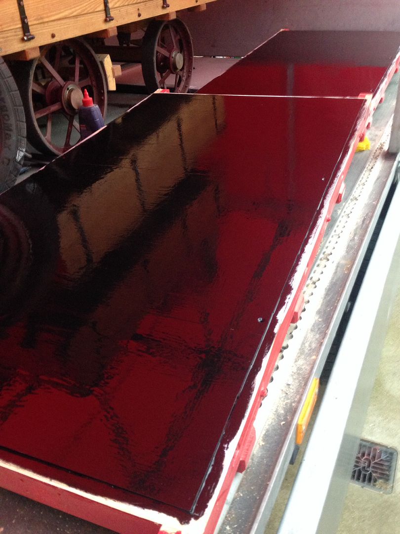

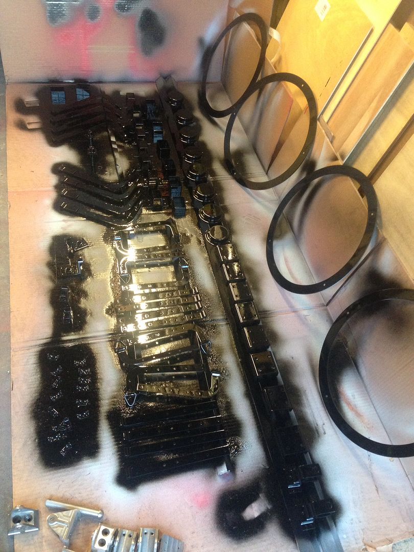

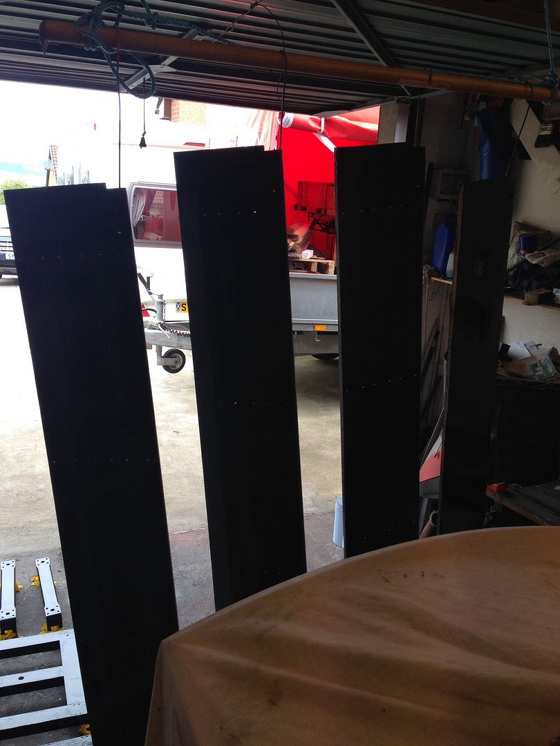

Bit of a change. Etch priming of metal parts.
Then into first coat of two pack.
So far so good. No dust visible!
Next coat. Still no dust!

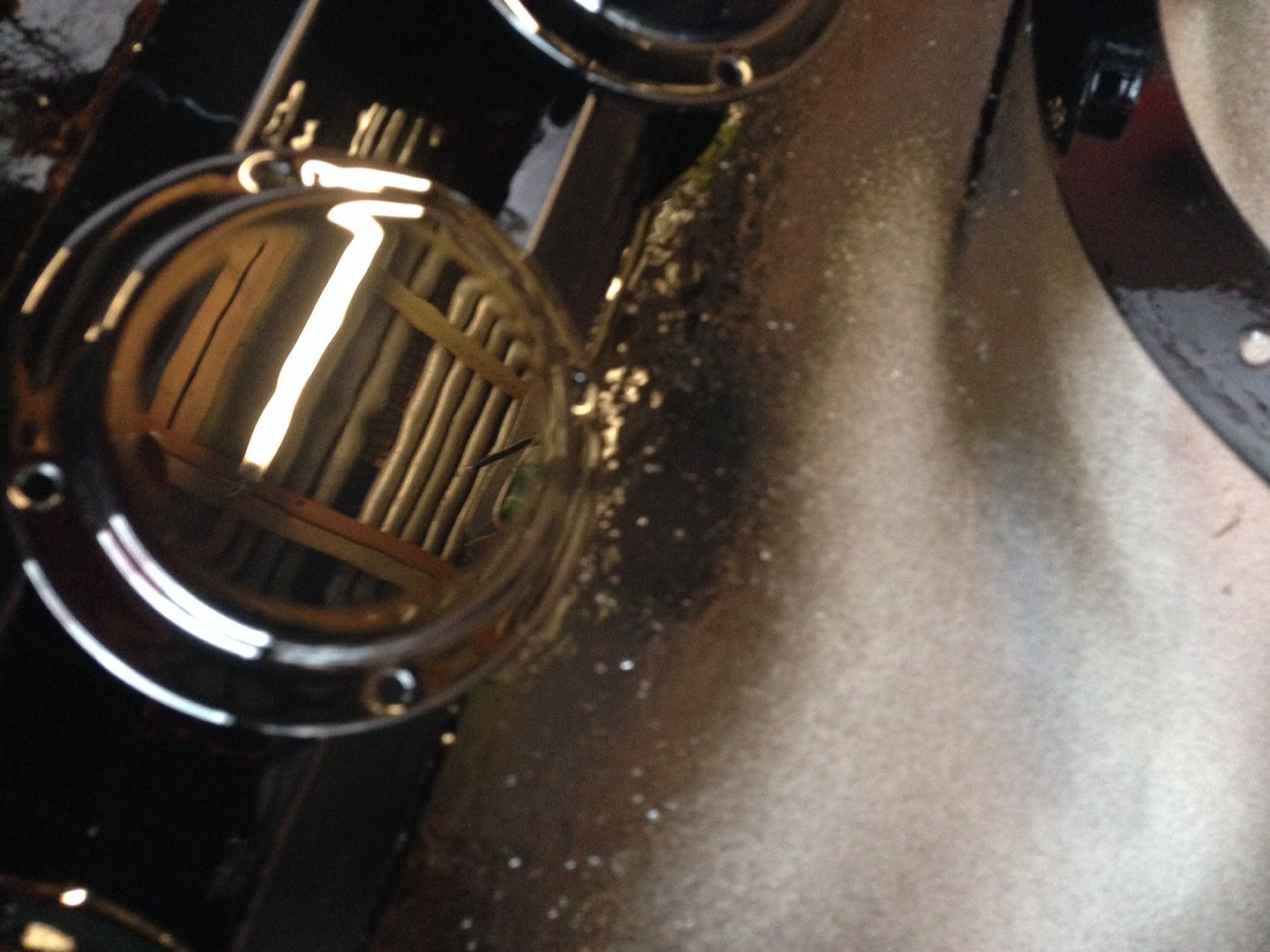

Looks excellent on the top but somewhat orange peel on the sides. Bugger!
Lets play with some wood instead. Belt sanders are wonderful things!

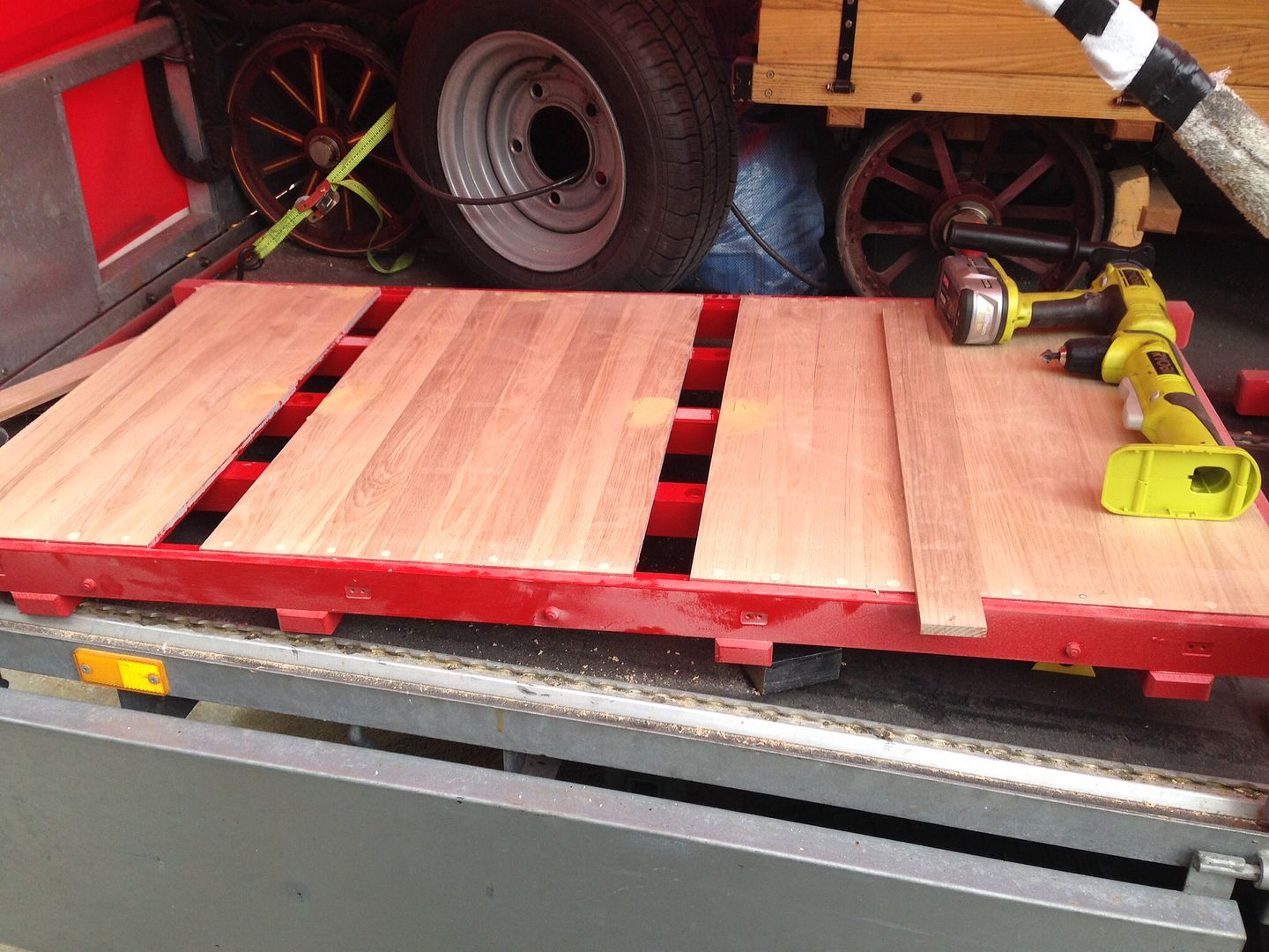

The "missing" floorboards are actually kept loose to allow the turntable pin and brake hangers to be got at. These boards will just be screwed down.

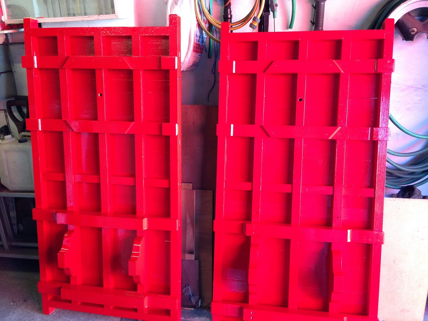

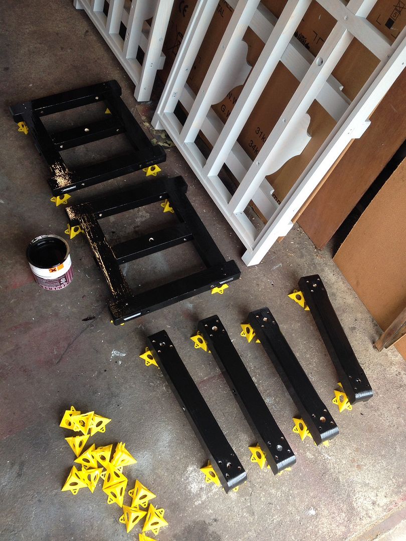

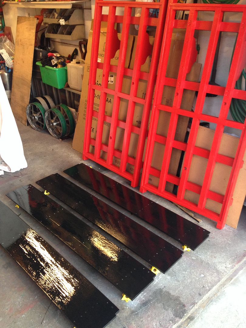

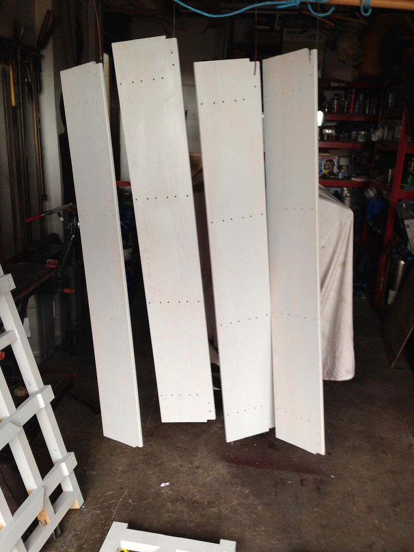

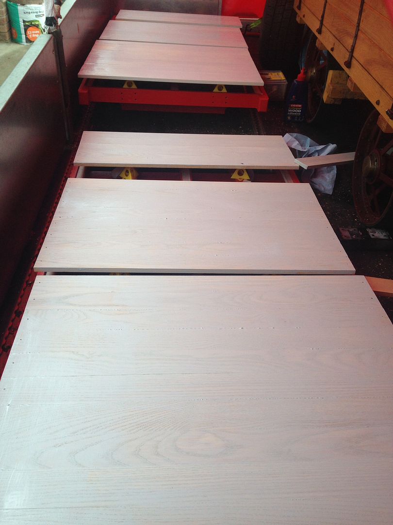

Primetime!

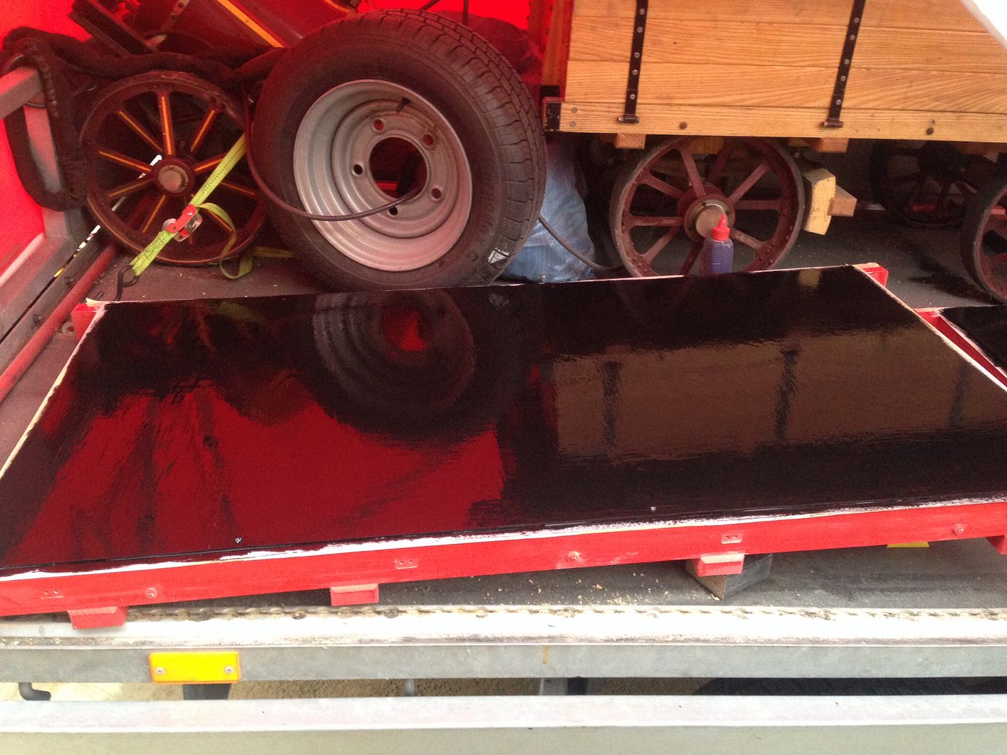

First black undercoat. The red chassis rails are masked off.
Back to the metalwork for their 3rd coat.
Now to leave for 7 days to fully harden.

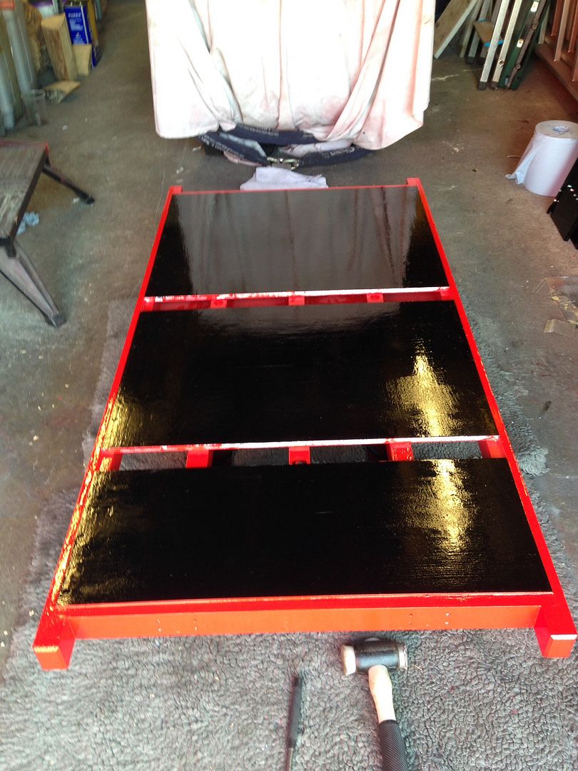

Now that is RED

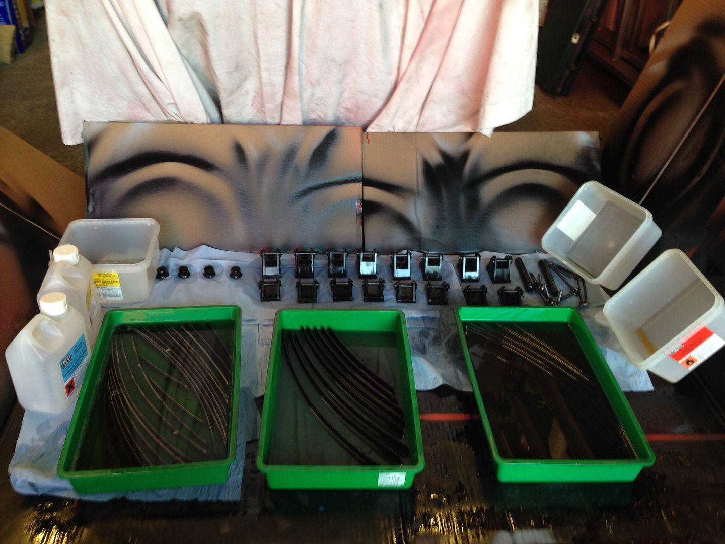

Now that I have had a good dose of paint fumes. Lets play with chemicals.

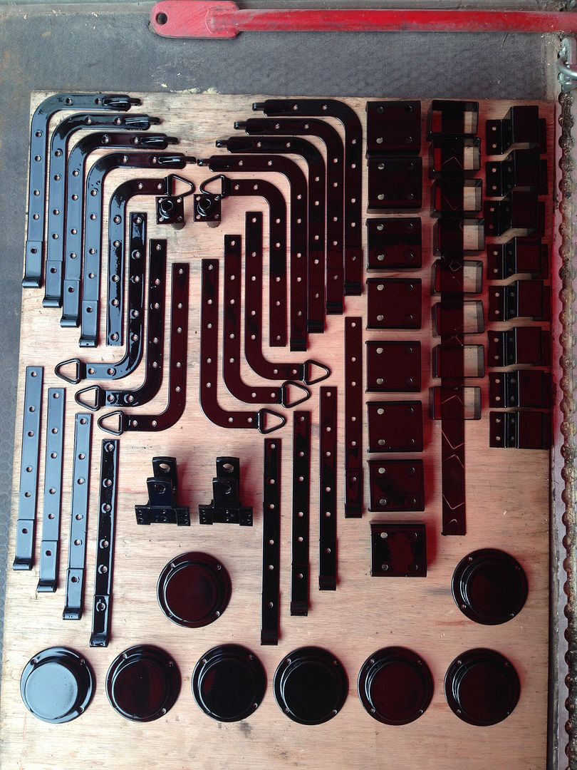

Blacking kit.

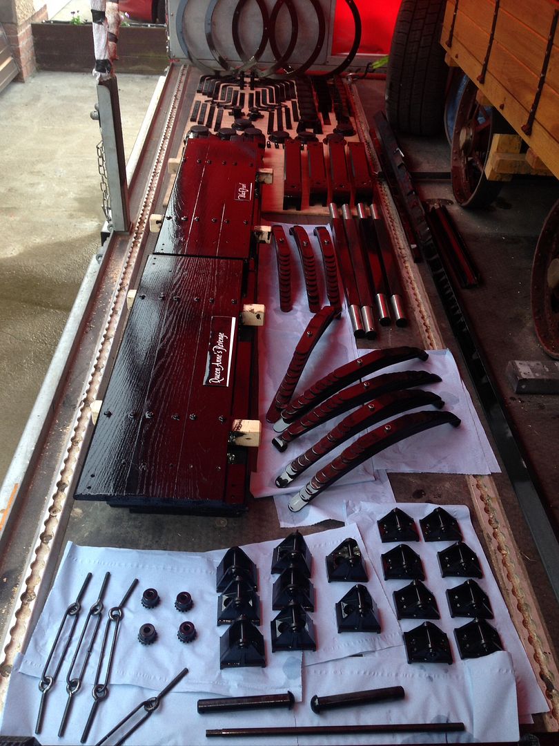

The parts store is getting quite crowded. Need to start fitting some of this stuff together.

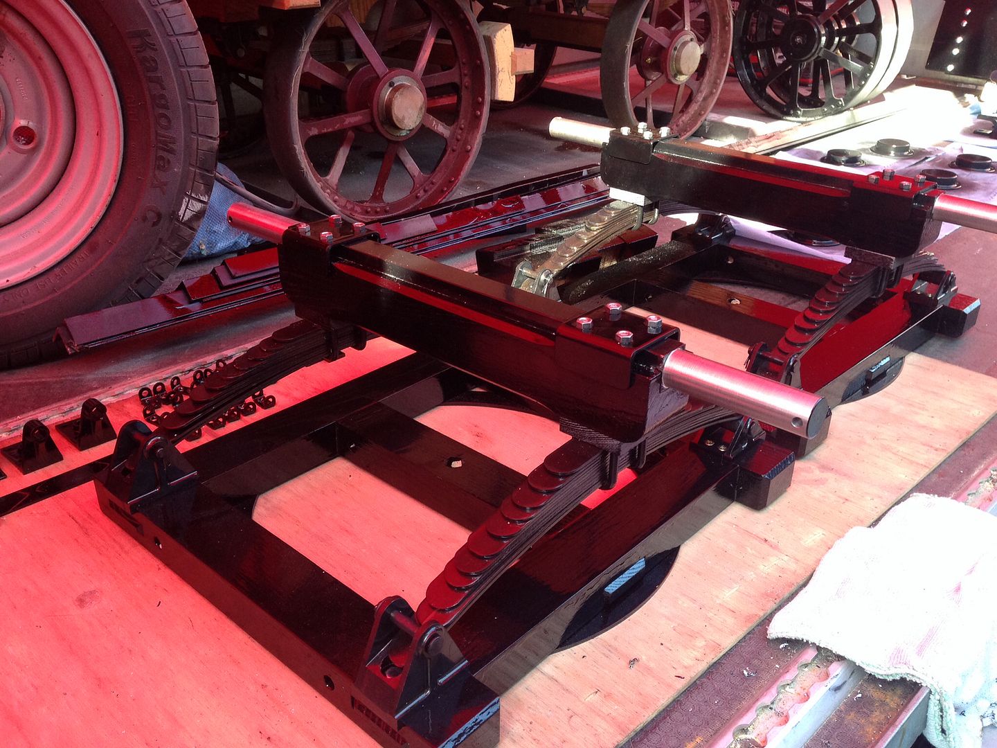

Second and final assembly has begun.

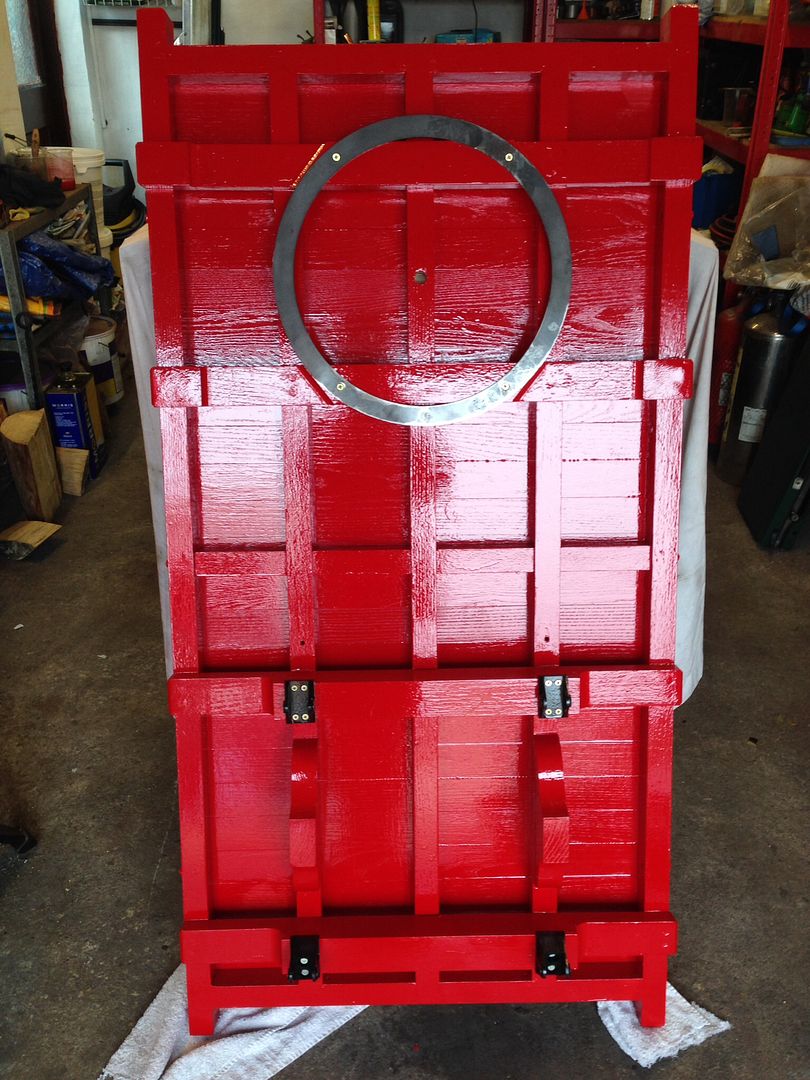

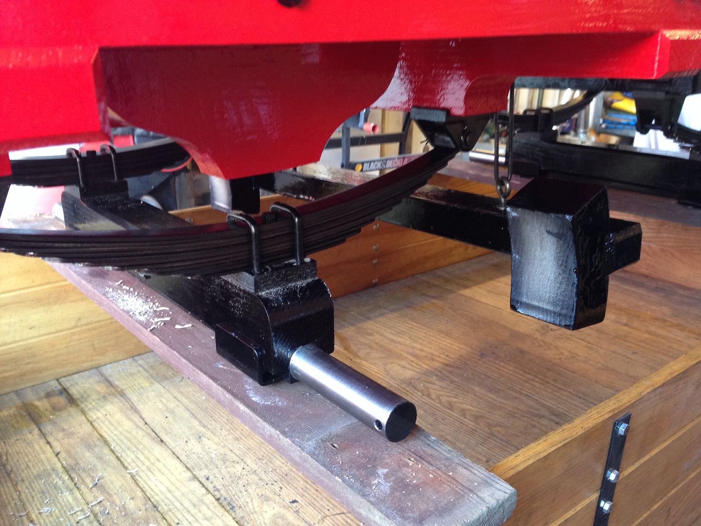

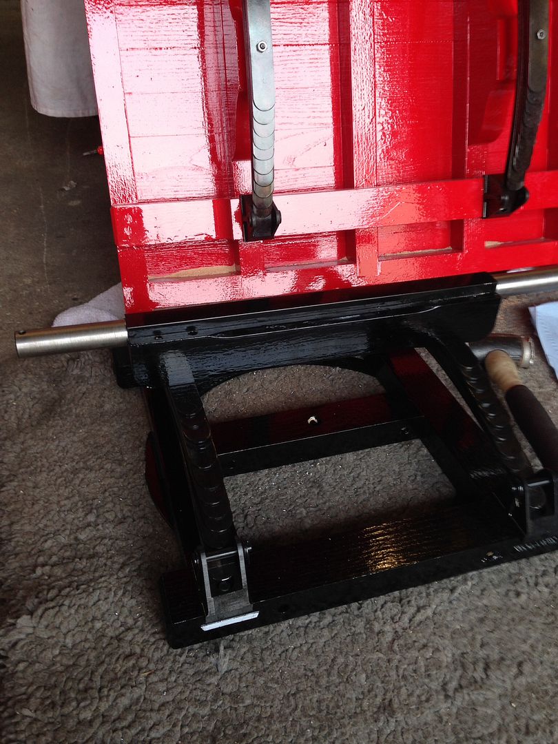

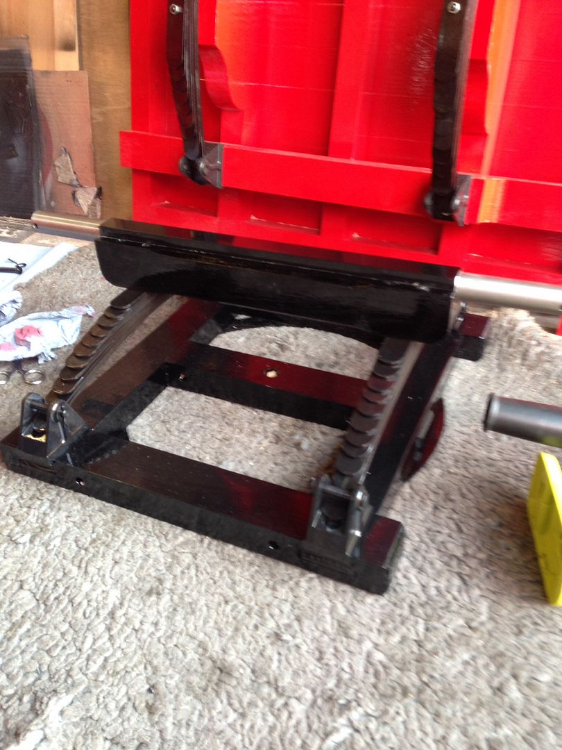

Turntables put out the way while working on the wagon chassis.

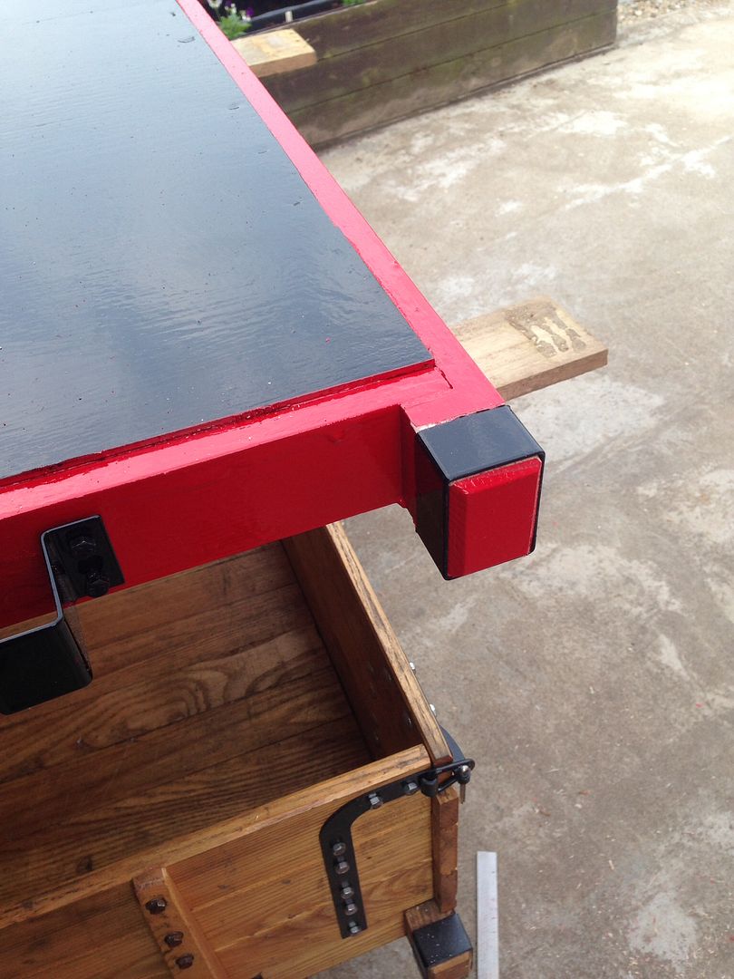

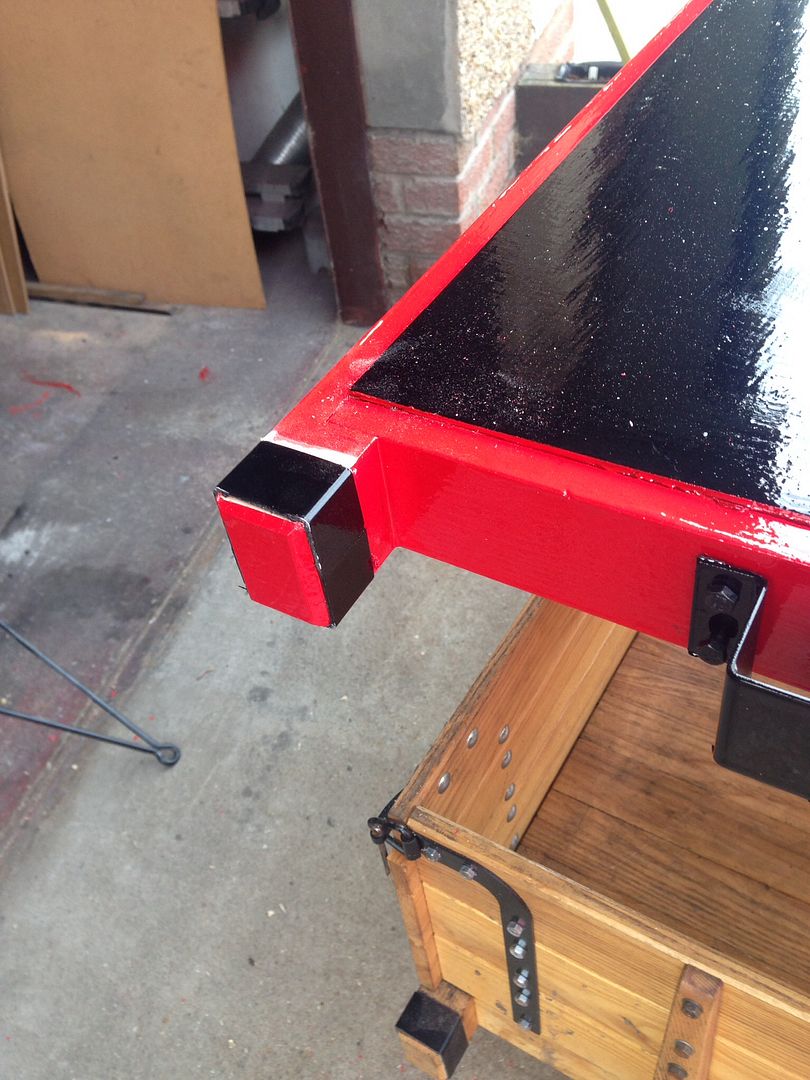

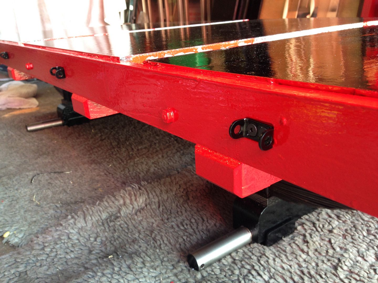

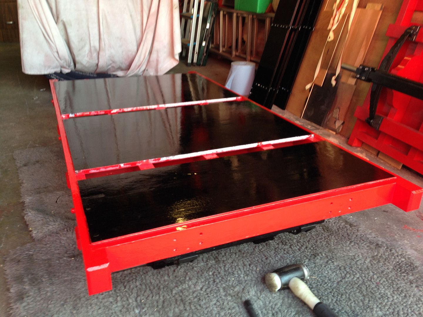

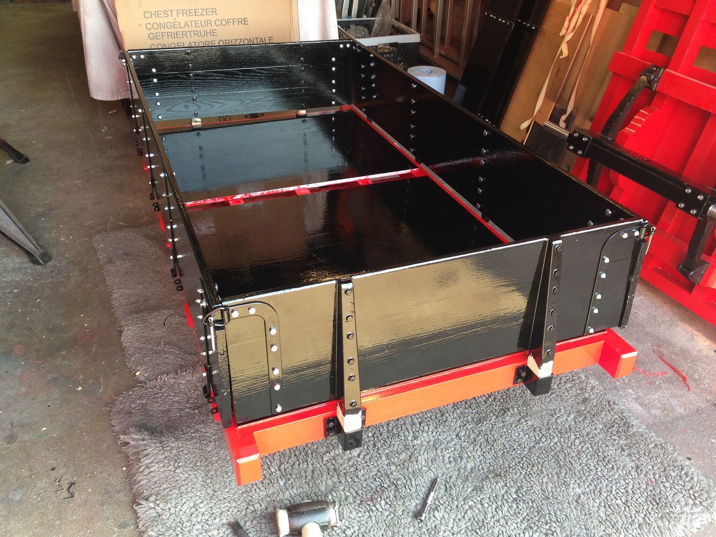

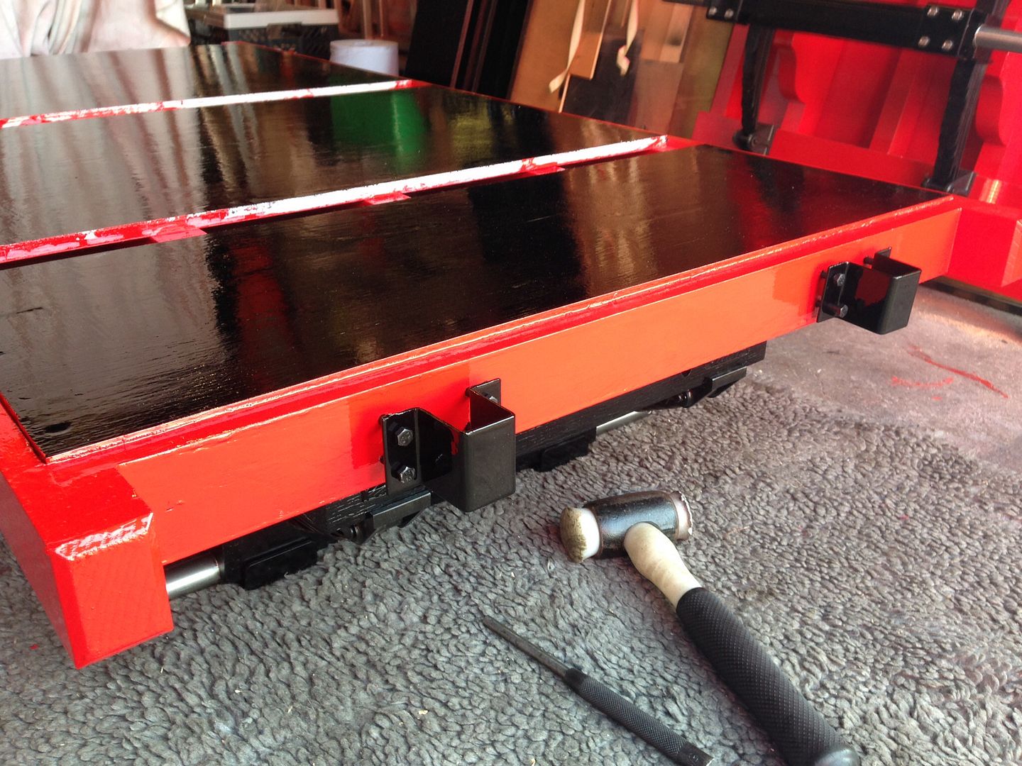

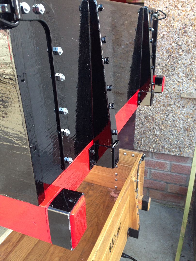

Now to touching up the floor of the wagons. Get a nice crisp edge round.
Ironwork now being fitted. The red is still a bit soft so not fitting fully yet.
Hinges looking good.
Trial fit of the body panels.
Yes Brian your colour scheme does look good.
I asked Crystal if I could borrow her wagons to use as mobile work tables.

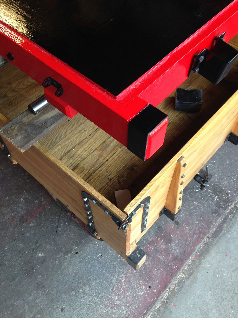

Fitting the end protectors. Paint touch up will be required.
Shaping up nicely. Will I be finished in time?

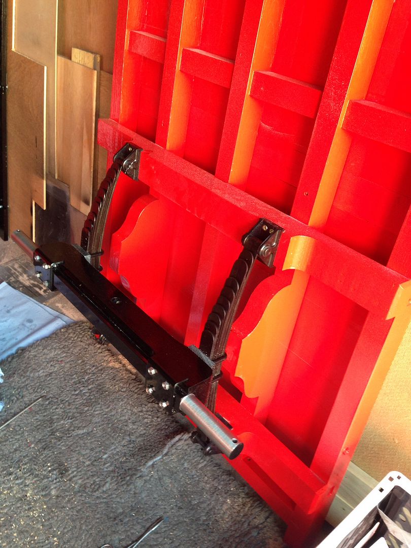

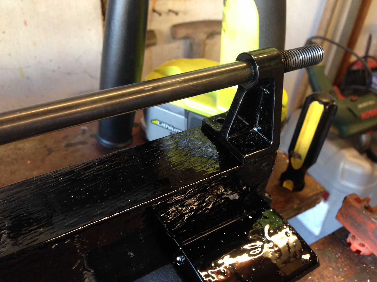

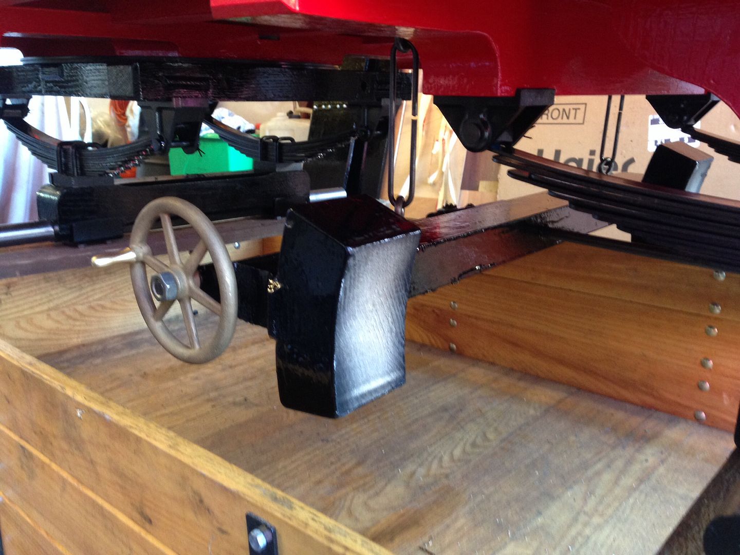

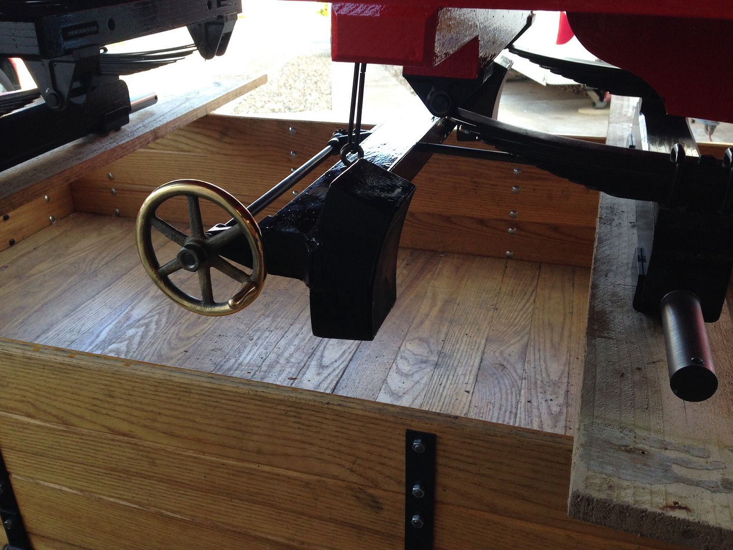

Now to put a brake on things.

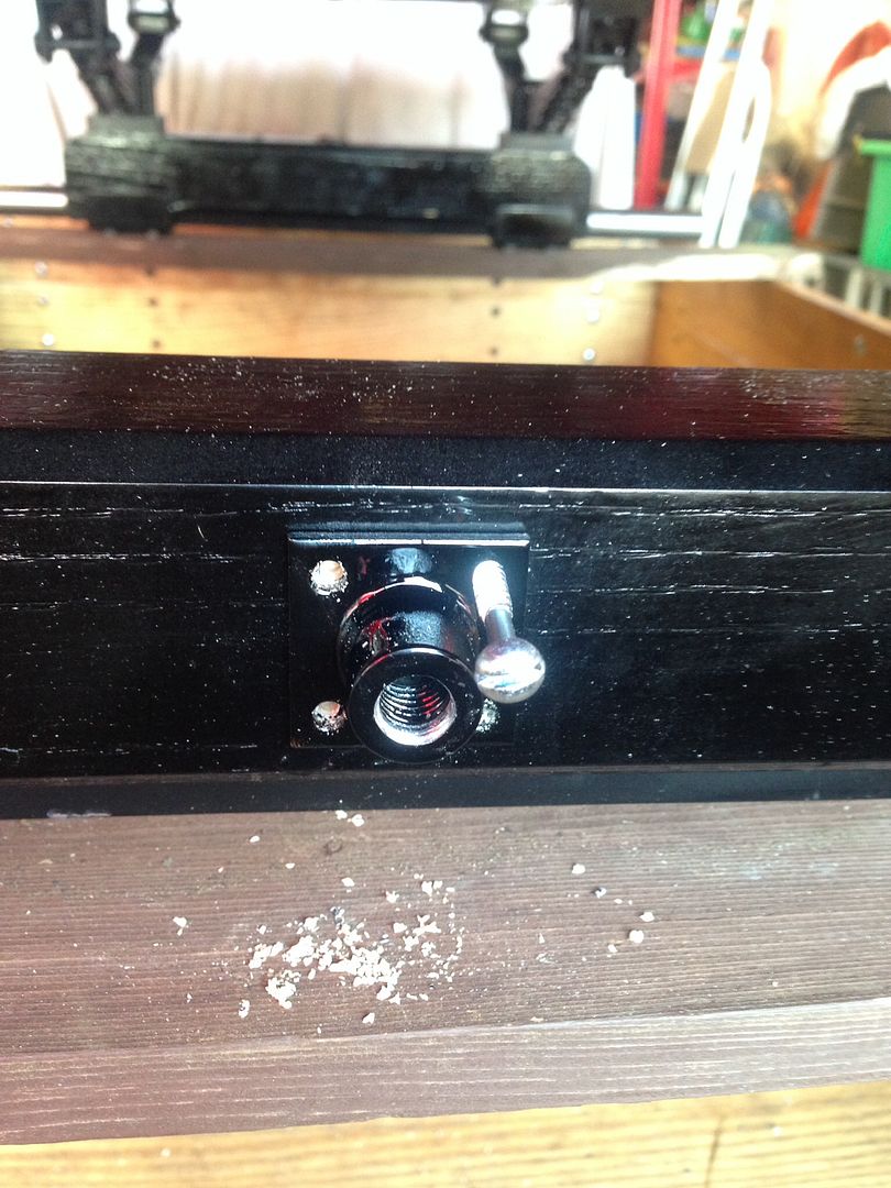

Axial screw nut.
Paint the tension bolts black.
That looks nicer.

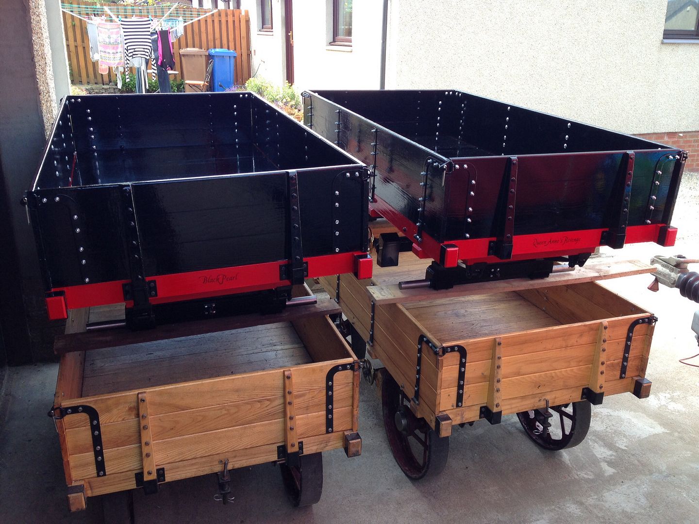

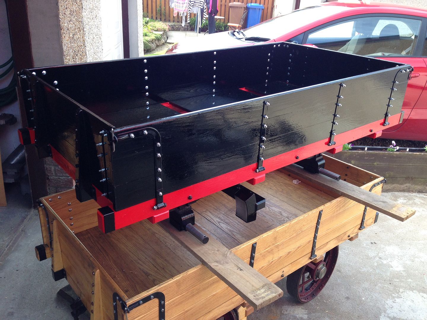

Now that does look nice.

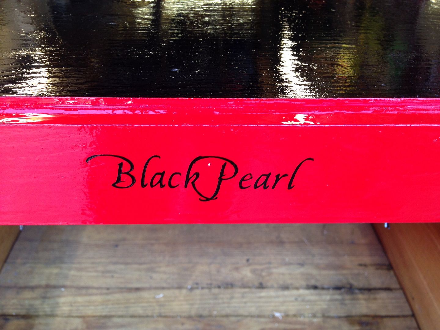

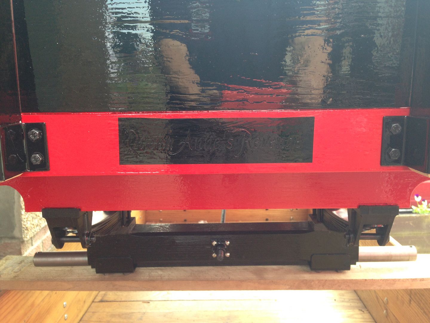

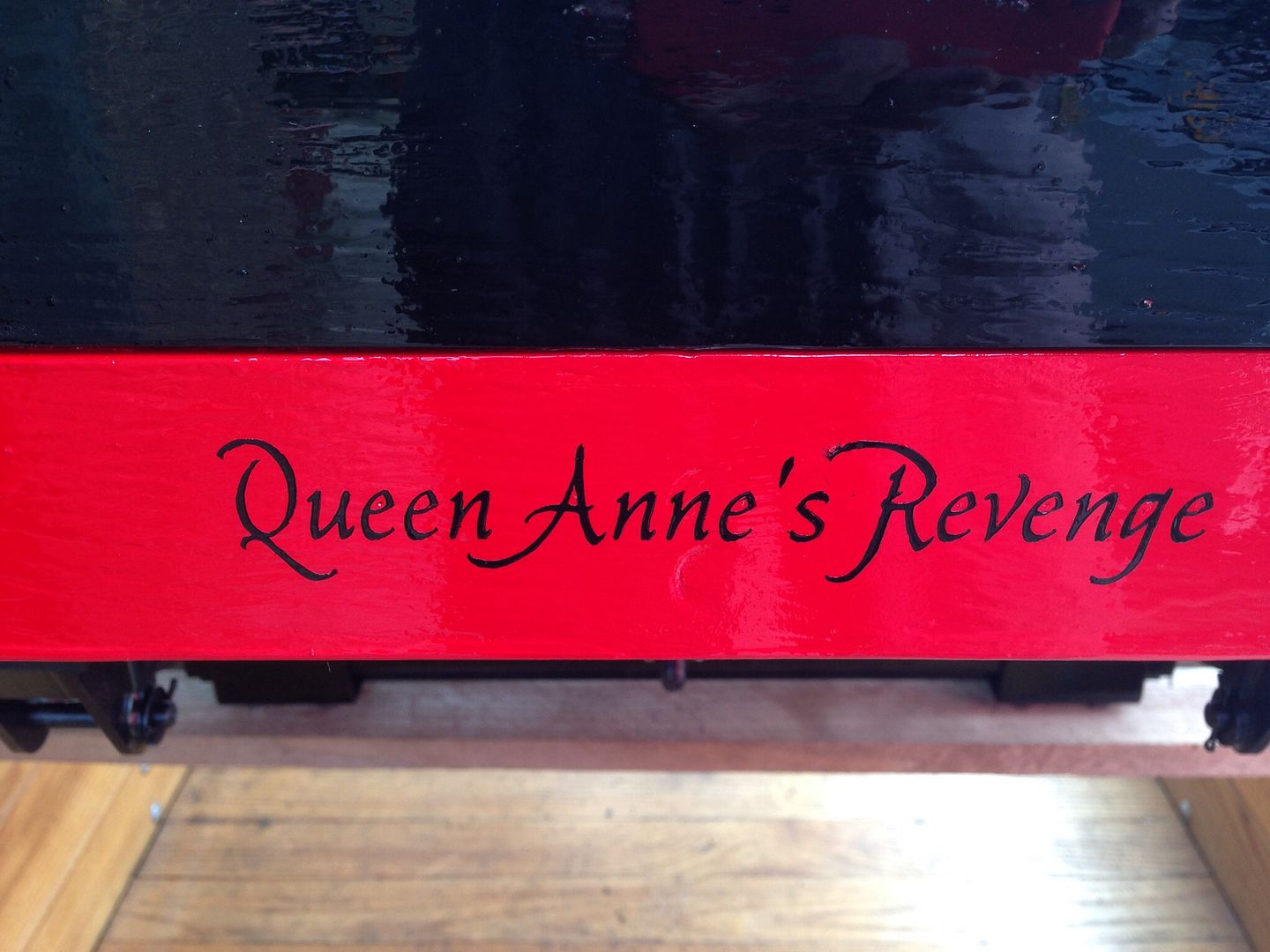

Naming of the wagons.
Bit snug in Crystals bedroom. She did as if she could keep them as well.
Back to the brakes. Currently fitting the wheel assembly and turning the gears bosses down to allow free turning.
No you are not seeing a repeat. This is the other wagon.

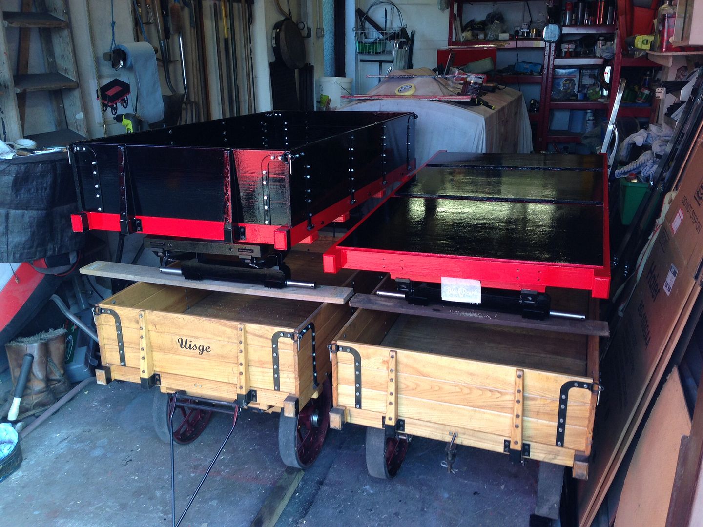

Twins! Bodies are basically complete. Waiting for tow strap and wheels now.

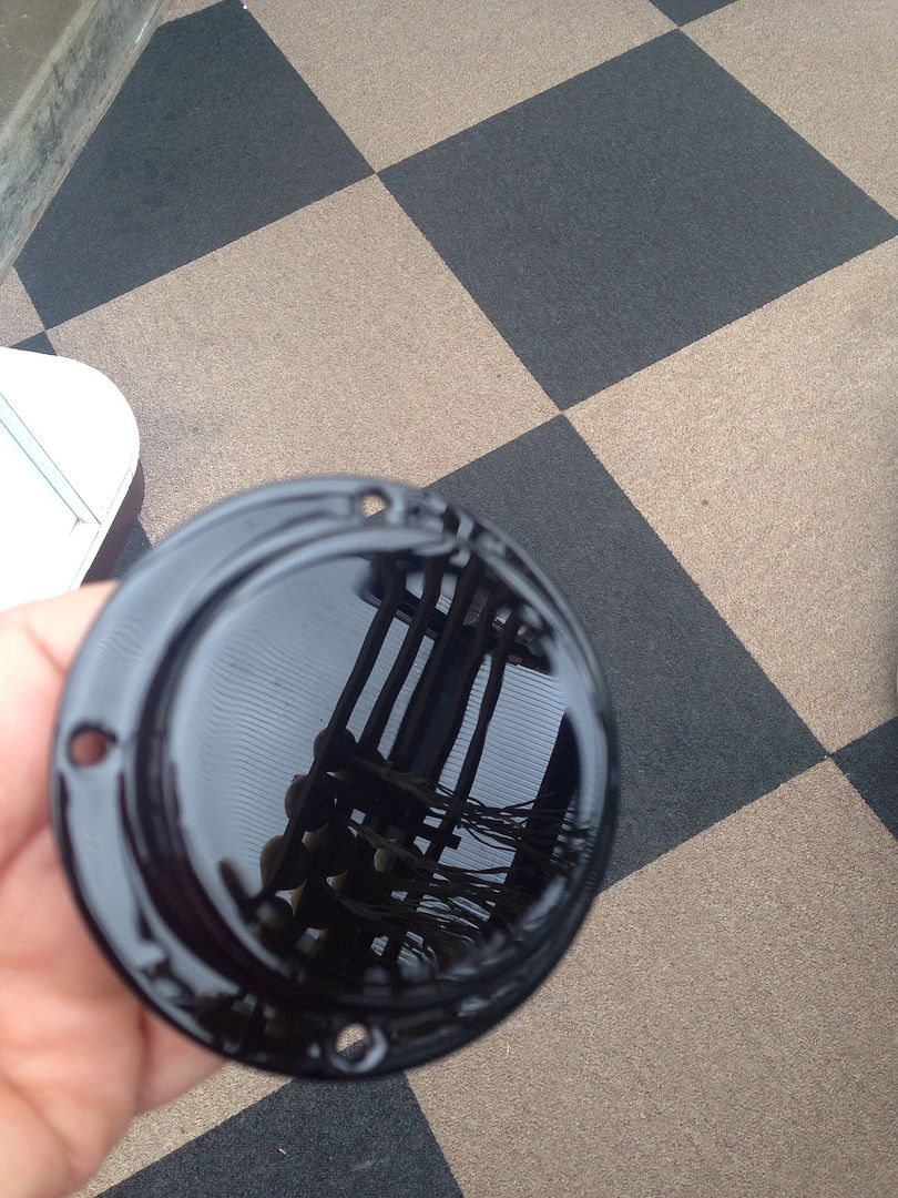

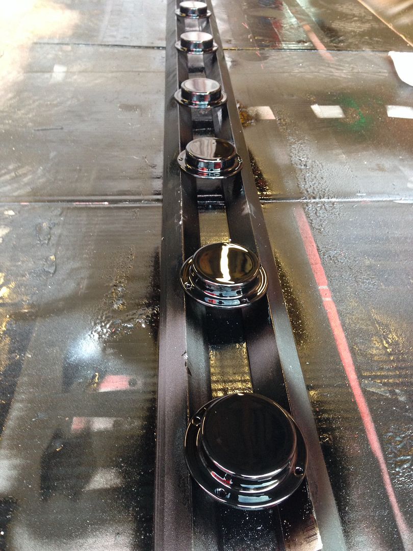

Had to redo the hubcaps. I was not happy with the finish. There must have been a bit of dust got under the door as it was quite windy a couple nights before.

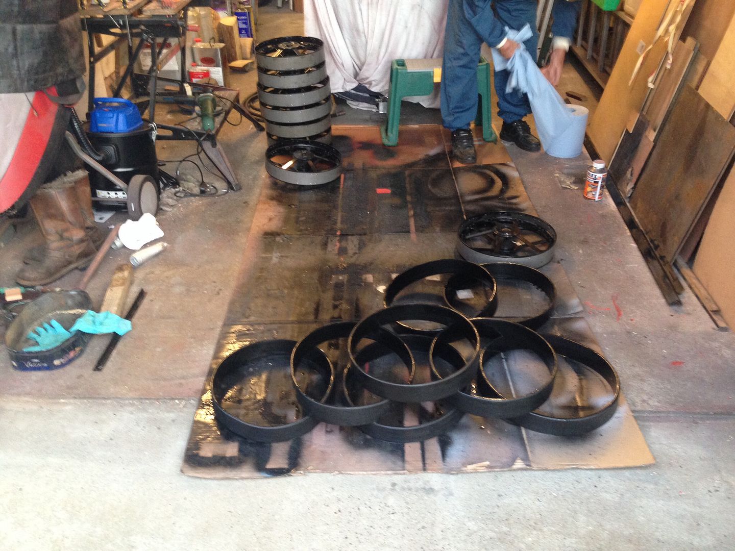

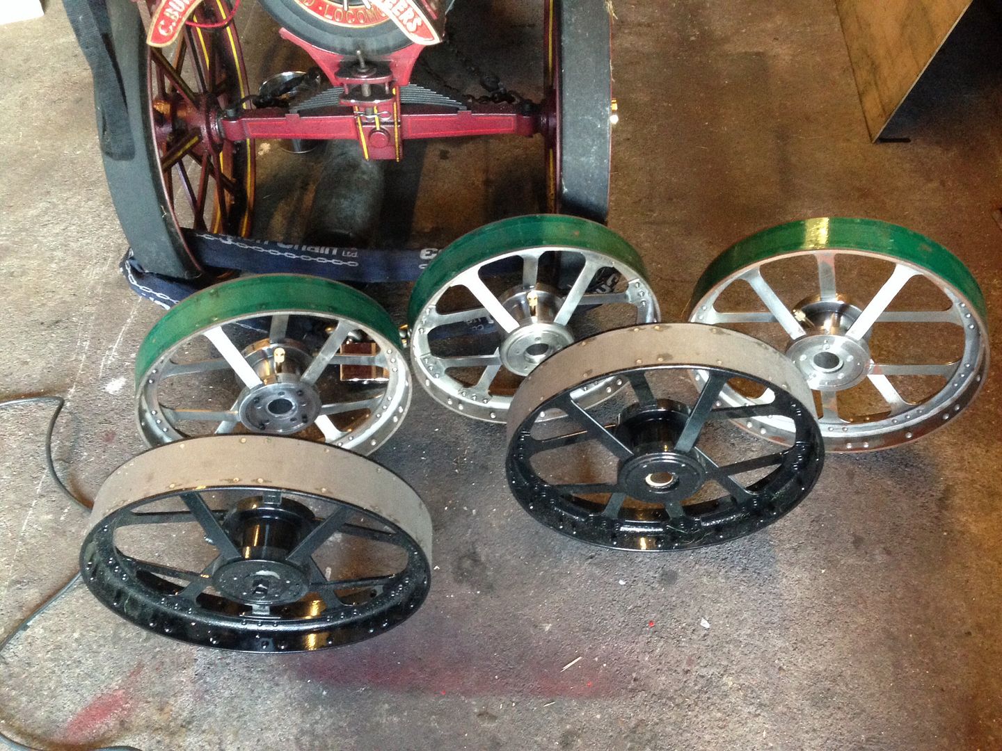

Wheels arrived!. Lets get ready for a mess.
Well not really. If you get set up correctly and clean between each wheel.

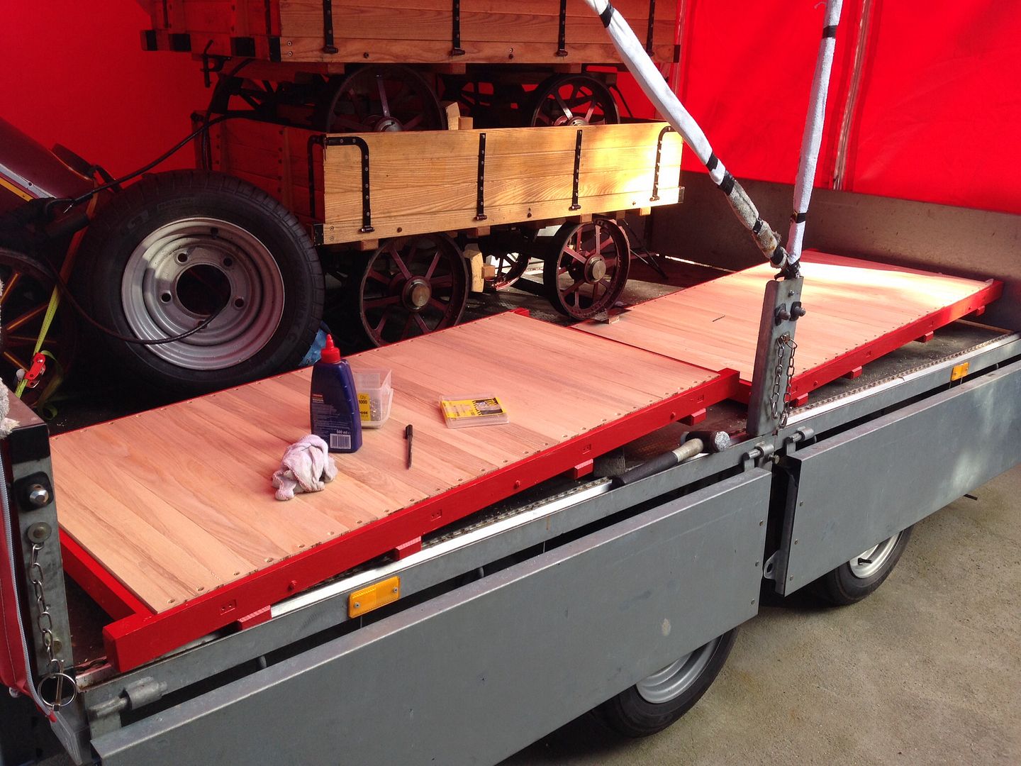

Here is one more picture of the road train after unloading, it all fitted into my 10 x 6 Ifor box trailer with the bowser in one of the wagons. Just the bolts holding the iropn work onto the sides to paint and all done, rubber mats for the floor inside arrive tomorrow. Just might get some mini tarps made to cover them like a full size trailer would cover the loads.
