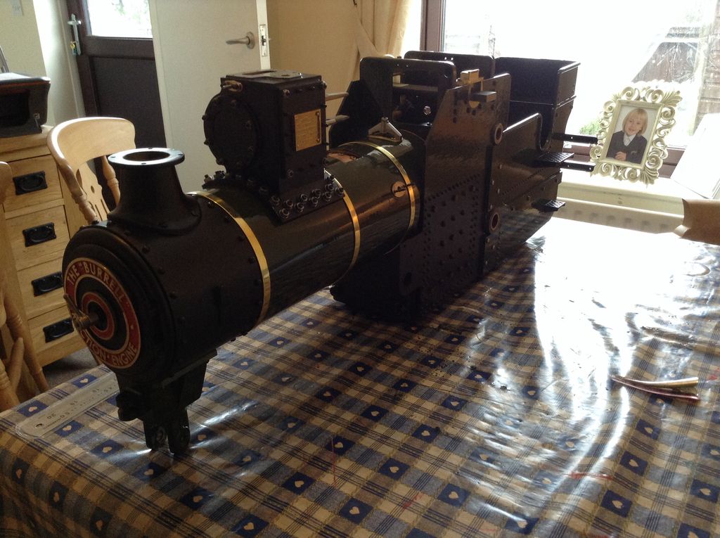

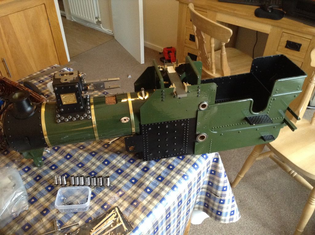

Putting all the bits back on post cladding and new fire door. She's starting to look like an engine now.
The new alignment tool fit with minimal adjustment and the measurements needed to square off the hornplates are all within tolerances with the minimum of fuss.

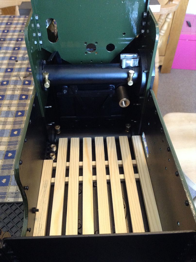

Been fiddling while I wait for my steering kit to arrive. Made some boards for the footplate. Seen something similar on larger engines and felt a bit creative. lol!

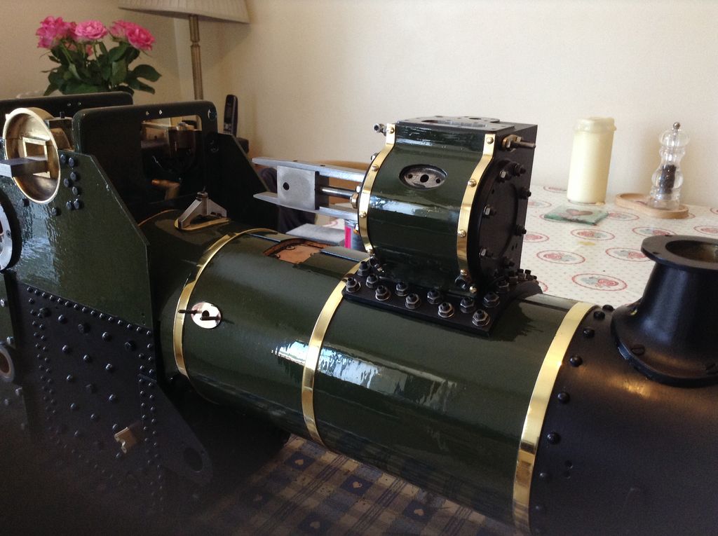

Finally finished cladding the cylinder block. Took a lot of fiddling and filing. The holes in the brass bands needed a little elongating in order to fit comfortably but I suppose when you are working this small in this level of detail a spot of ad lib is required. Shocked
