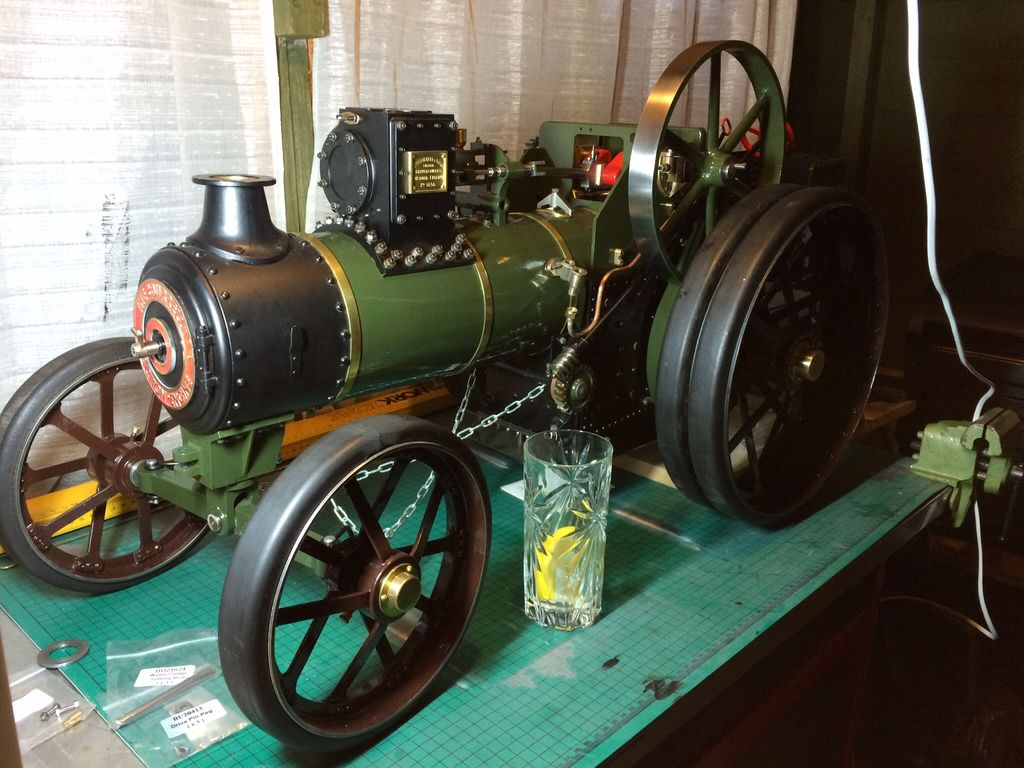

Been a while since I could get any time in the shed. No massive updates as I had to swap out the eccentrics on the crankshaft as they were the wrong material apparently. Thanks obviously goes to STW for their diligence for rectifying this before I had a siezed mess on my hands.
RIght hand gear guard gone on and the right hand wheel. Not sure if my spokes will foul the guard at the min as tolerances are tight on 2" scale. I will test and adjust after building up the Left hand side.
Some of the plumbing is starting to go in too! I've been trial fitting and assembling the waster pump for something different. Pics to follow on that.

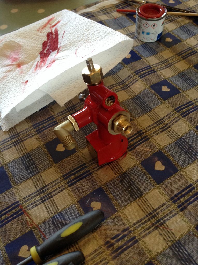

I though it was about time I posted a wee update. I have been very busy doing day to day living, work, family and Dad duties so been off the project for a while but I managed a few hours today so:
Water pump got a couple of licks of paint.

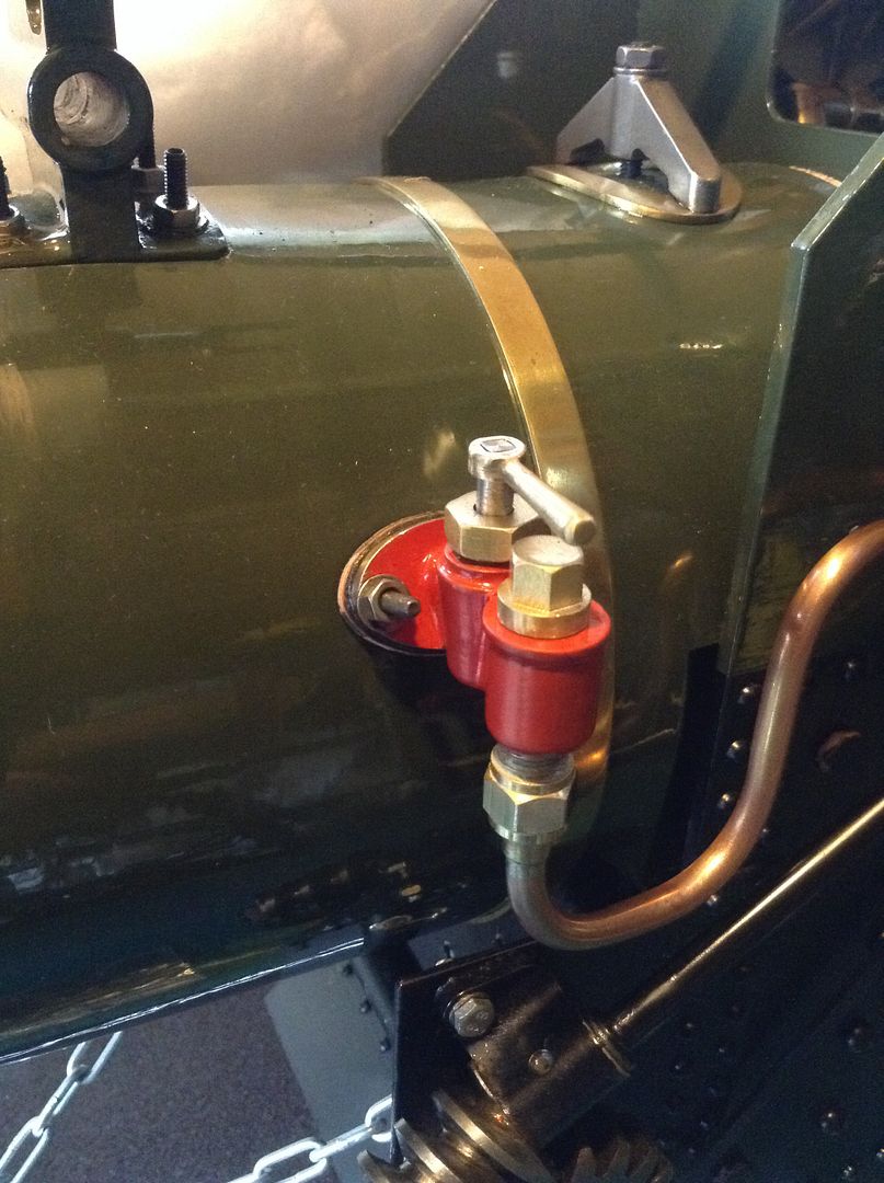

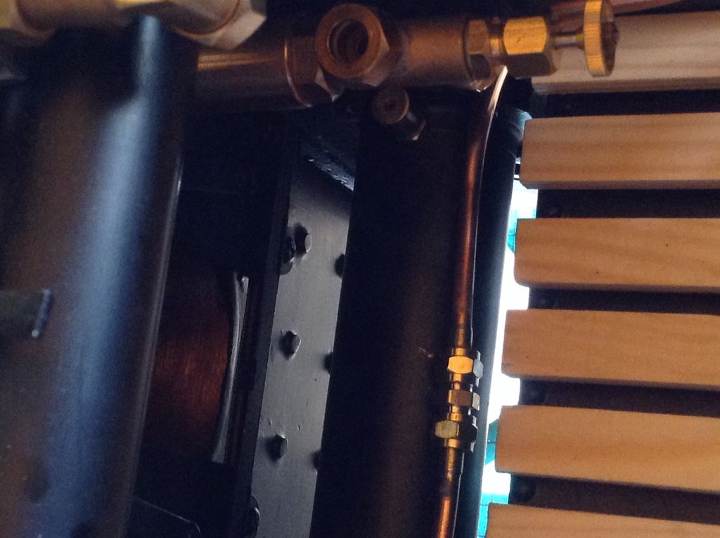

Post  Crazy_jim on Wed 17 Aug 2016, 6:44 pm
Fitted the exhaust pipe and steam pipe. Took a bit of fiddling to get the pipe into the chimney. Again in 2" scale this gets interesting. I had to cut down a mini file to get into the small gap between chimney base and cylinder block. In the end as its a warm day I threw the pipe in the freezer to gain those few microns of shrinkage to get it to fit nice and snug.

Post  lynnr on Wed 17 Aug 2016, 8:10 pm
Looking good.
Make sure you clean the ragged edge of the blower pipe as you want a nice clean exit.

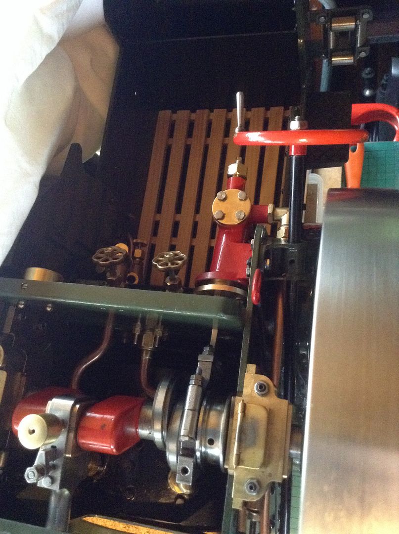

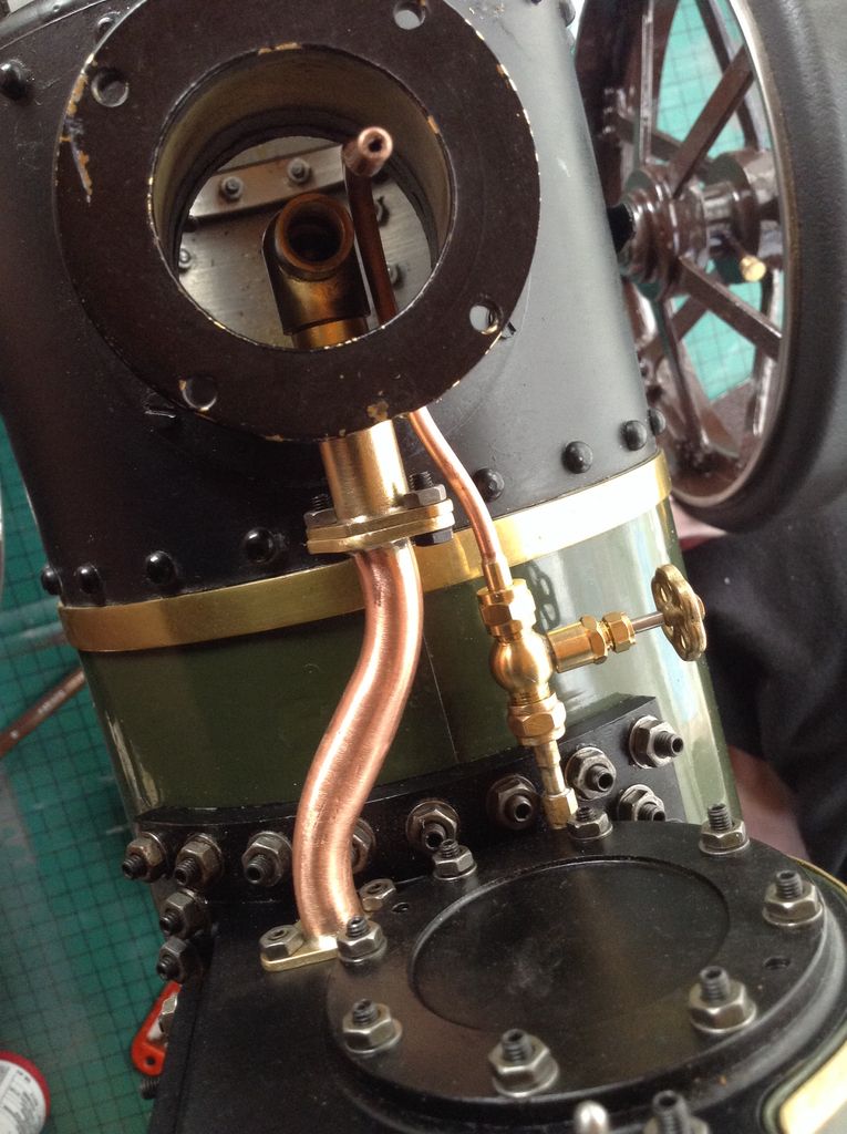

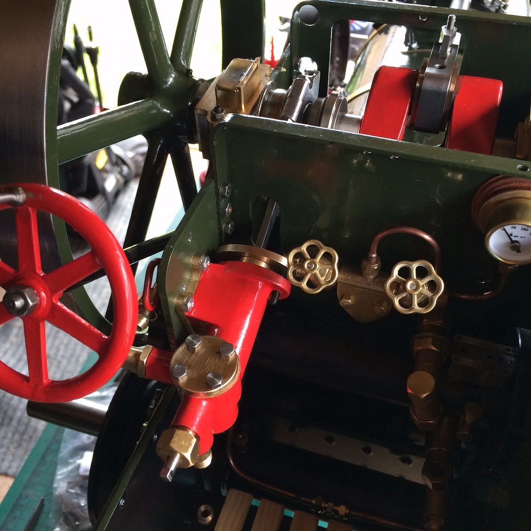

Post  Crazy_jim on Fri 02 Sep 2016, 6:01 pm
Chaps I'm in need of assistance once again. Does anyone know what thread size the studs are shown in the picture below. I seem to have mislaid some of the nuts (or the kids have eaten them). I ordered a slack handful from eBay, I thought they were M3 but they are too big. Defo not M2 as that's way too small. I checked it with thread gauges and could have sworn it was M3 (might have been a bit tipsy and it was dark your honour!)
Any suggestions?
NB: I'm referring to the studs holding on the valve and plumbing.

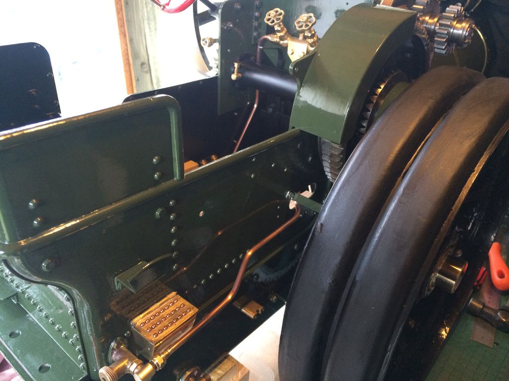

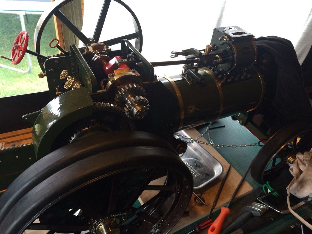

Post  Crazy_jim on Fri 02 Sep 2016, 6:07 pm

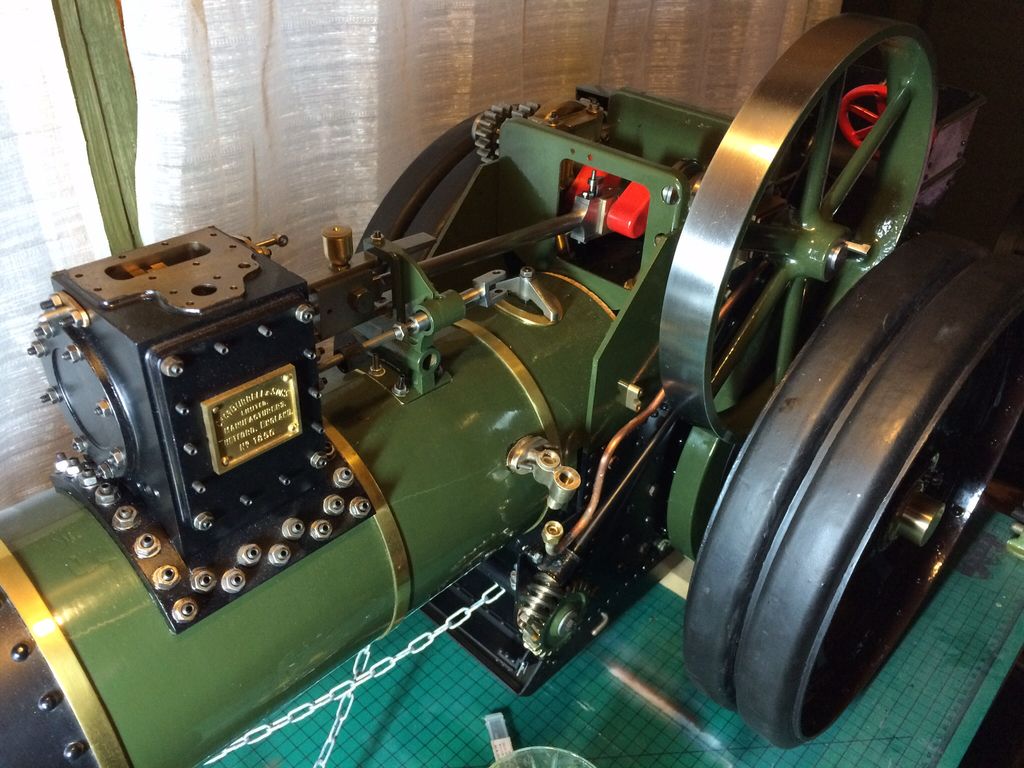

In other news here is some photos of the work I've done up to date. Pump ram sanded a little and now snug inside the water pump housing. Everything inow turns over nice and smooth with a flick of the flywheel. Happy days.

Post  Mike King on Fri 02 Sep 2016, 6:09 pm
Hi Jim,
Ive just threaded M3 nuts on those studs.
