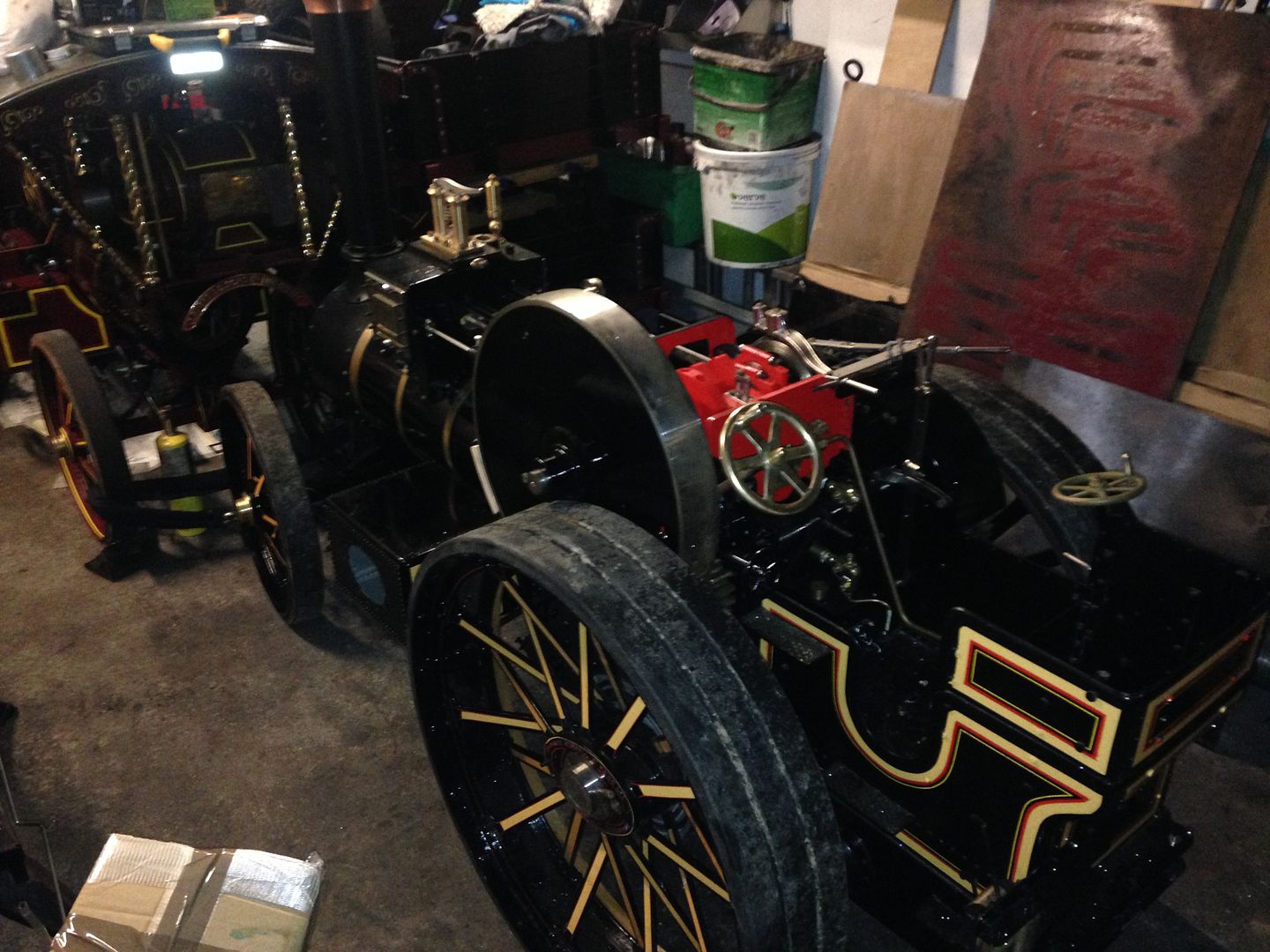

Post  Road loco on Mon 29 Dec 2014, 9:28 pm
Managed to fit cladding and belly tank, starting to look like a engine now Very Happy
