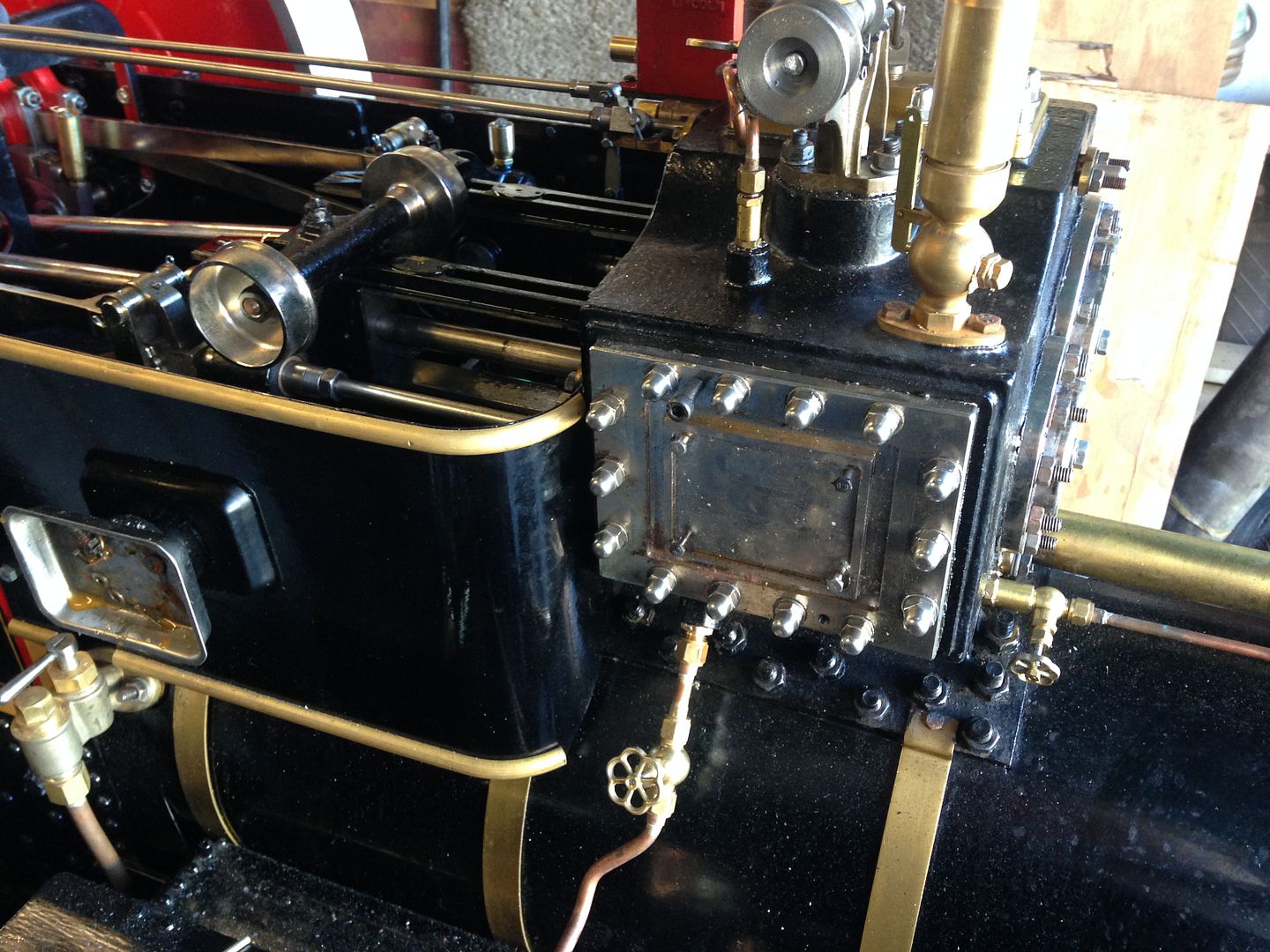

Got some work done.

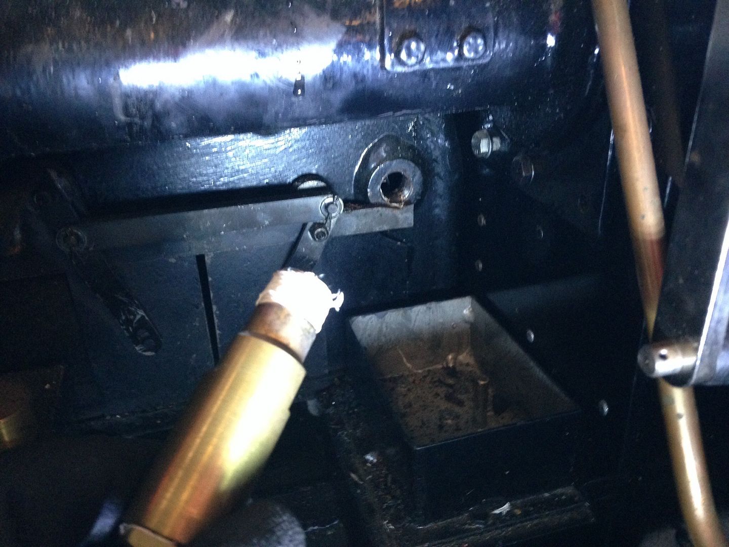

Had a steam leak from around the sight glass area. Upon inspection, someone forgot to thread seal the boiler end of the extension tube.
Why I always take the valve covers off after each test steam.

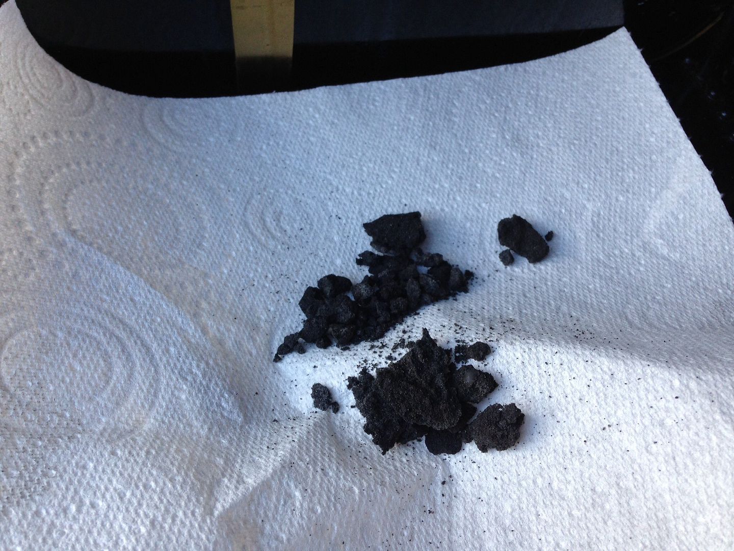

Casting sand.

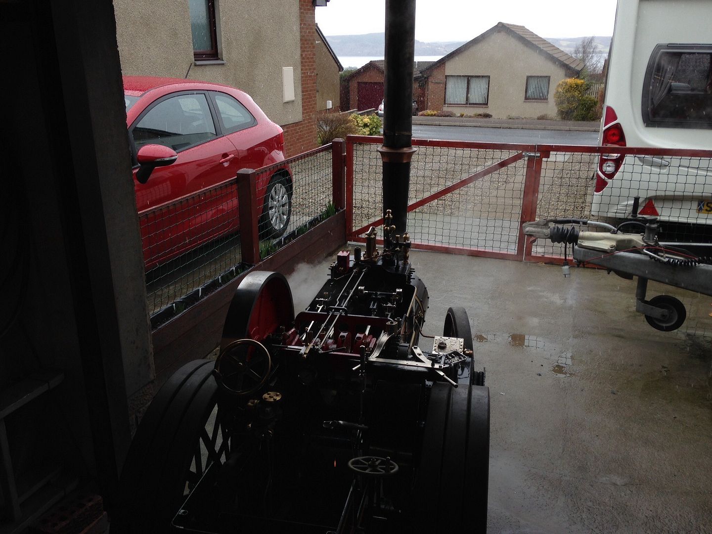

Then It started to snow.
So drop the fire and clear out the pressure.
Very atmospheric.

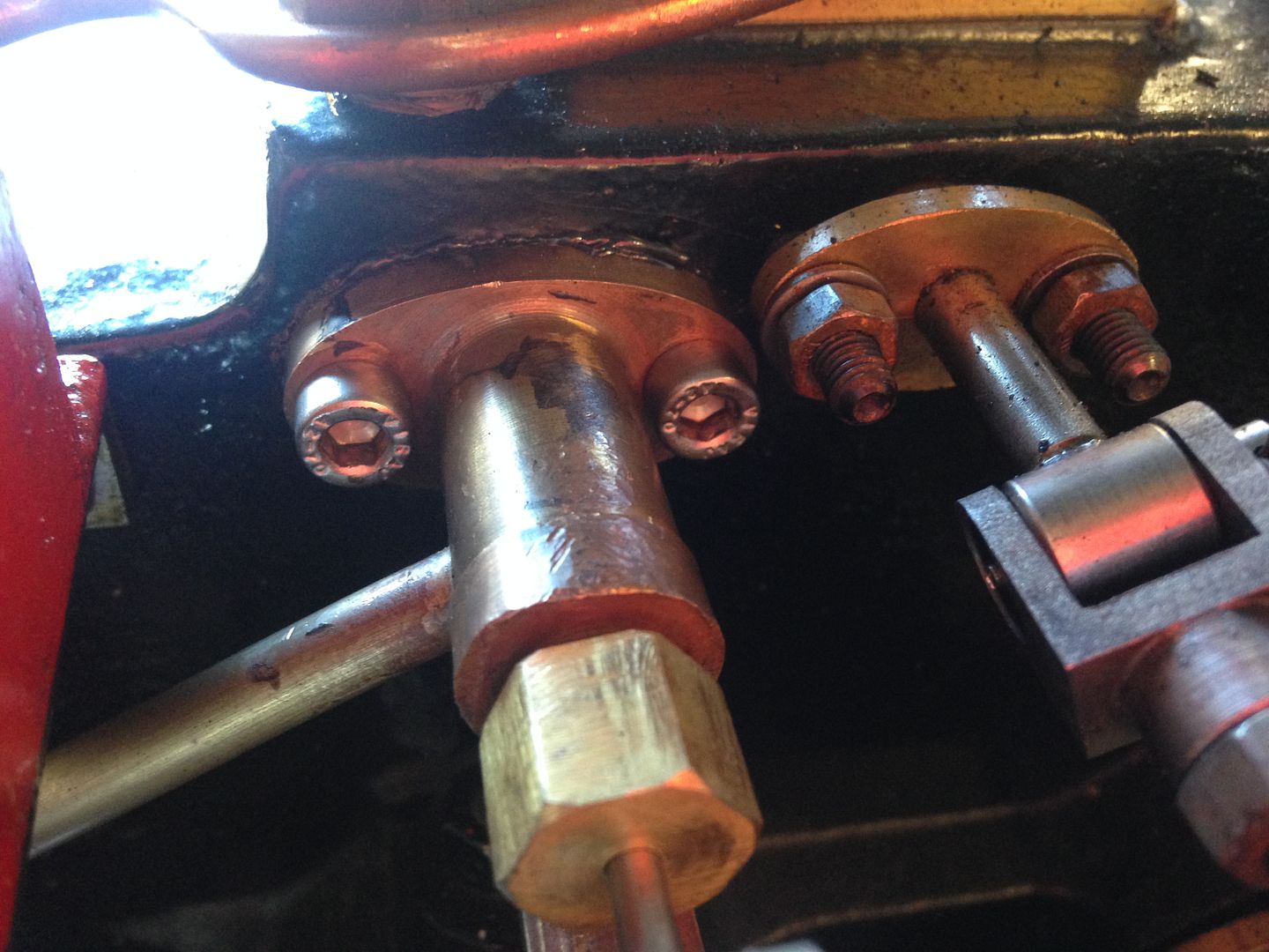

Post  lynnr on Mon 07 Mar 2016, 11:29 am
Steady progress.
HP side buttoned up as satisfied with the valve slide and regulator.

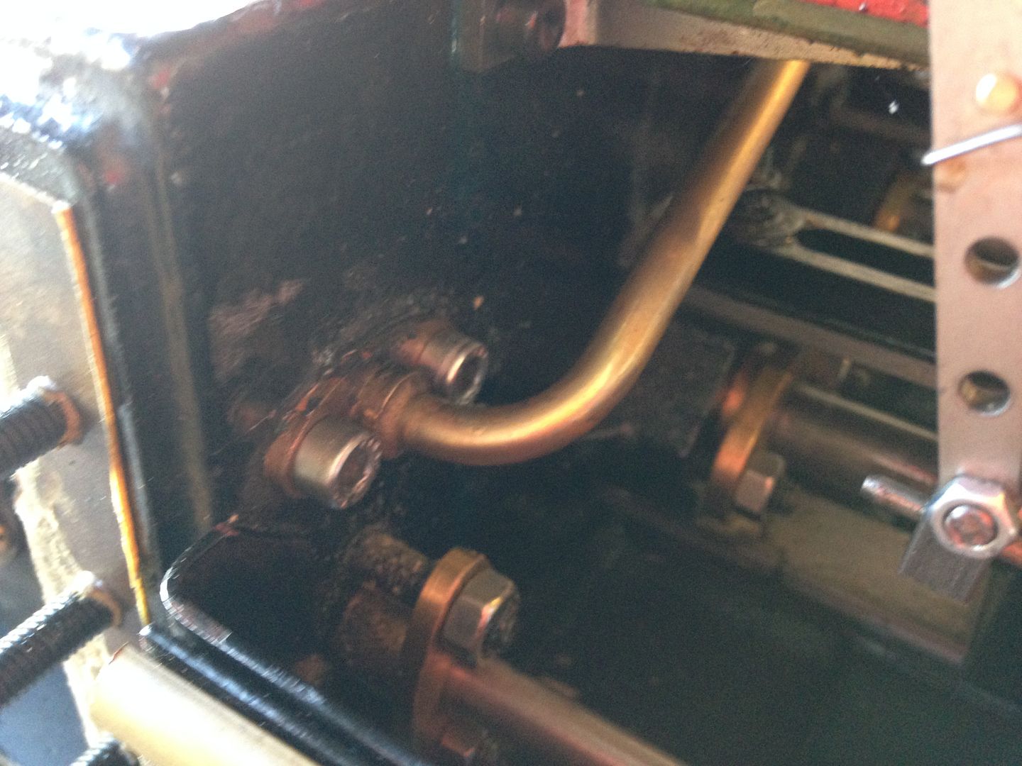

Took the starter valve apart again and smacked the ball again. Much deeper and even seat now. Also stretched the spring a bit.
Refitted with Alan bolts instead of hex. Seconds to fit instead lots of minutes!
LP side still off to test the starter valve again and now the HP back on. Hopefully get a nice blast through the cross passage and make sure it is all cleared out.

Post  lynnr on Tue 08 Mar 2016, 12:35 pm
More remedial work done and another steam testing.
Checking HP timing and the steam cross passage. Also checking the starter valve. Found the problem with it. The reach rod was .5mm too long. So removed and an extra bit of threading done and presto fully functional.
Then button up the LP side and she is running quite well.
Couple problems. Mech pump ram needs a polish to remove the squeak and the mech eccentric is still fouling the timing eccentric.

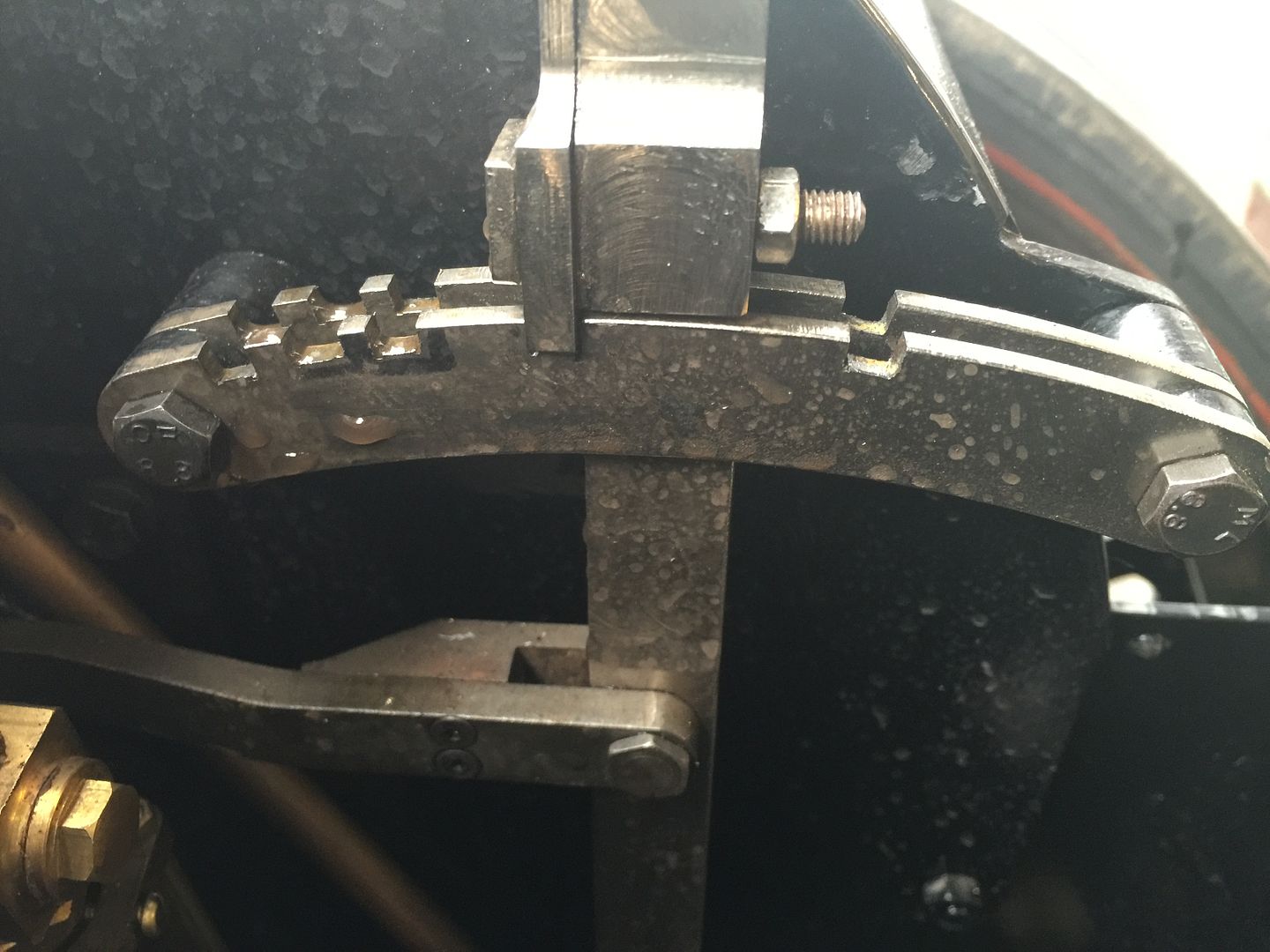

Measured the expansion quadrant wile at 180psi and cut the slots this evening.

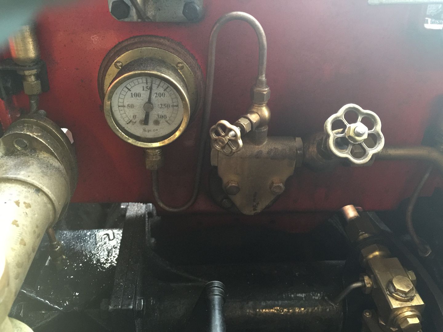

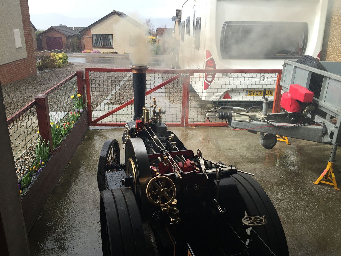

Got another test steaming in today. In steam for 6 hours and never below 150psi.
Got a few videos and a couple pictures.
The steam injector works very well indeed.
She is a bit knocky but will adjust out over time. Still running in.
Then we had a bit of a storm.
Pressure coming up nicely

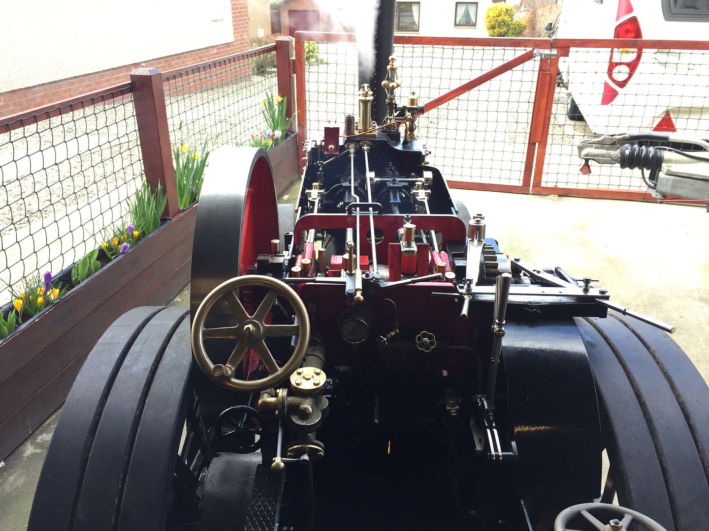

Reverser quadrant ready for action.

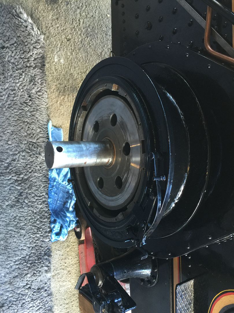

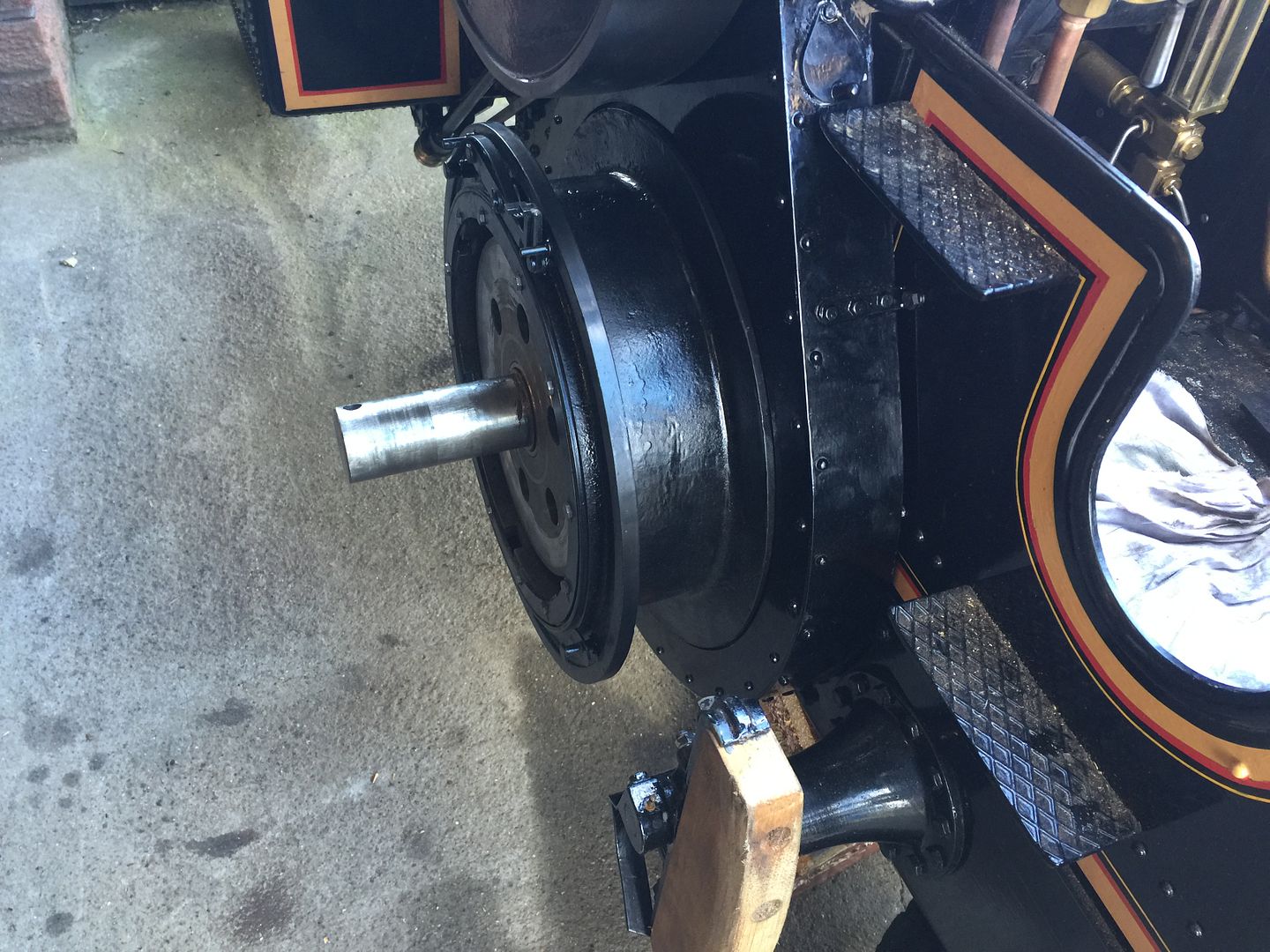

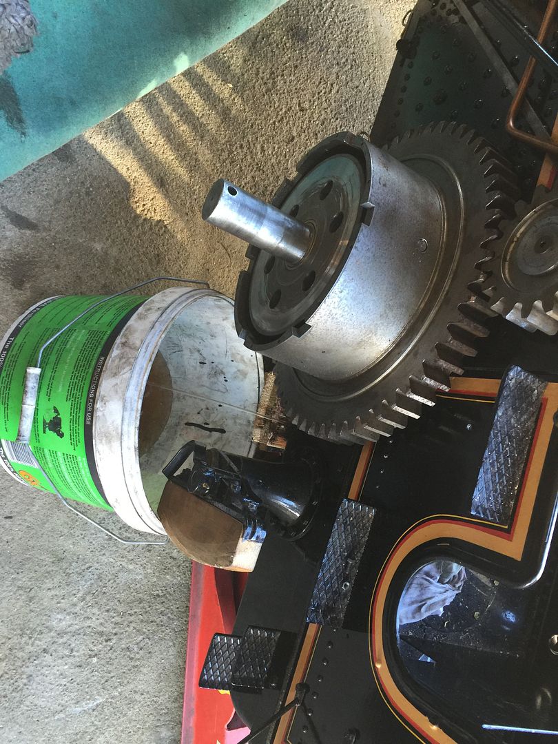

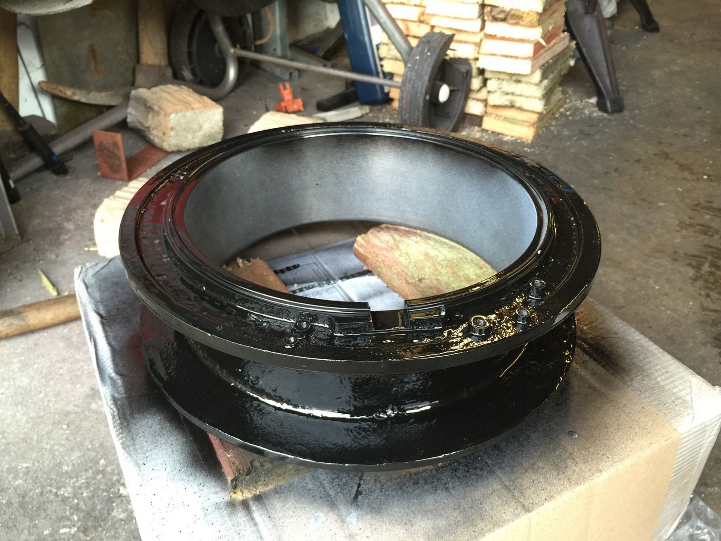

Post  lynnr on Mon 11 Apr 2016, 1:53 pm
Drum roll please.
Sorry winch drum roll please.
Spent the morning fitting the winch drum. Yesterday afternoon was fitting the drive dog assembly.
By the way. You can fit the gear guard before the winch drum as there is no interference.
So other than revisiting the sight glass. Still leaking a bit and tighten things up a bit more.
She is done.
