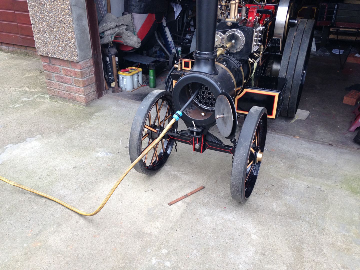

Managed to get her turned round.
"Fill her up" with Scottish premium water.
She hold water.
Unfortunately I need to go away for a few days so the steam up will have to T.B.A.

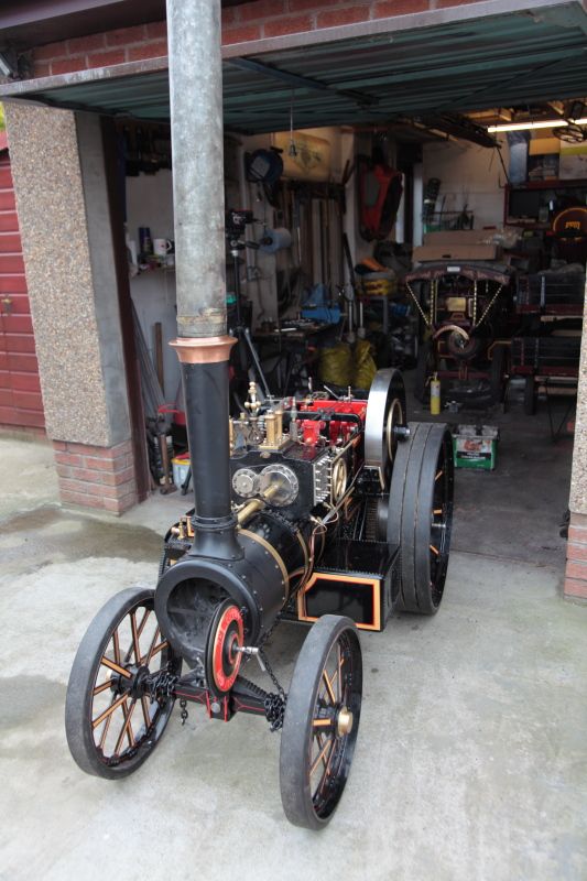

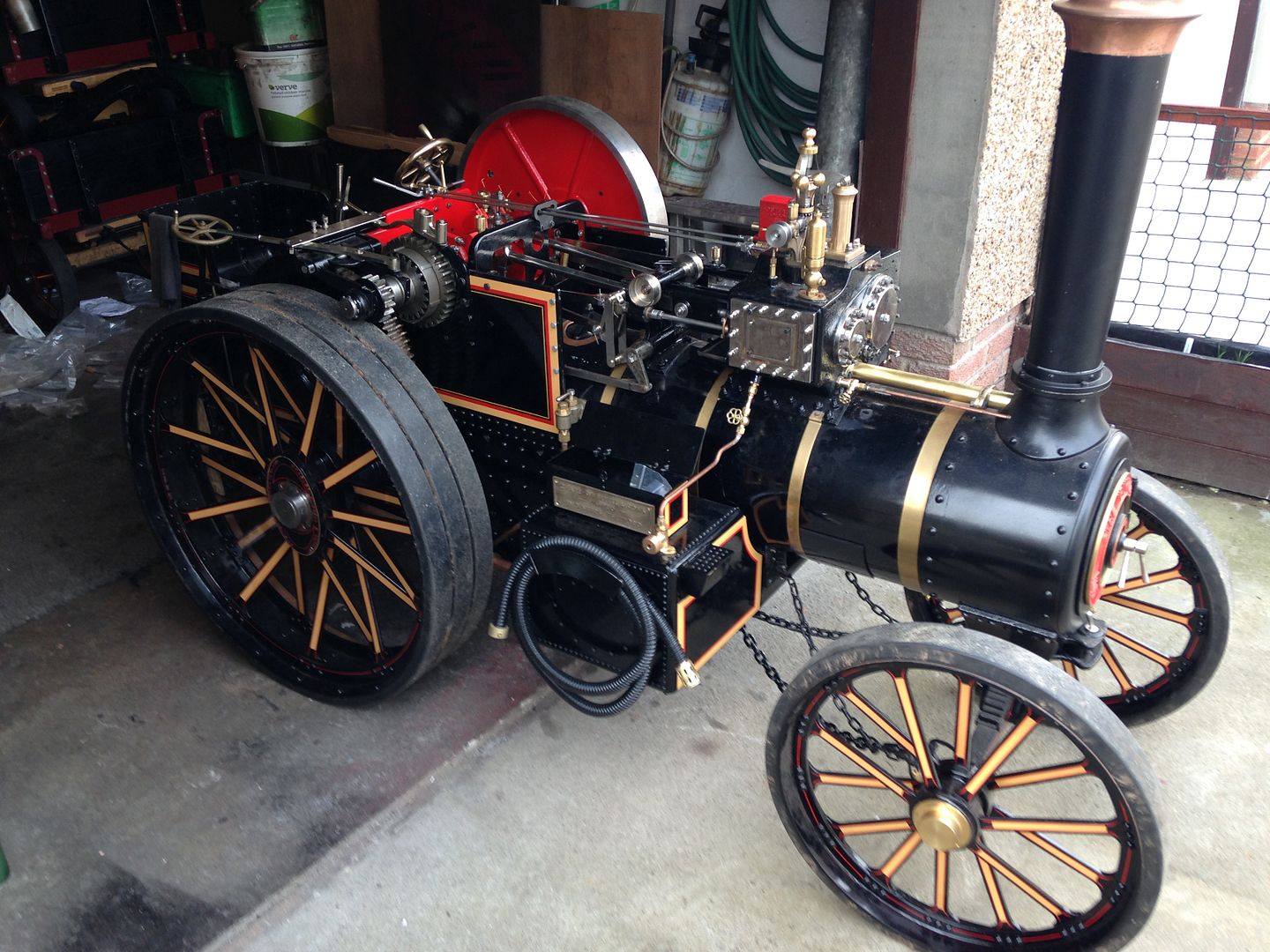

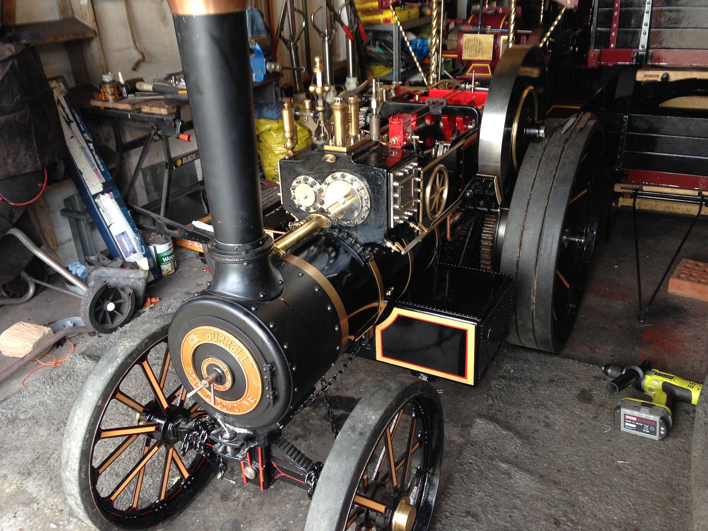

Post  lynnr on Mon 29 Feb 2016, 4:15 pm

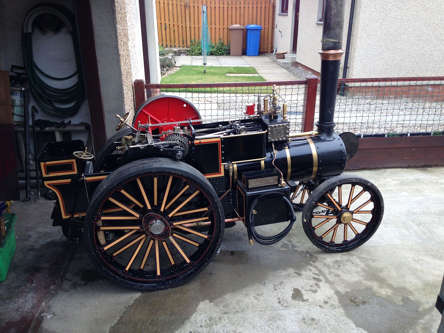

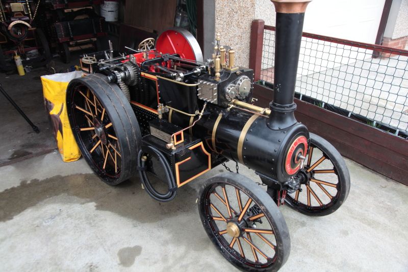

Here we go! Here we go!
Drum roll!
May I present "Priscilla" the Road Locomotive.

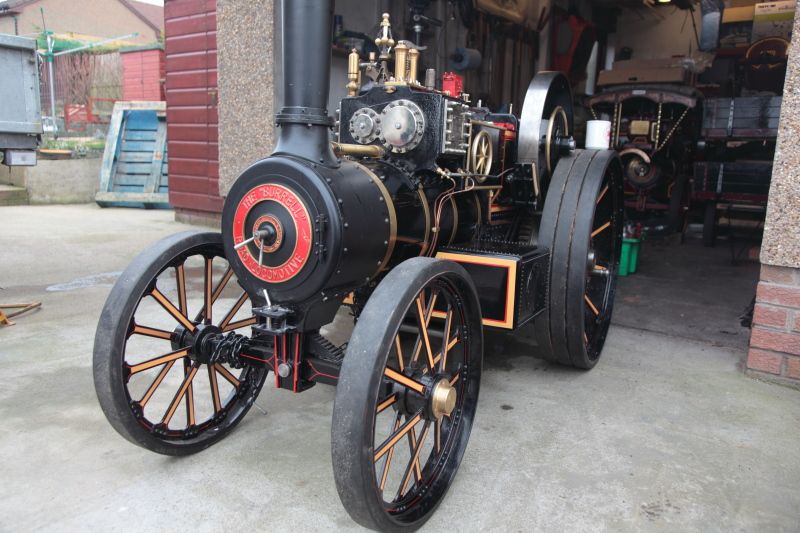

Borrowing Crystal's extension chimney

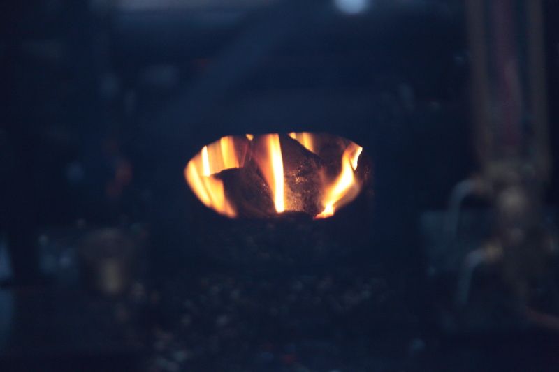

First fire

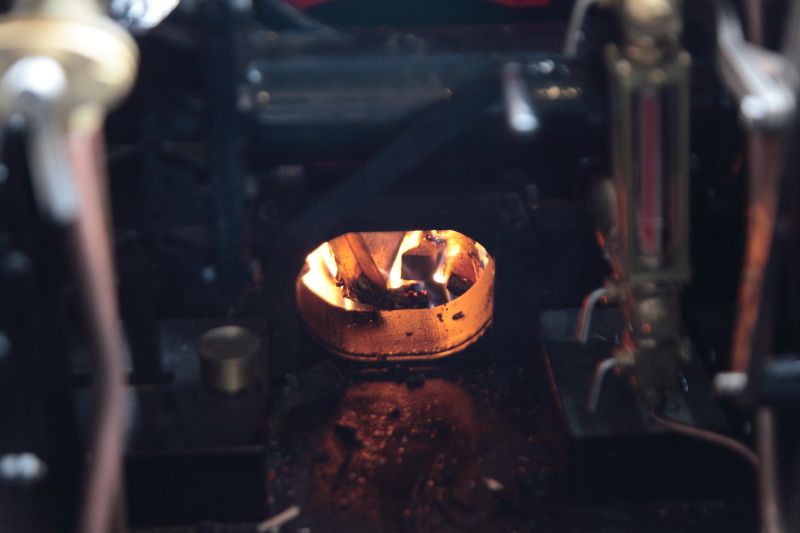

No major leaks

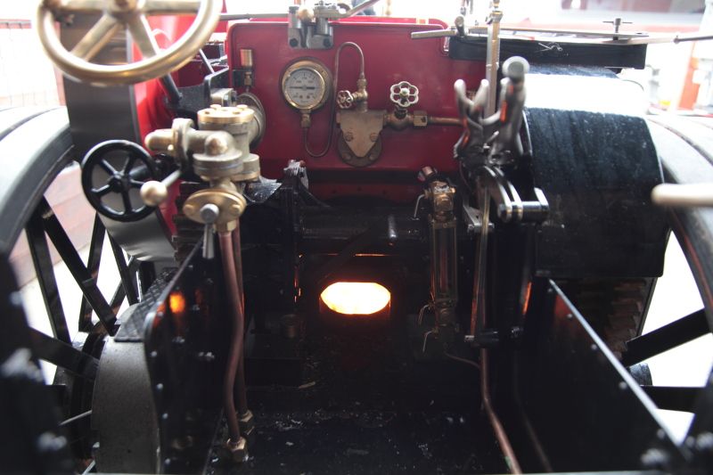

Fire going nicely

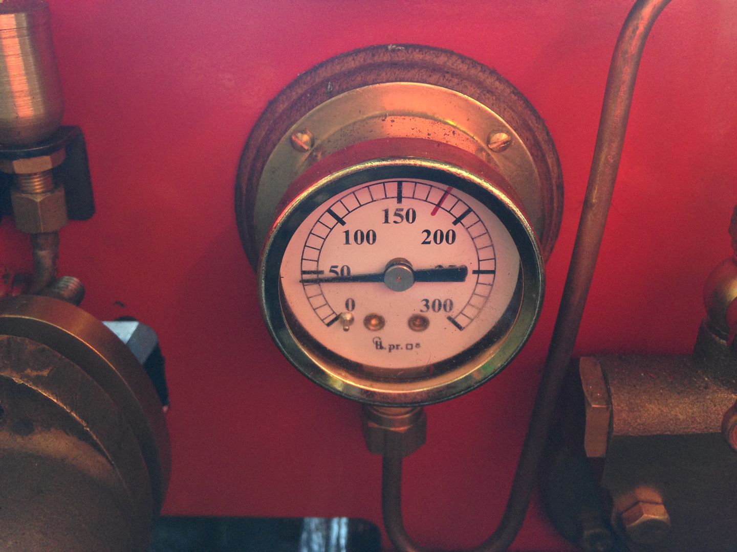

Pressure rising
Yes it is 50psi ish
I did not manage the live video streaming. Need to configure the laptop but the video will be uploaded shortly.
Blowing down after a successful 4 hours steaming

Post  Road loco on Mon 29 Feb 2016, 6:05 pm
i have been waiting alday to see that picture of a fire in her, great pictures Lynn, so happy priscilla is coming together Very Happy Very Happy Very Happy

An excellent video Lynn, better than the stuff on tv, there were only a few small leaks which is to be expected, was the by-pass valve passing steam, it seem as if it was, i noticed that you were trying to get it seal a number of times.

Post  lynnr on Thu 03 Mar 2016, 7:49 pm
Hi Everyone
I hope to get out to Crystal's bedroom tomorrow to continue working on the road loco. IF my knee behaves overnight.
The plan, if the weather also co operates, is to remove the valve covers. Steam the engine to get nice and hot all over and set mid and end points on the reverser quadrant. Also test the tightness of the regulator and starting valve. Put the HP cover back on and run single for testing. Then put LP on and test further. Having LP off will also confirm if the block is good or not.
Oh also need to take the backs of the LP eccentric straps and move the eccentrics over 1mm to the flywheel. Just catching the edge of the water pump eccentric. Think the crank found its home position when running the other day.
Only other thing is to remove the piston from the water pump and polish out the squeak that could be heard on the video. I think the machining left a spiral grove in the piston and its rubbing on the packing.
Otherwise with cogitation over the first light and test steam she will not take long to reach inspection ready status.
