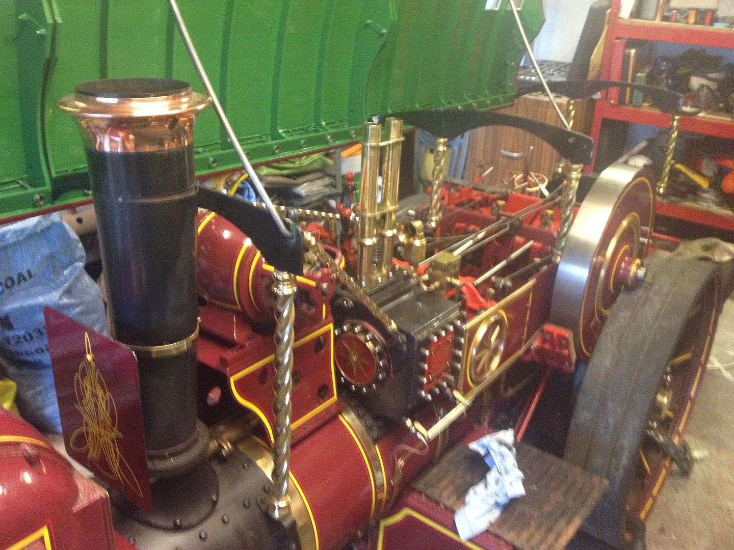

Post  lynnr on Sat 18 Jan 2014, 3:34 pm

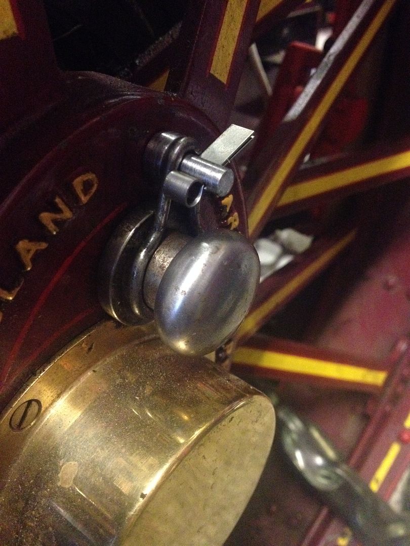

Started putting Crystal back together after her winter inspection.
Got the replacement retaining pins for the drive pins fitted.
And a view of her going back together

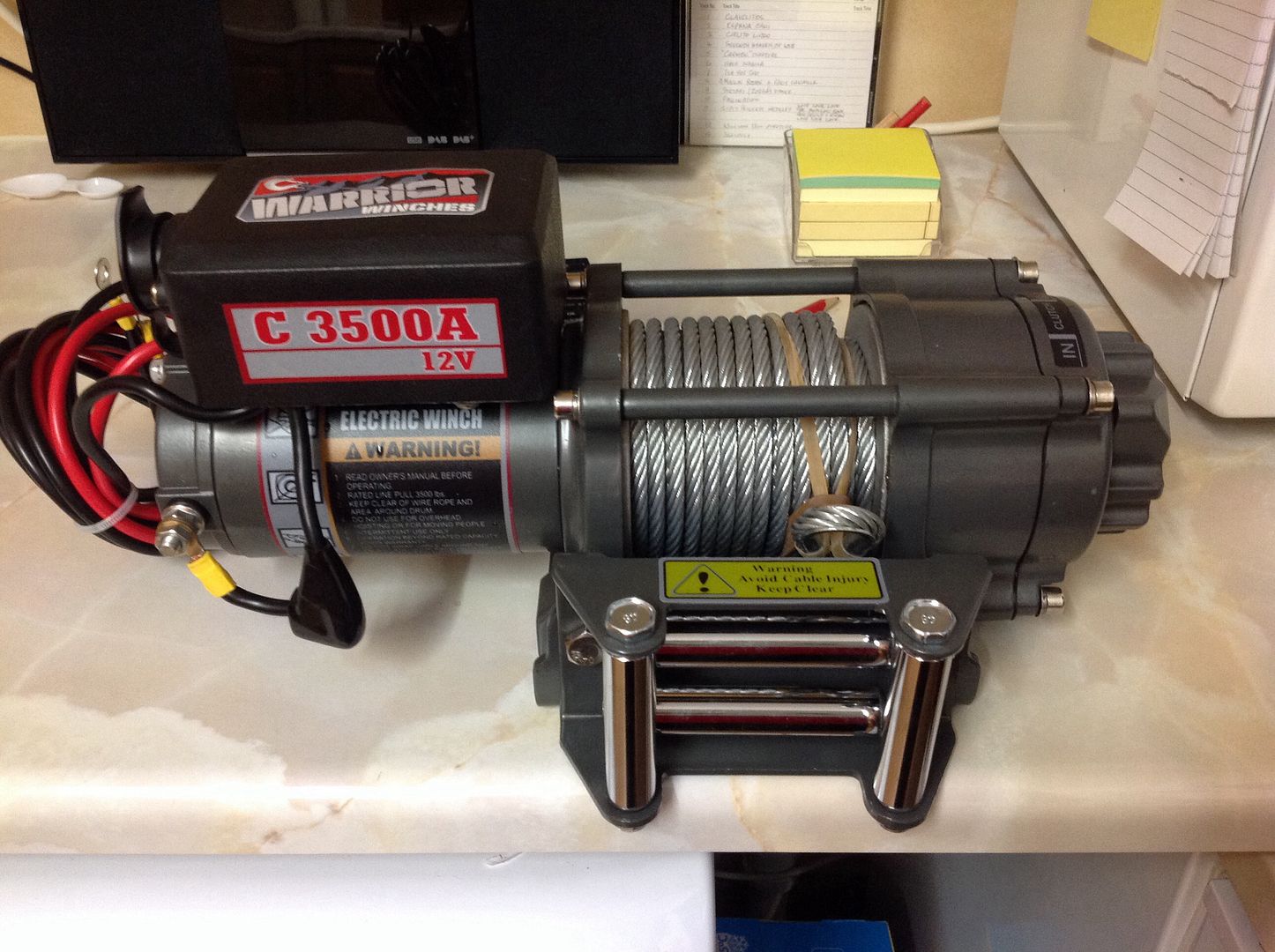

Post  lynnr on Thu 06 Feb 2014, 7:22 pm
One of Crystals new toys arrived today.
Number of posts : 2963

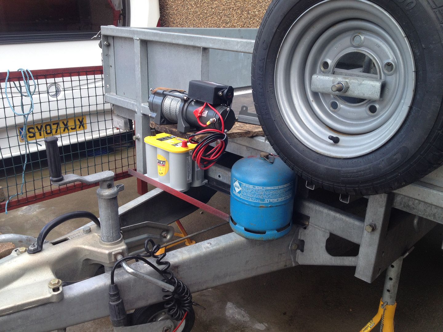

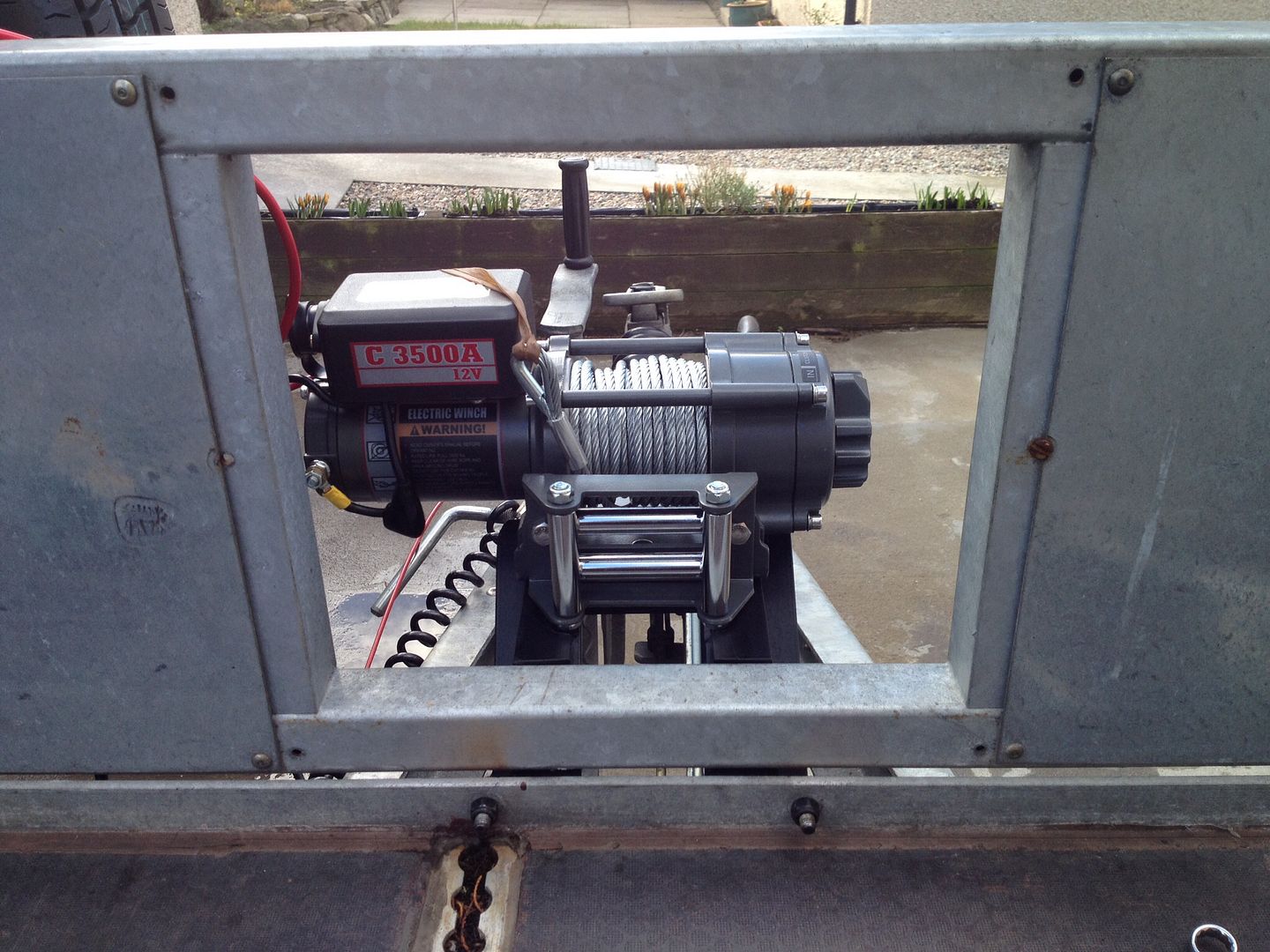

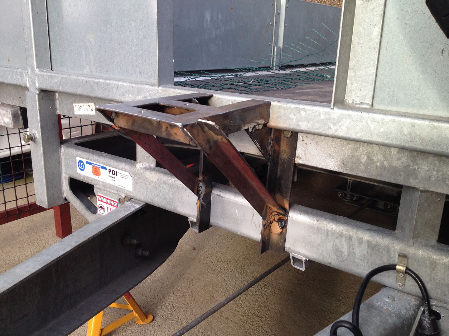

Post  lynnr on Mon 24 Feb 2014, 4:44 pm
On holiday to do my bendy truck training but get the afternoon off so been out mechanicing.
Winch mount basically finished.
Also made the battery tray but forgot to take a picture of it.

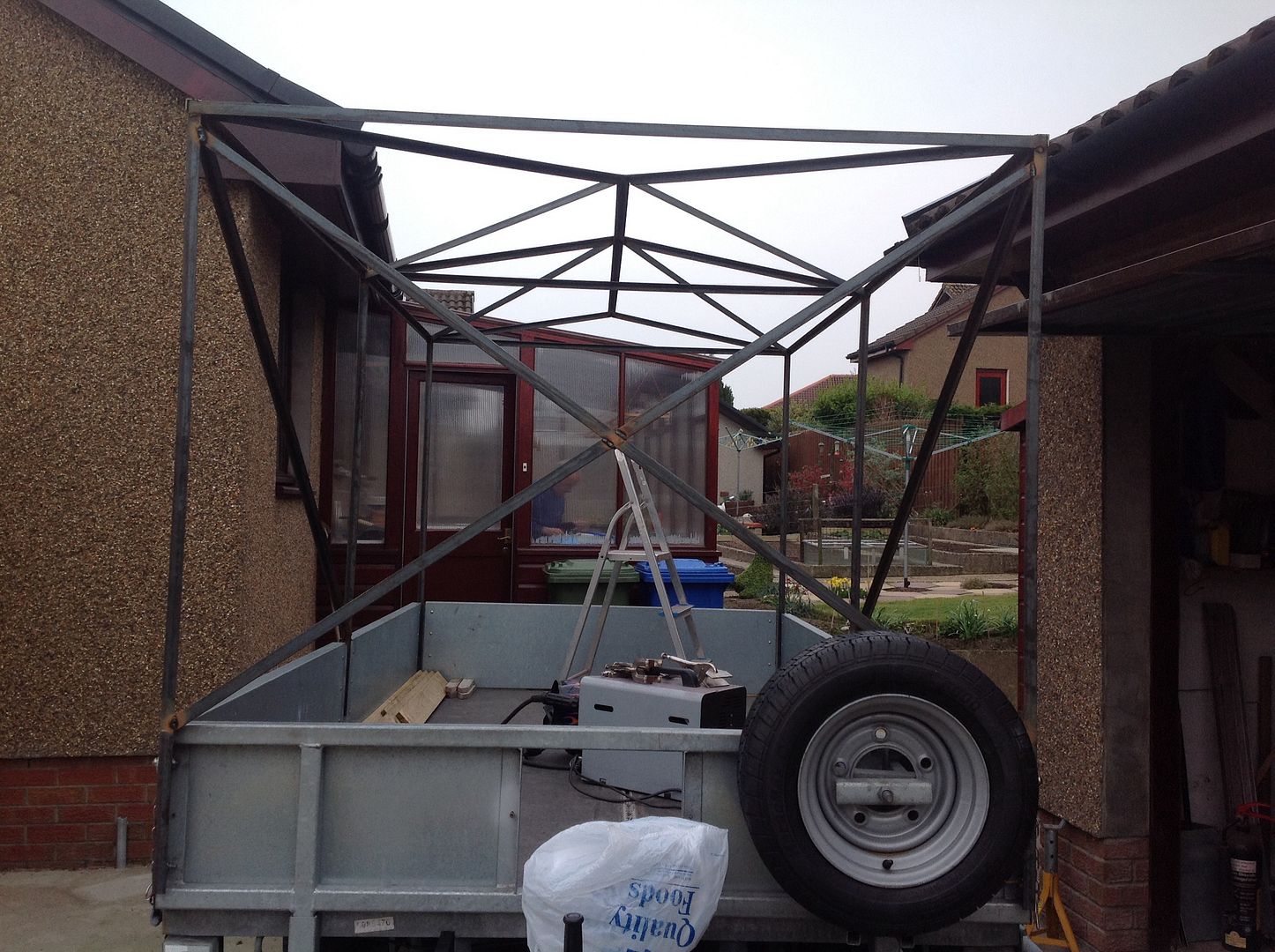

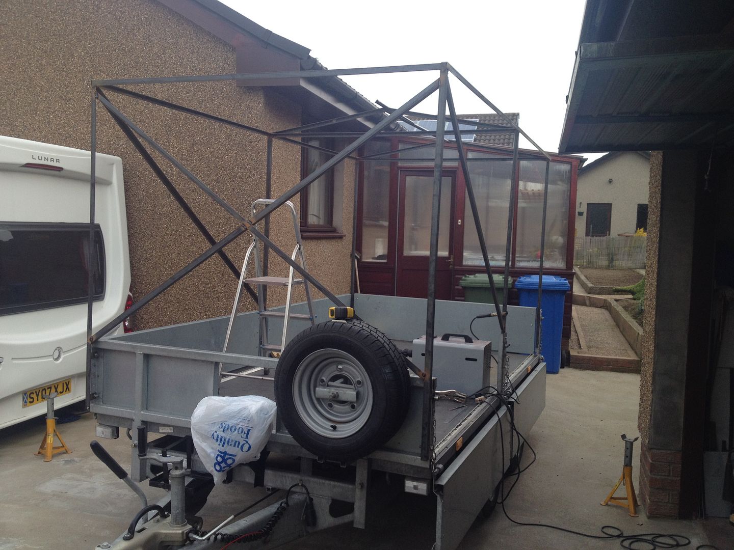

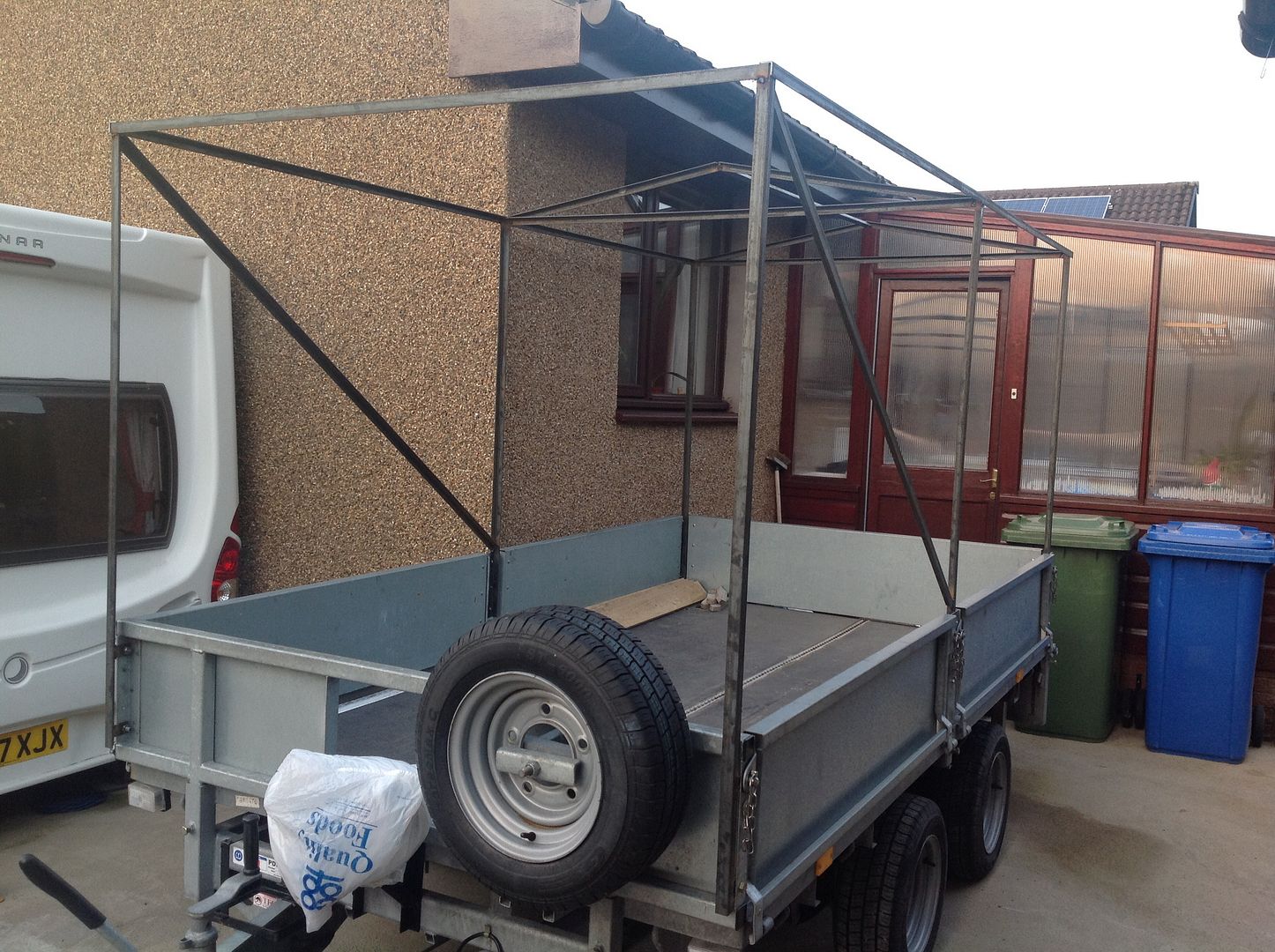

Post  lynnr on Sat 29 Mar 2014, 5:53 pm
Not the engine but her pram.
Te steel arrived a few weeks ago but the weather was very wet to say the least topped off with a strong wind.
Today was much better and I got some work done on the trailer conversions. Got most of the frame for the travel cover and trailer tent.
It's a case of weld it all together. Make splice brackets and cut the frame up to allow dismantlement.

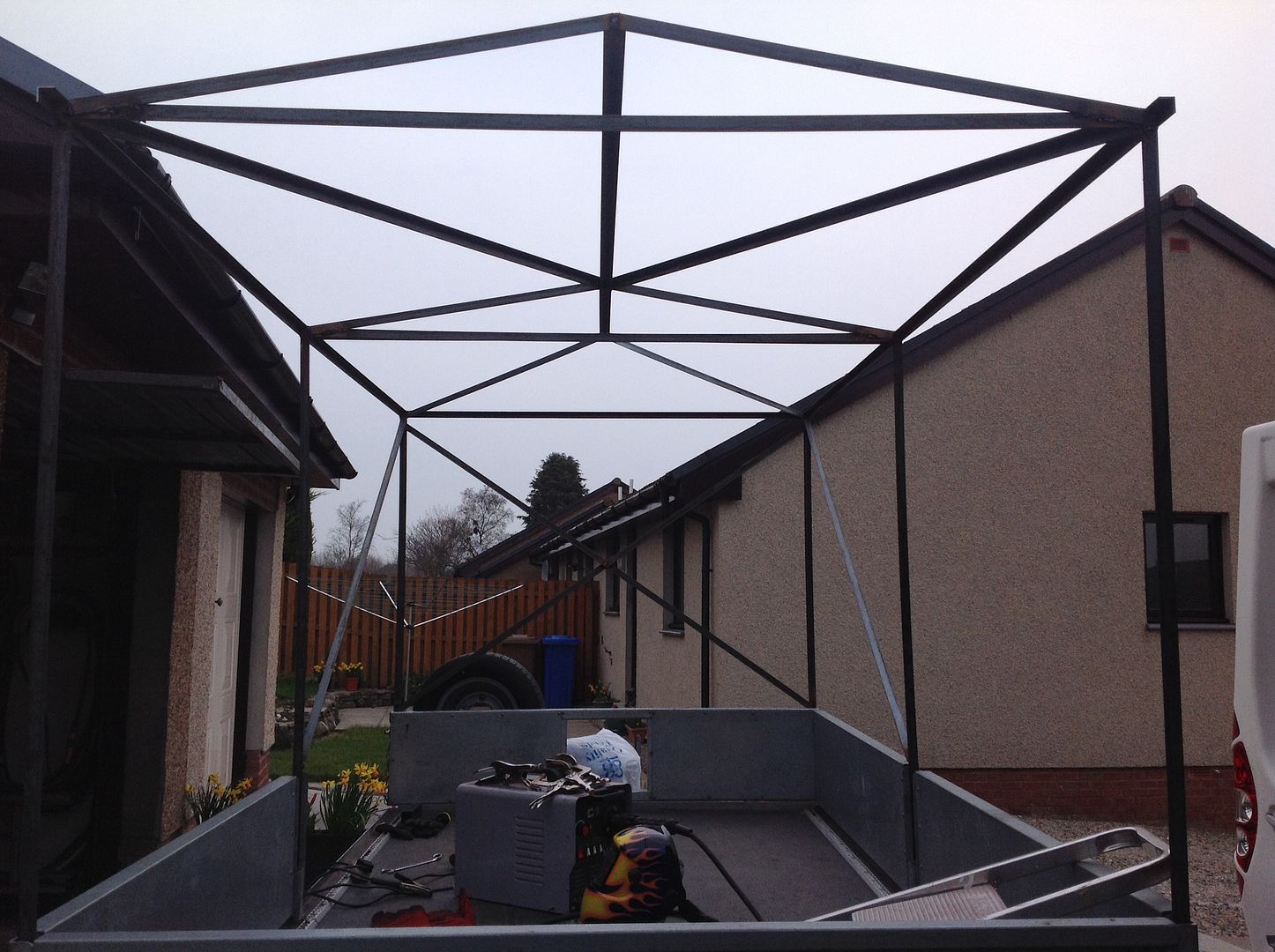

Post  lynnr on Sun 30 Mar 2014, 11:12 am
Excellent progress. Did some quiet welding this morning to keep the peace.
Almost finished building ready to cut up to make removable.
Post  lynnr on Sun 30 Mar 2014, 3:53 pm
More excellent progress today.
The frame is now complete. Just to cut it up now and fit the joints, clean up the welds and finish any welds that are not so good.

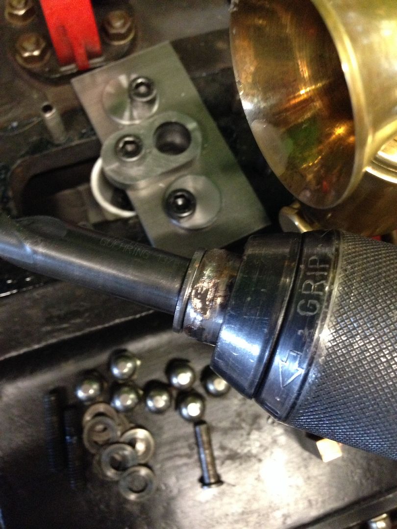

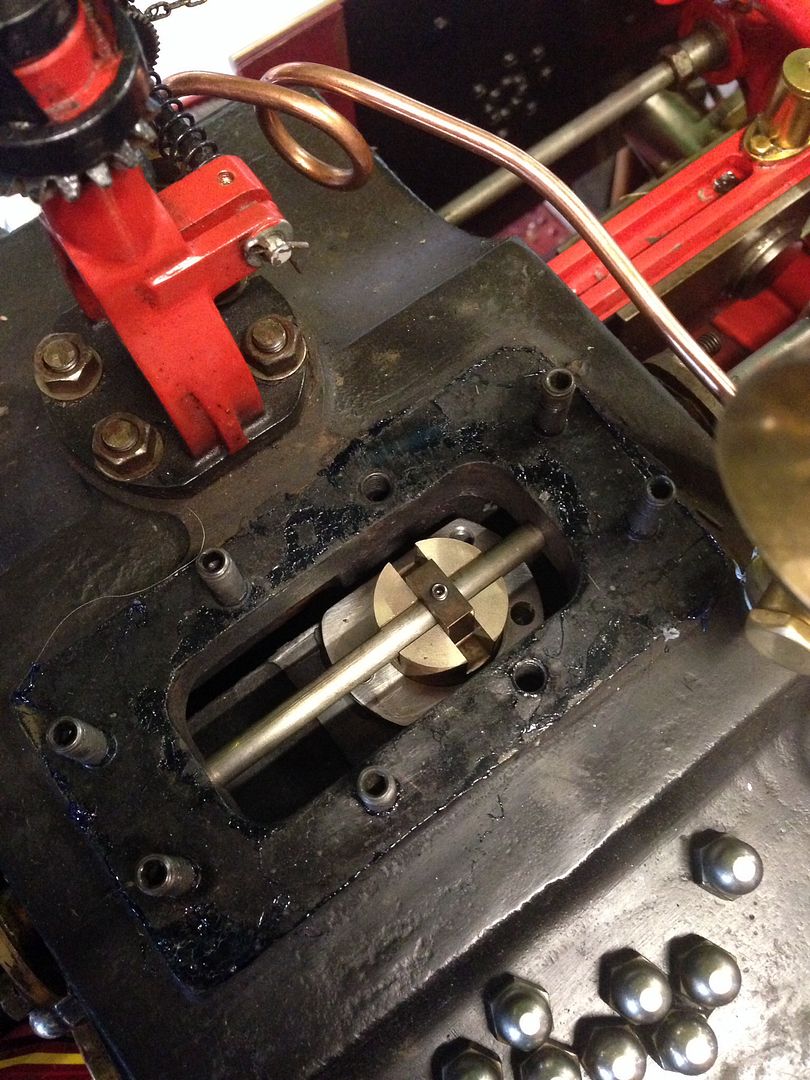

Post  lynnr on Sat 10 May 2014, 12:39 pm
Hi everyone.
Good news. Good news!

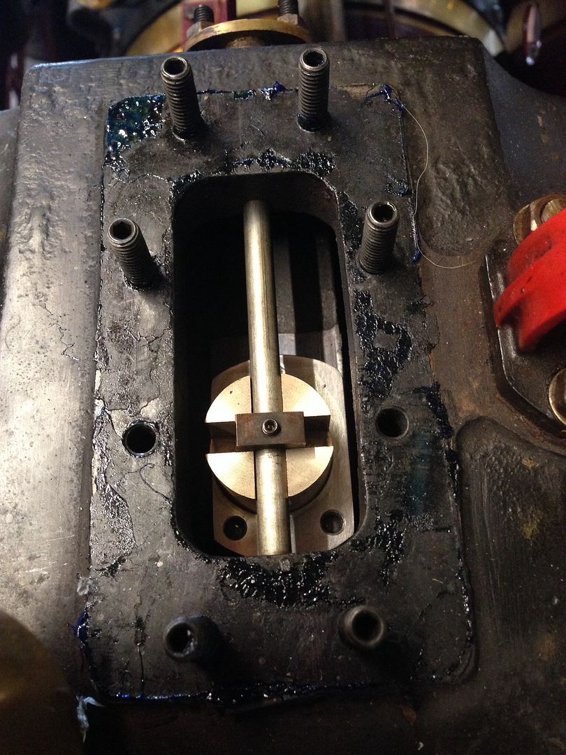

Regulator modification installed. Waiting for JB weld to cure off for a test steam.

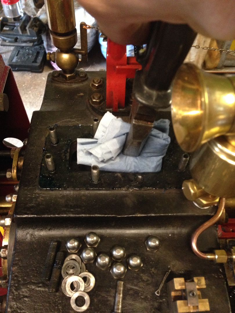

Jig installed as per instructions.
Drill ready in the jig
Watch your chuck on the bolt.
Oops.
Gone fishing

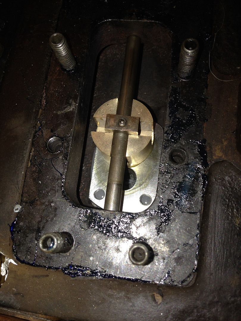

Swab please nurse. Get everything degreased.
Plate fitted with JB weld underneath
New puck installed after flattening. Spent 3 hours on 400grit wet n dry. It got to the point where the slightest smear of water held the two parts together.
Regulator in the open position.
The opening is good. She had plenty power before with the two stage setup. Now she will have lots more.
Once the test steam is done, no later than tomorrow and after reporting back to Steam Traction World. The kit will be released.
When you get the kit. Please do quickly so the jig can be passed on to the next in line.

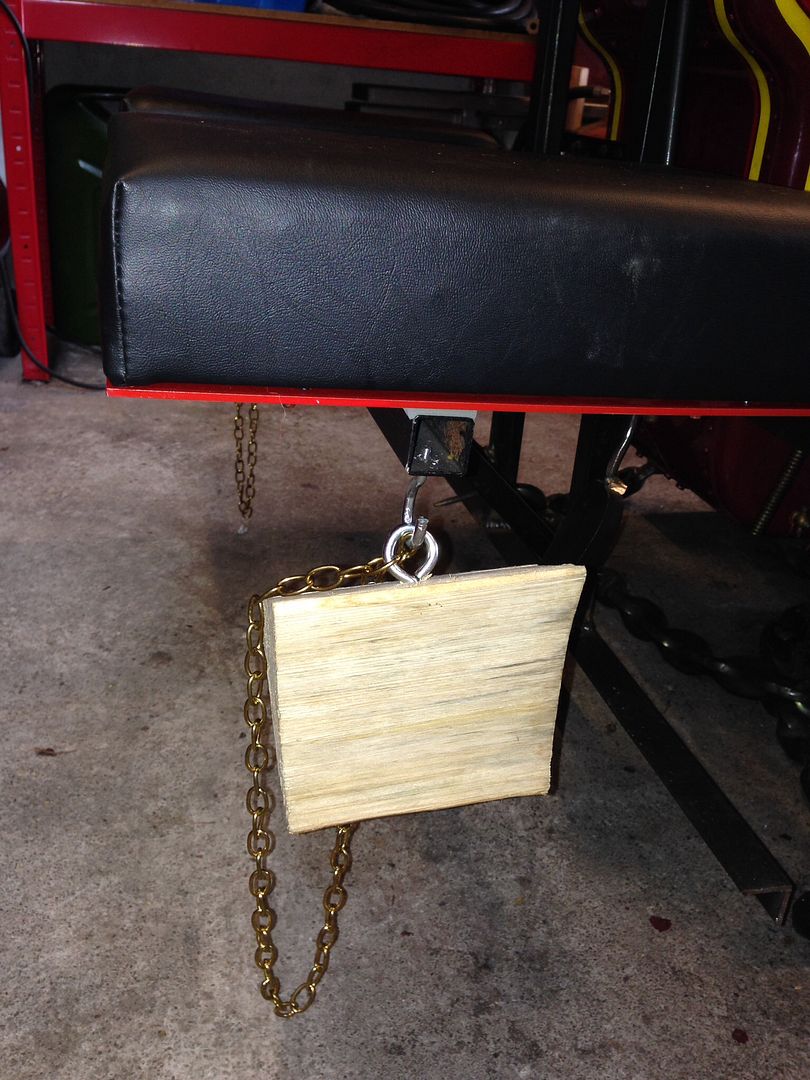

Post  lynnr on Sat 10 May 2014, 12:41 pm
Chocks away

Post  Tony King on Sat 10 May 2014, 1:41 pm
Excellent post Lynn, look forward to seeing how you get on with the mod when in steam!
Are there going to be any fixings other than JB Weld to hold plate in position?
Post  lynnr on Sat 10 May 2014, 3:34 pm
Hi Tony
There is a coller on the underside which engages with the steam port. So no movement possible.
Crystals pram winch wired up. Still to test at an event before cutting wires and fixing fully
Snatch block used to allow correct spooling with the offset caused when loading Crystal.
