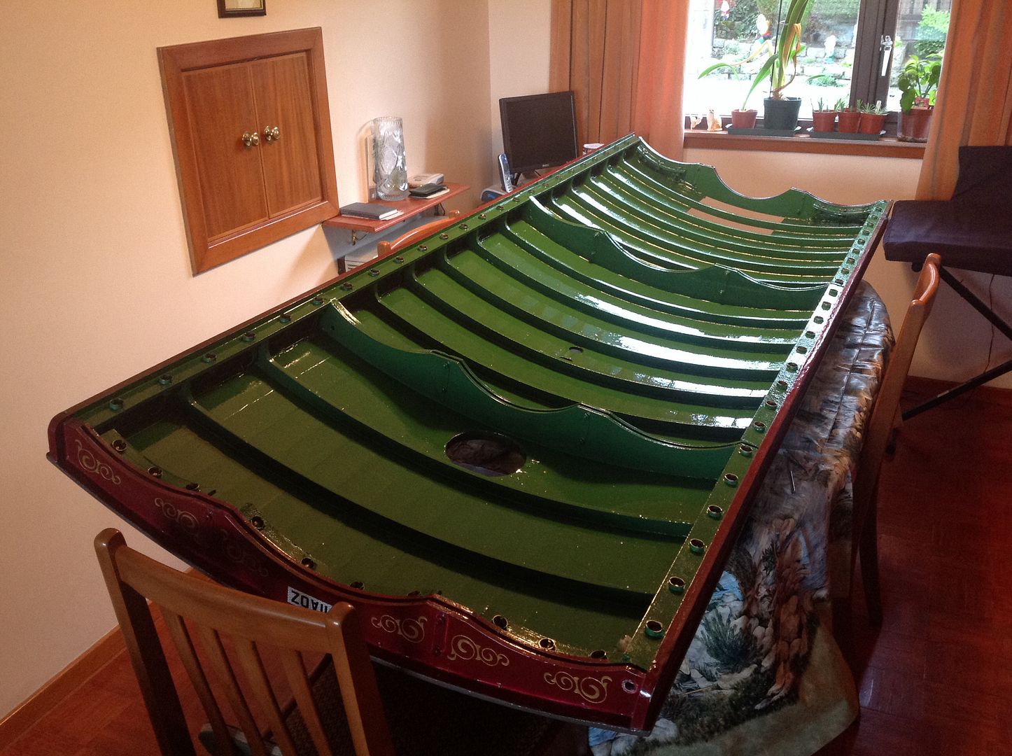

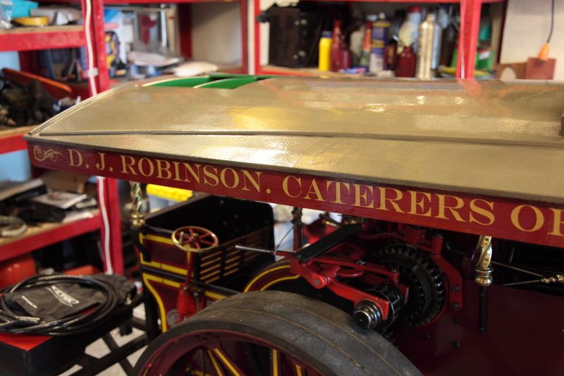

Well folks. That's the Burrell Green finished on the canopy. Just a bit of red touch up, season battle scars. Then it's final varnishing time.

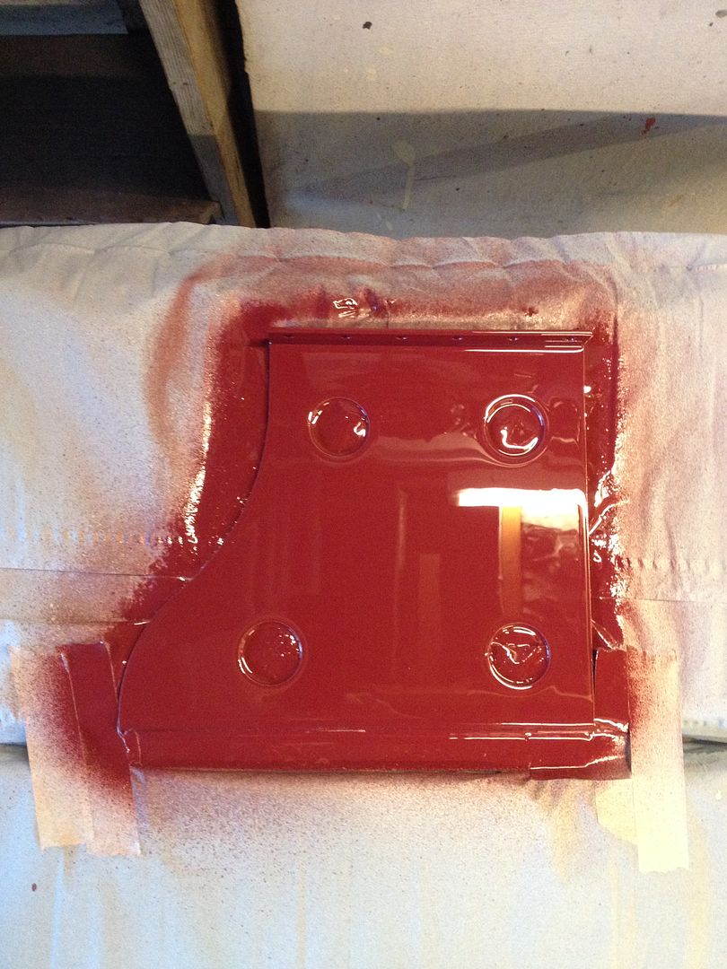

That's the exciter platform side stripped ready to repainting.

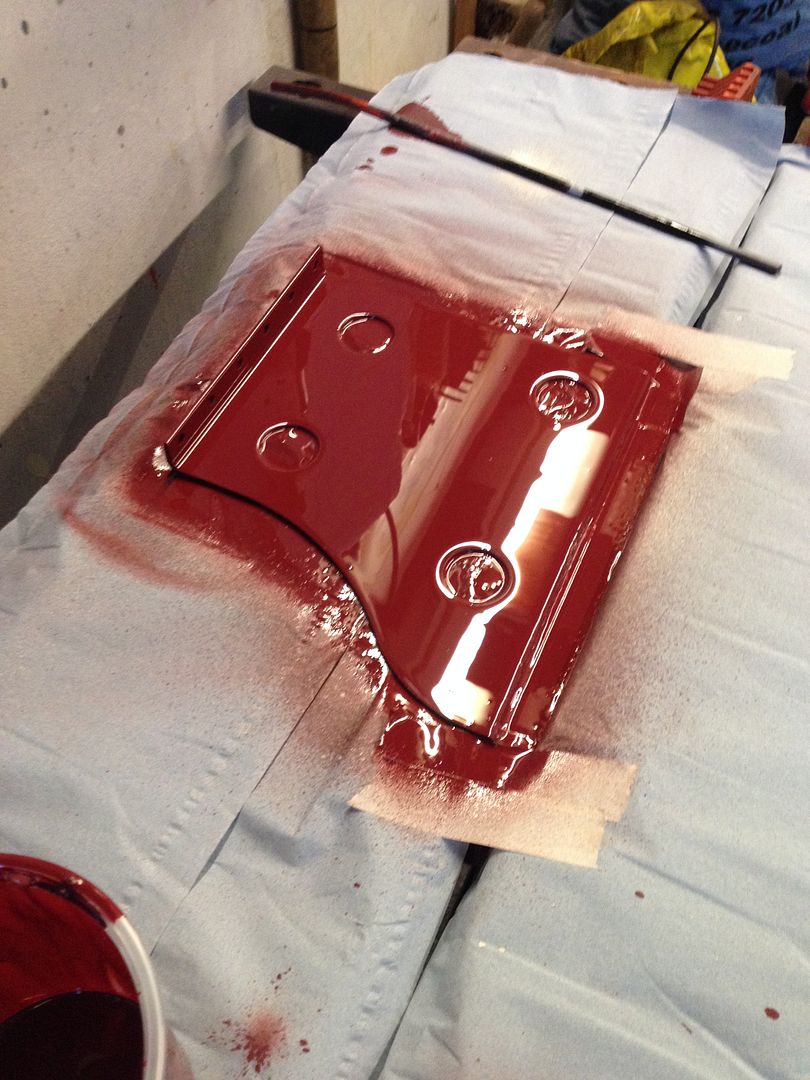

Now to repainting. Primer on.
I thought using the workmate to hold the piece would reduce the masking required. It works quite well.
Oh forgot. The final coat of varnish is on the roof.

The roof is back on. Bit of a struggle putting the bolts back in. Suggestion for everyone. Tapper the shanks of the bolts somewhat. This will make putting the bolts in easier in the very tight confines when all the light fitting are installed.
When it is a bit sunny outside I will get better pictures. Somewhat restricted in Crystal's bedroom.

Looking really good Lynn. The roof has finished it off really nicely.
Steam Traction World- Number of posts : 902
I agree, how's the exciter platform getting on....and did you do any trials of lines for the fascia / barge boards?

The exciter platform is hardening. Won't do anything to it until the weekend. May have to strip the other side as it may not be up to the new standard of paintwork. I will look at cutting the stencils Wednesday or Thursday evening in preparation.
Lining on the boards looked crowded. So not doing anything more. Possibly with a slightly smaller font size it may have worked.

Well done Lynn that roof has finished it off nicely. Looking good

I think the fonts are the right size, much smaller and they would have looked lost so it's better to leave as you say.

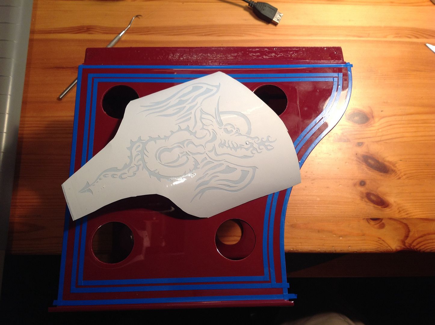

Ok back to where I was 2 months ago. Exciter platform side. Striped and repainted. Now setting out the lining and the stencil is cut ready for application. Not enough time tonight to allow drying and tape removal so will wait until tomorrow. I will stick the stencil on. Paint it and while it is drying the first coat do the edge lining. Then the second coat on the stencil. Then leave to dry for a few hours and start removing the masks.

Exciter platform times again.
Repainting the side that was ruined a couple months ago. Now got the tapes and stencil on ready for painting

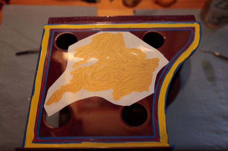

First coat of paint on the Exciter platform.
Now to let that dry off a while and do a second coat on the stencil. Need to watch the timing to remove the stencil before the edges get too hard. Otherwise you run the risk of taring the edges away from the base.

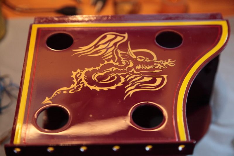

Looking good Lynn!! Glad to see someone's keeping the forum topped up with lots of photos!!
I haven't had a chance to even look at my engine for ages, I'm itching to come see you for some stencil printing work!!!
