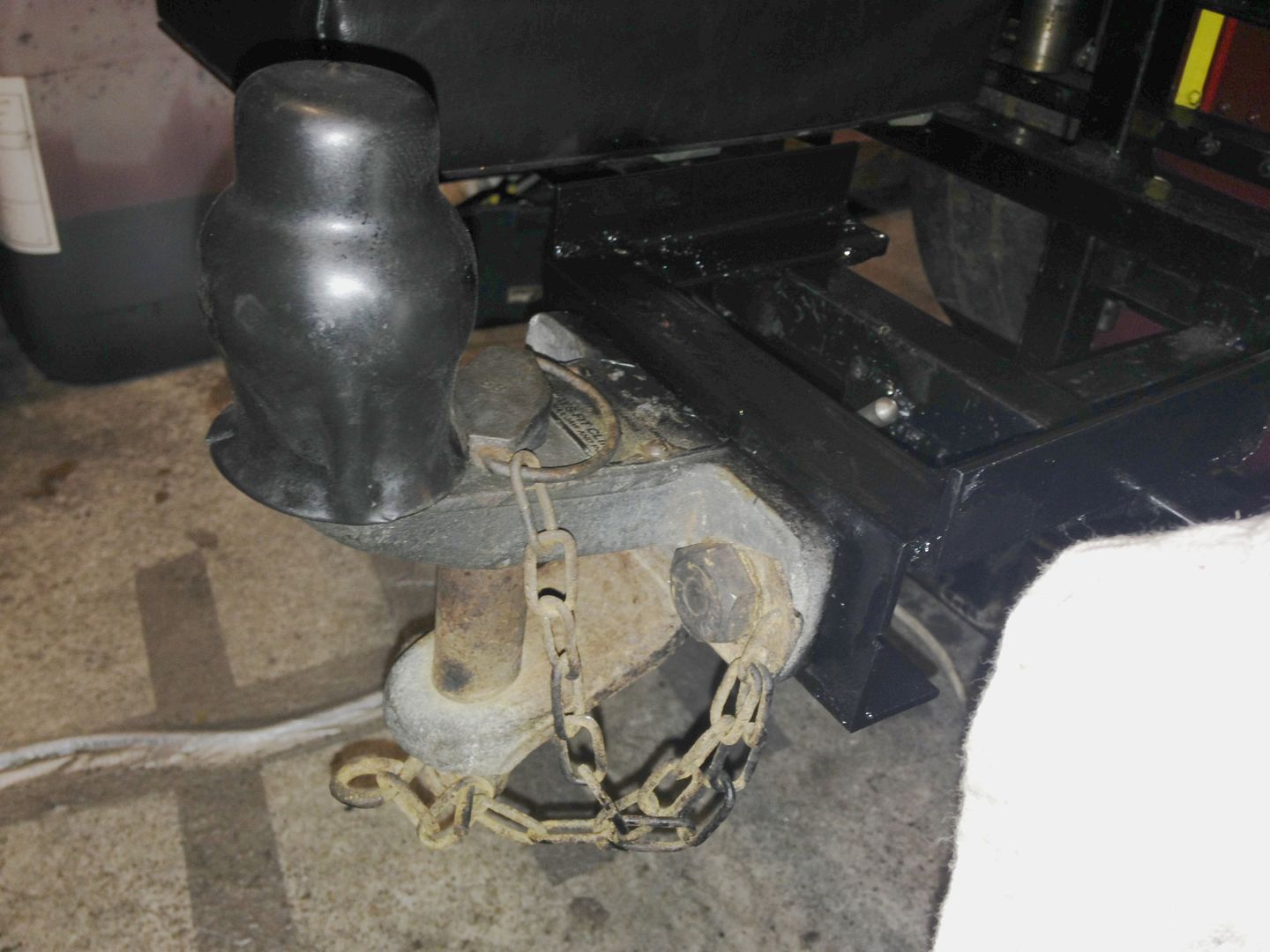

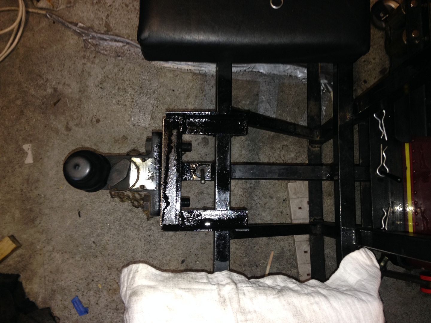

Post  lynnr on Mon 23 Nov 2015, 7:16 pm
Also made a tow ball adapter. Hopefully to be used pulling Rosemarkie's Santa sleigh on the 5th December.

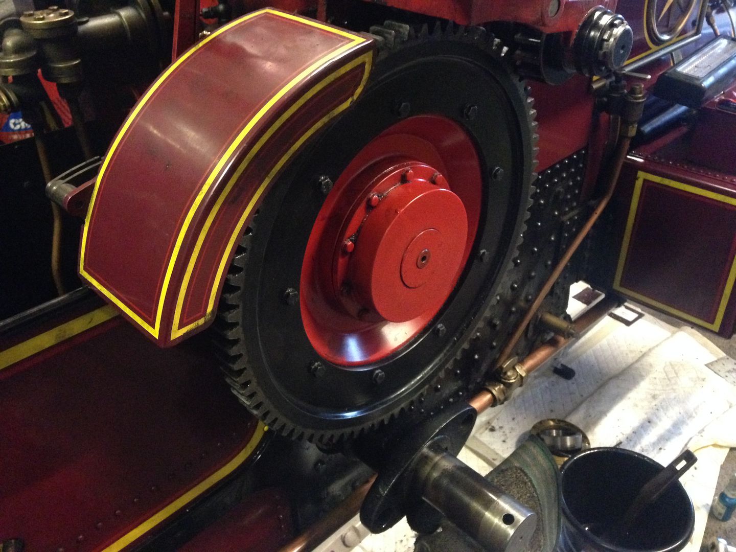

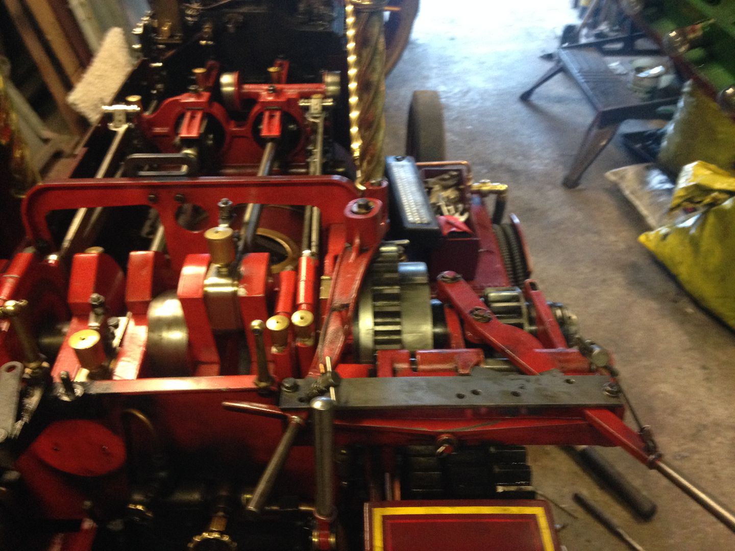

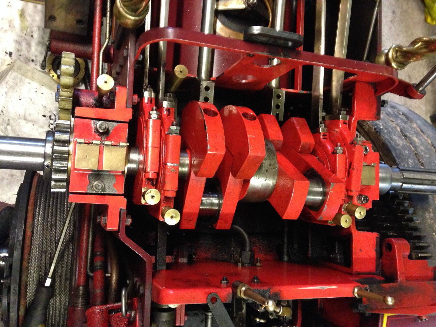

Post  lynnr on Sat 02 Jan 2016, 7:04 pm
Start of 2016. Maintenance time.
60 minutes of activity to this.
Just need to remove wheel and flywheel to extract the crank.
Number of posts : 2919

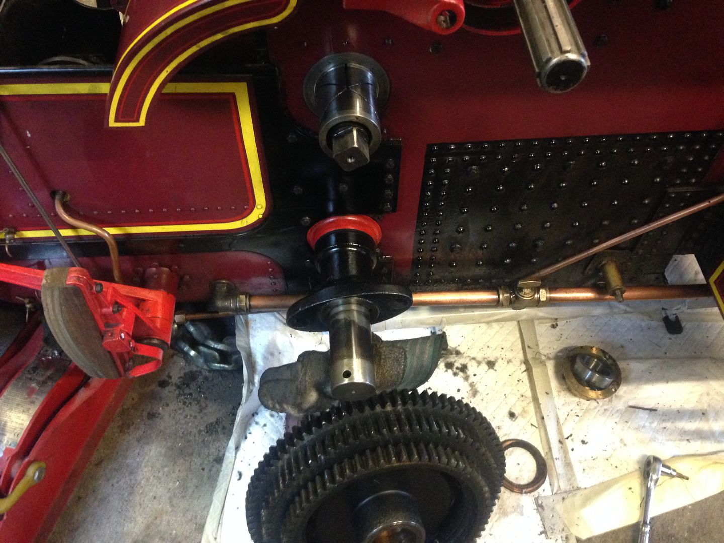

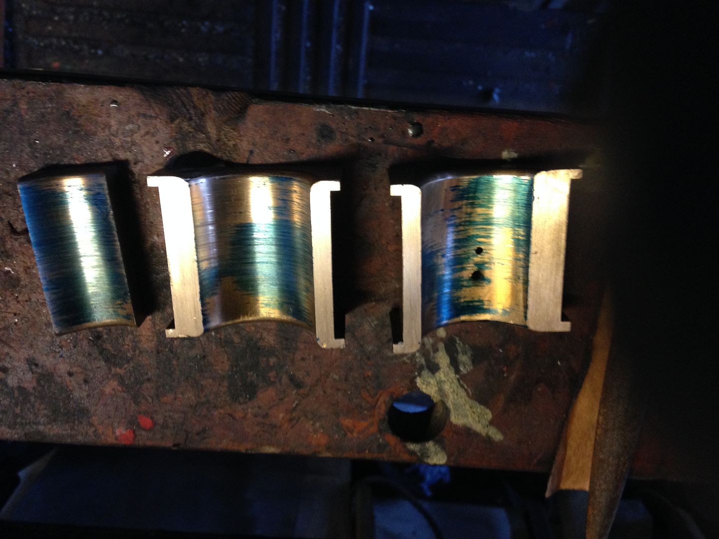

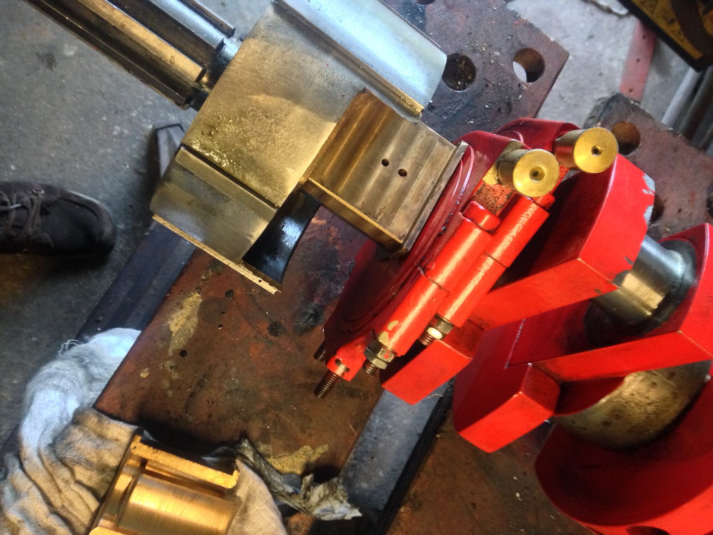

Post  lynnr on Mon 04 Jan 2016, 2:18 pm
There be a big hole.
Think I may have found the clunk. The bearing is loose. So shrunk down and refitted.
Getting there.
Now to refit everything.

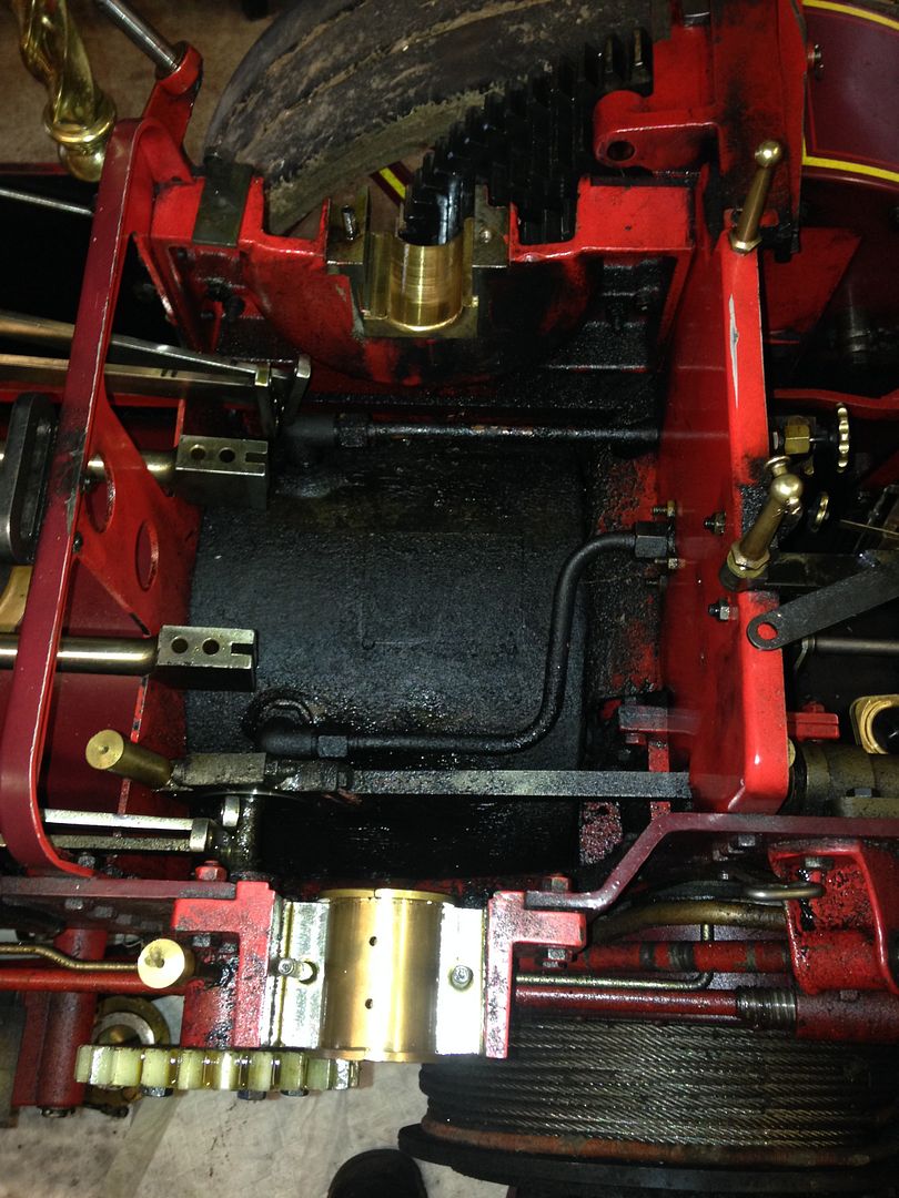

Post  Tony King on Mon 04 Jan 2016, 3:23 pm
Looking very good Lynn, apart from all that crud on top of the boiler under the crank! affraid
Has to be said those bearing surfaces look pretty good considering the amount of running Your engine has done...Nice job!!

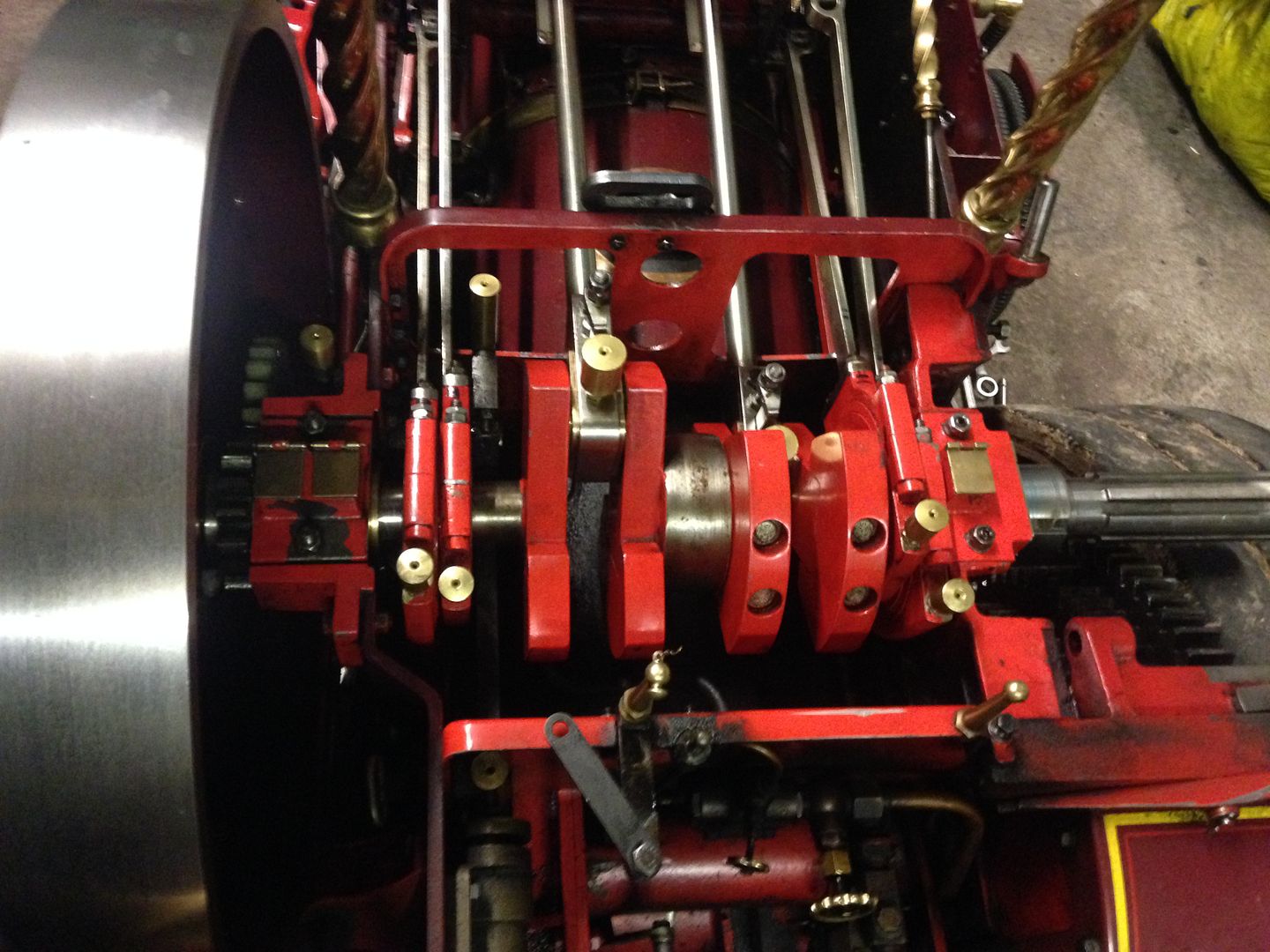

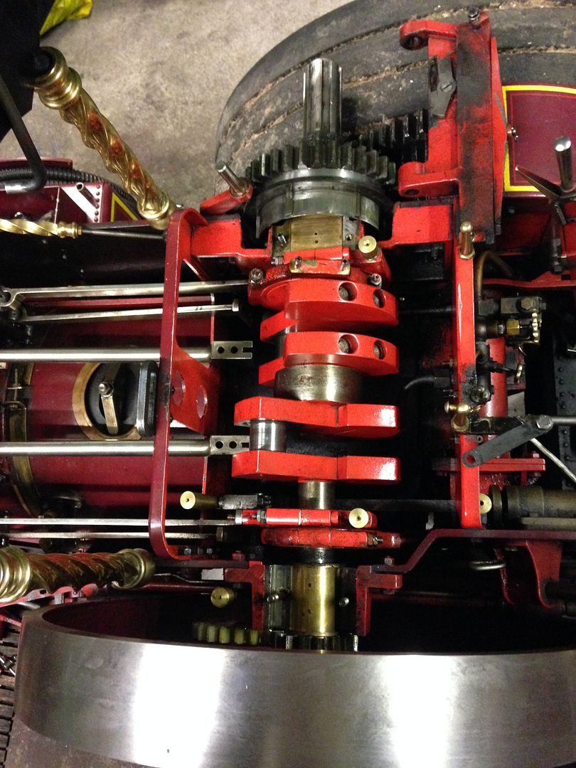

Post  lynnr on Mon 04 Jan 2016, 5:13 pm
Some of you might have noticed the problem.
I am not saying so try and guess.

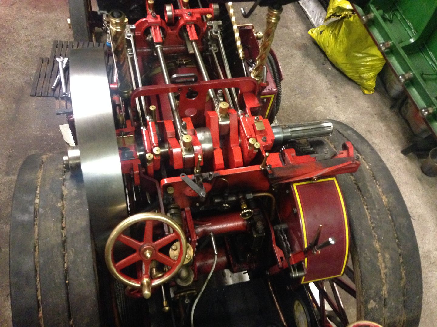

Post  lynnr on Mon 04 Jan 2016, 6:56 pm
Got out for a little while this evening.
Flywheel attached and another clunk removed. Flywheel key way was slack. So shimmed it out and all is good.
Just need to remove the right hand wheel and 2nd shaft gear set to get the crank gears back on.
Me forgot to put 2nd and 3rd gear on the crank before dropping it back in.
Post  lynnr on Tue 05 Jan 2016, 12:40 pm
Progress today. Got a hour in the garage.
2nd shaft gear cluster removed. Oh boy! I forgot how heavy that is.
Gears added to the crank and everything going back together.
Post  Tony King on Tue 05 Jan 2016, 2:45 pm
Well done Lynn, that's a lot of work!!... What exactly was causing the knock? ...I give up on noticing the problem!!
Post  lynnr on Tue 05 Jan 2016, 3:03 pm
A few things were contributing to clunking noises.
Flywheel keyway was a bit loose on the crank. So shimmed out and is now tight.
Gear change side of crank bearing bit loose. Now tightened up and smooth.
Expansion link die blocks need replacing as also slightly too loose.
The problem was I dropped the crank in but forgot to put 3rd and 2nd gears on before doing so. Hence the requirement to remove the right hand side wheel, gear guard and 2nd shaft gear cluster so I could simply slip the gears on the crank. Did not want to remove the crank again as all settled in with everything loctighted up.

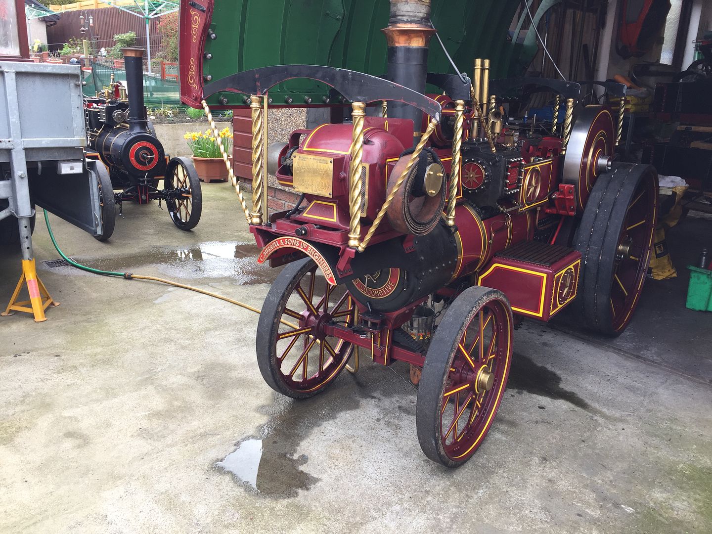

Post  lynnr on Tue 12 Apr 2016, 11:41 am

Post  lynnr on Tue 12 Apr 2016, 9:51 pm
Yes Mike.
Had Crystal out today. Wake up, fill up and out for a 10 mile run.
Yes Priscilla was sadly sitting watching as she is not allowed out in public yet in steam.
Now to clean up and get ready to head to Dundee on Saturday for the transport museum steam weekend.

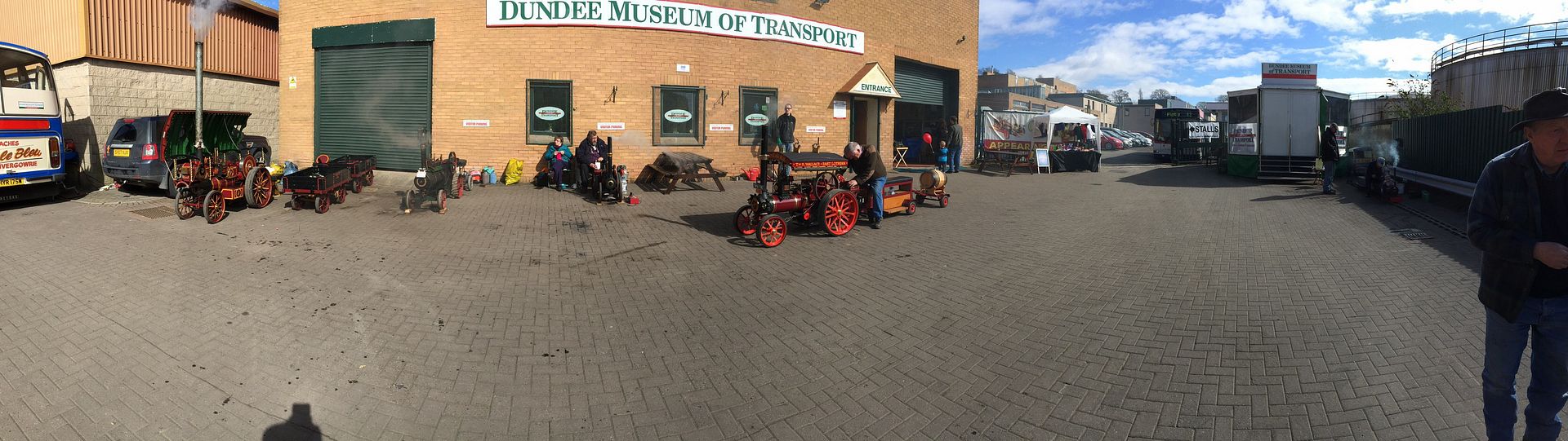

Post  lynnr on Sun 17 Apr 2016, 8:25 pm
Crystal had a sleep over at Dundee Transport Museum.
