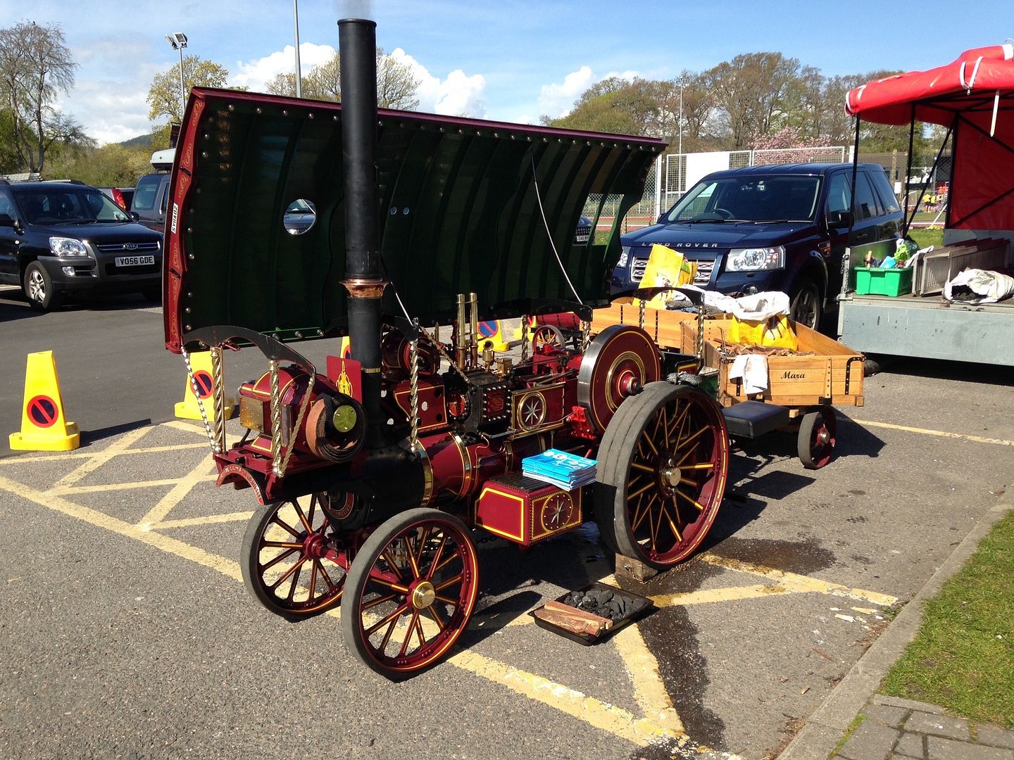

Post  lynnr on Tue 19 May 2015, 5:15 pm
A friend sent me a couple of nice pictures of Crystal. The originals are 8634x5979! So I had to down scale them somewhat.

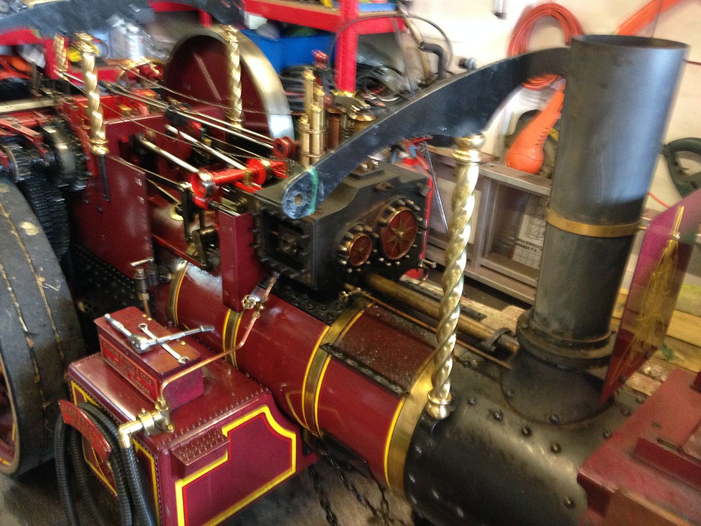

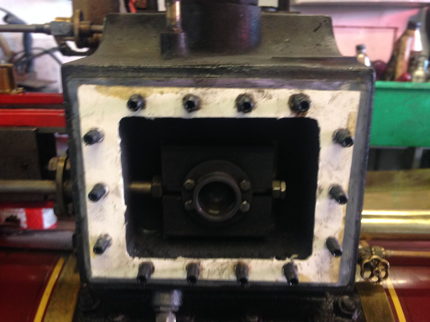

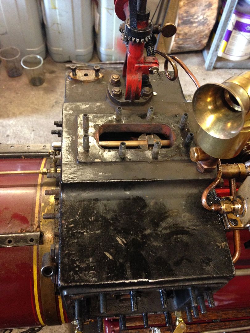

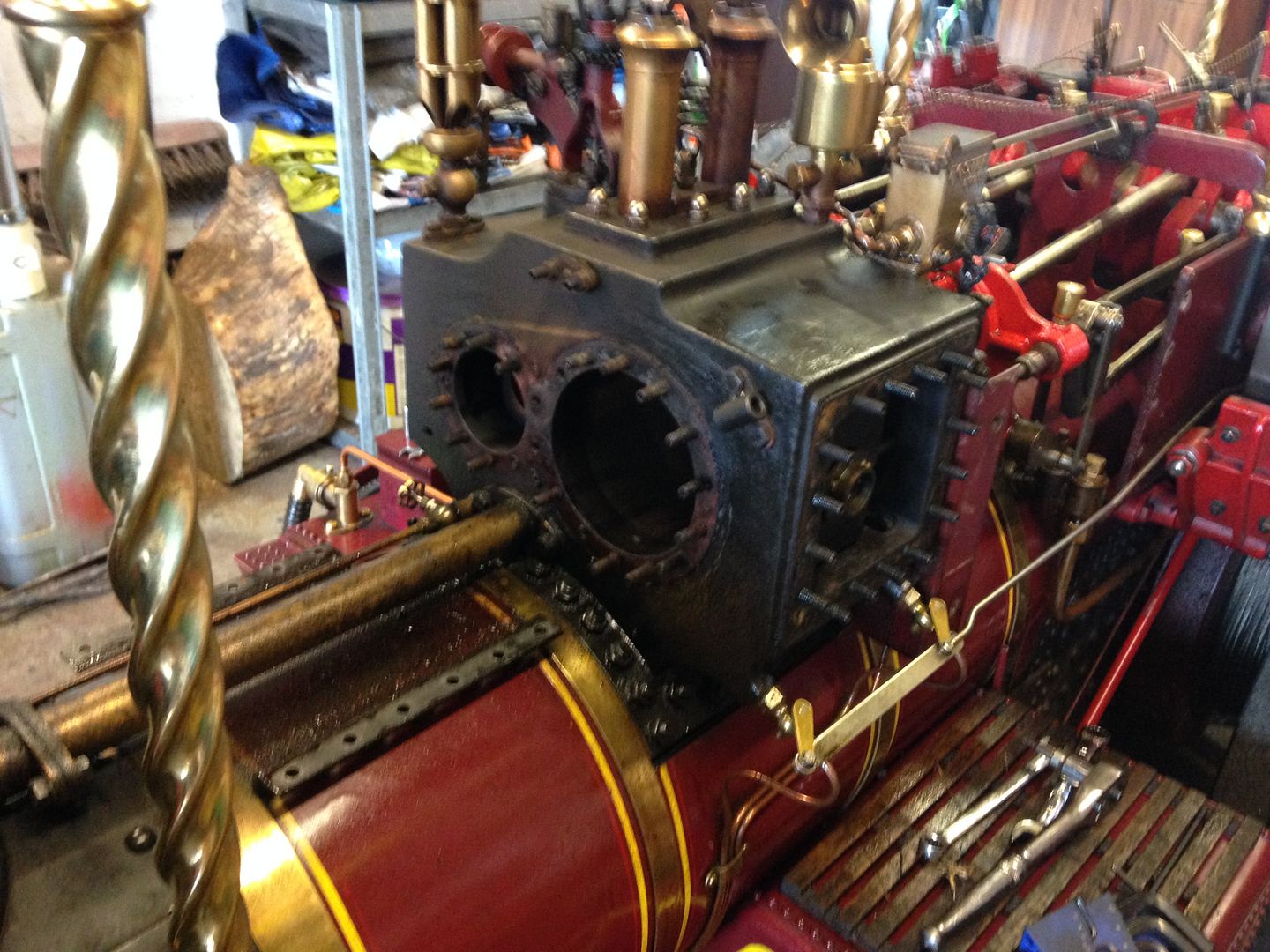

Post  lynnr on Mon 20 Jul 2015, 12:30 pm

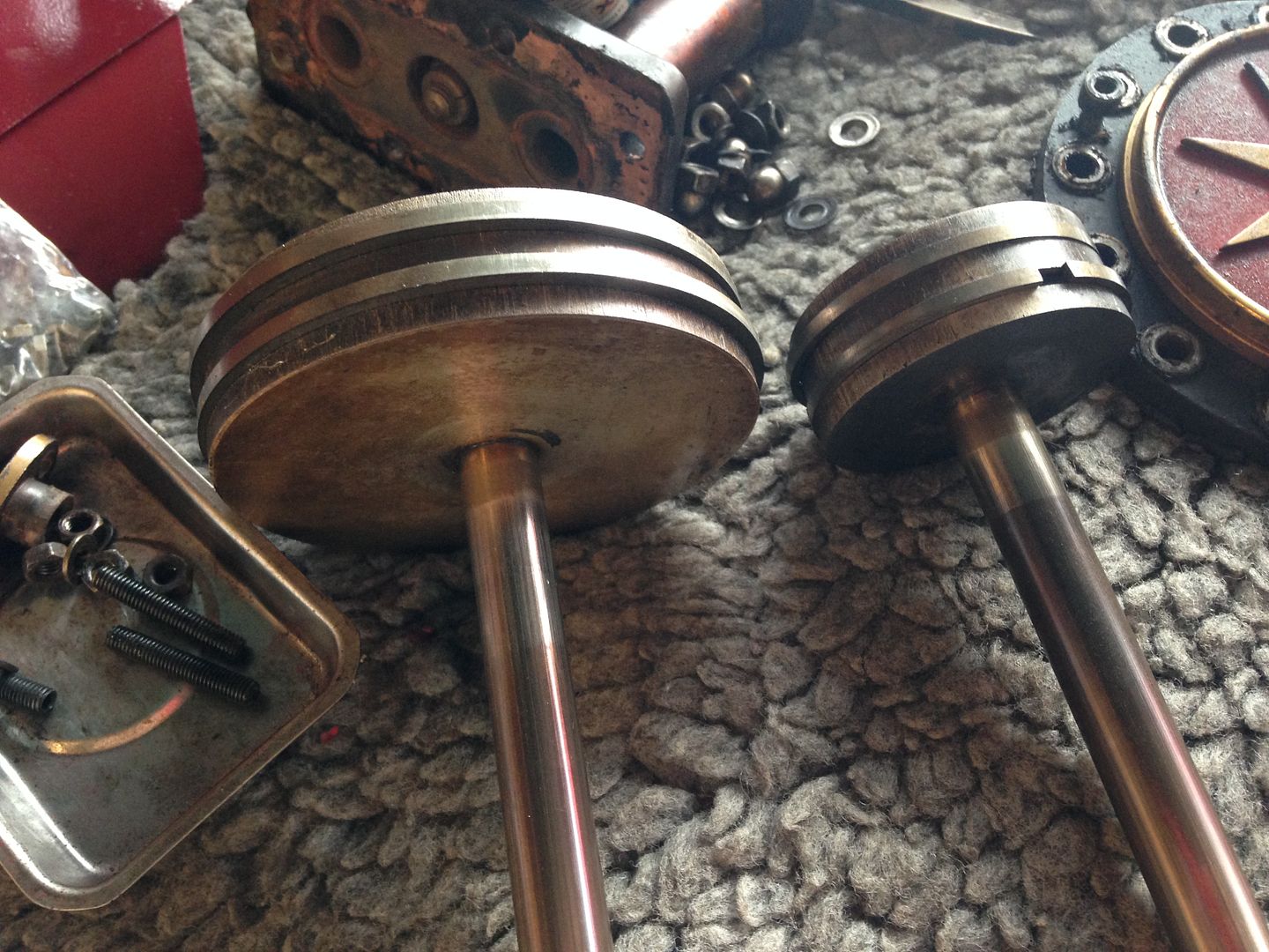

Maintenance time. She developed a knocking at the weekend. So while I am at it. Change piston and regulator gland packing.
Number of posts : 2906
Post  lynnr on Mon 20 Jul 2015, 2:02 pm
Modified regulator working very well. Over 200 hours in use
Post  Tony King on Mon 20 Jul 2015, 5:08 pm
Hiya Lynn,
Good to see a nice "technical post", wish there were more!!... Been a bit quiet of late!!
Post  Kevster on Mon 20 Jul 2015, 5:22 pm
Did you find the cause of the knock Lynn?
Number of posts : 406
Post  lynnr on Mon 20 Jul 2015, 5:28 pm
Looks like the LP slide valve. Bit too loose on its shaft in the valve chest. Just need to nip up the two locking nuts a bit closer.
Also found the LP piston has unwound itself a tad. Just trying to get the piston rod out the slide block.

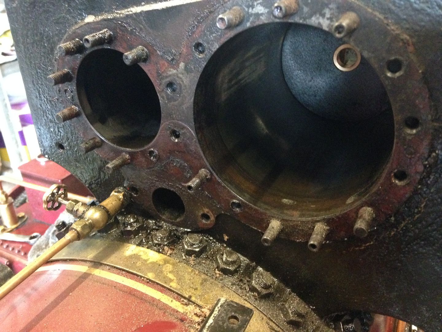

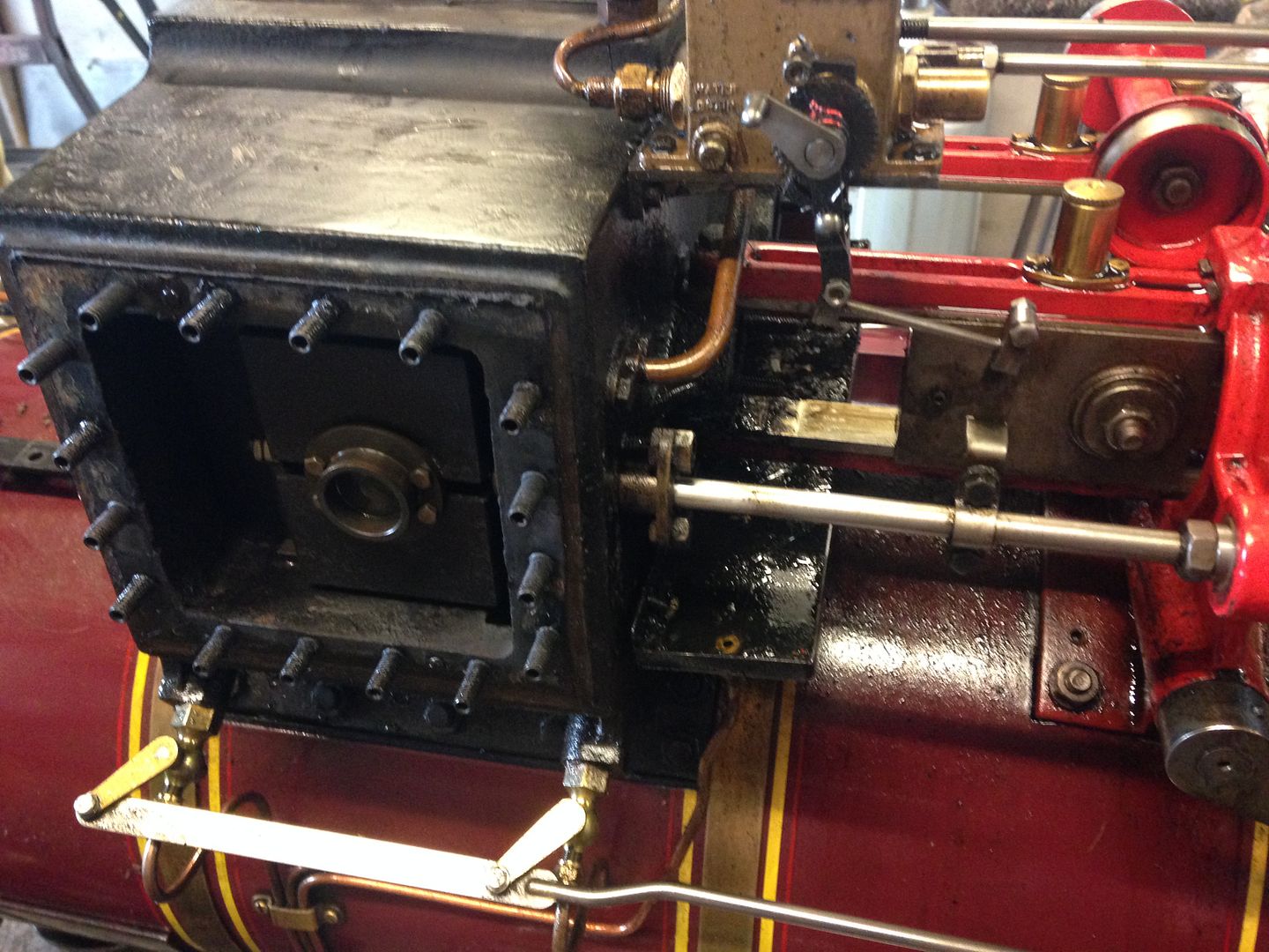

Post  lynnr on Mon 20 Jul 2015, 7:24 pm
Now she is apart. Need to put it back together again

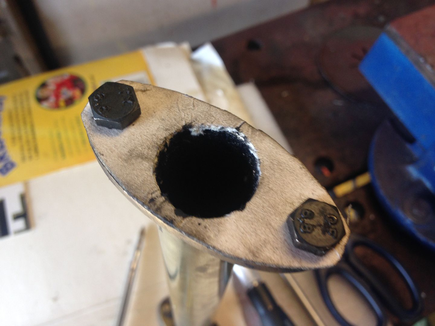

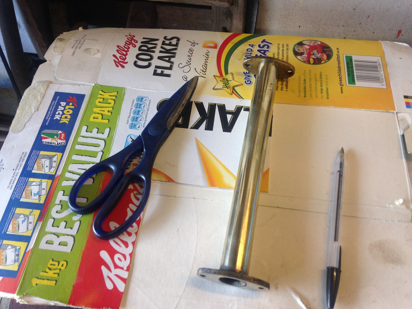

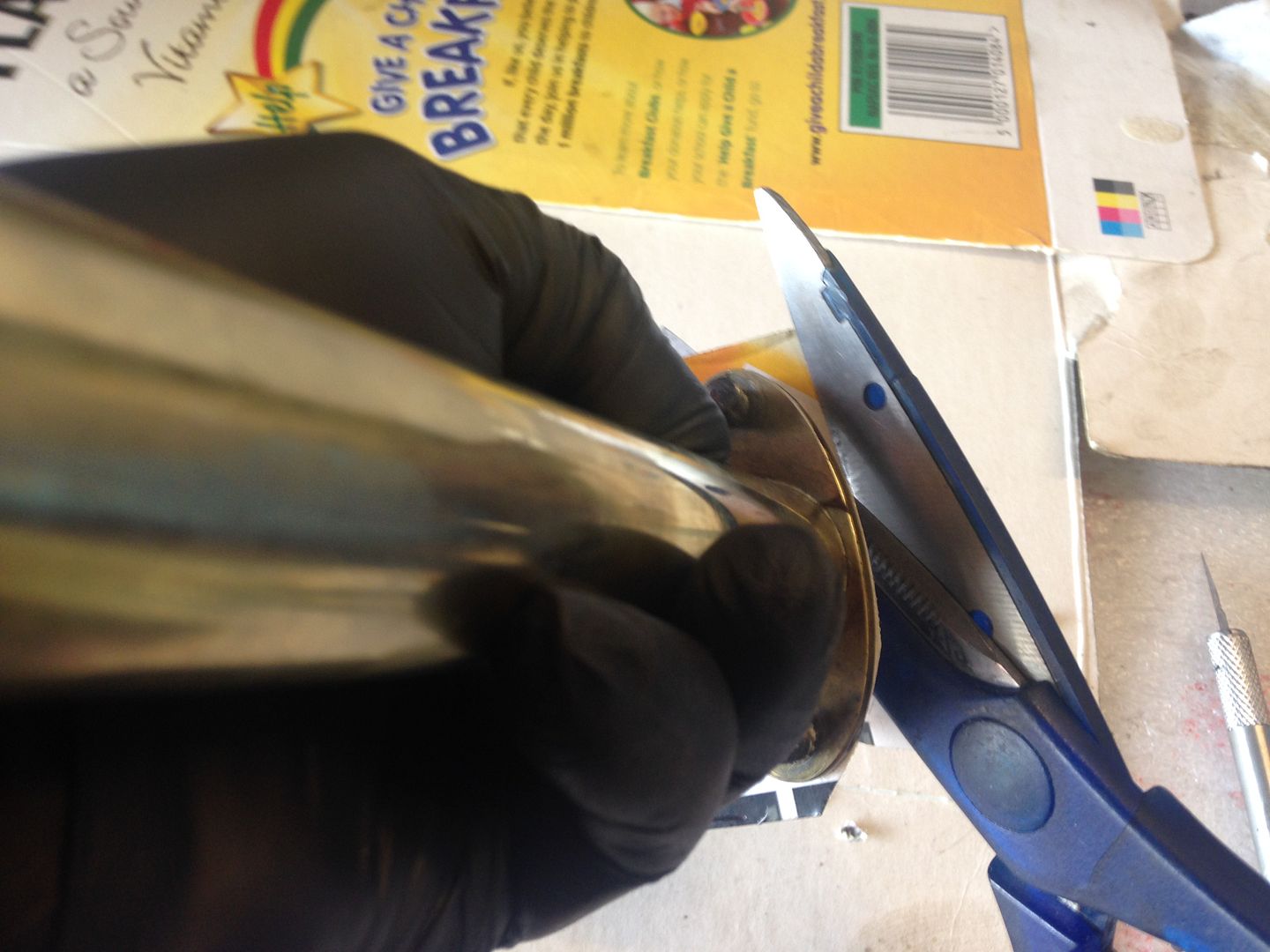

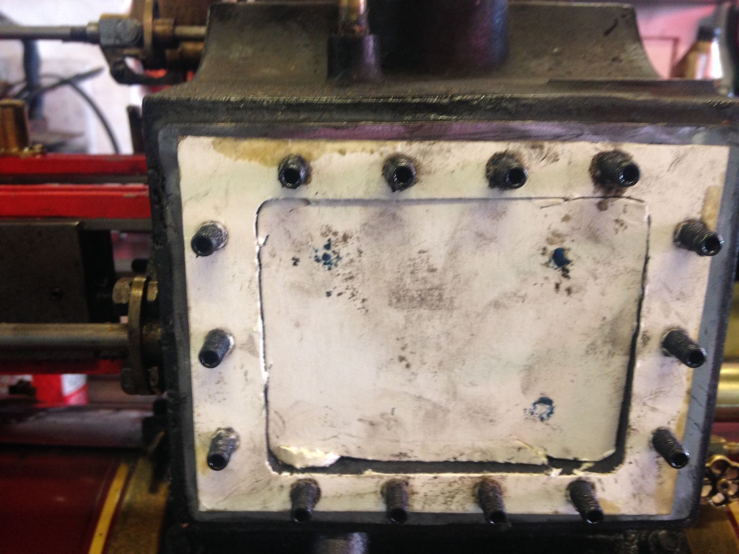

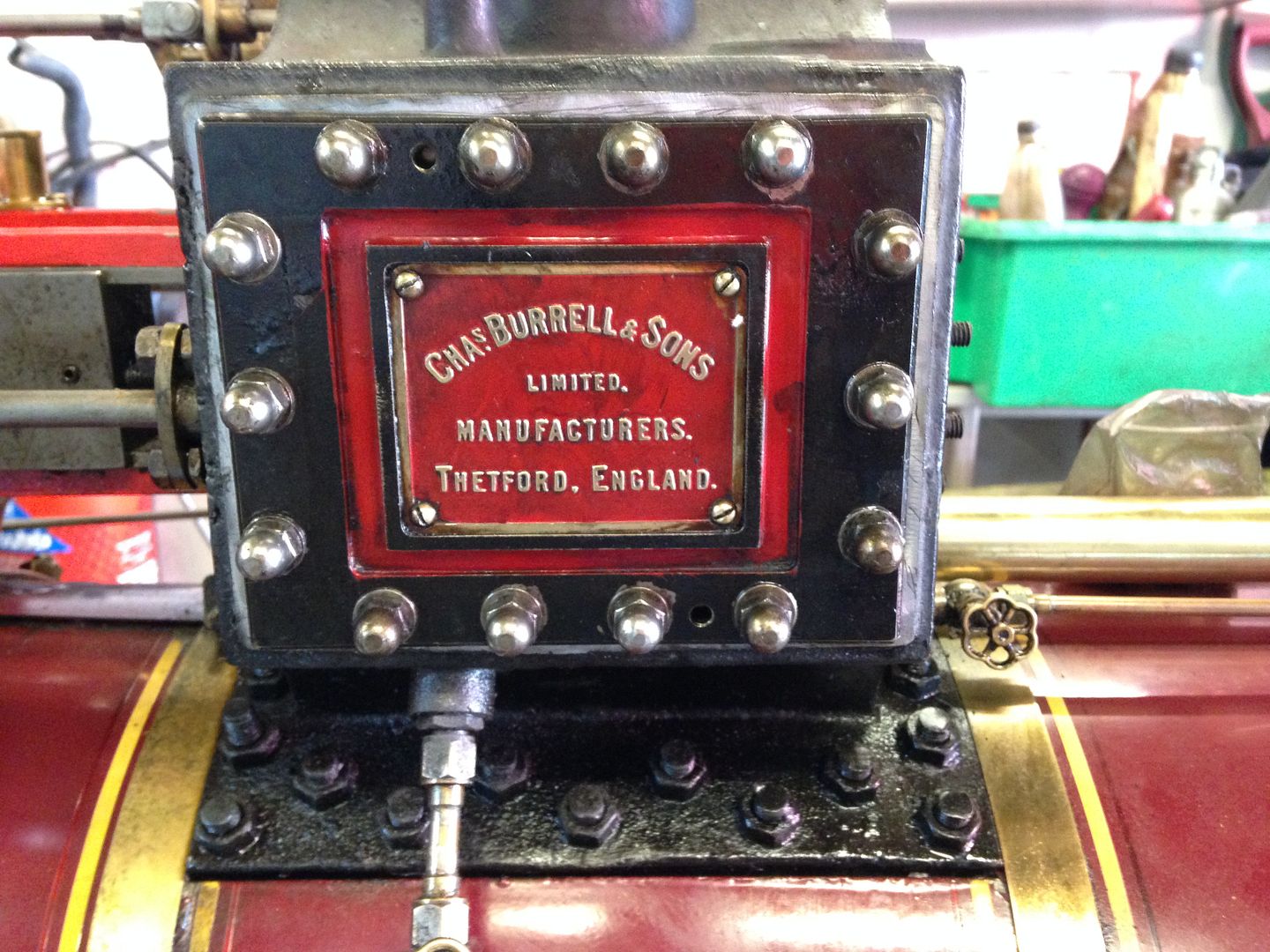

Post  lynnr on Tue 21 Jul 2015, 1:06 pm

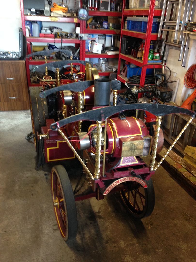

Been out in Crystal's bedroom again.
Starting to fit items back on.

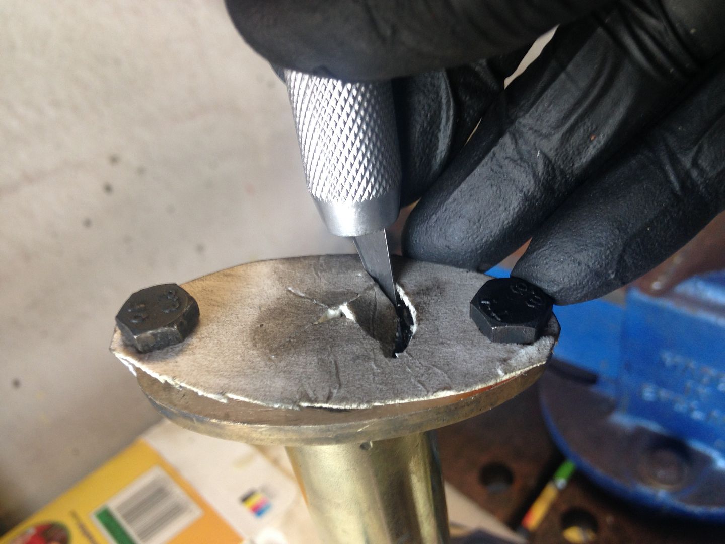

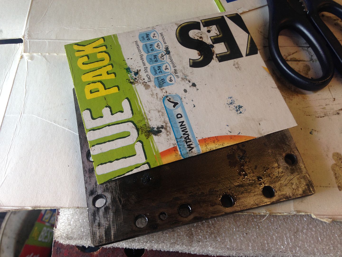

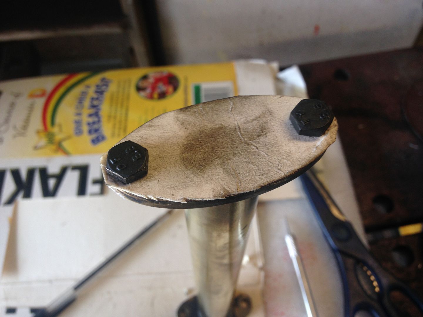

Gasket making cheapskate style.
Ingredients. Cornflake packet, scissors and crafts knife.
Cut a section that is slightly big. Cut a cross in the bolt holes.
Push bolts thro to make holes and hold cardboard in place for next operation.
Using scissors cut round the profile. Right handed scissors go anti clockwise. Then the cut is closer to the profile.
Then cut out the inside.

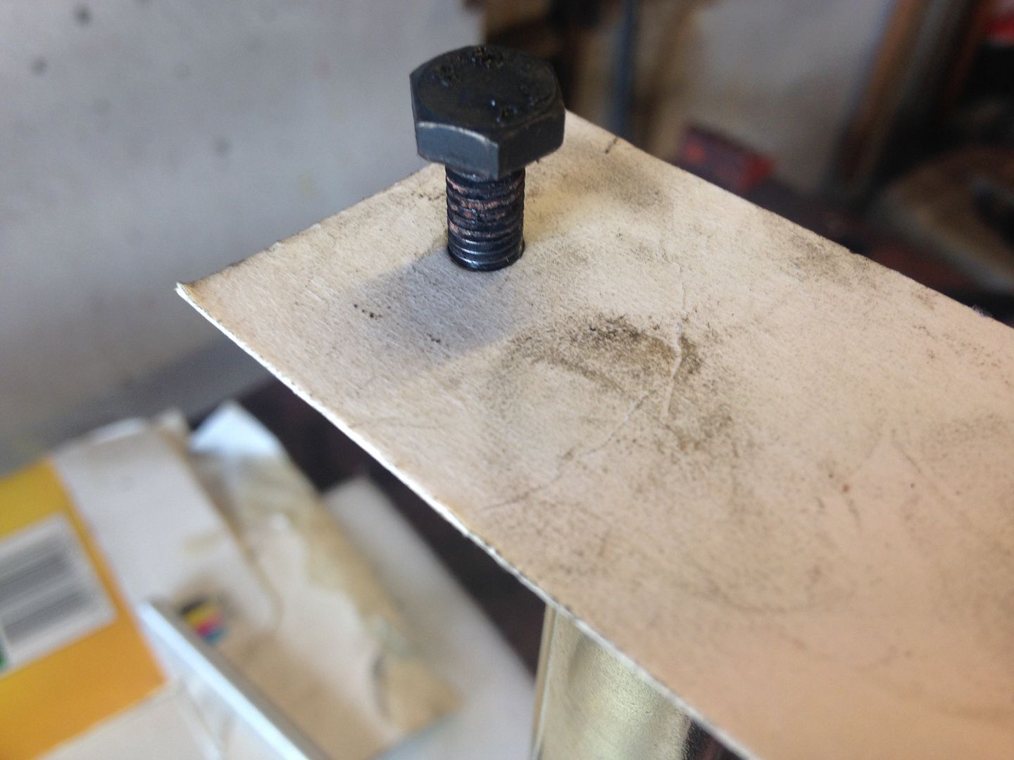

The valve cover.
Same idea
Oil the gasket on to the cover to hold it.
Line up one hold and push through the gasket.
This cuts all the bolt holes in one go.
Then cut the hole out by cutting against the casting. Only cutting on the downward stroke so you do not life.

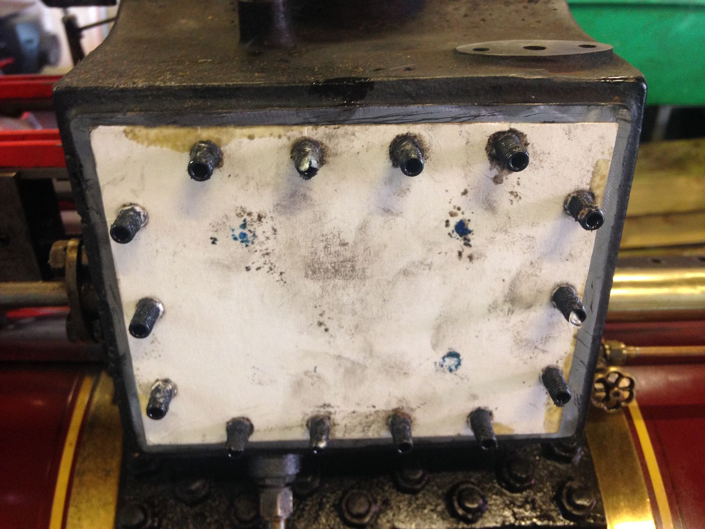

Bolt cover on
The complete job accomplish in 5 minutes.
Post  lynnr on Tue 21 Jul 2015, 1:07 pm

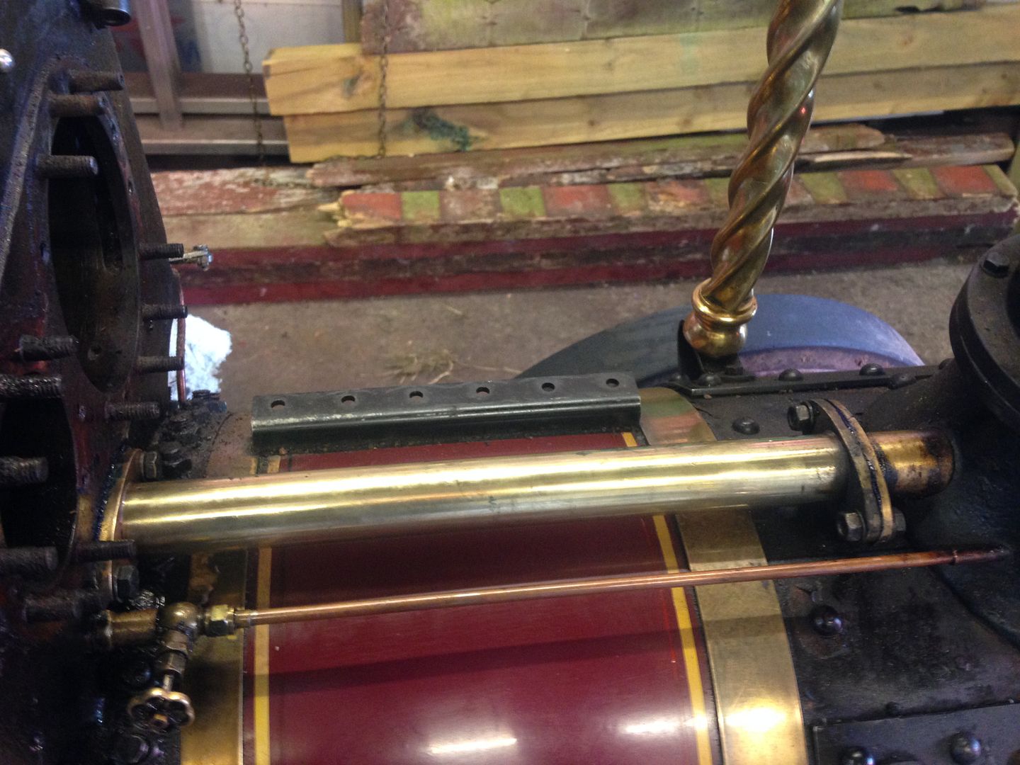

Blast pipe refitted.

Post  IanL on Tue 21 Jul 2015, 1:46 pm
Thanks Lynn, useful tips on the cornflake gasket I have tried myself but ten to end up with bolt holes in the wrong place so will try your method next time.
Best wishes
Post  LiveSteam on Tue 21 Jul 2015, 6:19 pm
Fantastic Lynn and actually far easier than I was expecting, I was thinking of using hole punches etc but your method is far simpler Cool
Number of posts : 465

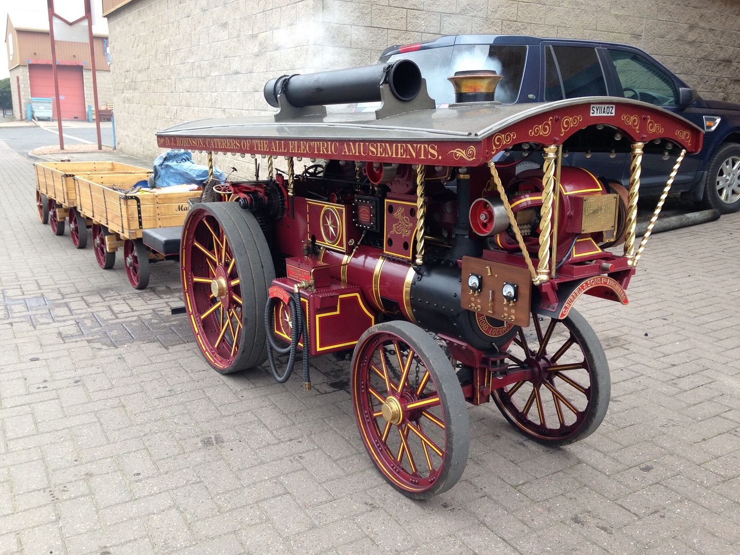

Post  lynnr on Thu 13 Aug 2015, 2:18 pm
Shine.
