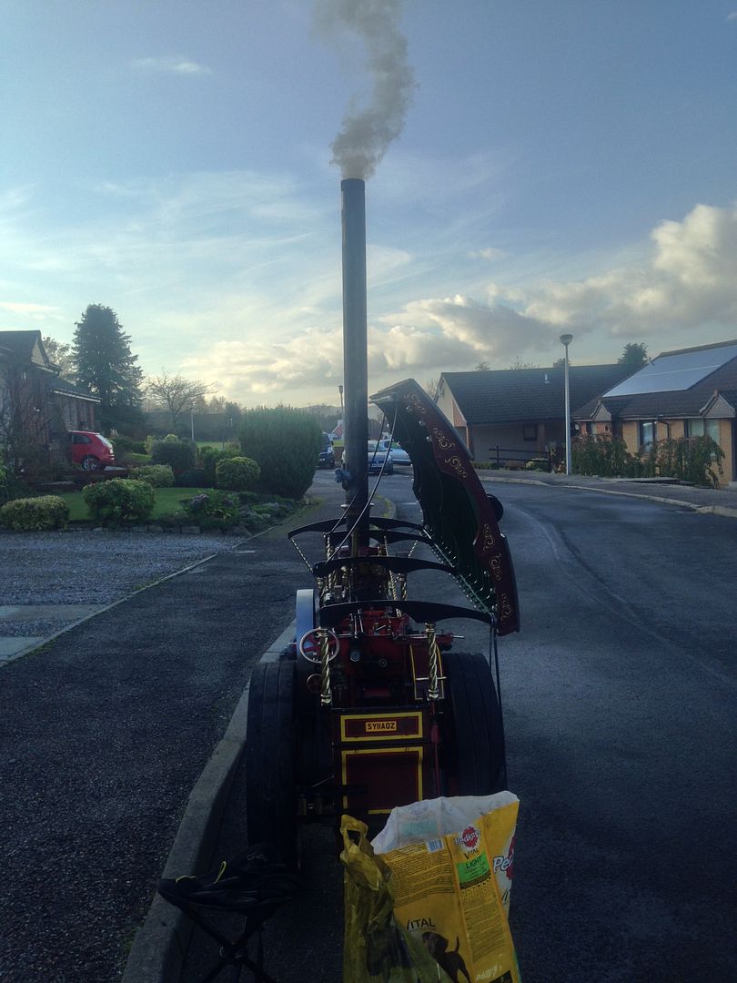

Steam test today.

Post  lynnr on Sat 08 Nov 2014, 6:36 pm
She passed no problem.

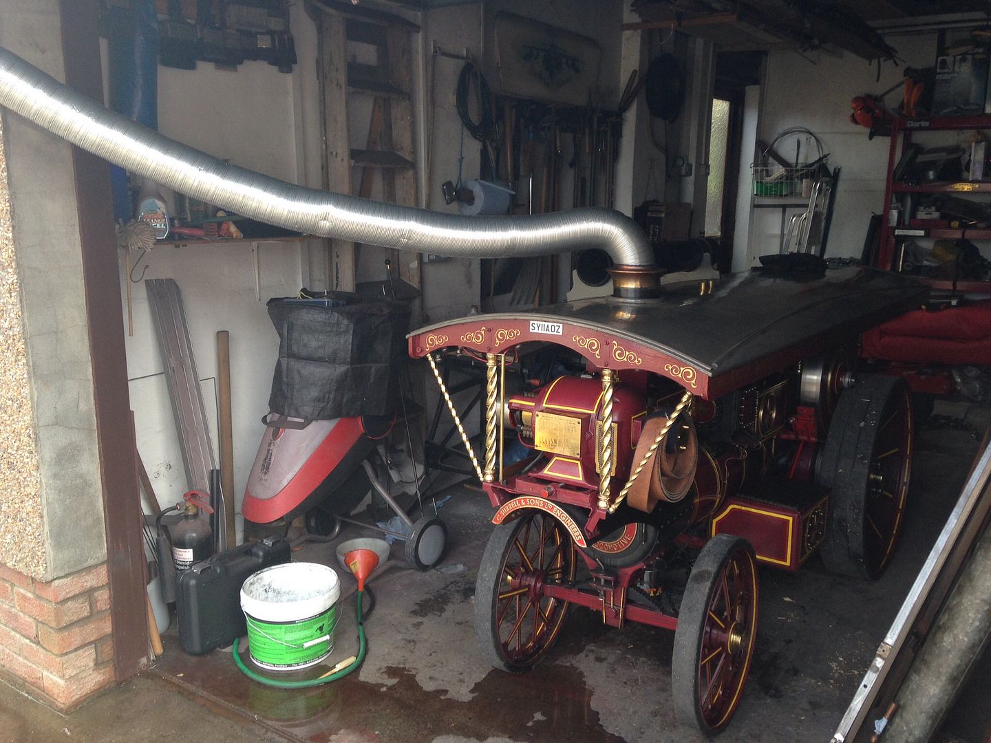

Post  lynnr on Tue 18 Nov 2014, 10:30 pm
Crystal is heading into hibernation.
Had her final blowdown of 2014. Deep clean and maintenance time.

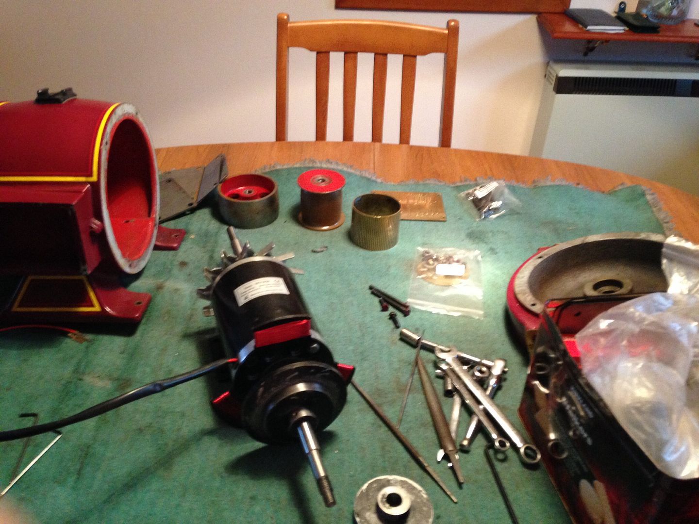

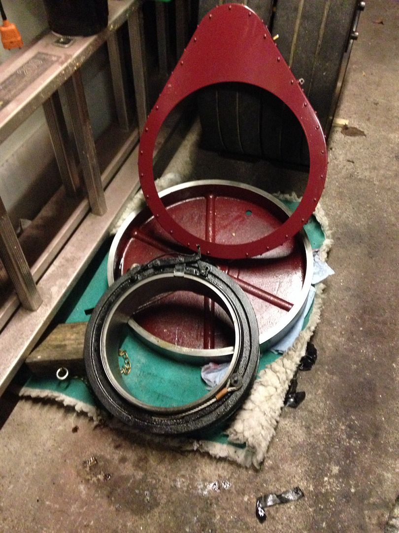

Post  lynnr on Sat 10 Jan 2015, 3:40 pm
Little bit of dejavu
Finally started putting the Dynamo back together.
Number of posts : 2906

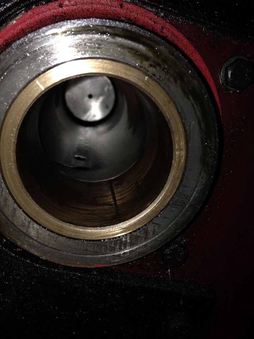

Which part of the generator failed?
Post  lynnr on Sat 10 Jan 2015, 10:07 pm
Hi Tony
It's one of the dogs old blankets Twisted Evil
The main shaft broke last year at Crathes. Funnily it was at the exciter end which has never been belted.

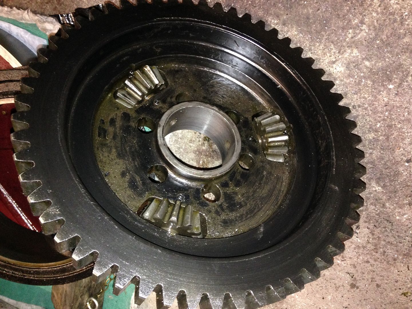

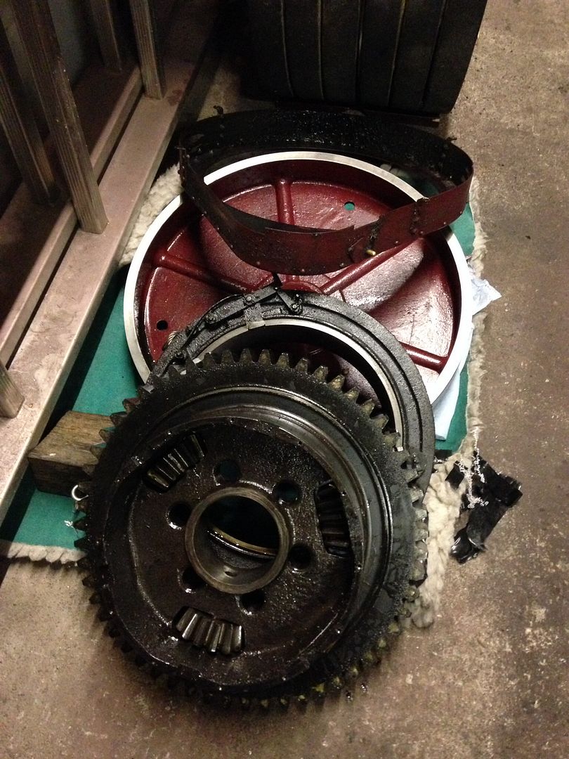

Post  lynnr on Sat 17 Jan 2015, 5:51 pm
Had a nice afternoon out in Crystal's bedroom.
She is getting some tlc. The main Dynamo is now refitted ready for trials at first steam. Now it's on the her rear end. Axial, bushes, gearing, differential and road wheels all being checked and serviced.
Just need to make a washer to space the flywheel out by a couple more milimeters to stop it tinging off the brake shaft.
The damper leaver also got modified with a deeper slot and a more pronounced hook to stop it falling shut on the road.

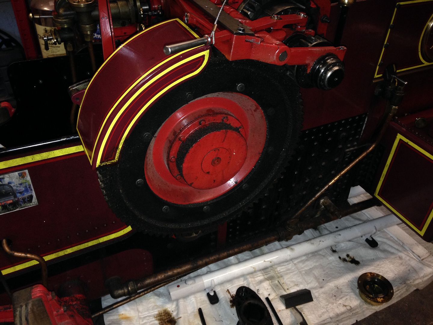

Post  lynnr on Sun 18 Jan 2015, 2:49 pm
Crystal's rear end all back together.

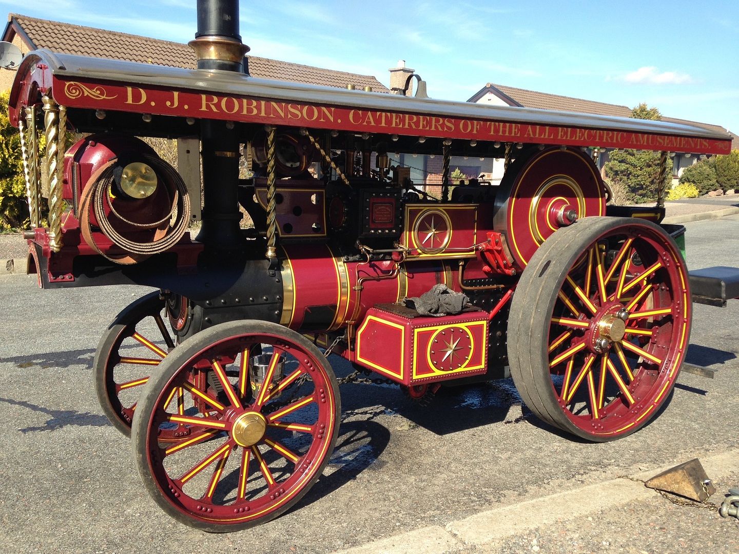

Productive couple days. Crystal is happy her oil and locoklean barrels have nice new pump adaptors. Will keep the oil nice and clean and make my life easier dispensing in the hand pumps.

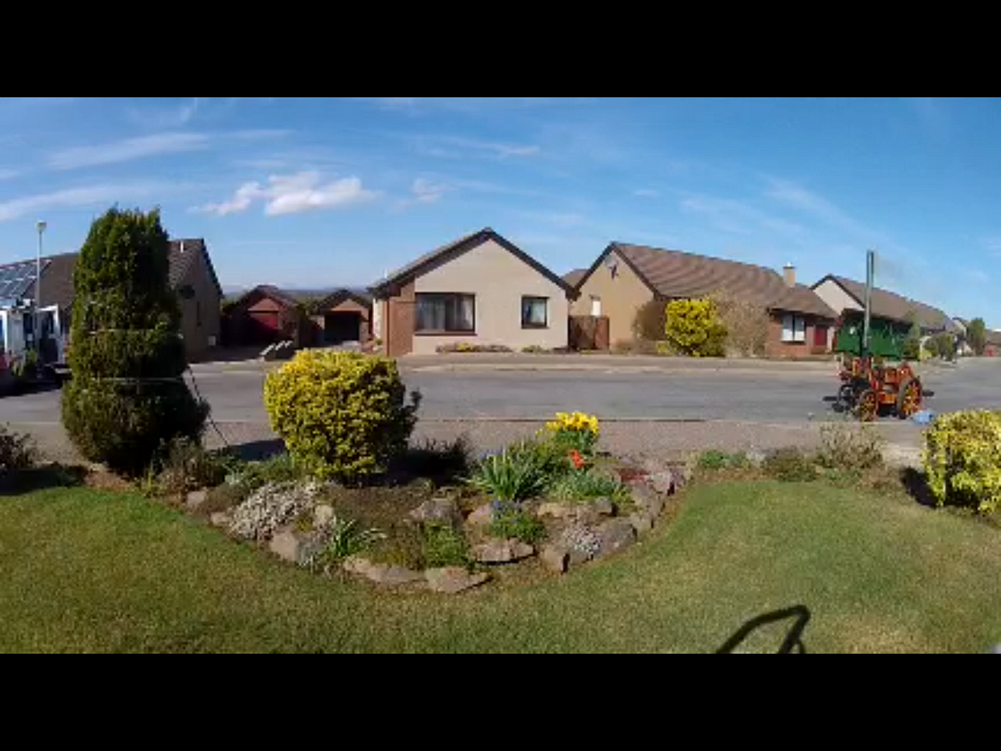

Post  lynnr on Wed 08 Apr 2015, 10:44 pm
Crystal looking splendid in the spring sun. Just before she is put to work.
Wonder what is going to happen here?
Find out in tomorrow's exciting episode.
