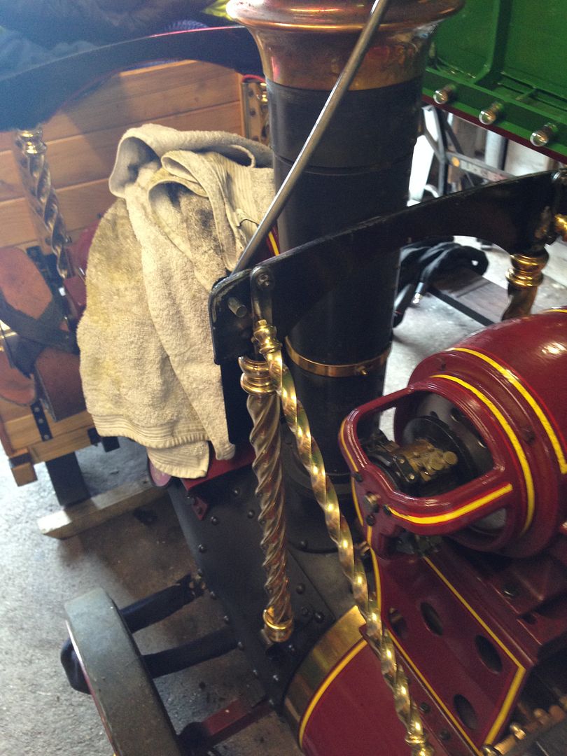

That's both sides now broken where the countersink bolt is.
This time it happened at Brian's birthday road run
Fixed. Well enough until winter hibernation and deep clean.

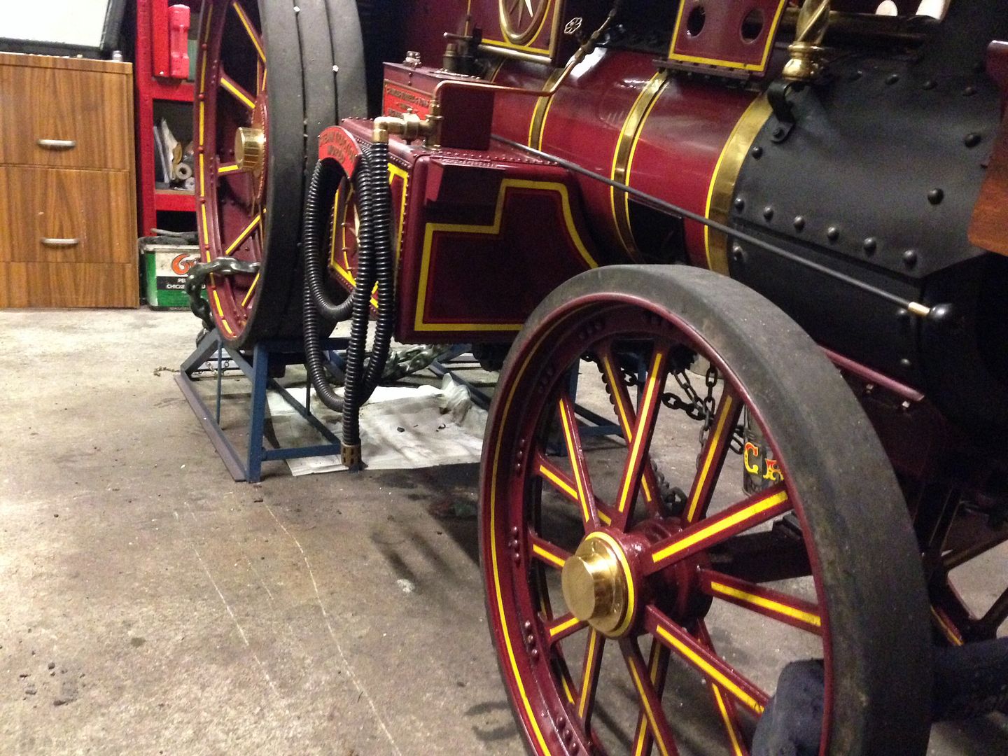

Oh the new valve on the injector feed worked a charm.
Water on. Steam on. Quick twist closed on water and open full. Slurp every time.

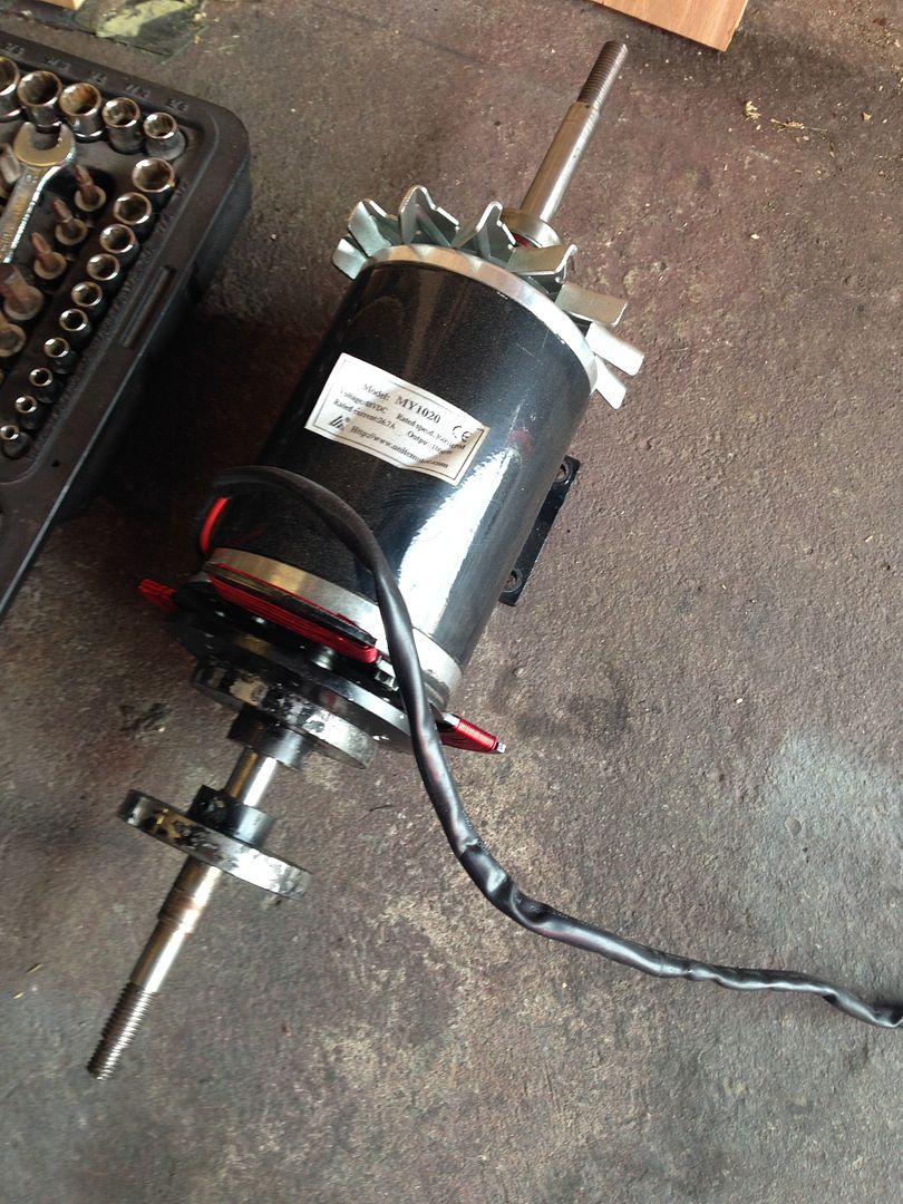

Steam Traction World we have a problem. Over.
4 hours to remove the dynamo. Very difficult when you can't hold the shaft stationary to unwind the pulleys.
I had to drill locking pin holes in various parts so I could unbolt and remove enough to get the dynamo out.
Just need to pack up and send down to Steam Traction World as the shaft has broken inside the casing of the dynamo itself.

one to watch out for, as my shaft also broke after a long generation.
It was correctly aligned in the generation case, but sheered the shaft completely in two. STW did turn it around in a day, so thanks Ian and Isabel.
Post  Tim Watson on Wed 03 Sep 2014, 5:20 pm
i wonder whether or not we are putting too much pressure on the belt when generating (and hence the spindle) to reduce belt slip. I've just bought a tin of 'Rocol belt dressing spray' to see if this helps. A wax based belt dressing certainly improved matters at GDSF.

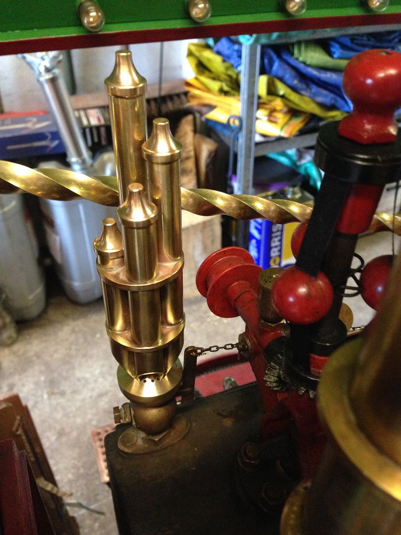

Got my new whistle fitted. A nice 4 chime one. Sounds good. Yes I forgot to record it on air before fitting.

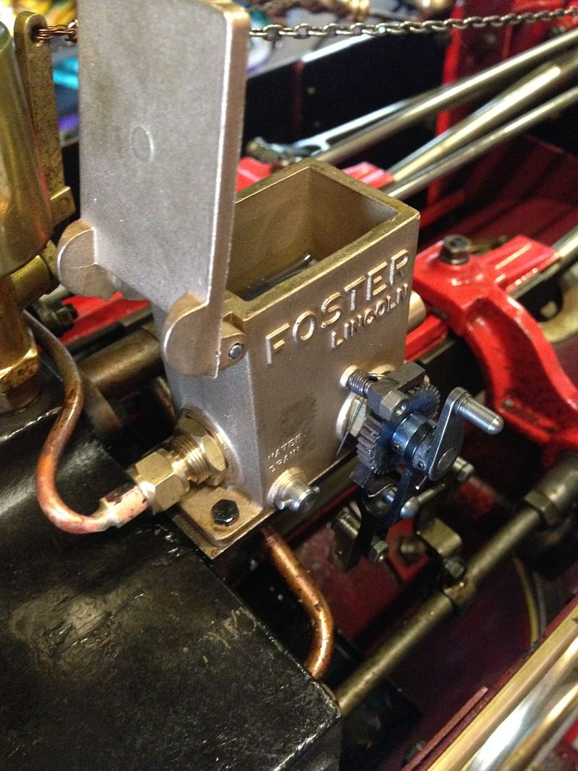

And a ratchet style lubricator. Very good and reliable oil delivery. Positive action even at max cut off.

The new lubricator works wonders. Might be slightly too enthusiastic. But that's fine.
Whistle. Not very much out of it. Needs a new valve as previously suggested. I have tried finding the yorkshire company but can not get a fix on it.
Help please. Which valve to get and contact details.

Post  IanL on Mon 20 Oct 2014, 6:56 am
If you are using the original STW valve, mine did not let any steam through when open as the diameter of the push rod filled the hole in the PTFE ball seat hence sealing itself. I turned the end of the push rod down slightly and it now let's loads of steam through to the whistle, your nice new 4 chime probably needs a lot more steam flow so check if your valve has a similar set up.

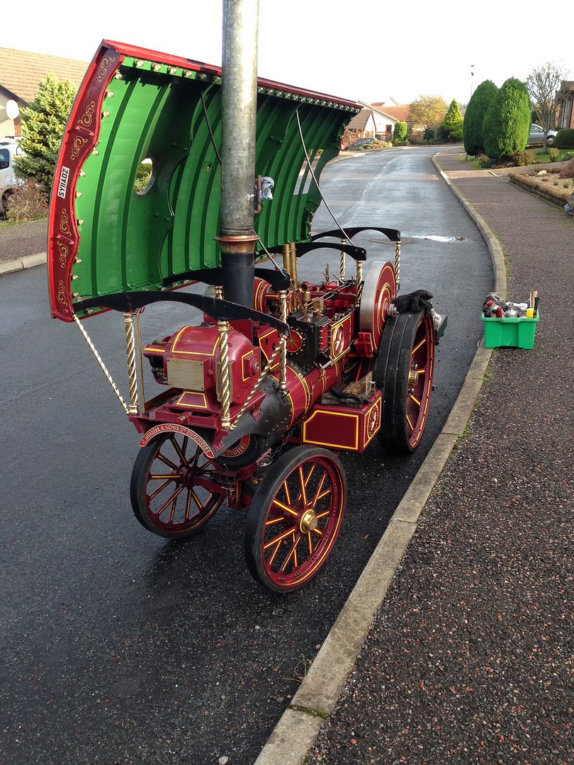

Crystal has passed her cold inspection. But she is not too happy with her current posture.
Steam test on the 7th.

Lubricator
Post  Tassie Tiger on Thu 23 Oct 2014, 11:57 pm
Hi Lynn
Where did you get your lubricator from please?
Phil
Tassie Tiger
Number of posts : 47
Location : Tasmania Australia
Registration date : 2012-01-01
Post  lynnr on Fri 24 Oct 2014, 6:48 am
Hi Phil
Live steam models. Page 37 of the PDF version of the catalog

Post  lynnr on Sat 25 Oct 2014, 12:42 pm
Hi Ian and all
Got Crystal back together after her cold inspection.
Since it is a bit showery this morning though I would have a go at the whistle valve.
Upon inspection yes Ian. The valve is very restrictive. So after porting the casing, filing triangle the end of the push rod and channel it out. New whistle screw fit altered to allow more steam out of the offset port on the valve.
Tried on air. Yup. Much louder. Next steam trial. Weather is getting better.

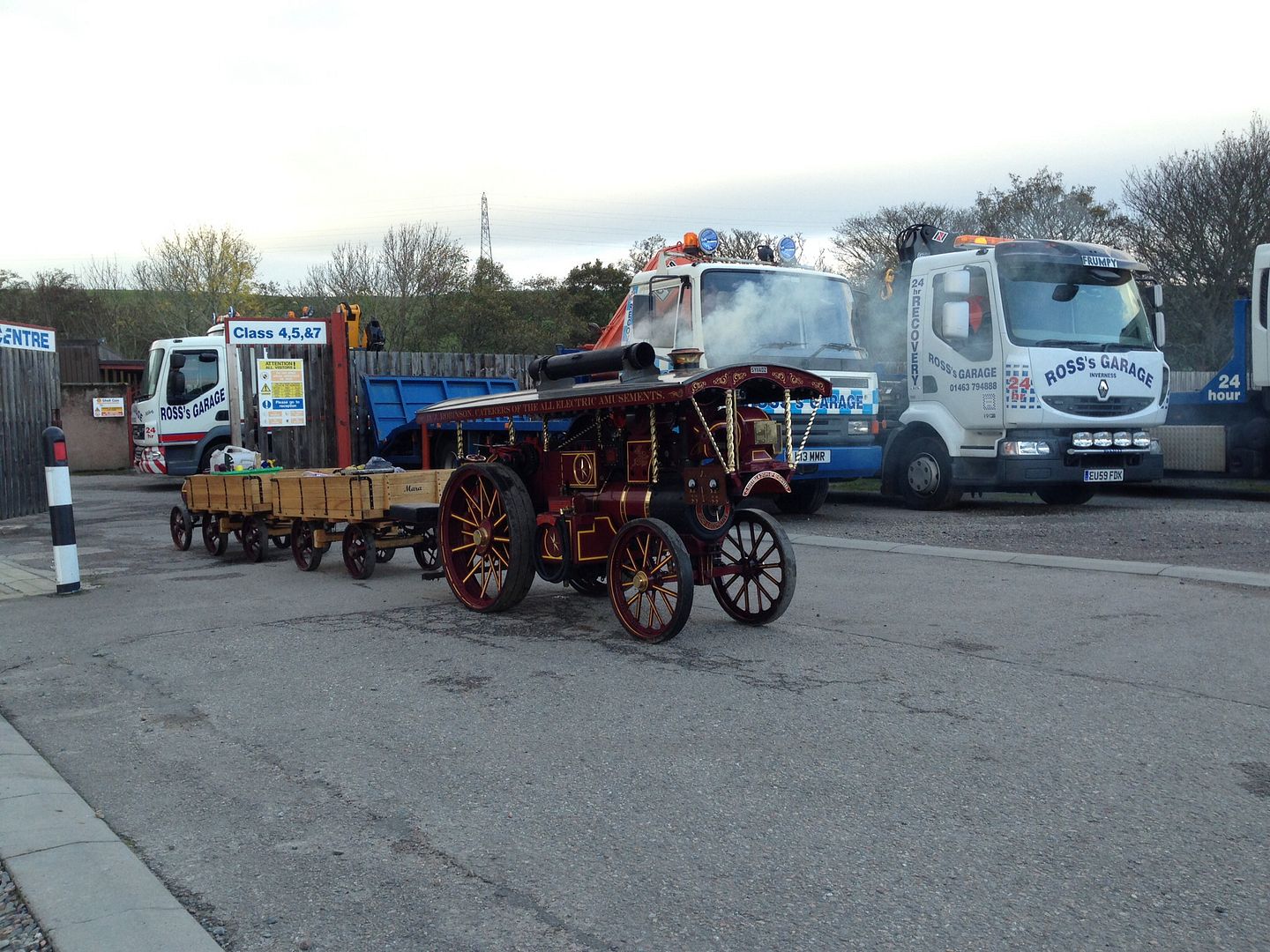

Post  lynnr on Sat 01 Nov 2014, 6:34 pm
Got a steaming today. Not many pictures but there will be a video.
Yes Brian! I got out of the housing estate. All the way to the garage and back. 10 miles round trip across Culloden Moor.
Some nice hills steep but not as long as Brian's birthday road run.
