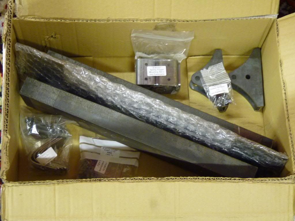

Hi all, received Kit One today and im really impressed with the quality of the kit, well worth the wait, haven't done much with it so far just unpacked it and check it all over

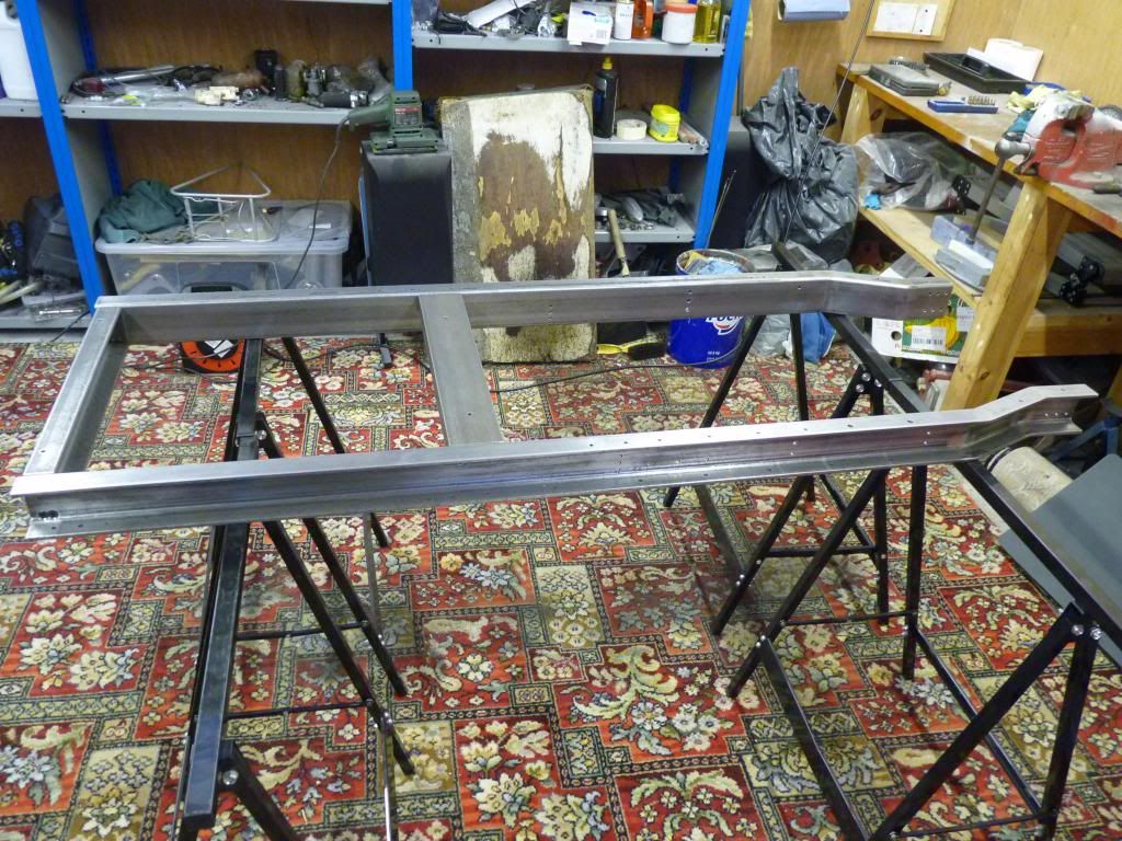

Had a good solid day today working on the chassis, managed to clean the rails and rear/mid cross members up as well as test fit everything together. Hoping tomorrow to take back down and start Etch Primering the parts up.
I have 2 questions though should there be a gap at the rear as i carnt seem to get rid of mine and should the Mid cross member be lower than the chassis rails or level, the drawing shows level but other builds on here look lower

Not sure what you mean about the gap at the back but on my chassis the mid rail definitely sits lower by a couple of mm.  The instructions didn't mention it, it was just where it fitted.  Not sure what difference (if any) it would make when you come to fit the water tank etc.

Thank you tom, having looked at your picture and enlarged it i can see that the back of your looks like mine does, seems as your self and others have lowered the mid cross member i shall do the same just encase as you say it will affect the water tanks later on, Managed to get a few parts in Etch today but haven't got any pictures the next lot ill prob get is when everything is in primer

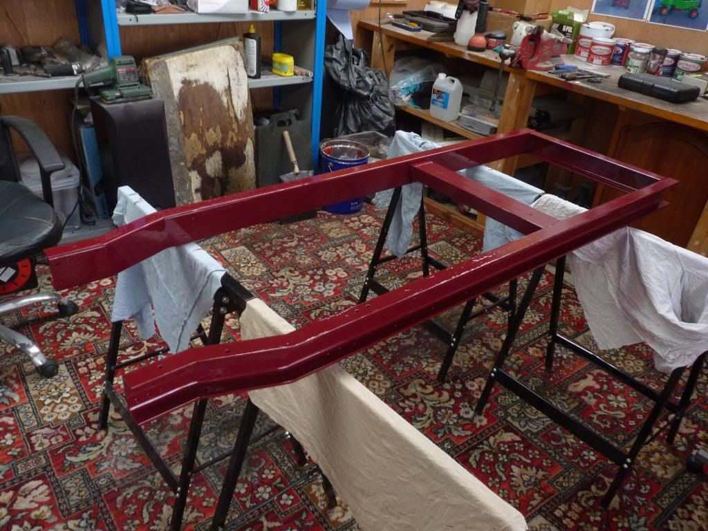

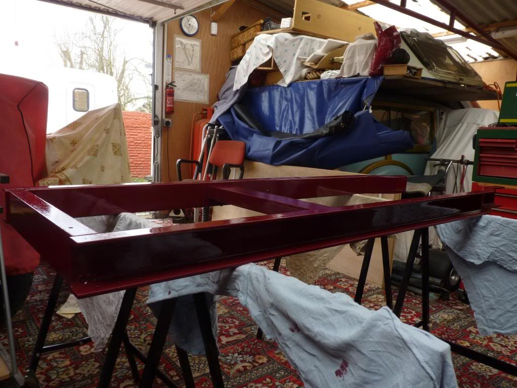

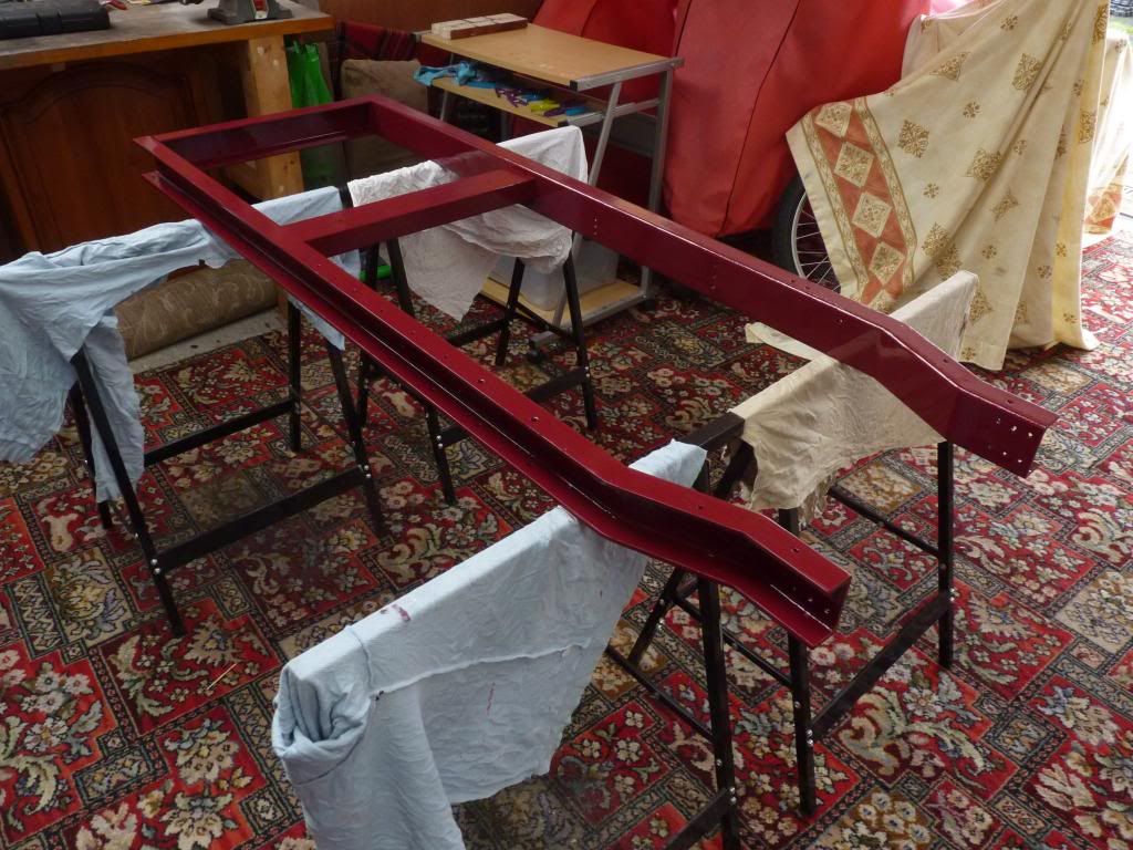

Post  hartshaulage on Wed 26 Mar 2014, 4:16 pm

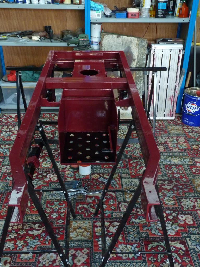

Got the chassis in first coat of top coat Manchester Red, just need to leave to harden for a day or two then flat down the top and bottom rail and repaint as the paint ran, other than that im really pleased with the way its all going. Some areas look black on the photo that's just because i use a Manual setting on my camera to try get more accurate color in the pictures

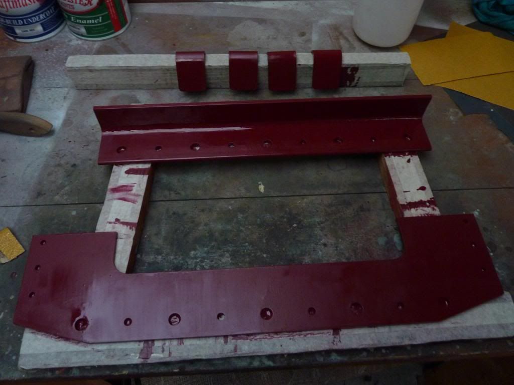

Post  hartshaulage on Tue 15 Apr 2014, 8:23 pm
Been pretty busy lately getting kit one re prepped and painted as had a few runs, my self and my dad have came up with an idea to keep the paint int he air so it has enough time to dry and not get marked, We put a bolt in to the lath and put a point on it, this then sits in a hole on the chassis and keeps it int he air thus meaning no damage to the paint.
I have also been busy prepping and primering the Tow bar ready for final assembly and fitting

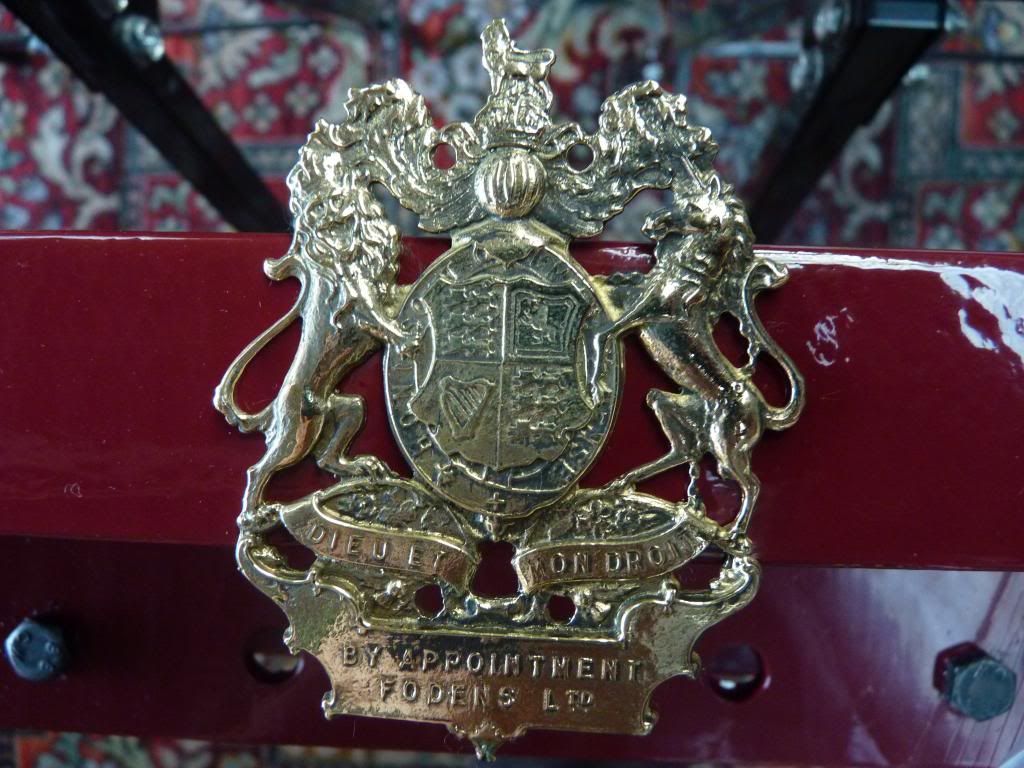

I also managed to pick up of Ebay the Foden Coat of arms, looks very good lots of detail on it

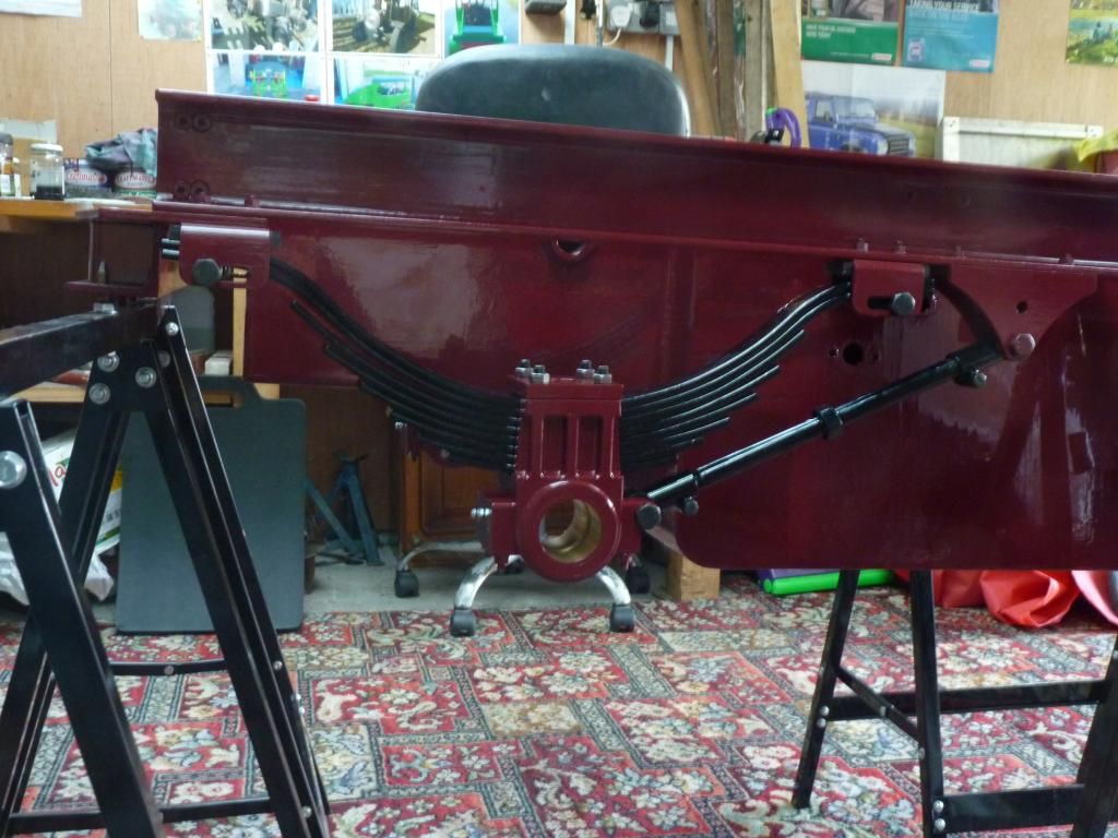

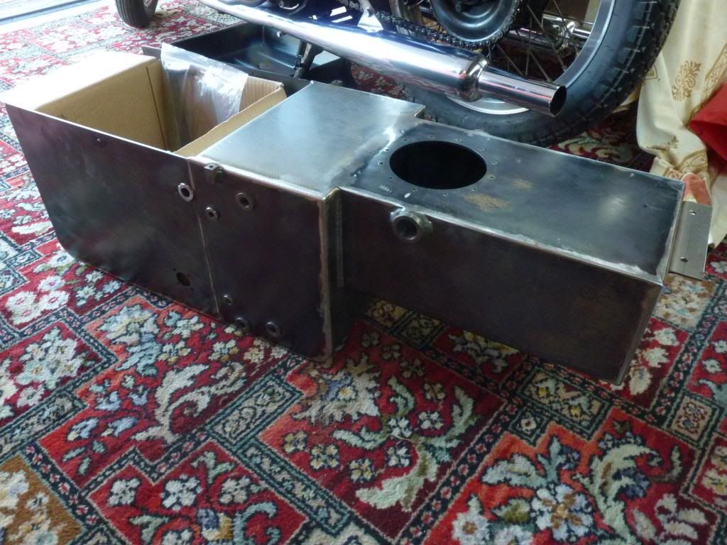

Post  hartshaulage on Sun 27 Jul 2014, 8:13 pm
So been quite busy recently, got all of Kit 9 the bottom water tank complete, painted and fitted, and have had the holes plugged up filled with water to check for leaks int he Sight Glass
Have also got all Kit 3 completed and fitted, thanks to Atomenter (Tom), Foden SWB (Nick & Ken) and Steve at STW for there help with the rear suspension, i ended up cutting 5mm of each side the top springs to get to sit level

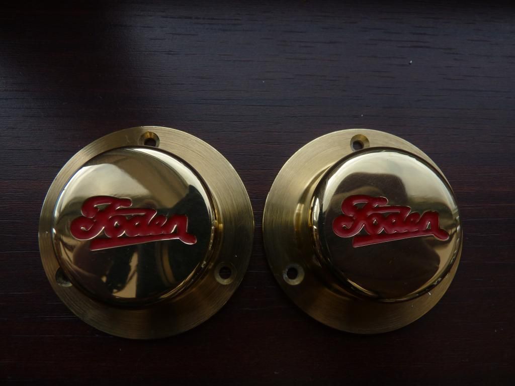

however i sent my hubcaps to steam plates for engraving and enameling, with my engine being red i went for a red logo, and im extremely pleased with the result

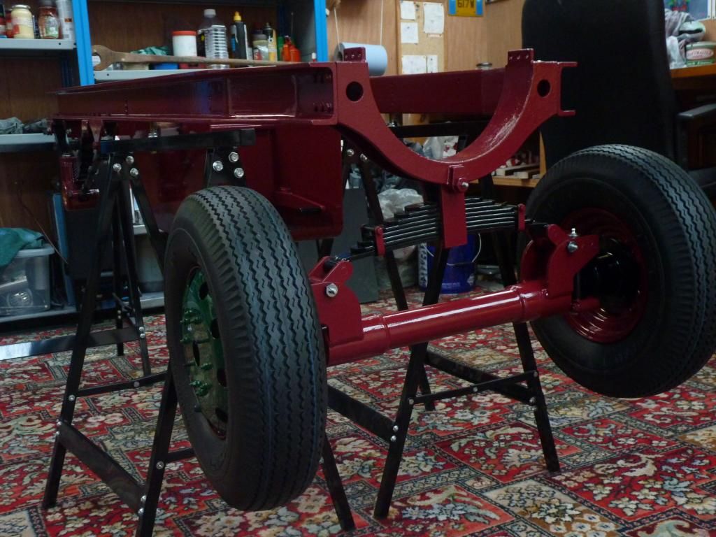

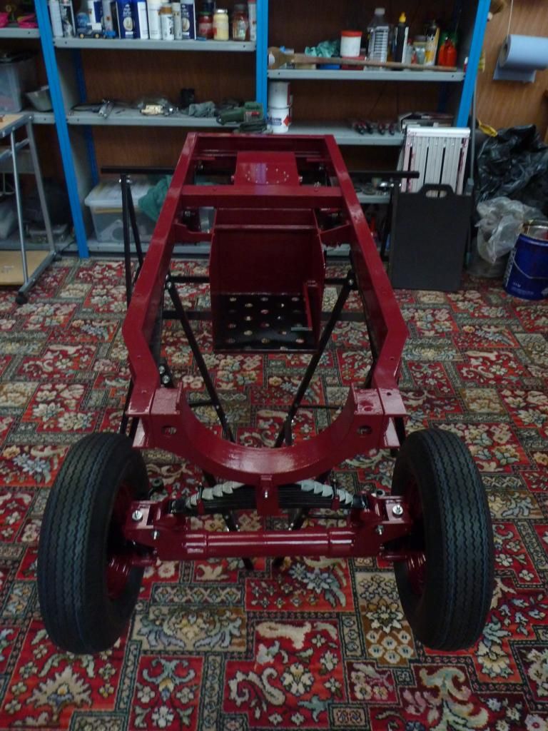

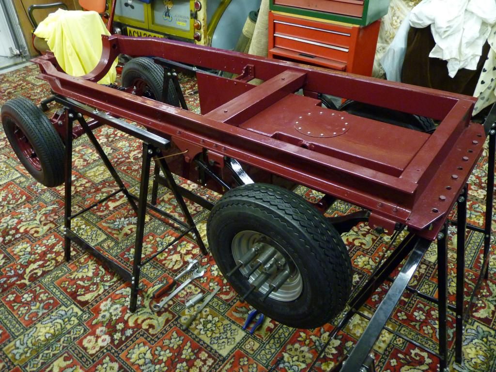

Post  hartshaulage on Sat 23 Aug 2014, 9:56 pm
Font axle and wheels now fitted, also made a start on fitting the hub caps, as you can just see ive painted these the same colour as the cab will be Mid Brunswick Green, will try and get some better pictures when the hubcaps are fully fitted
Number of posts : 229

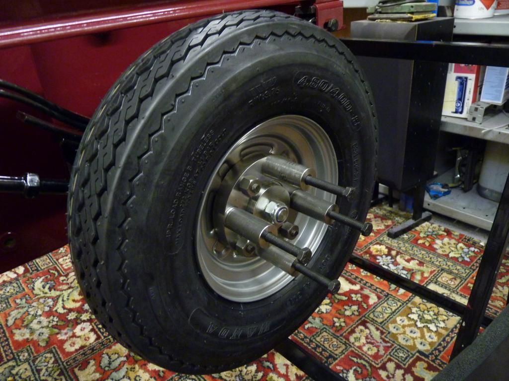

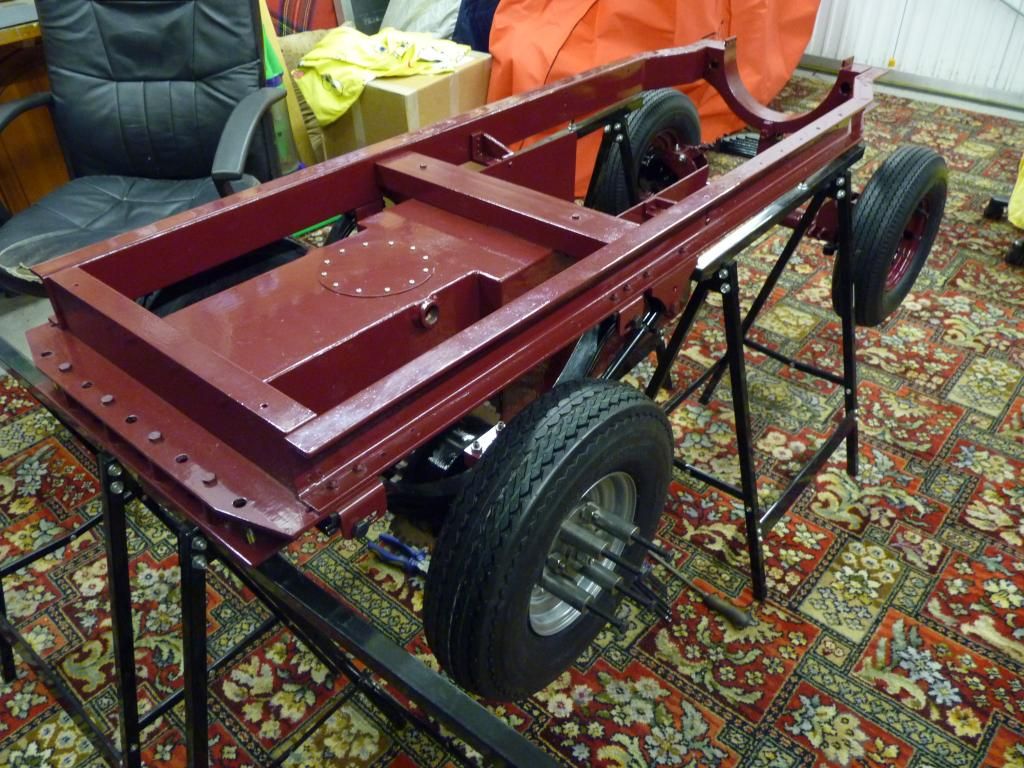

Post  hartshaulage on Tue 14 Oct 2014, 9:59 pm

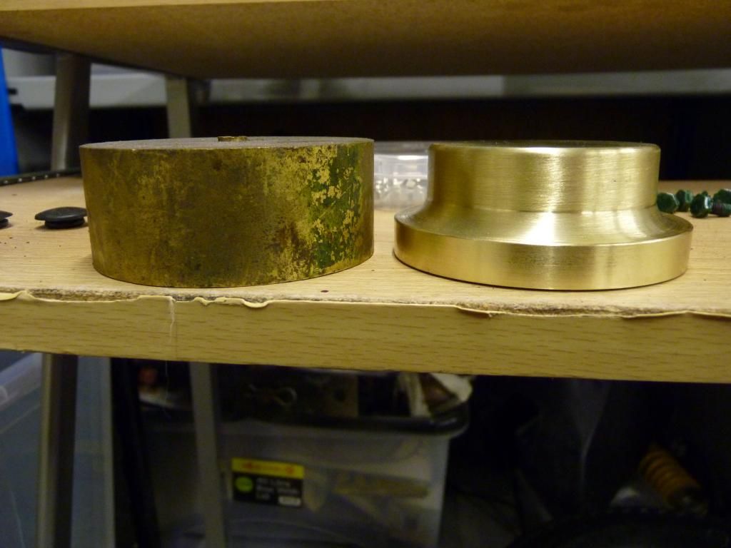

Okay time for a small update, The rear axle and wheel kits have arrived and with a lot of building up and taking down the rear Diff is all set up and working lovely.
The rear hub's required a slight bit of trimming down on the lathe as they were just slightly to big thus making the diff lock up when tightened down, with this all sorted Ive fitted the inner wheel and the Wheel spacers, next job is to cut the bolts down to make the studs to fit the outer two wheels.
Ive been looking at the rear hubs that steam traction supplied and im not very keen on them, purely for the fact the front is lovely brass and the rears are steel.
Luckily the old owner of the lathe when he left it my dad also left various bits and pieces with it which included 3 solid pieces of brass just the right diamater to make some new rears. With dads help i have managed to produce one and have started a second, and im hoping if it works to have them engraved like the fronts
Before and After
Steam Traction's Hub
Home made hub
Front and Rear

Post  hartshaulage on Wed 15 Oct 2014, 9:03 am
Hi phil, the problem i had was only on the right hub, when fitted there was a 1mm gap between the hub and the end of where the two shafts meet, so when the thrust washer was fitted and the lock nut tightened down the shafts were being pulled tight. Ive read somewhere others had this problem the solution was fit a spacer washer between the shaft end and end of hub, or send to stw to be trimmed down. Luckally dad got his lathe to work so could do it our self.
