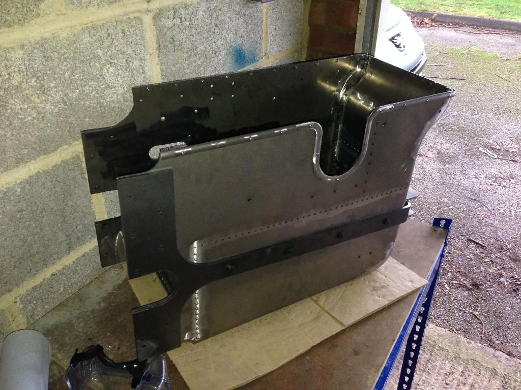

Post  storey on Mon 06 Jan 2014, 7:51 pm
After Christmas and new year I felt I better make some more progress, the front wheels are being sprayed by a professional and I got stuck into Kit 7.
The tender was a long but simple process, only half a dozen holes needed drilling to make everything fit. Now debating how best to seal the inside and what impact that will have on painting. May go down the powder coat route.

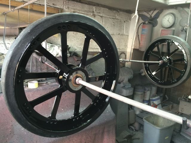

Post  storey on Fri 14 Feb 2014, 8:14 pm
Just a quick update.
I Picked up the wheels from a friend who is a professional sprayer/metal finisher. I am really pleased with the outcome.
Eagerly awaiting the next kit, will practise my lining in the meantime.
