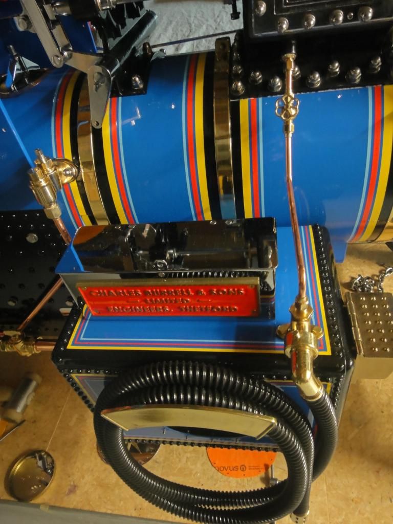

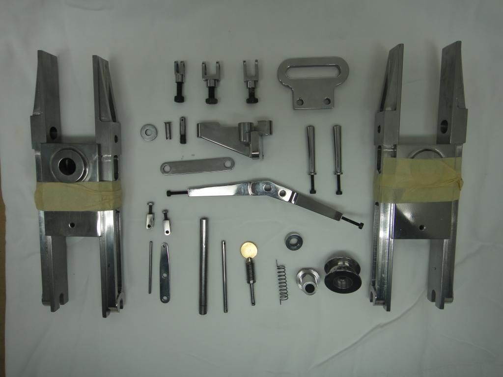

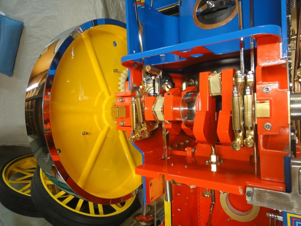

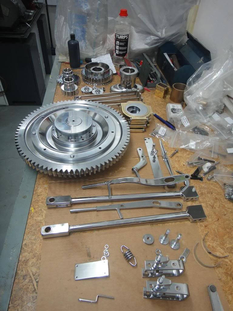

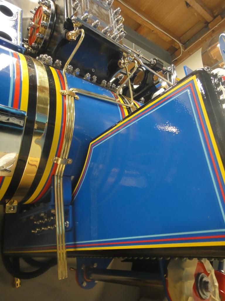

Hello fellow builders. I have been a bit remiss of late with posting some of my progress with the viaduct and raised track project at my model engineering club taking up most of my spare time. The viaduct is now finished and we are having lots of fun testing the track before we open to the public in a month or so.Have been spending a lot more time in the workshop and making some progress. As I thought the metal polishing is a mindless task but am pleased I spent the time as hopefully the results speak for them selves.

I have just completed my last batch of metal polishing yesterday and couriered today to the chrome platers .Hope doesn't get lost.

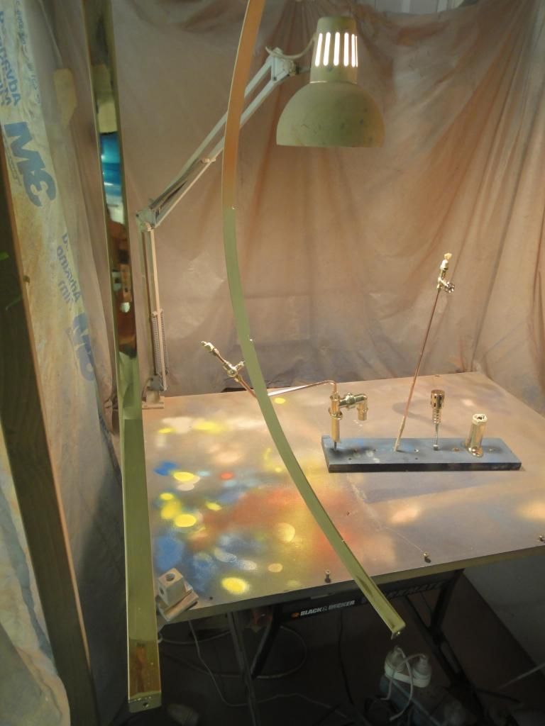

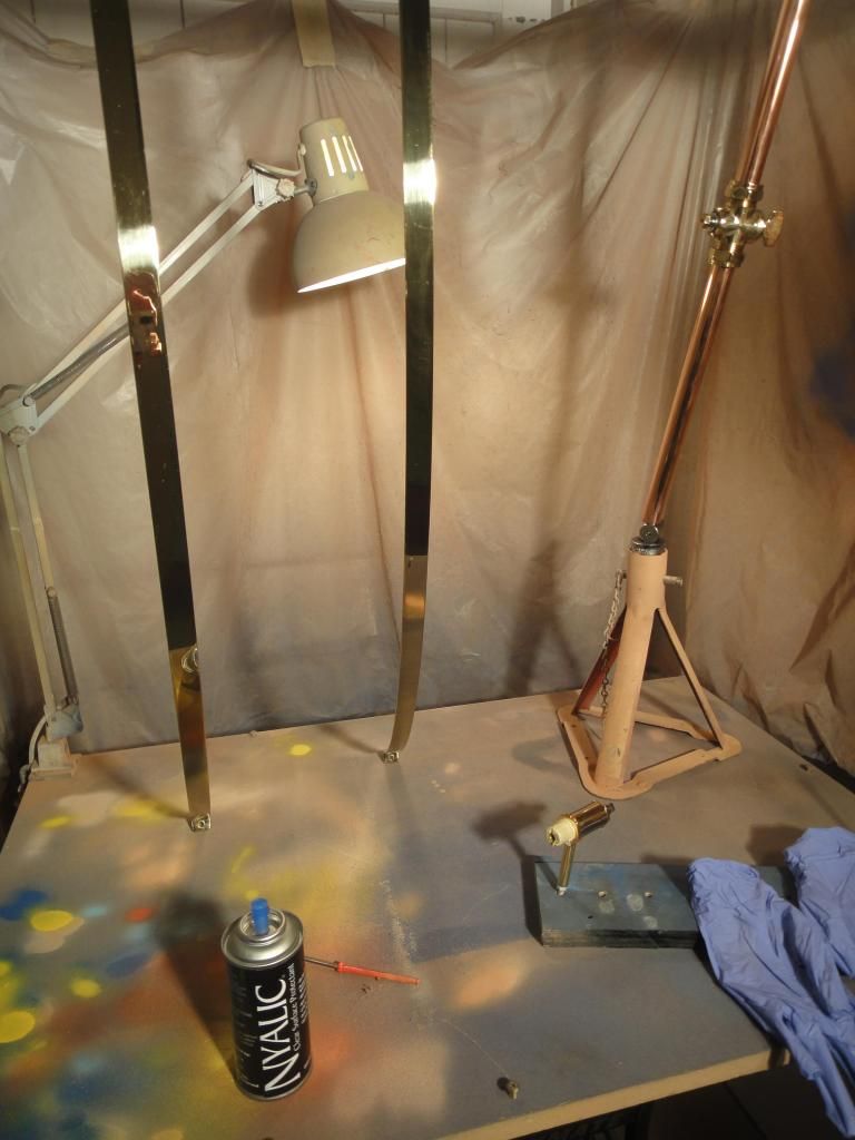

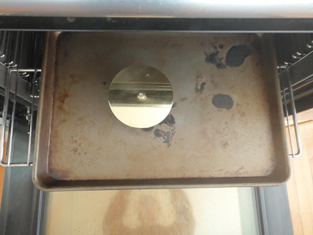

I have been gogitating on how to keep the brass blinging without the elbow grease, time and copious quantities of brasso. What does a man do when he doesn't have an answer why of course he googles the problem(note gender specific).Have found a product marketed down here under brand name of Nyalic. Apparently invented for NASA as a heat and dirt proof clear coating for non ferrous metals.Sold in a spray can. Did some testing(highly scientific of course in the bosses oven) and heated brass disc up to 200 degrees c. No apparent breakdown in surface coating. Good enough for me so have been coating a lot of my brass. Happy with the results

Thankyou Tony and Tim. Only time will tell if the nyalic coating is fit for purpose. Painted the brass disk over a month ago and no discolouration yet even with the salt laden air where we live.The non painted side has discoloured significantly during this time. The beauty of the product is it is so thin and hardly noticeable .Have sprayed my water pump ,taps etc without dismantling and they seem to still work fine. No clogging of threads etc .Look forward to putting names to faces at GDSF. Kind regards Shane

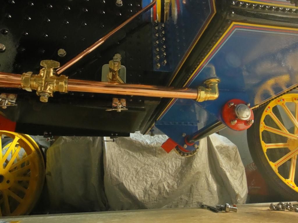

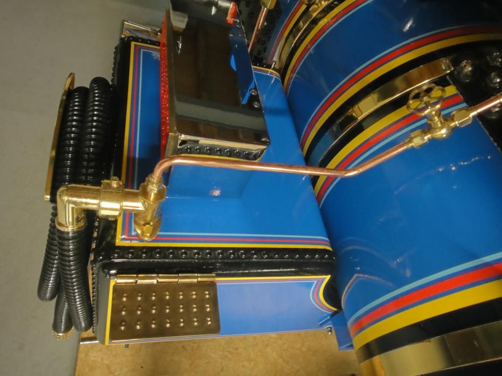

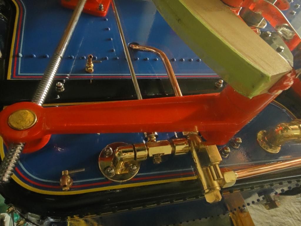

Hi, With all the extra time I now have managed to make and install new cylinder blowdown lines and waste oil line from the drip tray last weekend. Whilist the copper tube supplied by STW was fit for purpose(but a bit short to clear the belly tank) I wanted brass (as one would expect) tube for the bling factor. I have used 3/16 OD brass tube and carefully and frequently annealed when completing the bends in my tube bender. For those interested the curves (except the curve of the cleading)are all half inch radius .The curve around the cleading I managed to do by hand without using the tube bender. I silver soldered the end of the 3 tubes together to keep tidy and new olives to the top ends. Applied nyalic to the ensemble to preserve bling . Another job ticked off. Cheers Shane

Shane
Burrells normally fitted brass cylinder drain pipes rather than copper. Are your pipes going to clear the steering chains?
Number of posts : 558
Re: Starlight Express
Post  showman shane on Mon 21 Jul 2014, 11:34 pm
Good point Tim. I will check tonite. Easy to shorten.Thankyou. Shane.

Post  highpressure on Wed 23 Jul 2014, 4:59 pm
I would also recommend modding the drip tray to cover the length of the slide bar to the weighshaft, a lot of oil falls off here. You might also want to consider a second drain line on the other side. I think there is a shot of it in my thread as I have just done the same.
