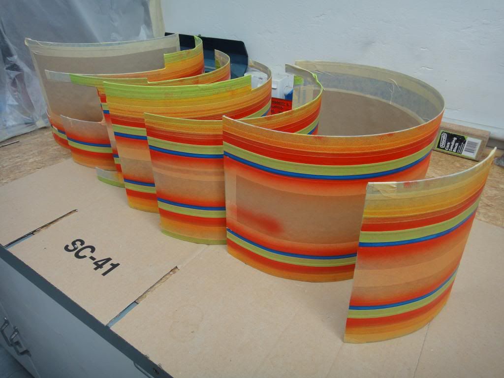

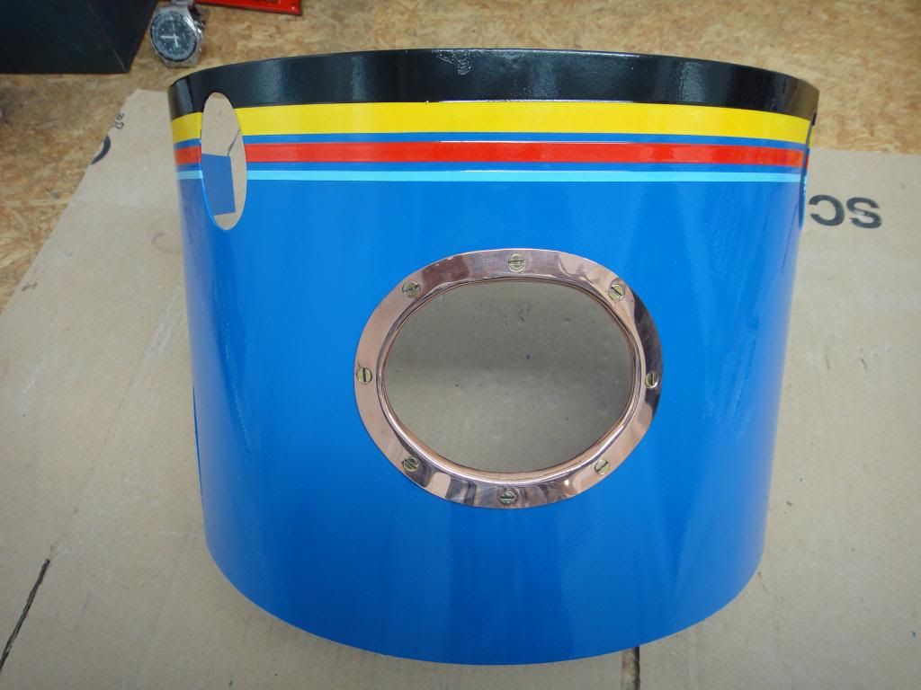

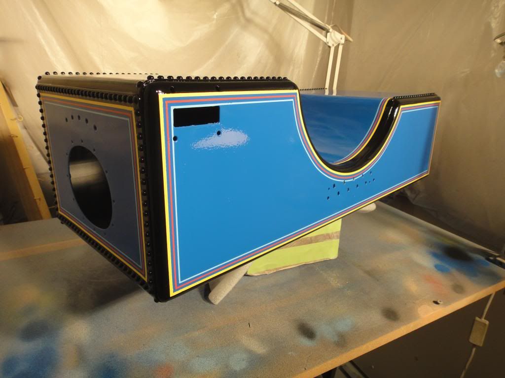

Post  showman shane on Sun 10 Nov 2013, 10:23 pm
Hi fellow builders and others interested.

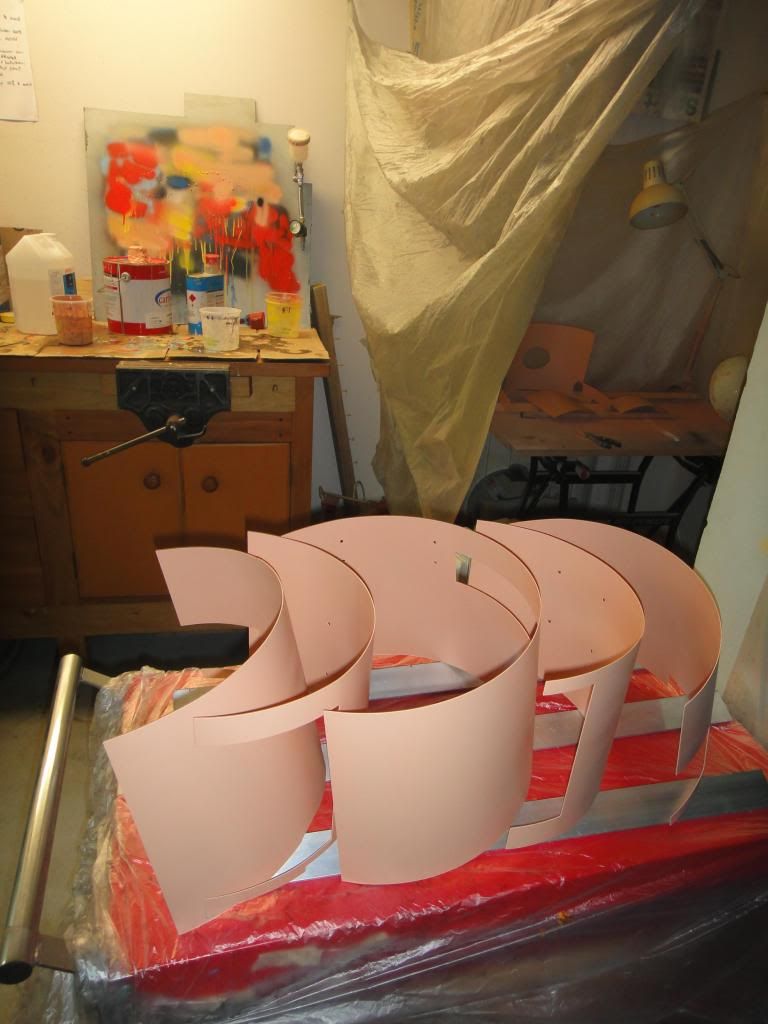

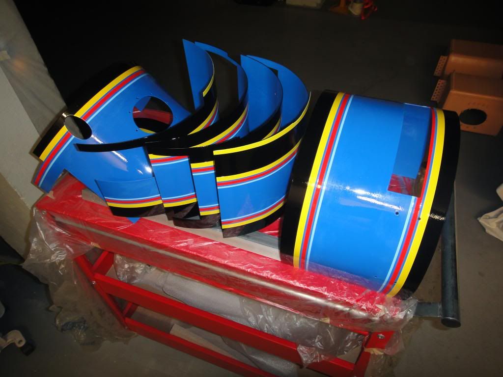

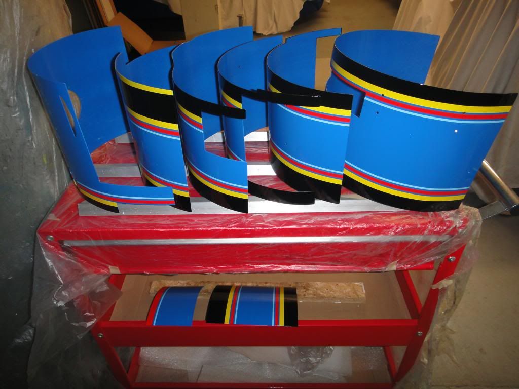

Update on my build and photos below .Have been concentrating since my last report on kits 16(cleading) and 17 (belly tank) also fitted all steering componentry and replaced chains and eye bolts with stainless.
Some general comments for those builders yet to complete these kits which maybe helpful. When installing the hoops on the boiler barrel make sure they are a snug fit. I had to adjust the curves on mine (particularly where they join at the top)to enable the cleading to fit snugly. Spend lots of time(I spent hrs and hrs) fitting the cleading before painting .As the instructions say some trimming required but measure twice and cut once! Remember to allow for the paint thickness. With bringing the belly tank forward the new belly tank bracket does not fit in the gap provided in the cleading supplied. I suggest you fit this new bracket and trim the cleading before painting. Not sure if STW have made allowance for the moving forward of the belly tank bracket for subsequent cleading kits. Once all cleading fitted with belly tank bracket in place but before painting I offered up the belly tank for fitting to the brackets .Unfortunately it was fowled by the cleading on one side.I had to adjust brackets and bolt holes downwards and sideways(2mm max))for everything to fit. Pleased I did all this before painting.
Cleading all trimmed and etch primed.
[img][/img]
Painted base colour and fitted again to check before pin striping
[img][/img]

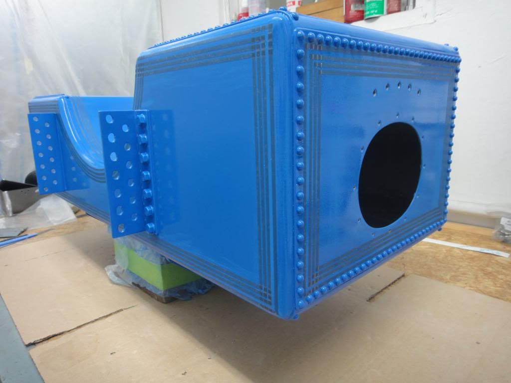

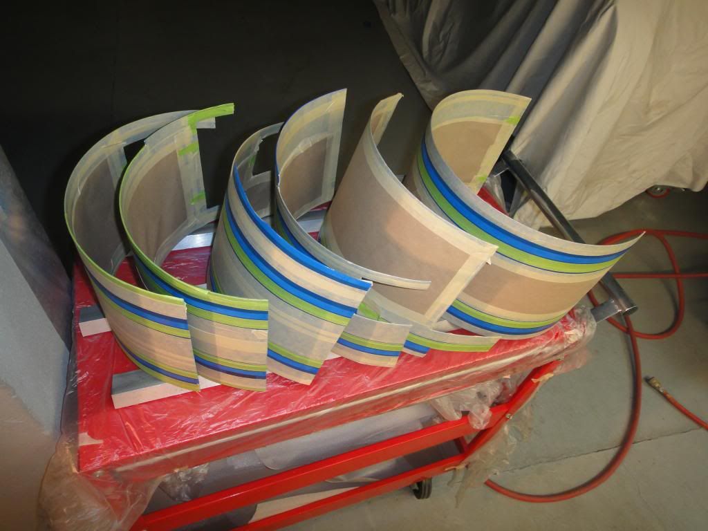

Post  showman shane on Mon 11 Nov 2013, 12:04 am
Start of pin striping
[img][/img]
[img][/img]
Had to contend with 4 colours on top of blue for first time.
[img][/img]
[img][/img]

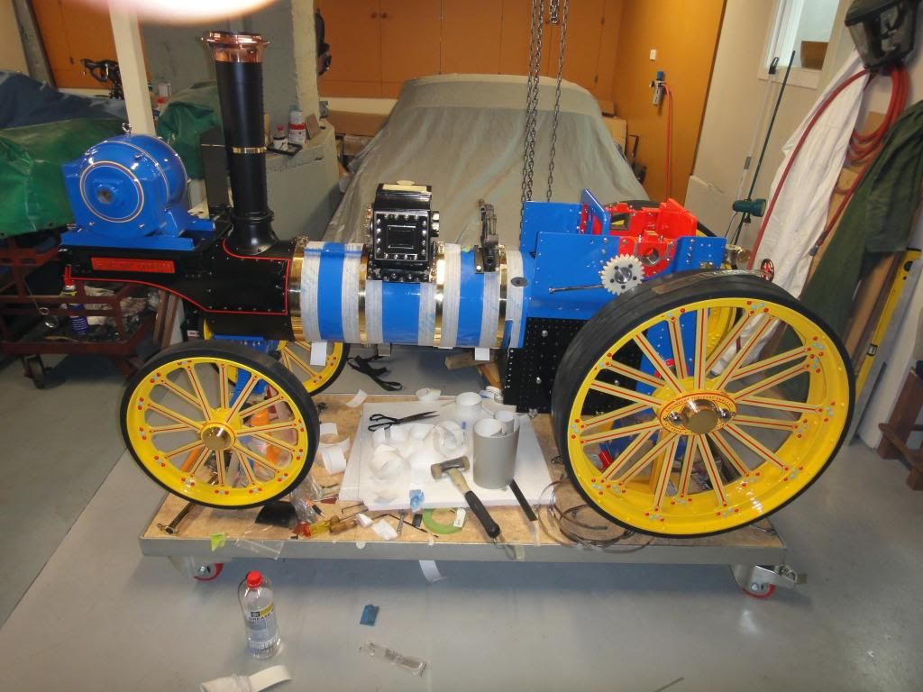

I centered the man hole ring on the cleading when in situ so as dummy clamp would not fowl the edge. Also had to cut a hole in cleading to fit the fly wheel brake bracket on inside of hornplate.You can just see the hole in the picture below.
[img][/img]
showman shane

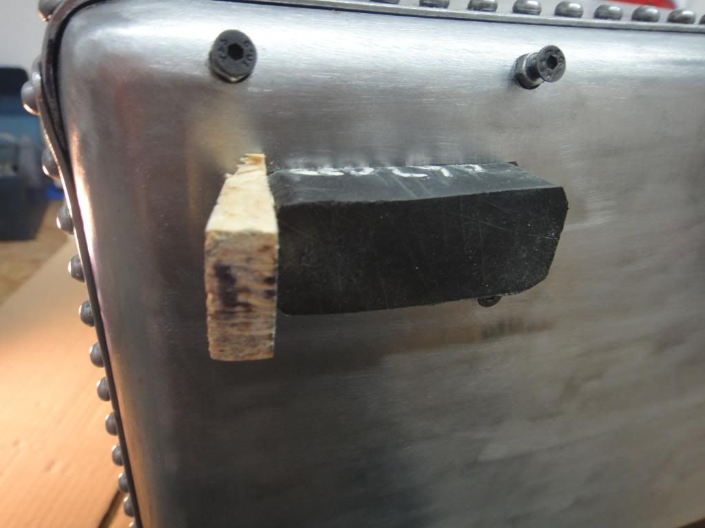

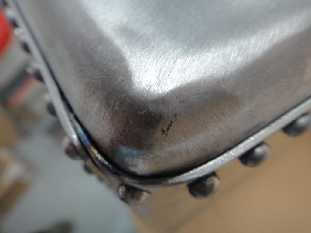

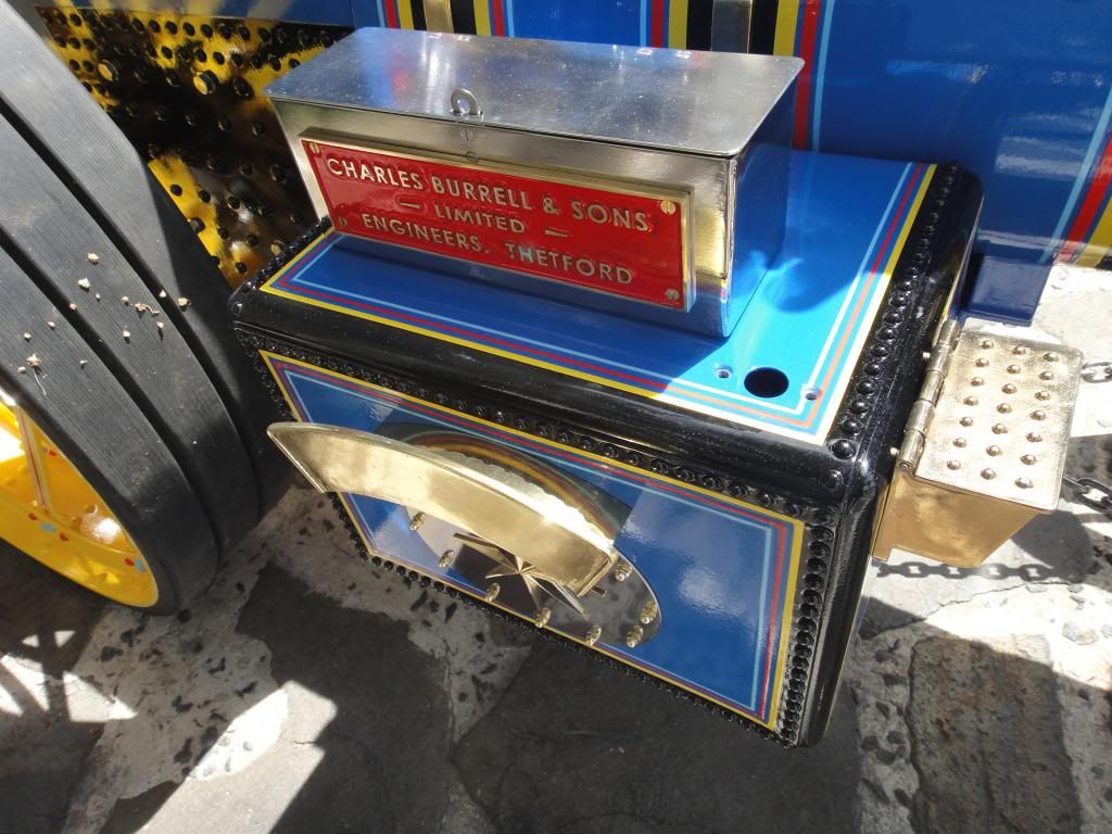

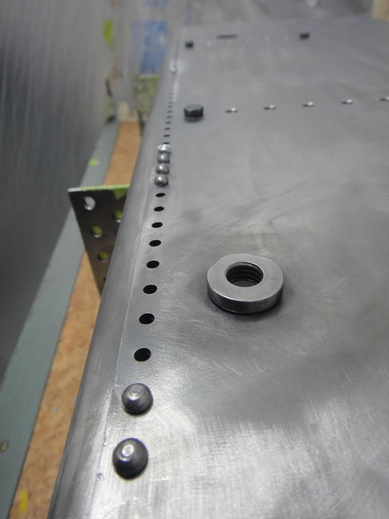

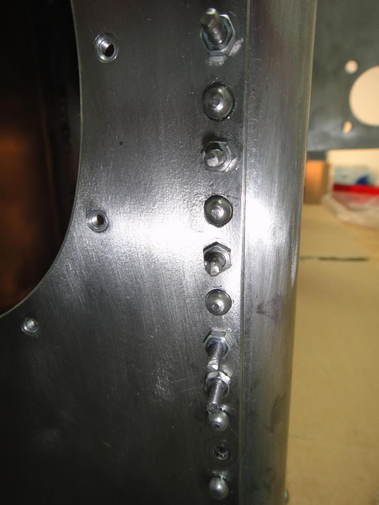

Kit 17-Belly Tank
This kit lived up to all the comments both good and bad made by other builders. Apart from wheels probably the most satisfying part of the build so far now that it is finished. Purchased a 100 or so high tensile hex machine screws to pull the panels together.Being high tensile the threads did not strip.Came together beautifully which is a real credit to STW.I bolted every other hole then inserted nutted rivits in the holes between .A pain but no gaps as the photos show. Any mis- alignment of holes was minor and easily fixed with a round needle file. Did not use a drill as the drill tended to track to the hole in the bottom panel which then could have made the rivet heads on the top panel uneven.
At the start-boy there are a lot of rivits.
Look no gaps!- as the add for filler goes in NZ
Now setting up for Por 15
showman shane
Re: Starlight Express

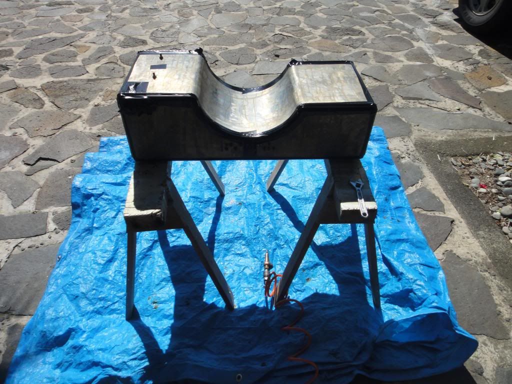

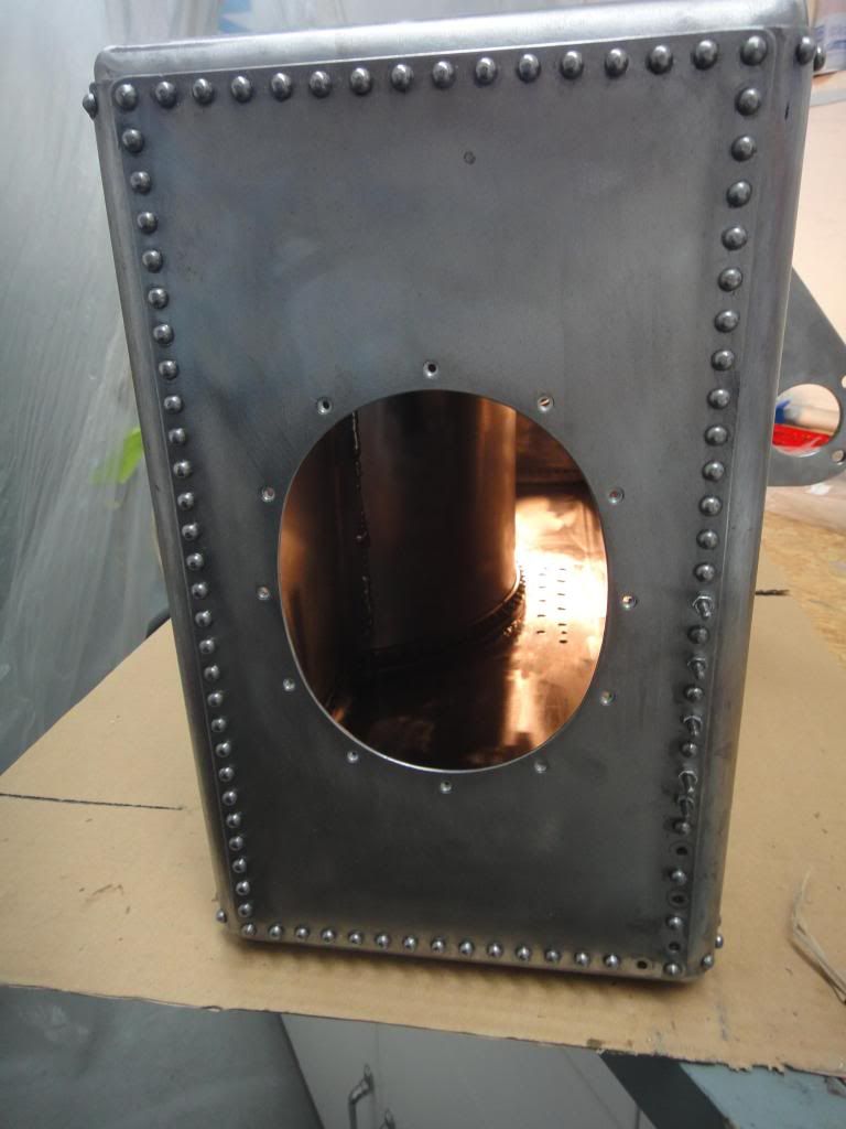

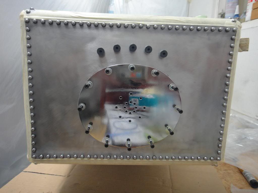

Post  showman shane on Mon 11 Nov 2013, 1:05 am
[img][/img]
Taped the edges and followed the directions to the letter set out by Por 15.Also pressurised (low)the vessel to push the brew out the joins. As drying wiped as much off the outside as possible.
[img][/img]

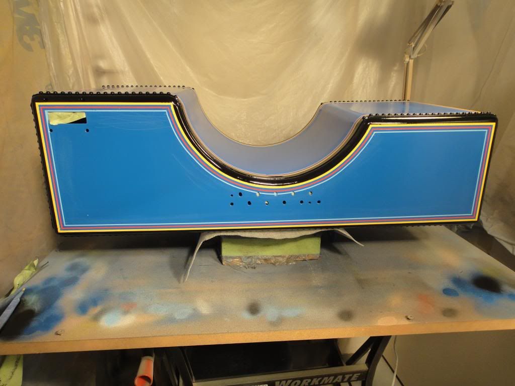

Then etch primer.
[img][/img]

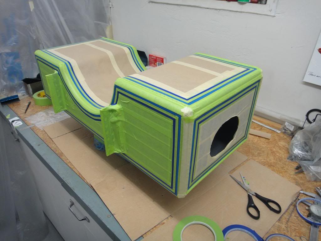

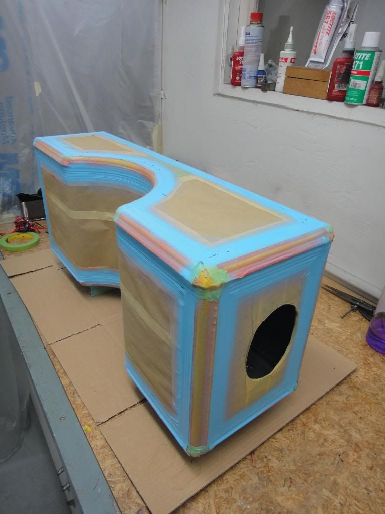

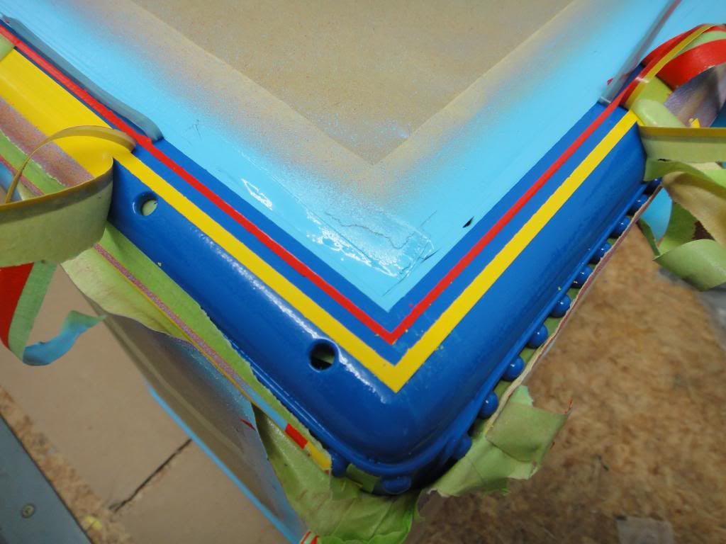

Getting ready for pin striping with "the system"
[img][/img]
Masked up.
[img][/img]
showman shane

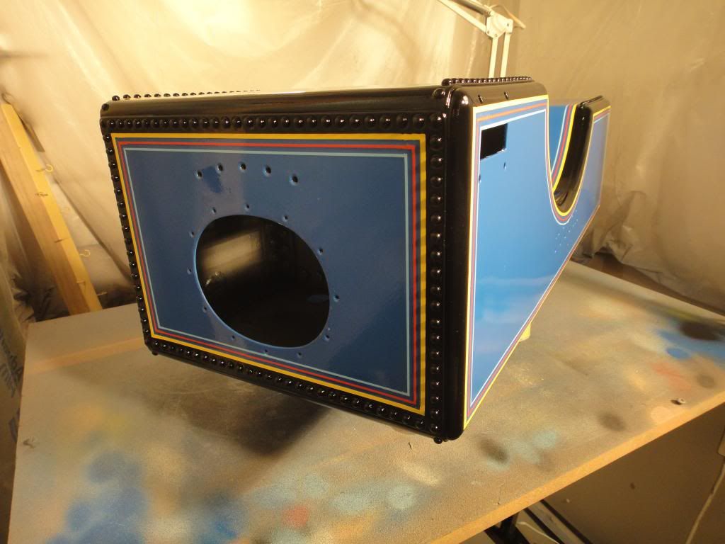

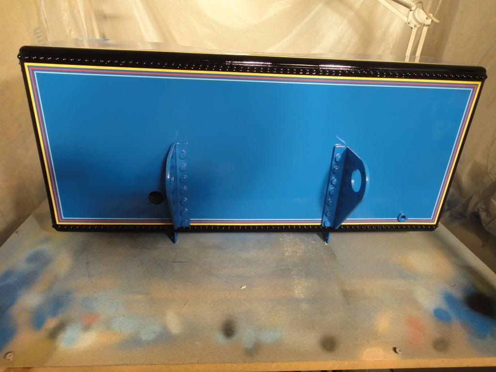

Post  showman shane on Mon 11 Nov 2013, 1:12 am
[img][/img]
Starting to come together.
[img][/img]
light sand b4 3 coats of clear
[img][/img]
And finished -ya hoo!
[img][/img]
[img][/img]
even pin striped the bottom for the rivet counters.
[img][/img]

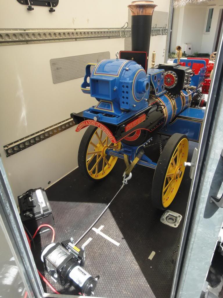

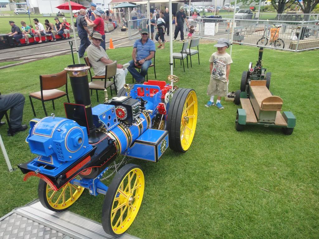

Post  showman shane on Mon 11 Nov 2013, 1:22 am

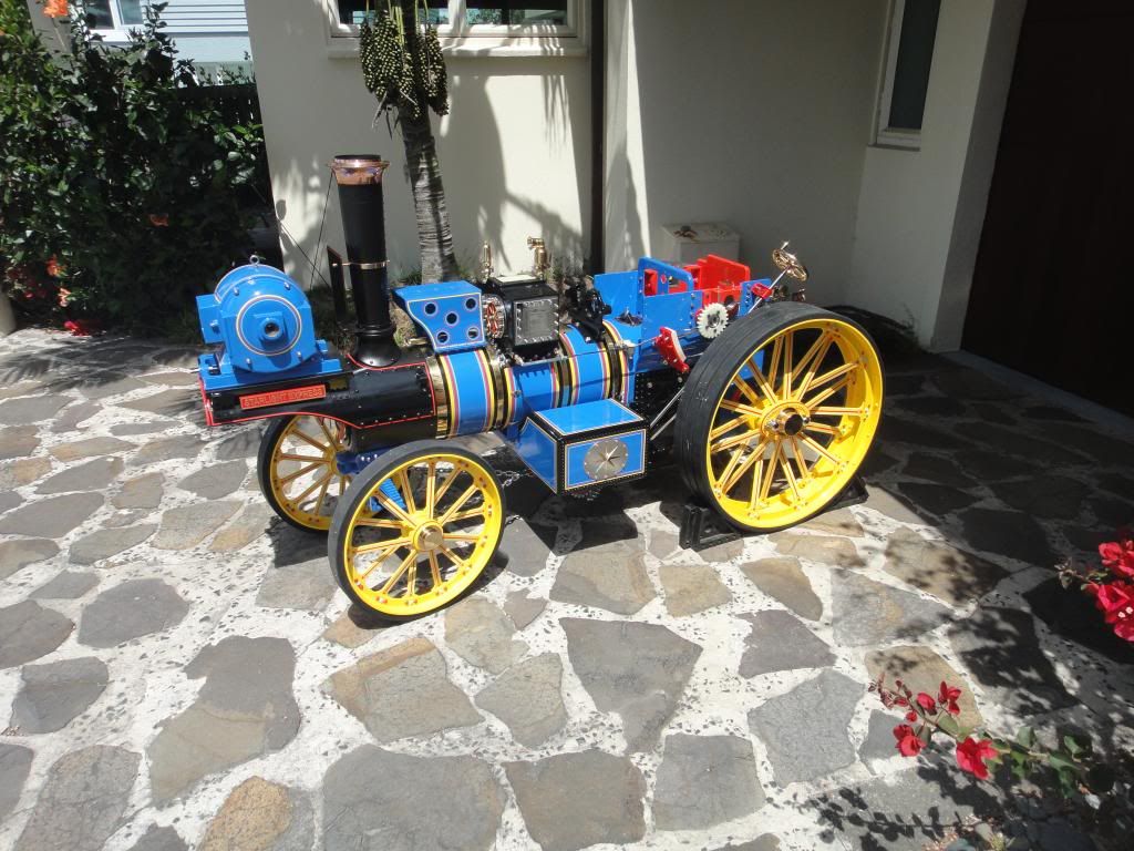

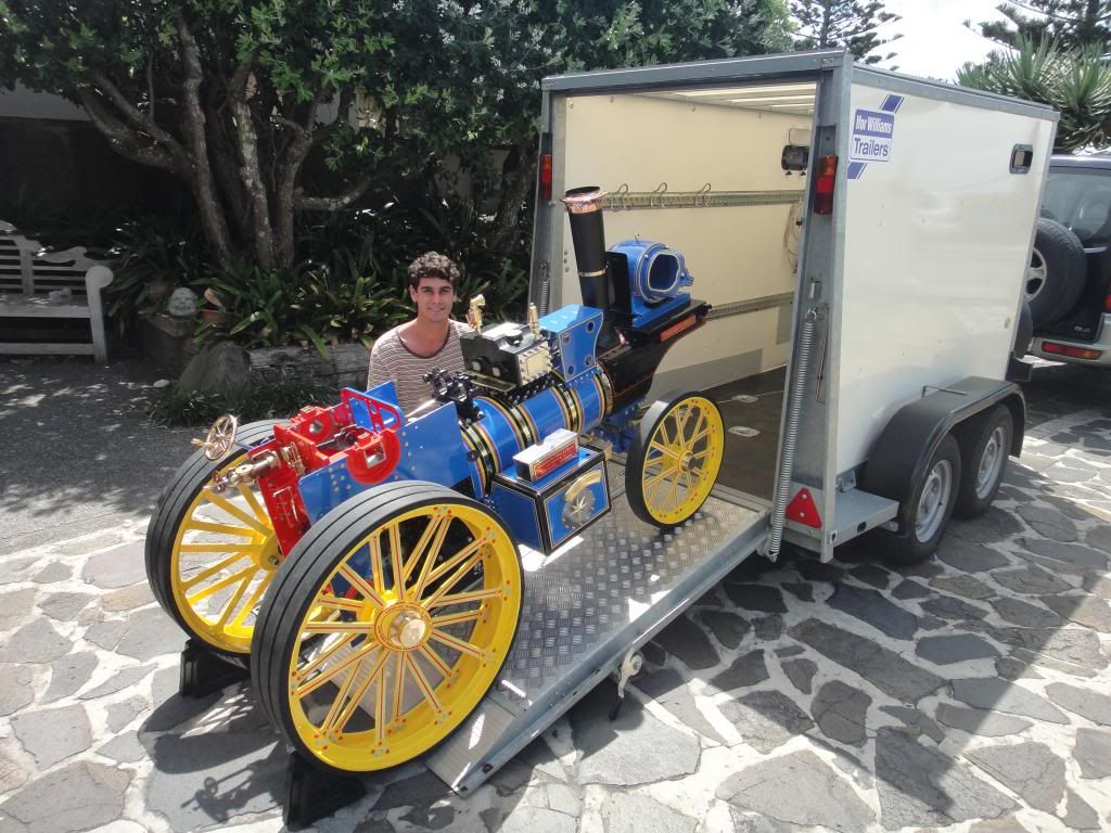

All ready for her first public outing
[img][/img]
[img][/img]
[img][/img]
Then into the trailer-ifor Williams of course!
[img][/img]
[img][/img]

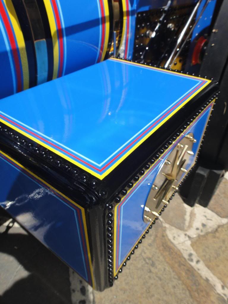

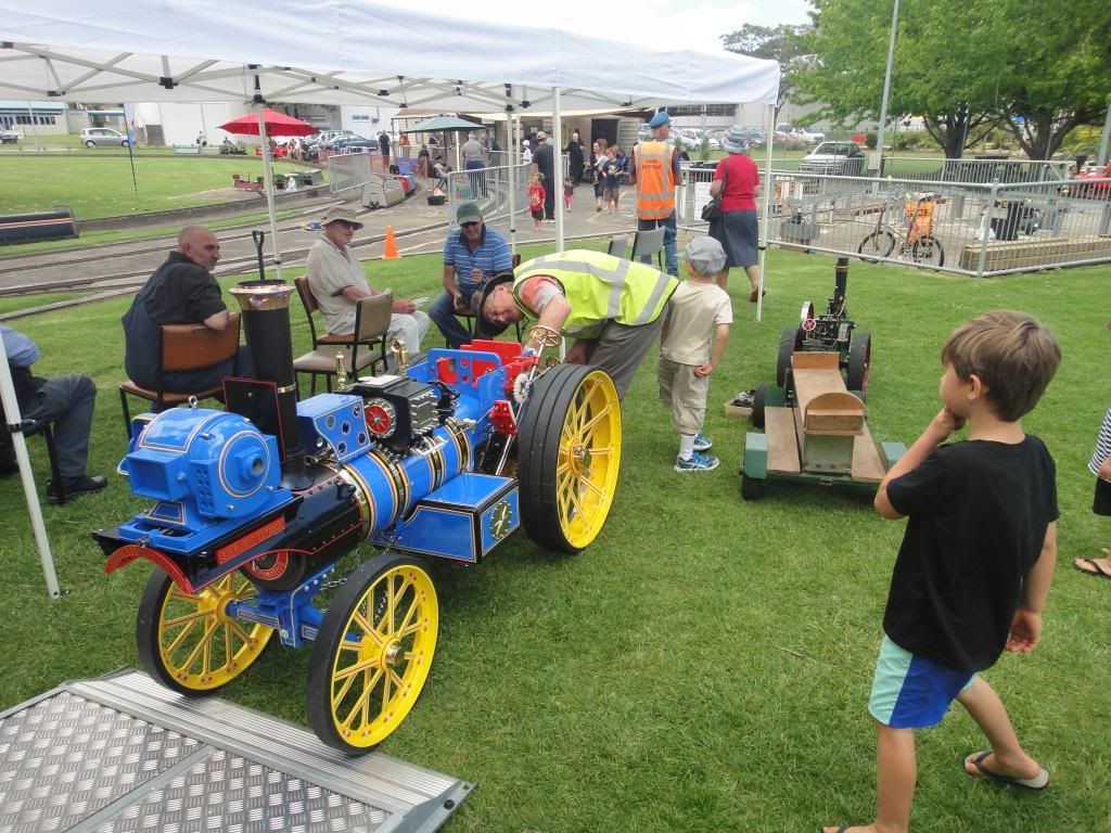

And at our clubs open day.Lots of positive feed back.
[img][/img]
My friend Bruce looking for a fire-at least a year away.
[img][/img]
