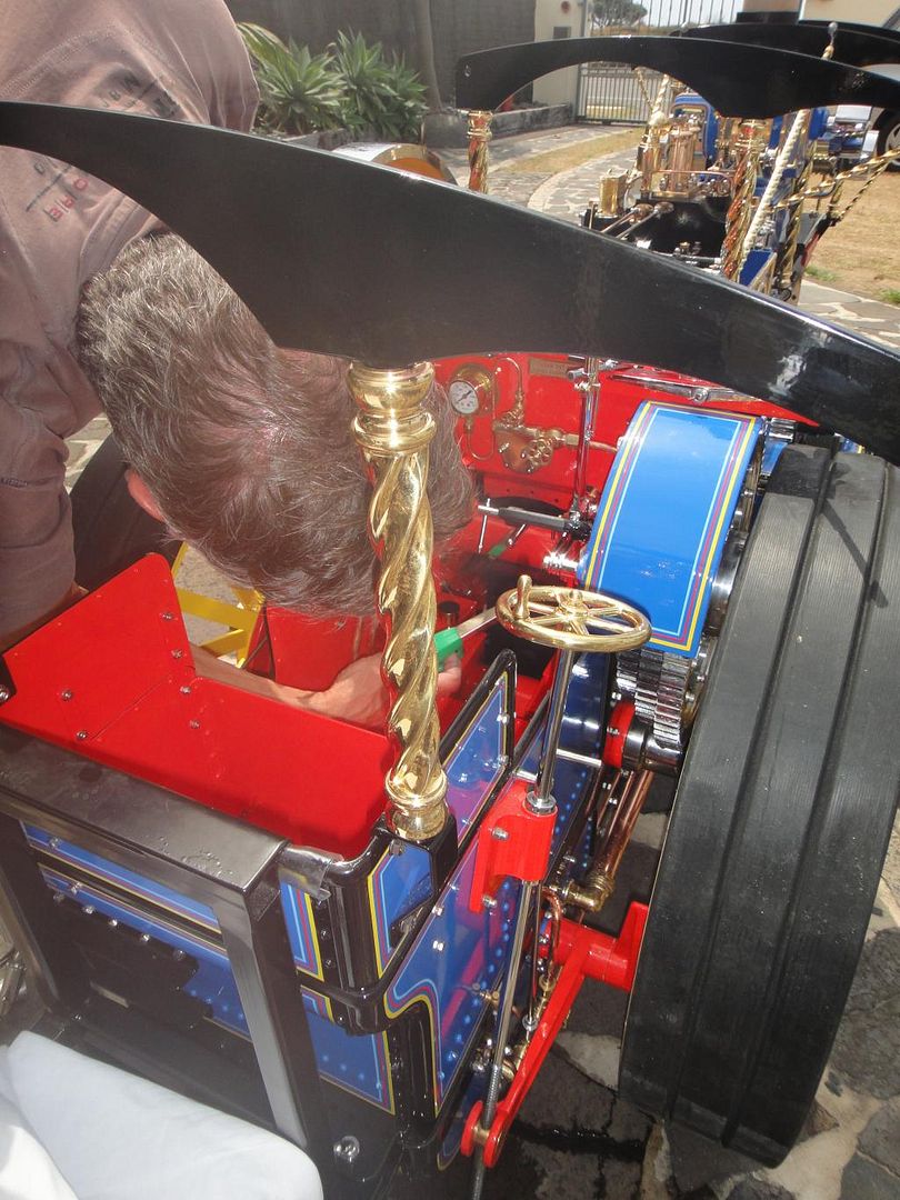

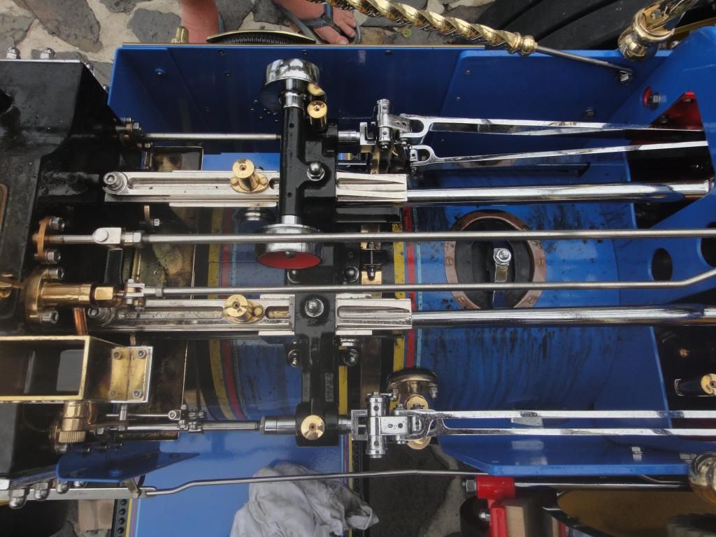

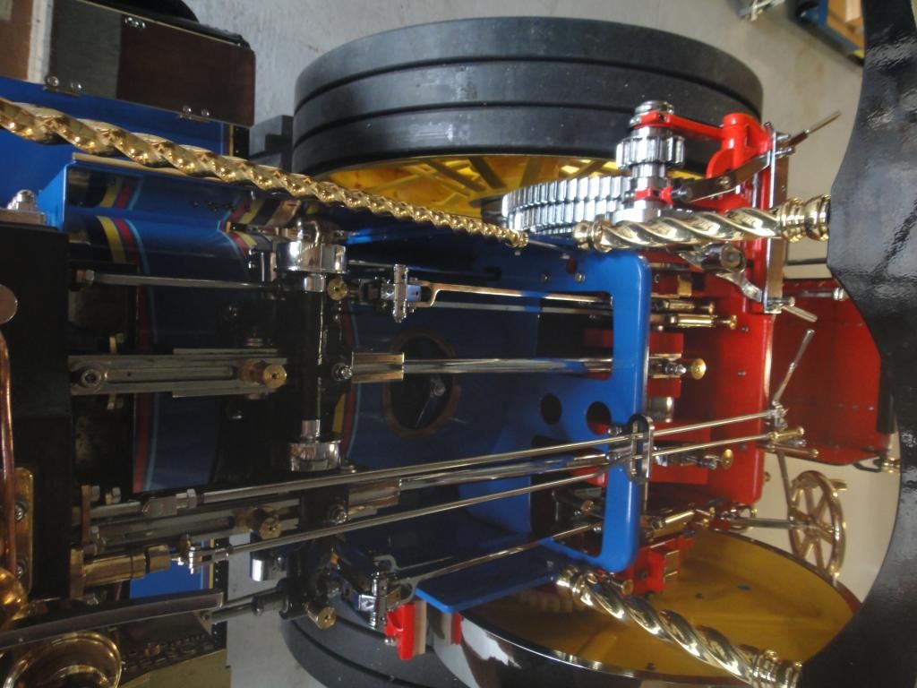

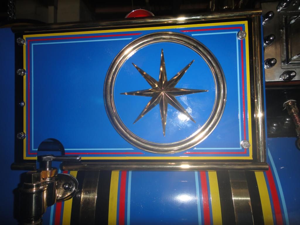

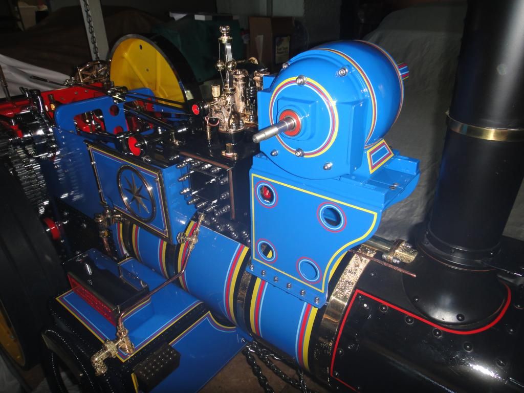

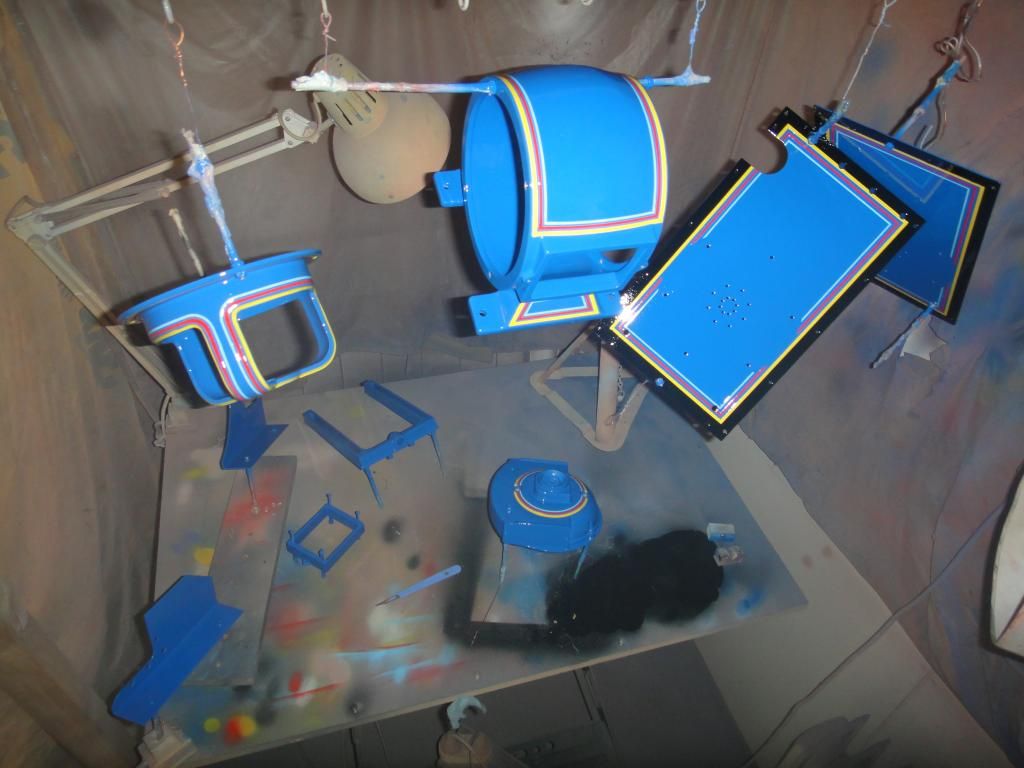

Hope everyone had an enjoyable new year. Have not had the opportunity to do to much since my last post as the sun has been shining and the surf to good to miss. Some photos of the pin striping on the motion guards and the exciter. With any luck this will be the last lot of pin striping required on the engine.
Next job the canopy .
Cheers Shane

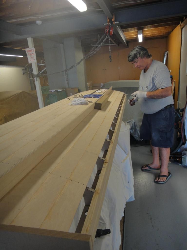

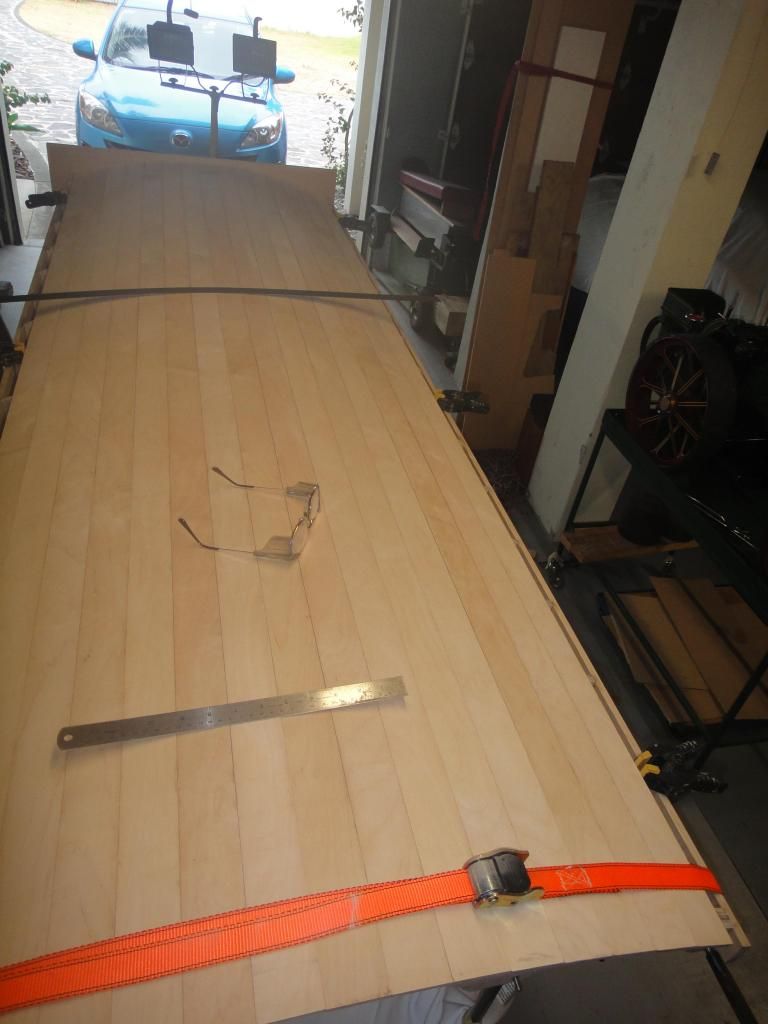

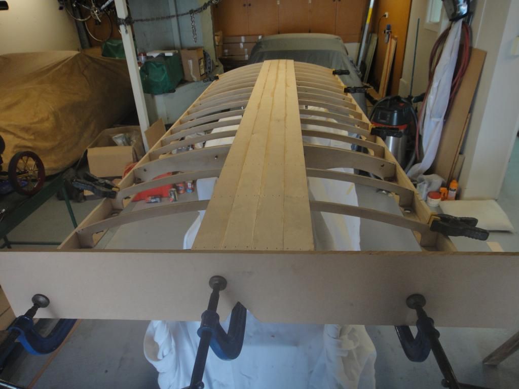

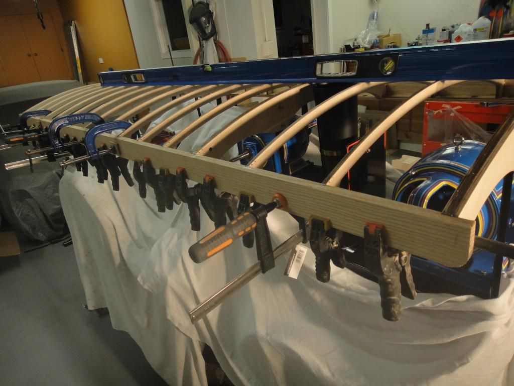

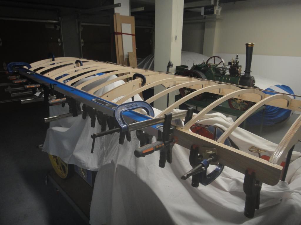

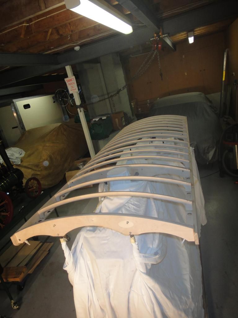

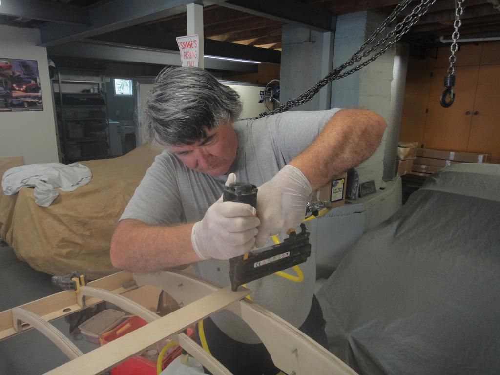

Hi comrade builders and others interested. Have started on the canopy for Starlight Express .Wow you certainly get an appreciation of the size of the engine. Quite imposing really and well worth the wait. The canopy went together beautifully after of course trial fitting all the ribs etc. Small amount of work with the chisel but nothing too onerous.
[img][/img]
[img][/img]
[img][/img]
My mate Murray a part time classic boat builder and now a traction engine canopy builder has assisted me with the build. His experience has been invaluable. We used his brad nailer or finishing gun to attach the roof .For those interested the nails were 15mm long and 18 gauge.A tool well worth using to attach the roof strips.
[img][/img]

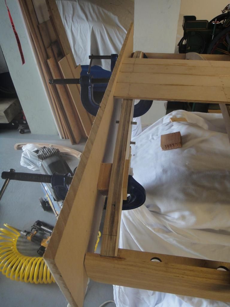

With the centre strip on we checked that all the other strips were straight and fitted. Wasted our time cos they were !
[img][/img]
Clamped some board at the front of the canopy with blocks on the inside to ensure board straight. All the roof planks butting up to the board ensured they were kept even.
[img][/img]
showman shane

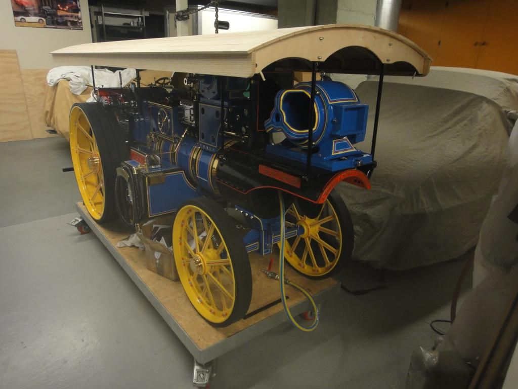

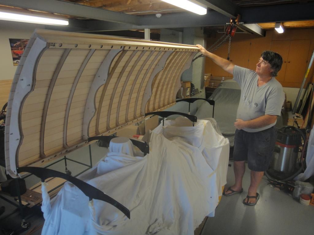

We used two pack boat builders glue and tried to clean up as much as possible after each plank was nailed. Last plank.Allow plenty of time.It took Murray and I all day to glue and nail the planks
A better shot of the board at the front to keep all even.
Good days work. Steve Traill gave me good advice at Dorsett to make each plank look like tongue and groove. Murray had the table router and quite easily done if you do before installation!
Starlight express with the canopy  now has a certain presence.
Still to finish fibre glassing the top,painting and pinstriping.

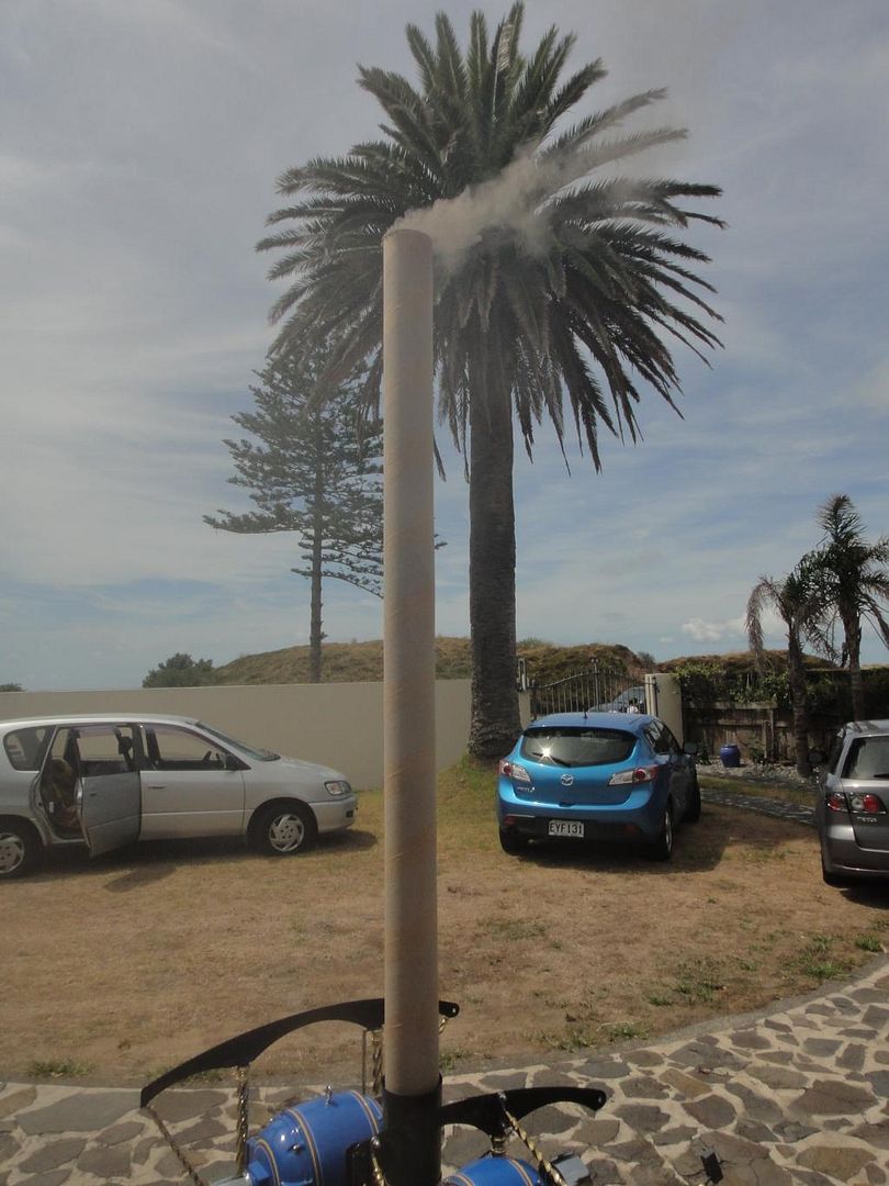

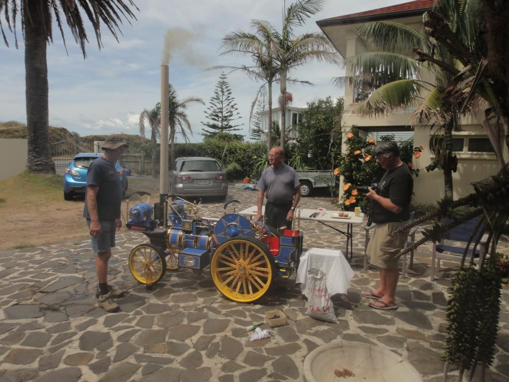

Hi All,An interesting day last Saturday. After waiting and waiting and still waiting my patience for Tony to fire his engine before mine evaporated (in a puff of smoke) and I just had to light a wee fire in Starlight Express' belly. First had to sort some issues out with the water pump. The nipple at boiler end of pump delivery pipe was leaking badly. My expert witnesses (both engineers) wanted to re silver solder the nipple in situ. After waving the blow torch around my nice paint work I had to pull rank and call stop work while I removed the pipe all together. This necessitated removal of wheel, fly wheel etc. Bob had it fixed in a jiffy. Should have done the other end as well as it started leaking later on. Must have been brazed by STW towers on a Monday after a bank holiday weekend.
[img][/img]
Lit the fire. Thought I had lost more hair than photo indicates with the challenge of the build.
[img][/img]
No forced draw on this baby. The cardboard tube from the local carpet worked a treat. My advisors thought that the tube would catch a light and shorten considerably. Proved them wrong.
[img][/img]
[img][/img]
All went well. Brought up to steam over 2 hours and no more than 90 psi for first steaming. Sounded awesome. Thank you to everyone at STW.
