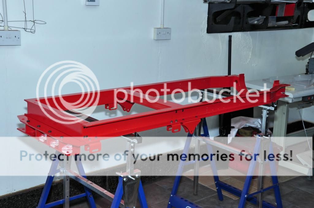

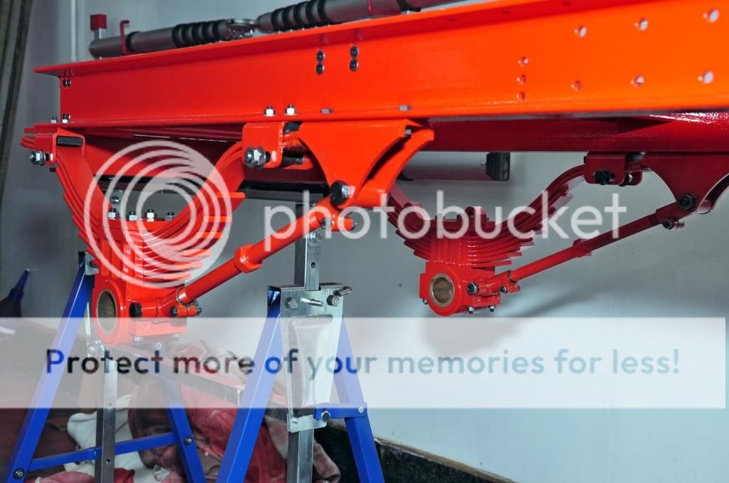

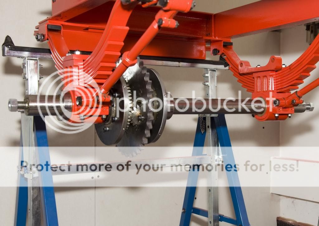

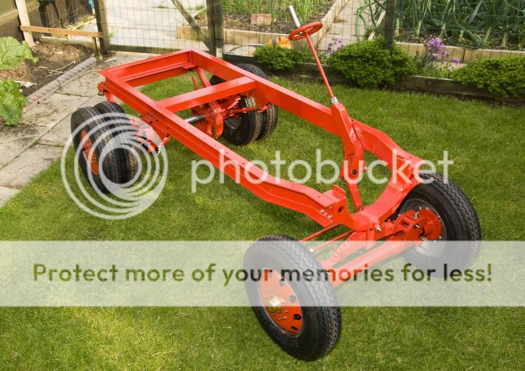

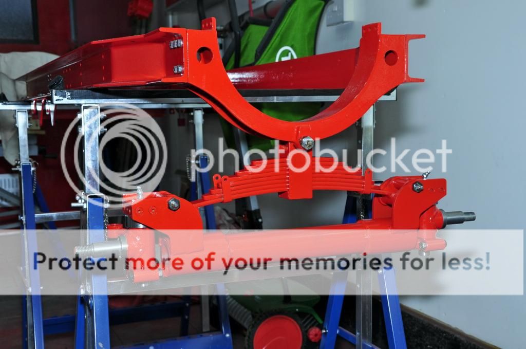

It's been a while since Kit one arrived and there have been a few since so thought it was about time to post some images of the progress so far so here goes.
Chassis
Front axle and Spring Attached to Chassis
Rear Springs + boxes
Front Hub
Rear Axle

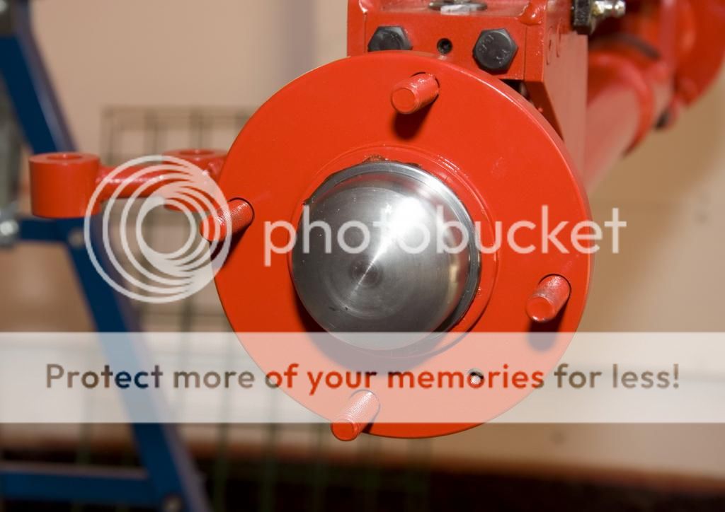

That's the progress so far hopefully sort the rear hubs and trims out this weekend so we can drop it onto the wheels.

We have now completed all the kits delivered to date so have uploaded some more images, the only bits not fitted are the rear wheel centres as these are going to match the body colour and we have not brought the paint yet, also the rear inside tyres are missing valve caps as these hit the spring boxes when fitted so will be taking the wheels back off later to fit shorter valves to the inside rims on the rear.

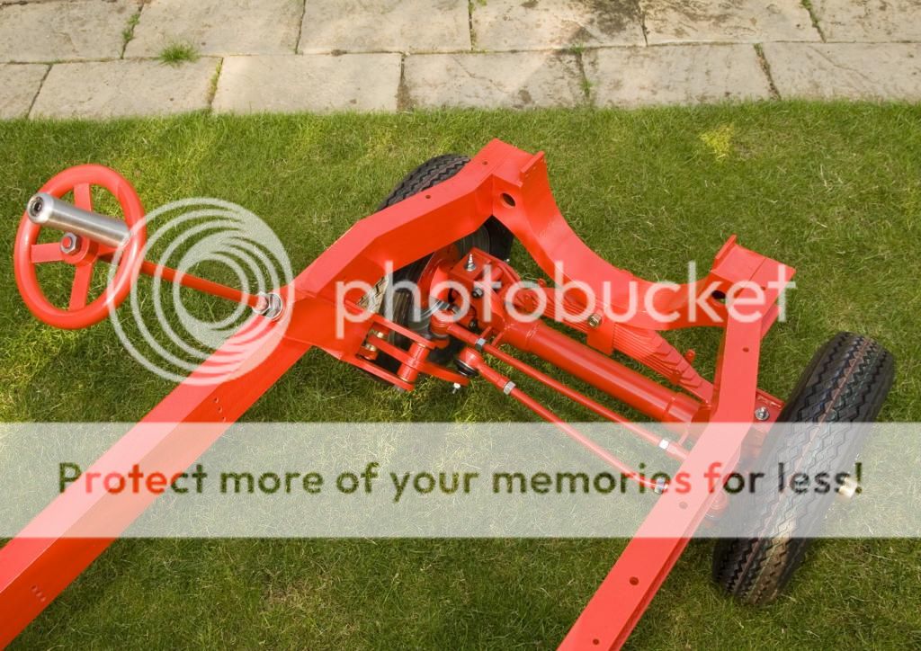

Post  Hecter on Mon 01 Jul 2013, 9:32 pm
Looks lovely in the red, what method did you use for smoothing down the steering wheel and getting rid of excess solder?
Hecter
Number of posts : 50
Age : 25
Location : Luton
Registration date : 2013-02-13
Re: "Chuttie" - 4.5" Foden Build Progress
Post  FodenSWB on Mon 01 Jul 2013, 10:25 pm
Hi Hecter,
We did not do anything I just chucked it in the blasting cabinet as the brazing is soft in cleaned up pretty well without much effort.

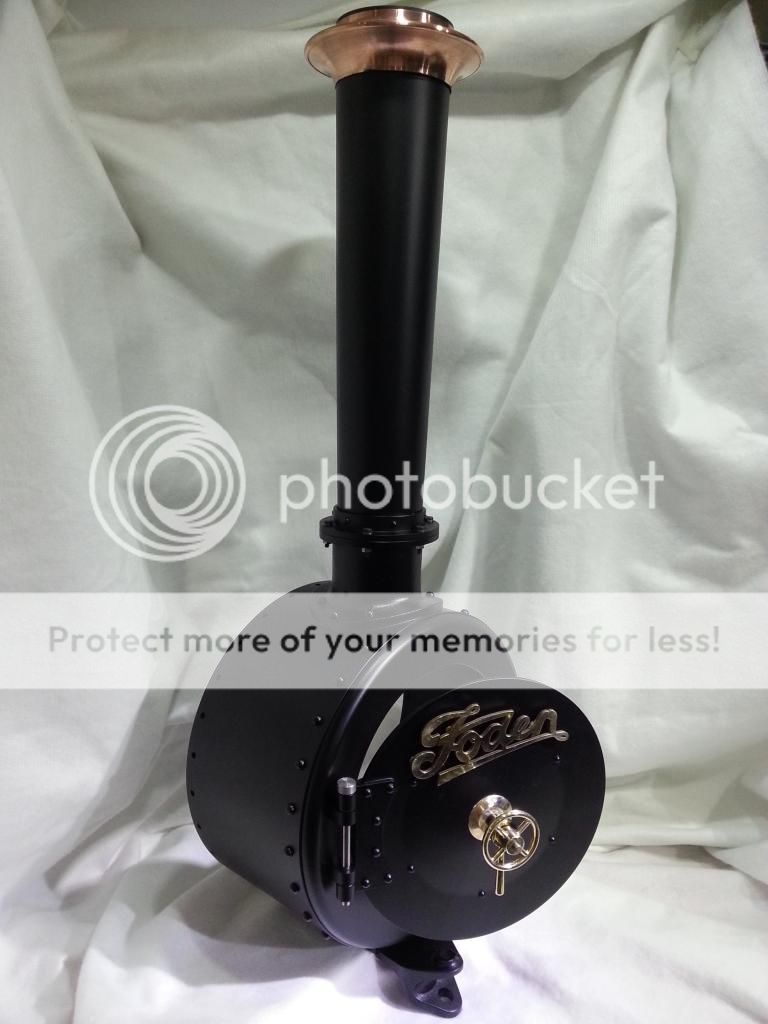

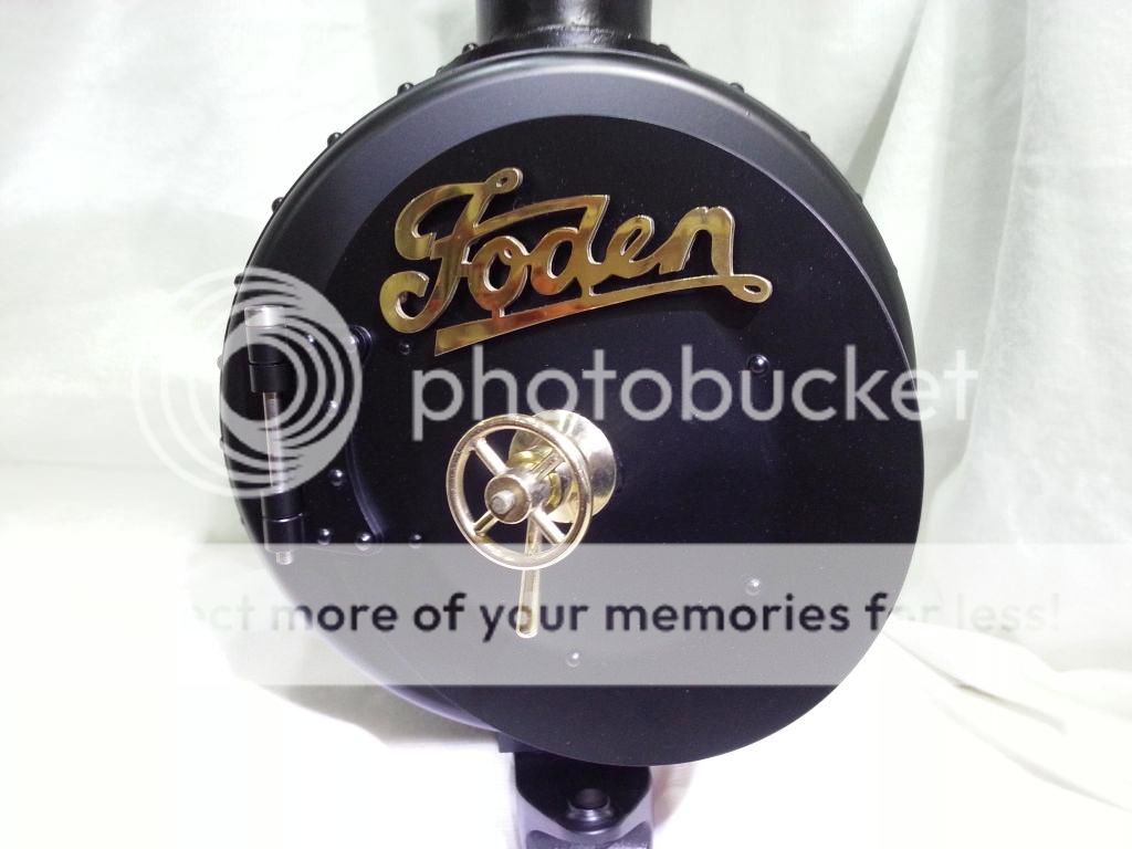

We have completed the smoke box and chimney, but have not started on the cylinder and valve gear yet as my father has been ill since October, he is getting better now but we have just gutted the kitchen and dinning room so wont get a chance to look at the steam engine for a bit.  I have posted some update photo's for the smoke box below we have also finished and fitted the water tank but the weather has not been conducive with rolling it outside for a photo.

Chuttie 4.5 in Foden Build
Post  Old Down Trevor on Tue 18 Feb 2014, 6:42 pm
Hello Nick and Ken- it seems to be coming along nicely. I took delivery of 11 kits on 14th Jan and am busy working on chassis etc.
I liked the finish of the smoke box and chimney- can you tell me what paint you used. It looks a little like the heat resistant paint sold for wood burner stoves.
Old Down Trevor
Old Down Trevor
Number of posts : 13
Location : Bristol
Registration date : 2014-01-09
Post  FodenSWB on Tue 18 Feb 2014, 7:22 pm
It's Satin black high temp engine paint from Halfords I thinned it and sprayed it from my spray gun.

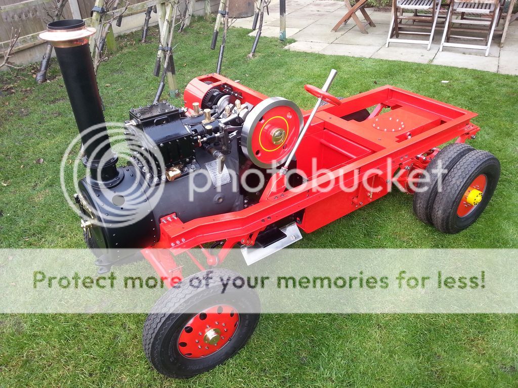

As it was sunny and we have now lined the wheels I thought I would snap another couple of photos outside to show the whole engine so far with the pinstripes, as you can never have too many photos in my opinion Very Happy
Just need another kit now as it is strange not having anything to do at the moment.
