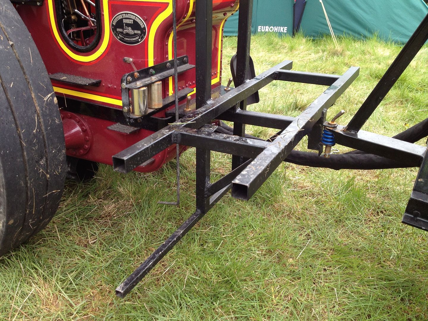

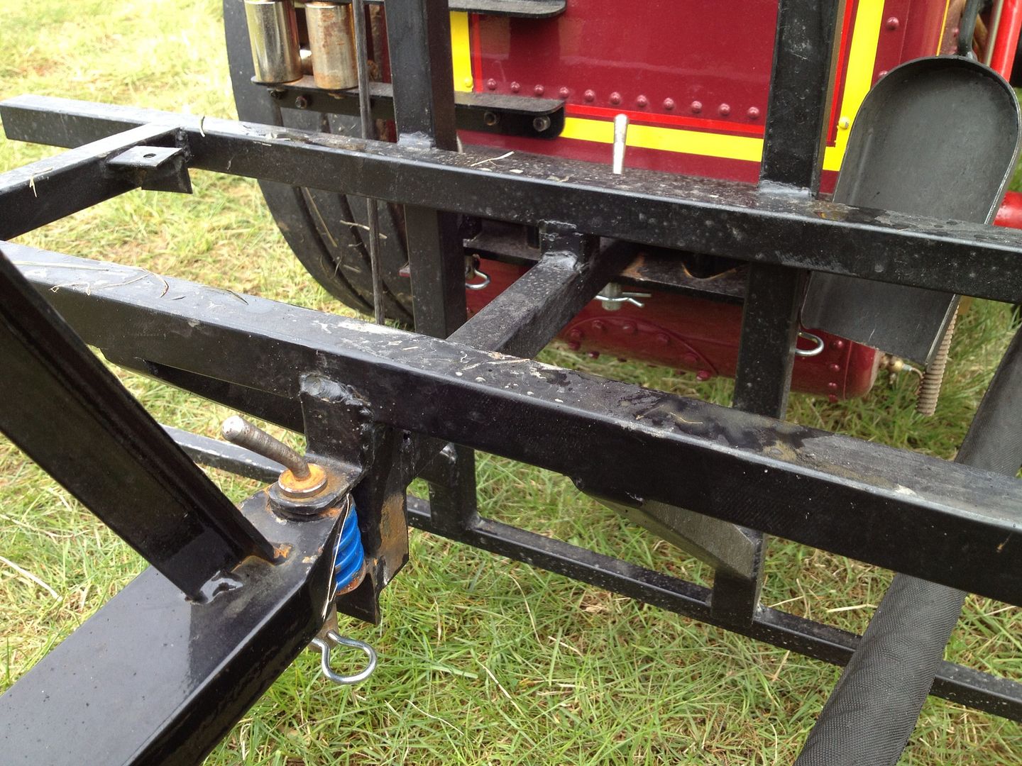

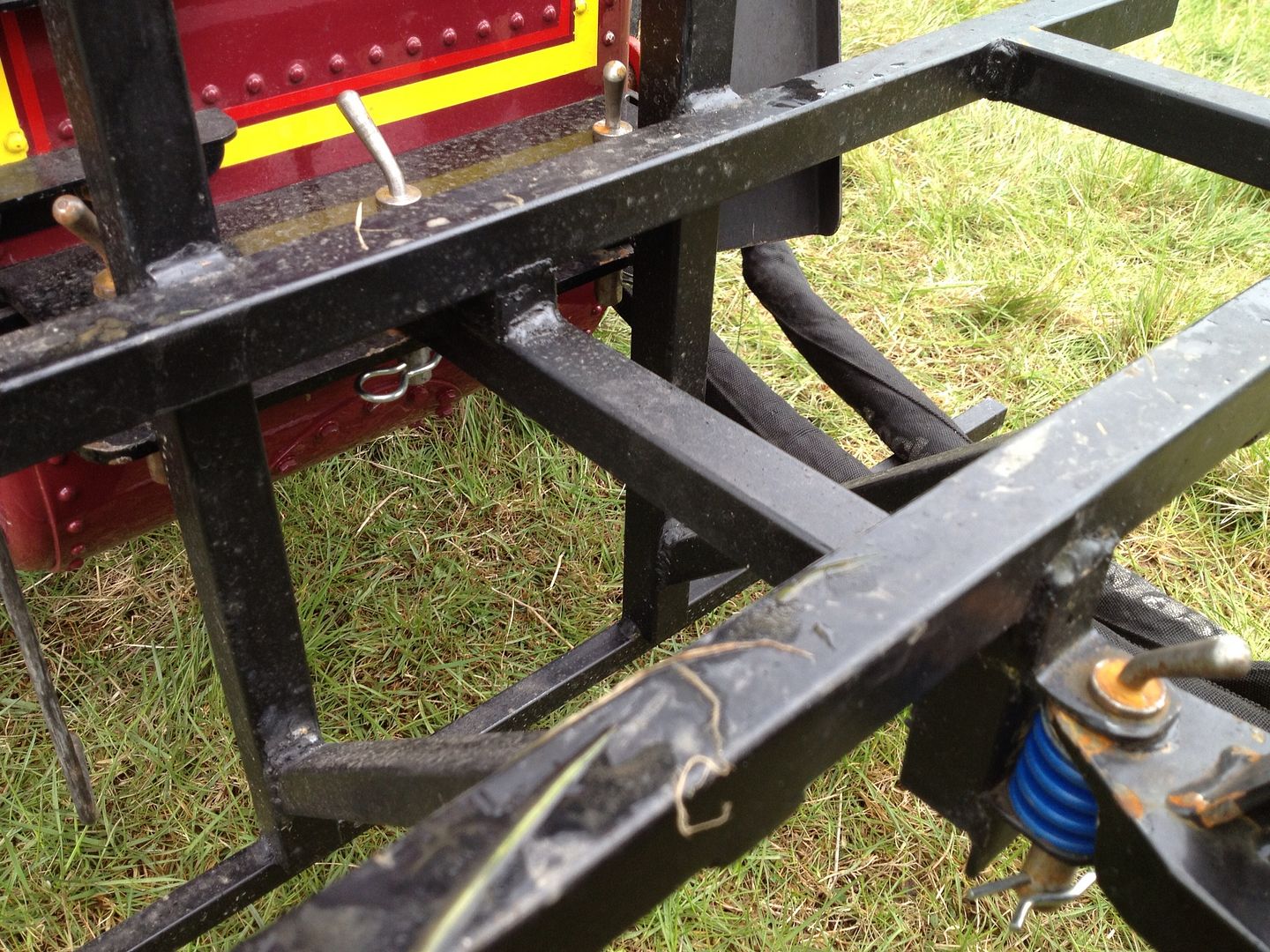

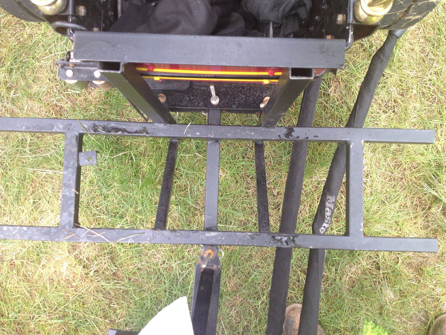

I have added the photos of my seat for completeness.
Seat frame
To reduce stress on the seat frame while towing. I fitted a tube from the central tow pin through the frame to provide the tow hitch at the back of the seat.
No tilting with this securing system. The angle over the top of the tender is almost full width as well.
Still need to sort out padded seats, just been using the pad from the single seat as supplied.

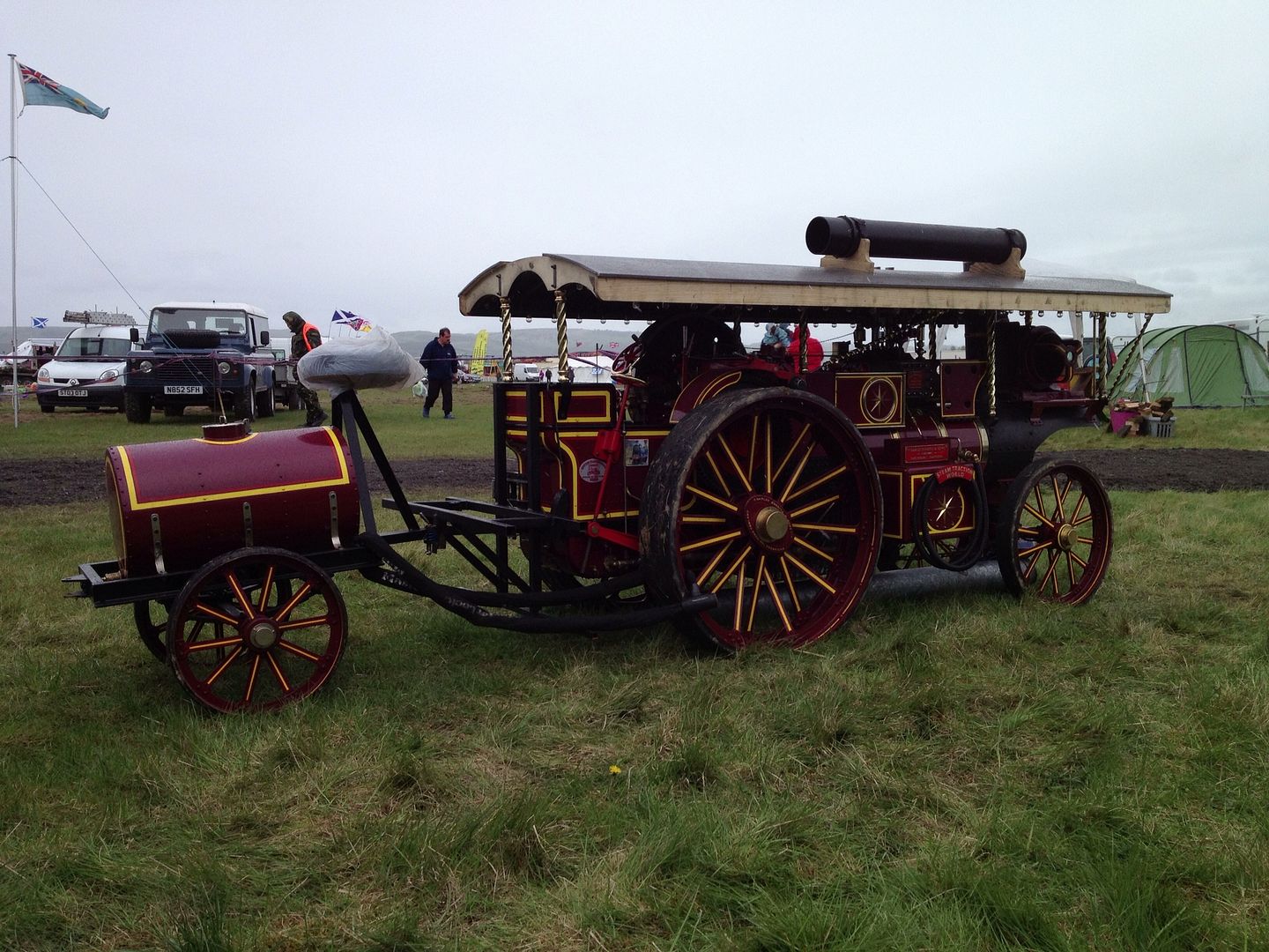

Your water bowser looks great are they available or did you make it from plans?
How much water does the engine hold? how far can you go on a fill. My two inch was more or less constantly calling for water
I guess i need to carry both water and coal behind on some sort of trailer.
richard
richspoo
Number of posts : 15
Location : kings lynn norfolk
Registration date : 2013-05-06
Re: Are you sitting comfortably
Post  lynnr on Sun 19 May 2013, 6:49 am
Hi Richard
The water bowser is a stw kit and holds 8 gal. I think the engine tops out at about 10 gal. With the engine notched up I ran around the rally field for 7 hours and used 2 complete fills and 1/4 an engine fill. That was including the steam up in the morning. So she has plent legs.
