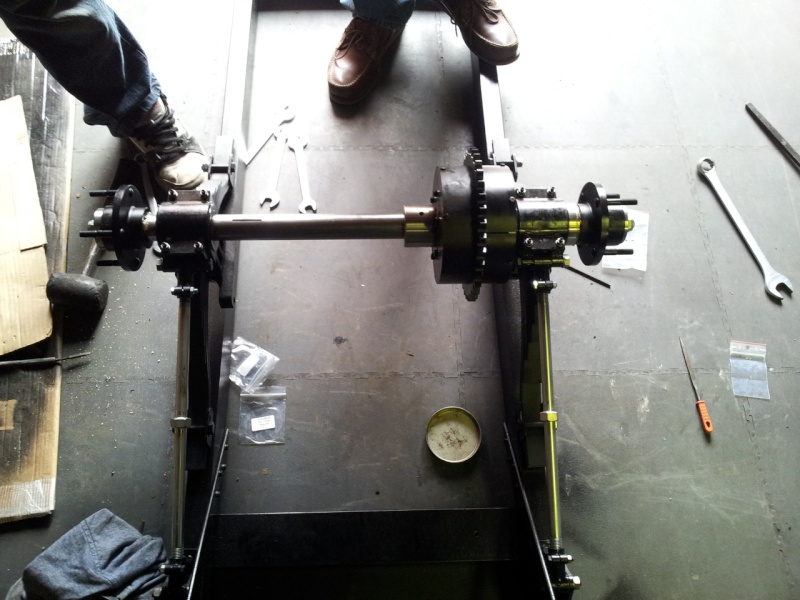

Post  Hecter on Wed 20 Feb 2013, 5:42 pm
Finally got the rear leaf springs/axle bearings ect fitted to the chassis but found the pinch bolts for the tensioner bar were poorly welded and broke. it only seemed to be the one end though so possible batch default? I dont know. but id check the pinch bolt bracket by tightening the pinch bolt to check yours havent got the same defect. Got a couple more photos and will add them later when im on a pc

Post  Hecter on Thu 21 Feb 2013, 8:53 pm
as promised the photos, would of got a close up of rear suspension but the broken bits mean there's no point. hopefully in a month and a bit i'll have a rolling chassis.

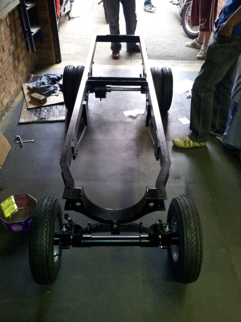

Post  Hecter on Tue 07 May 2013, 10:18 pm
So finally got back up to date with the kits and we now have a rolling chassis

Post  Tony King on Wed 08 May 2013, 7:31 am
Very good.........looks like you've got some help/admirers & a nice collection of old British bikes in attendance Very Happy
Re: 4.5" Foden C
Post  Hecter on Wed 08 May 2013, 7:37 pm
Well two of them, my dad and his mate who is a family friend are all into it, then the other two are his sons. I wish the bikes were mine, they're my dads mates. bsa b50mx, a65 lightning and a c15t thats hidden away behind the r6.
Is nice to get it into.a rolling chassis, a lot better idea of size suprising how much bigger they make look. got a few bits to take off, tidy up and paint though.

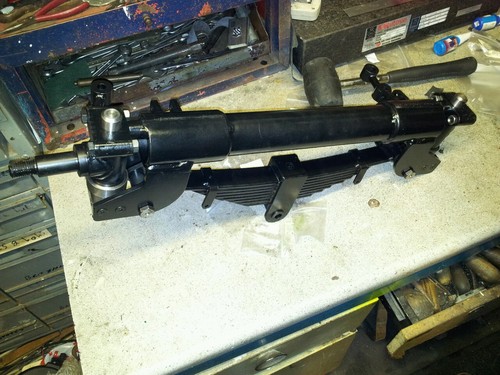

Post  Hecter on Sat 10 Aug 2013, 7:27 pm
Latest addition to the lorry, thing there was a few parts we took a couple of mm off so they moved better. any idea on what sort of toe in it should be i think ours is around 1/8th" at the moment. Hopefully the smoke box and water tank will be fitted soon
