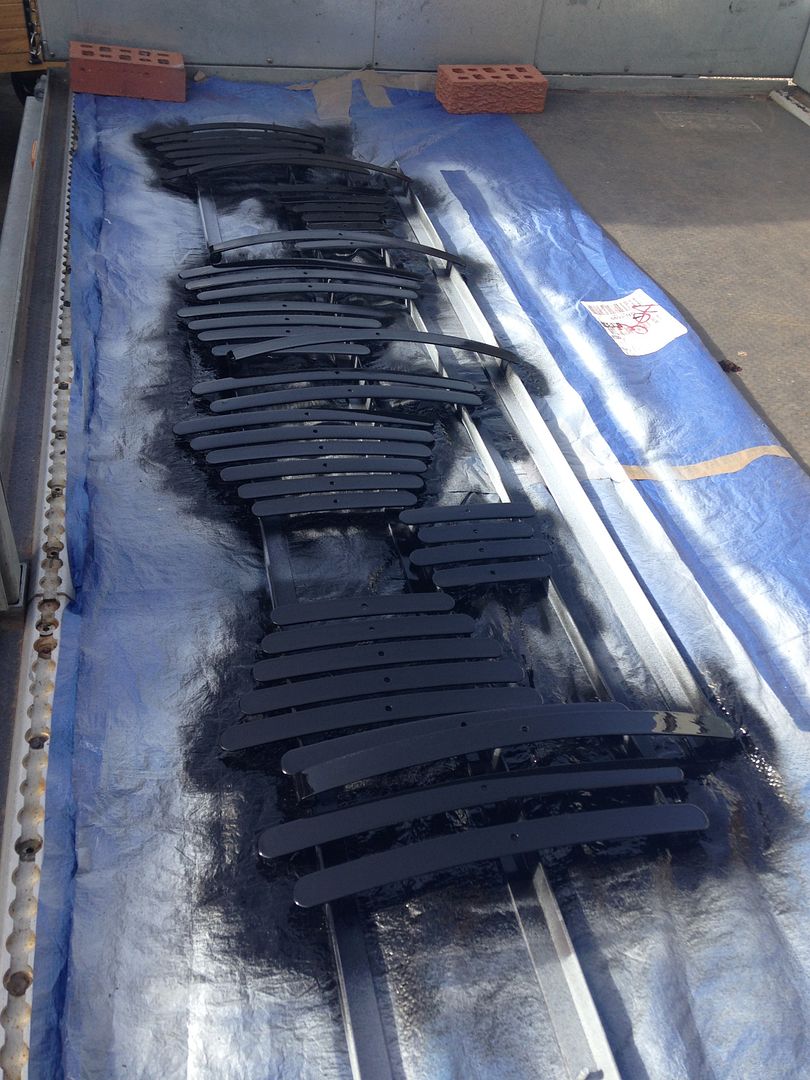

No picture from last night but the wheels are in primer. Gone with a zinc loaded primer to see how it goes. I hope to get top coat on tonight and possibly a second coat on tomorrow.

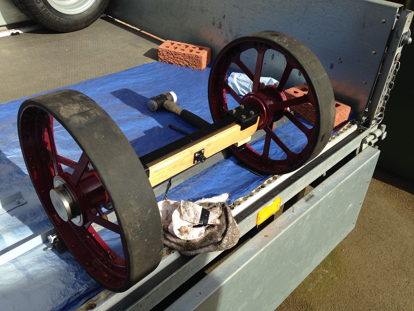

Wheels in top coat

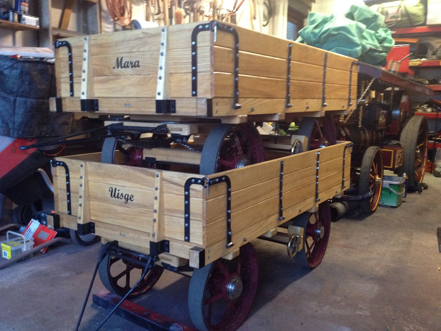

Back from holidays. So spent the day working on the wagons. Getting them finished enough for next weekend steam Rally at Crathes
Turntable
Second one almost attached
Getting there on the first
One almost finished. Not done the brakes but ready for next weekends rally.
Both ready for next week.

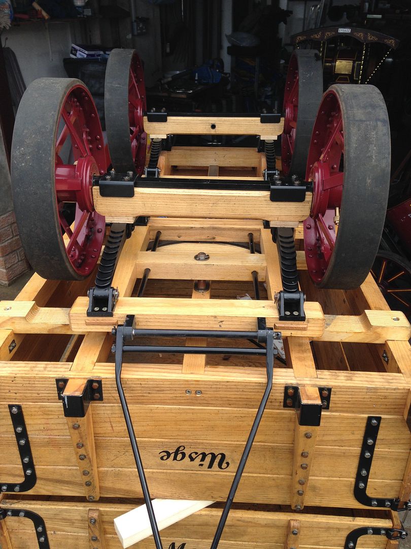

I've been doing a bit to my wagons over the last two days, & have got the first one pretty much assembled now!! I've got sore fingers having cut & "dressed" all the bolts on the grinder, that hold the planks on!!
When I tried to move one wagon by lifting it, all the leaf springs dropped out of their hangers, so the question is, what have you done with yours to stop this happening?
Re: Lynn Robinson. 4" traction Wagon. Twins. "Mara" and "Uisge"
Post  lynnr on Sat 12 Oct 2013, 9:28 am
Hi Tony.

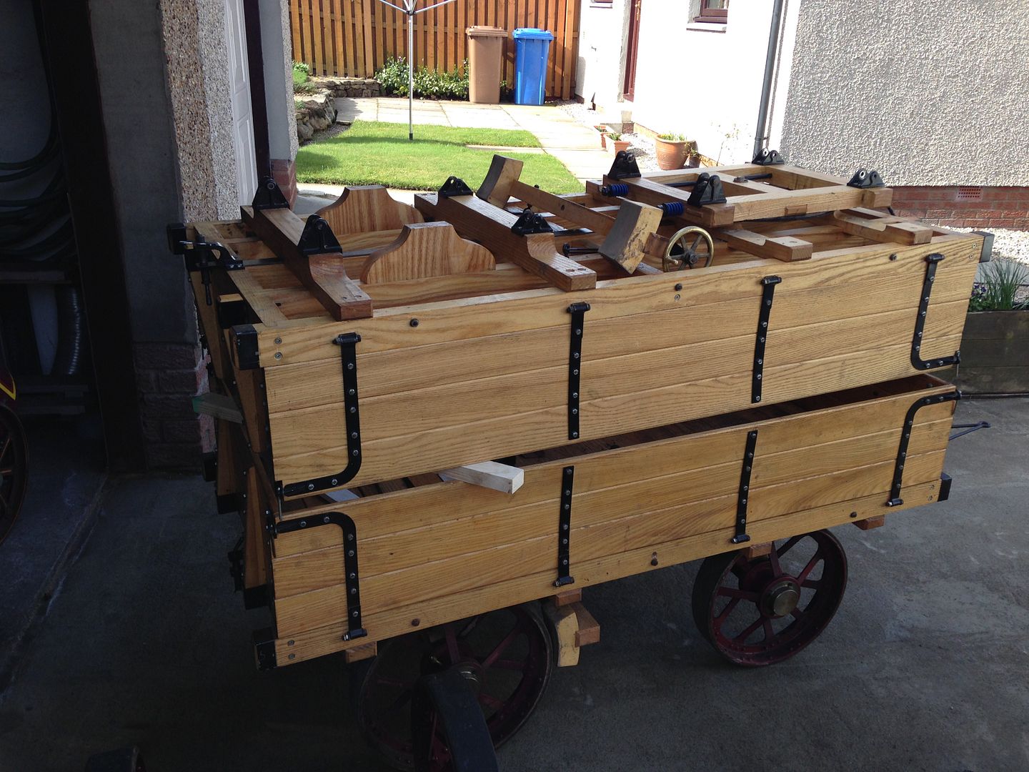

On the first wagon. I did not know about the issue, btw Steam Traction World is aware. On the second I moved the rear crossmember in 10mm for the rear springs. So far my front springs have not fallen.
So when I stack I makes sure it is the modified one that is lifted. Over the winter I plan to investigate the hangers and see what local modification could be done to stop the drop. I have considered a check strap, like used in rally. Fitted between the chassis and axil and limits the drop. Should be able to do it with 3mm high flex wire rope thimbled either end and discreetly attached. Also hide them inside of the bump stops.
Also while they are stacked for storage. I put wood blocks between the axil and chassis on the lower wagon to take the weight off it. So the springs don't sag under the long term load.

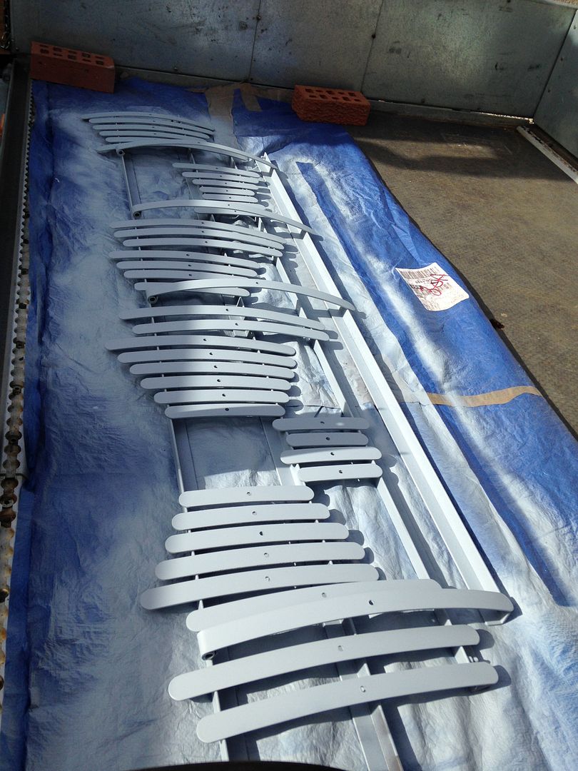

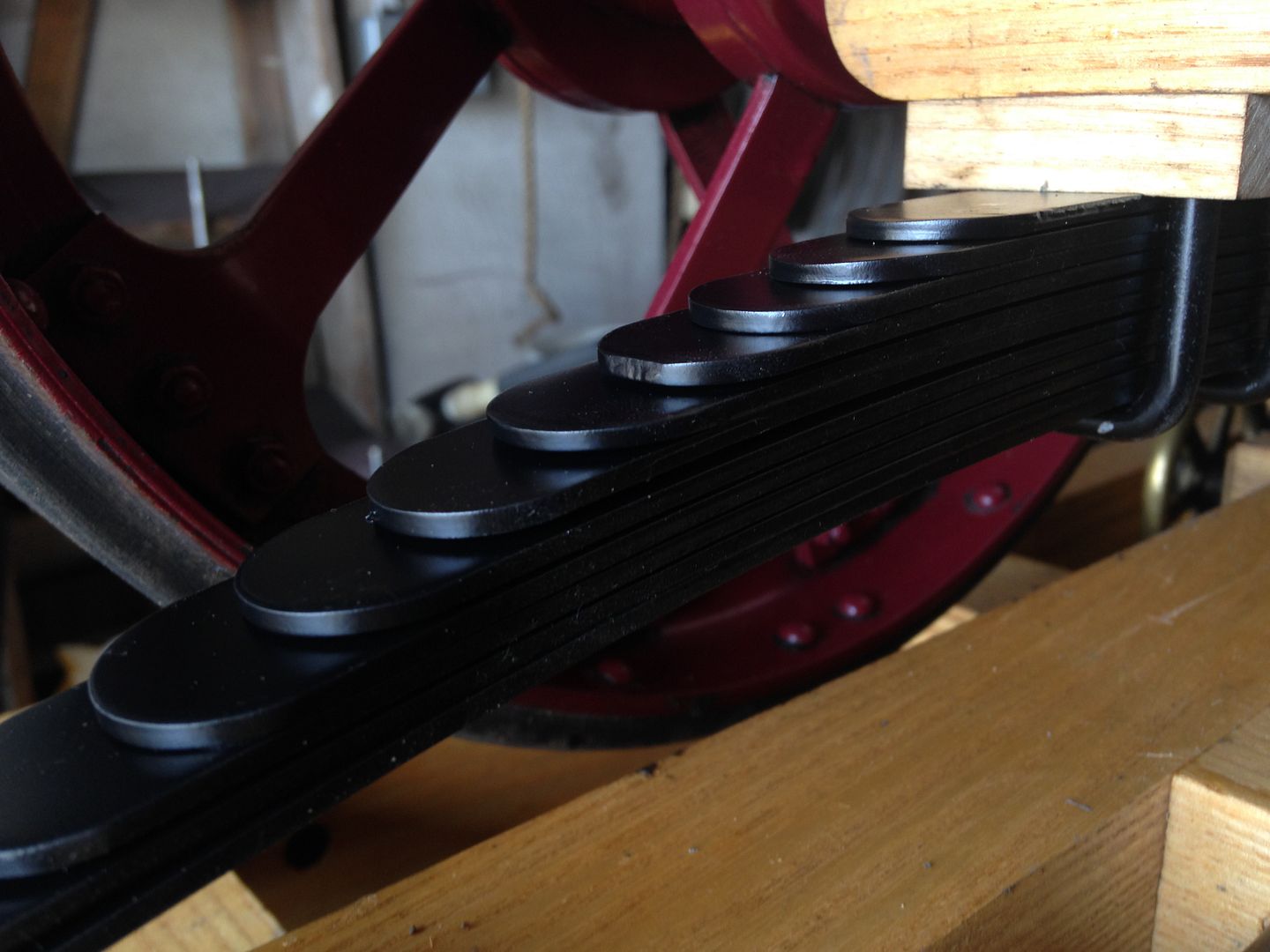

Her springs have been cleaned and now being repainted.
Primer
Top coat. Satin black. Why? It is in stock on the shelf.
Oh by the way water bowser. It will be your turn for a bath once Mara and Uisge are finished.

Uisge is feeling happier.
Springs looking better.
