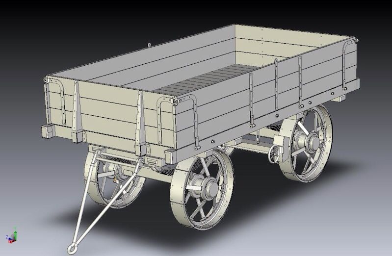

Well got 1/2 an hour in the engine shed today so got a start on the traction wagons.
There is an ISO drawing around but I can not currently find it.
Found it.

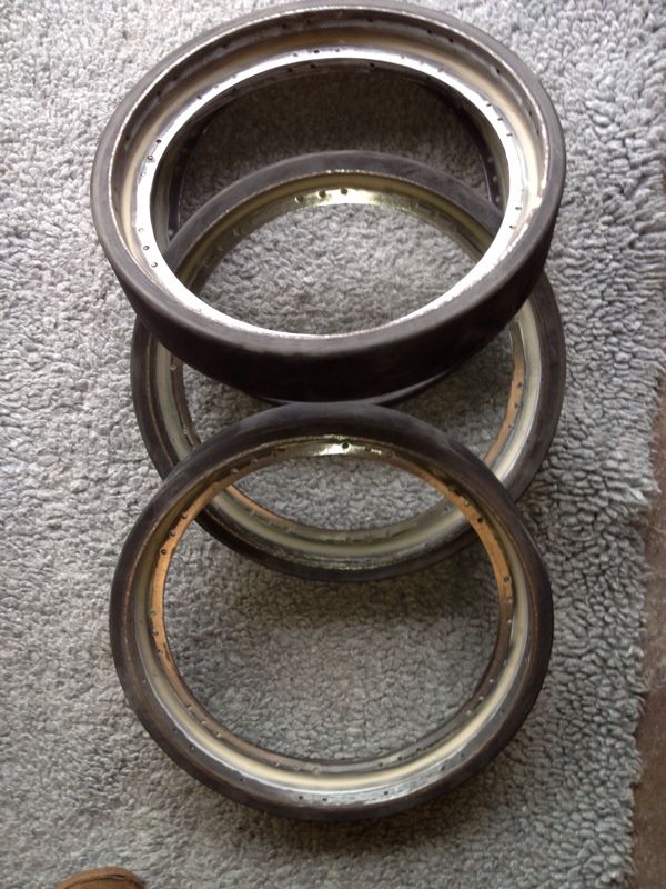

Post  Tony King on Sun 03 Feb 2013, 5:17 pm

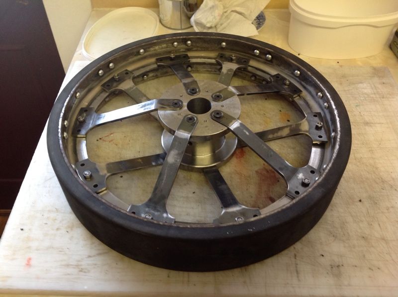

Have you got the paint on them wheels yet Lynn Very Happy
Could you bung up a pic of the rims, if you got a minute Smile
Re: Lynn Robinson. 4" traction Wagon. Twins. "Mara" and "Uisge"
Post  lynnr on Sun 03 Feb 2013, 5:35 pm
Hi tony
Sorry bout the image will do better tomorrow. Still very poorly so little done.
Last edited by lynnr on Sun 03 Feb 2013, 6:30 pm; edited 1 time in total (Reason for editing : Adjusted the picture)
Number of posts : 2963
Post  Tony King on Sun 03 Feb 2013, 6:56 pm
Wow, they do look "meaty" Shocked
Thanks for putting that up Lynn.
Hopefully get mine soon too cheers

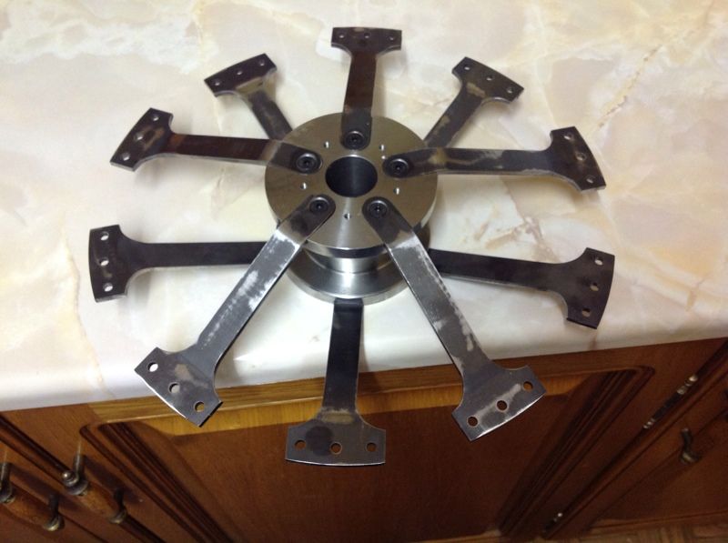

Lynn
Is the Irnbru for descaling the spokes?
Post  lynnr on Tue 05 Feb 2013, 1:21 pm
Just a wee fiddle to see how the hub fits.

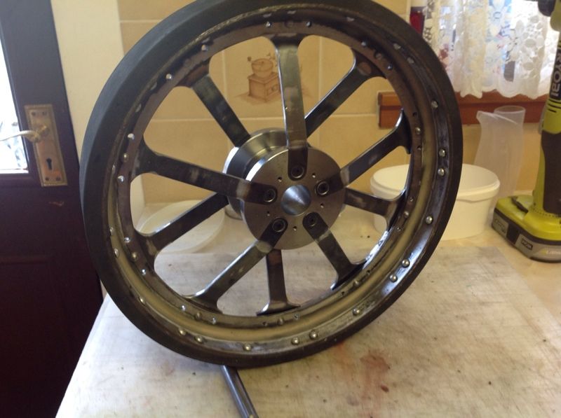

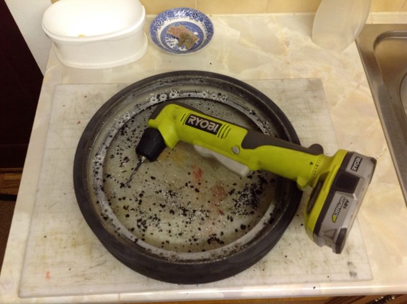

Post  lynnr on Thu 07 Feb 2013, 12:41 pm
Little progress.
Wheels filleted and cleaned.

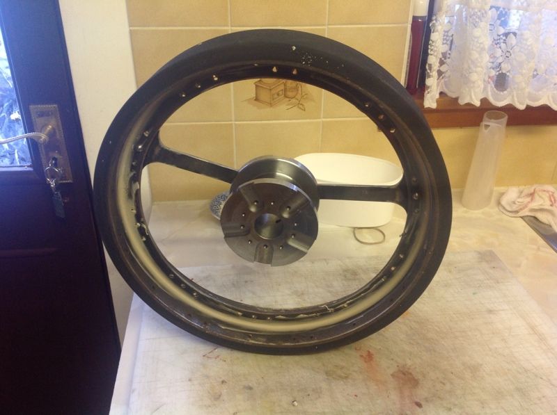

Post  lynnr on Thu 07 Feb 2013, 2:33 pm
Though I would try and fill in the middle a bit more.
Still to do the rivets on the rim so only a couple bolts. Things look like they will line up nicely as per normal procedure.

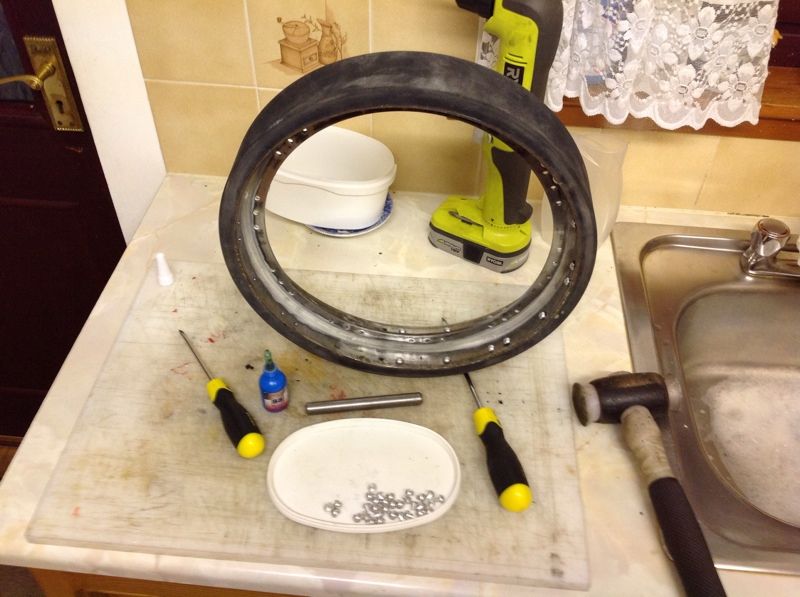

Post  lynnr on Fri 08 Feb 2013, 1:52 pm
Some gentle progress.
Trial fitted together one wheel and put the rivets in. All looking good.

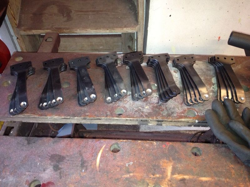

Riveting job.
Post  lynnr on Fri 08 Feb 2013, 7:23 pm
Fairly mindless so relaxing.
Cleaning the holes and putting the rivets in.

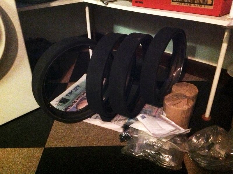

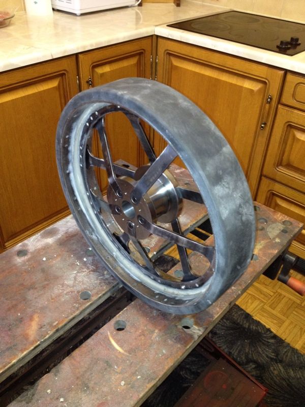

Post  lynnr on Fri 22 Feb 2013, 7:35 pm
Got some progress today.
All 4 front wheels are assembled, had to tread 2 spoke holes in 2 hubs and I have 2 stuck rivets needing removing and the holes drilled. I used the 2 hour araldite and what a difference not having it set off on you all the time. I also pasted under the spoke at the rim to keep out the water.

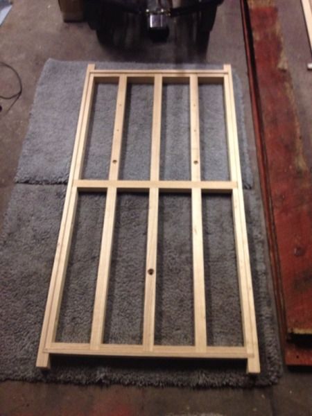

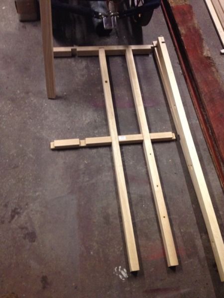

Well the Chassis for the wagon arrived yesterday. The wood looks good but I hope you all like filing and sanding. I have only 1 mortise joint that actually fitted together first time. Every other joint needs work done to it. Ho Hum.

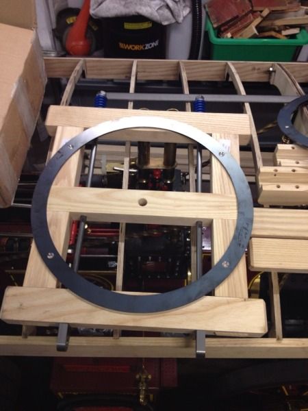

Post  lynnr on Tue 16 Apr 2013, 7:21 pm
Dry fit test of the first wagon.
More ribs
Turntable.
Turntable fitted
Tow hitch
Everything is dry fitted. Only te turntable steel rings are screwed on. Everything else is just perfect fit and dry.
Measured the position of each cross member so all ready for dismantle and glue up.
