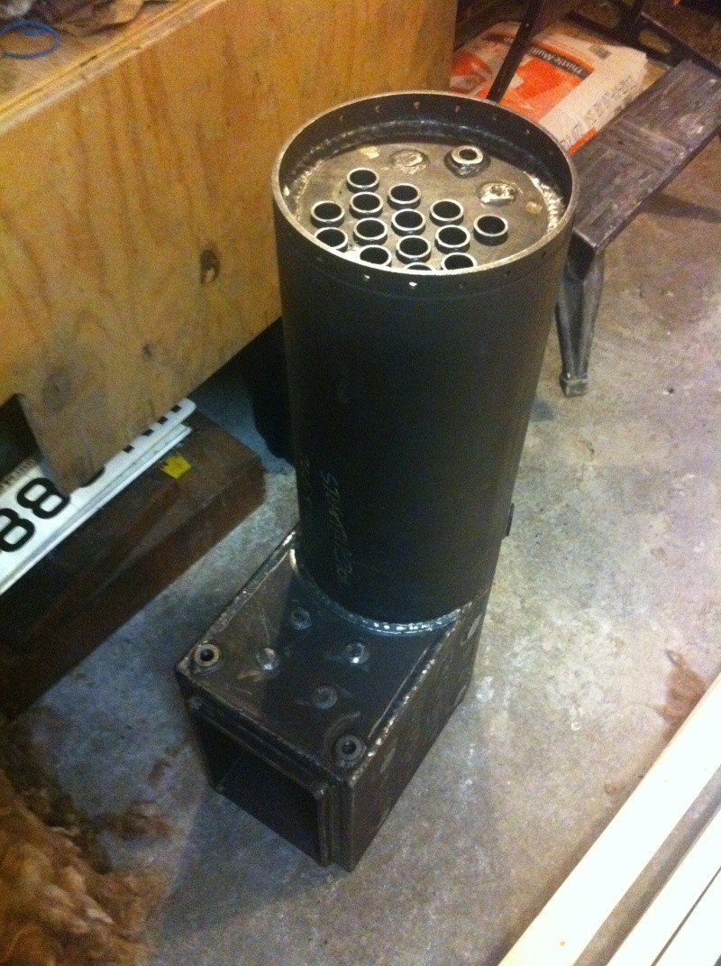

Picked up this yesterday, I can now move on with my build. Things have been abit quite as i wanted the boiler before done any work to the horn plates and finishing the tender. Just got to finish of the re-vamp of my workshop now. Busy Busy.

I would question "just picked it up"
Full steam ahead now then.

it looks fantastic how heavy was it when you just picked it up ?

As I'm sure many with their boilers will confirm its heavy. I picked ours up from the haulage company and we lifted it in the back of the car with a forklift. Lifting it back out by hand when I got home was a interesting at 140kg it was a challenge.

The agricultural boiler is smaller than that of the road loco and showmans, it weight's in at around 110KG some gloves and two people was no problem to move. Don't blame you for making a ramp rob! Just need my workshop finished now then i may be able to get back on with the build. still being inside is better than being out in this snow.... tongue
