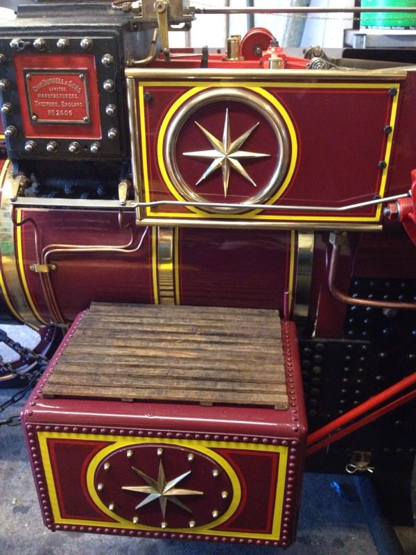

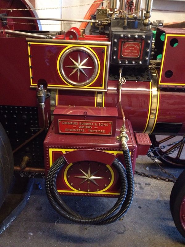

In the instructions for the RL builders who want a star on the RH side motion cover, it suggests using the LH side cover to act as a template for him drilling the RH side.
More explicitly, I would bolt the two together and run a drill through the LH cover at clearance for starting the holes in the RH, then separate the two and re drill the second side at full size for the star and ring fixing screws / bolts. This will maintain a very accurate hole spacing.

Mine came per-drilled Very Happy

I know, so were mine, originally.

I didn't bolt them together but held with clamps and haven't had any issues but they do need to be accurate there is very little room for error if any at all. Lynn yours would have been not being a Road Loco!!!
