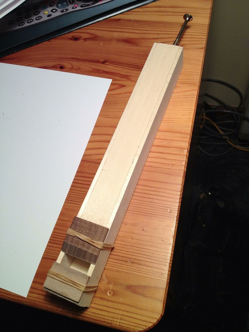

Post  lynnr on Tue 20 Nov 2012, 8:34 pm

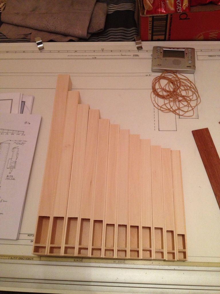

Just started my organ. First pipe made.

Post  highpressure on Tue 20 Nov 2012, 9:54 pm
Looks good, only another 99 to go if you're going to make the full spec Topsy!! Shocked Jonhs plans can be a little taxing to follow but it's very satisfying to get to the point where it actually plays. Having made 8 or 9 versions now I must have made nearly 1000 pipes!! but I dont use Johns style for the current types as the pro versions sound cleaner but it will make a compact machine with a pleasant sound.

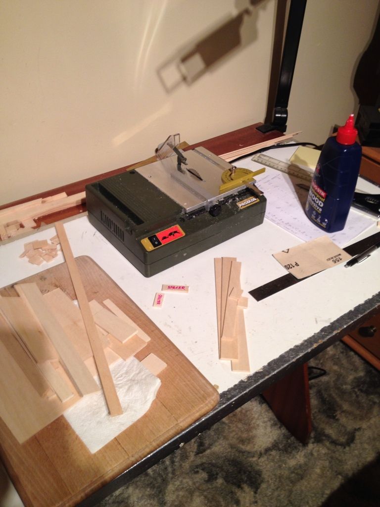

Post  lynnr on Sat 24 Nov 2012, 4:55 pm
More pipes.
Next ones to be glued
The work area.

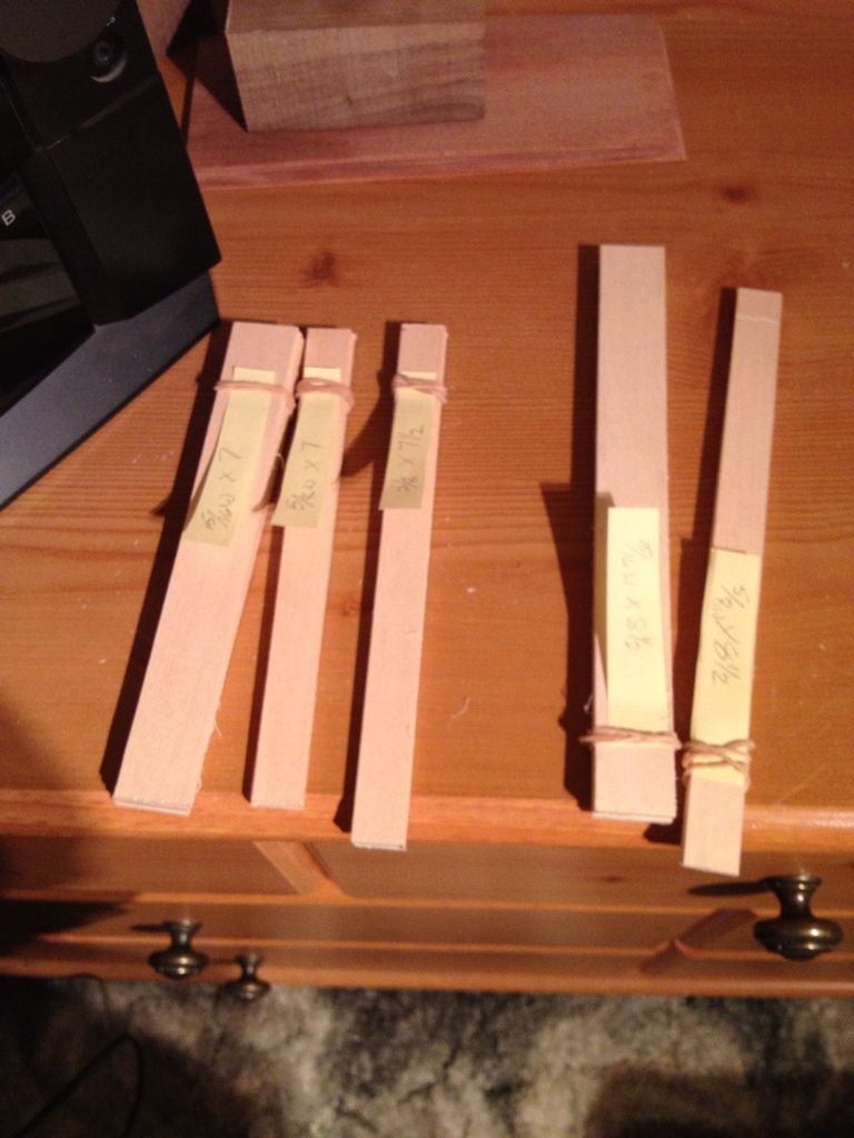

Hi Tony.
American basswood. Light but fairly strong. Straight grain and no knots.

Post  highpressure on Sun 25 Nov 2012, 9:18 am
I bought the same table saw, very good for the fine work, must have cut kilometres by now here!!! Where did you source the wood from, I have always found sourcing wood other than run of the mill pine types a challenge, the stuff from B+Q and others is crap.

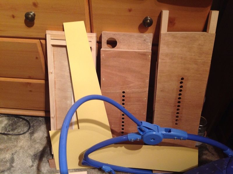

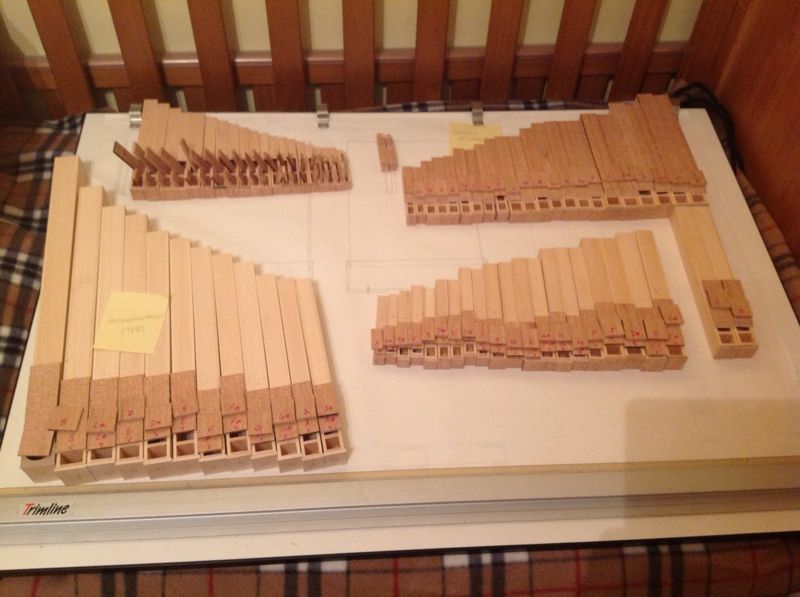

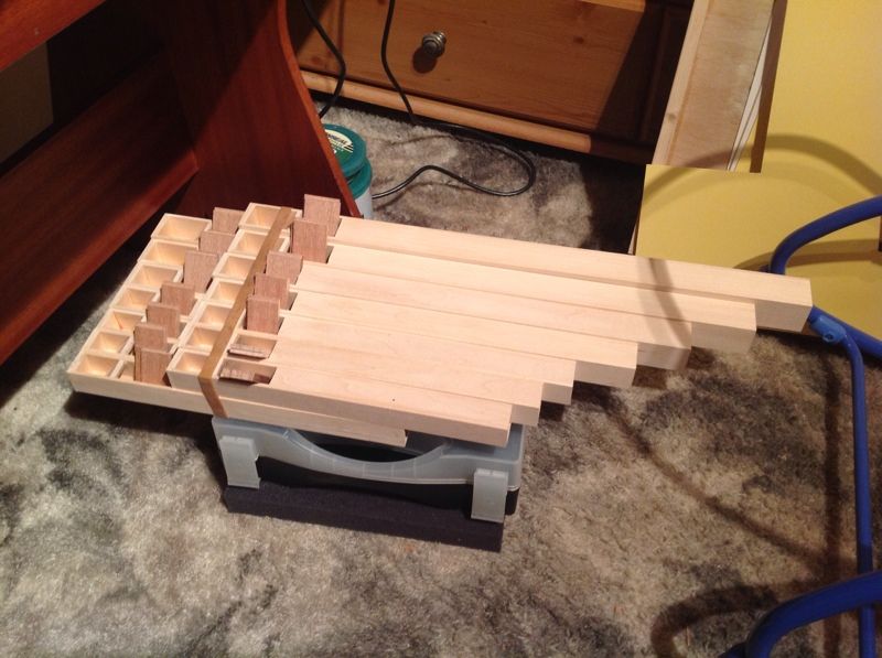

Sorry for not posting. Progress on the organ is quite slow at the moment, between my lack of health and supplier issues. But progress has been made.
More pipes made, had to wait almost a month for wood then went to a small model shop in Nairn and he got the wood in 2 days at 1/3 more wood for half the price.
Waited until after Xmas to order the leather. So that has arrived now.
And the making of the bellows
