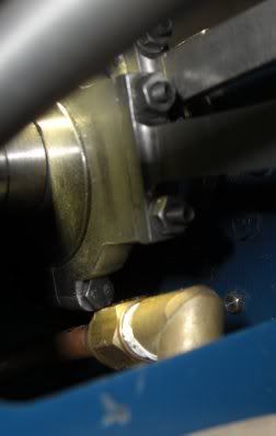

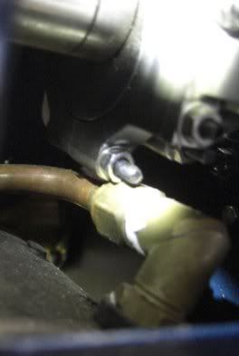

I now have done my kit 19 ......Did use 4 plasters.But I did have a prob the eccntic strap hit the elbow on the bolier!!
So I took the crank of to see if the eccntics were in the wrong place but thay are ok .So I tryed to
put the bolt in the other way round as you can see in the pics ,.

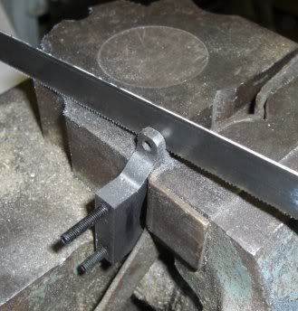

So I filed of a bit on the nut on the bolier and cut away some of the strap.
This was a big decison but did and now all is running well......
But I am thinking was that the right thing to do ??

Had the same problem but found that the elbows, when turned over, stopped this happening.

geoffmills1946 wrote:Had the same problem but found that the elbows, when turned over, stopped this happening.
HI did try that but the steam pipe had a better fit ..Thanks how can I put it OOPPSS
