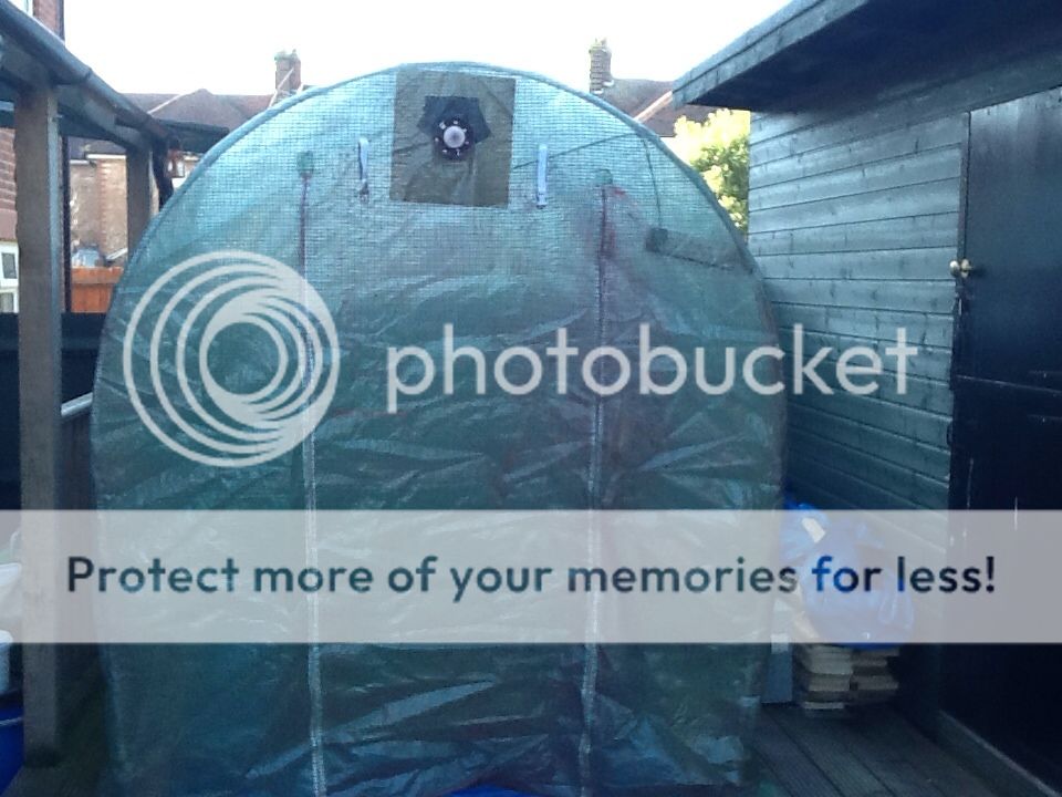

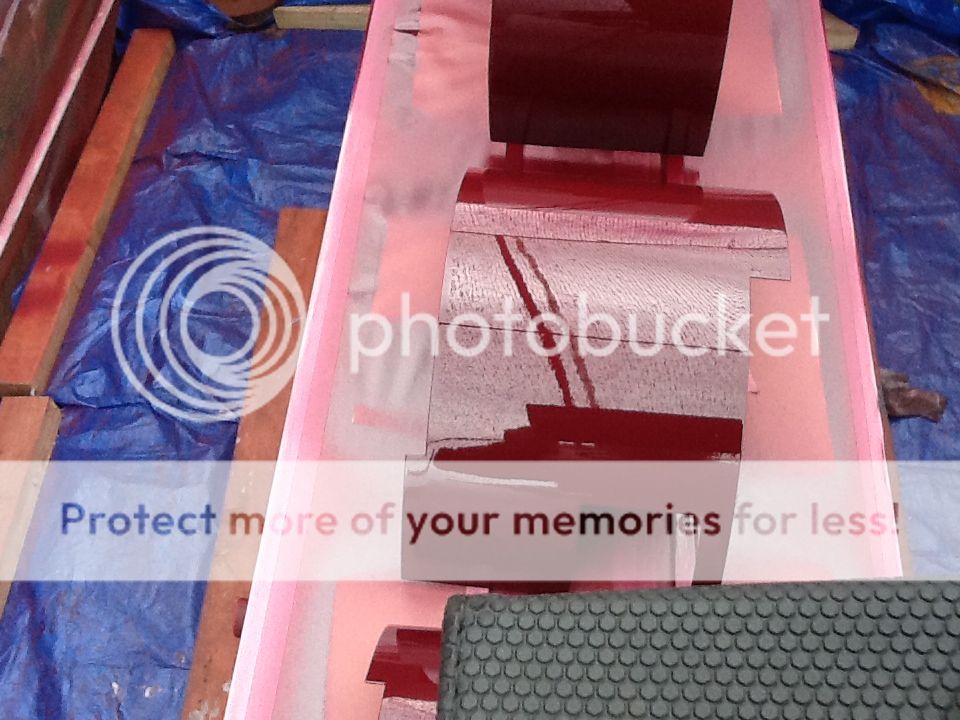

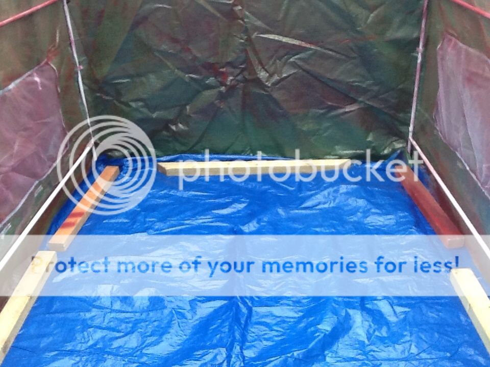

Post  the coleman on Sun 17 Feb 2013, 9:17 pm
Done some painting on cladding and seat only priming. So Put the polly tunnel up on saturday only takes 10 mins on my own.3x2x2

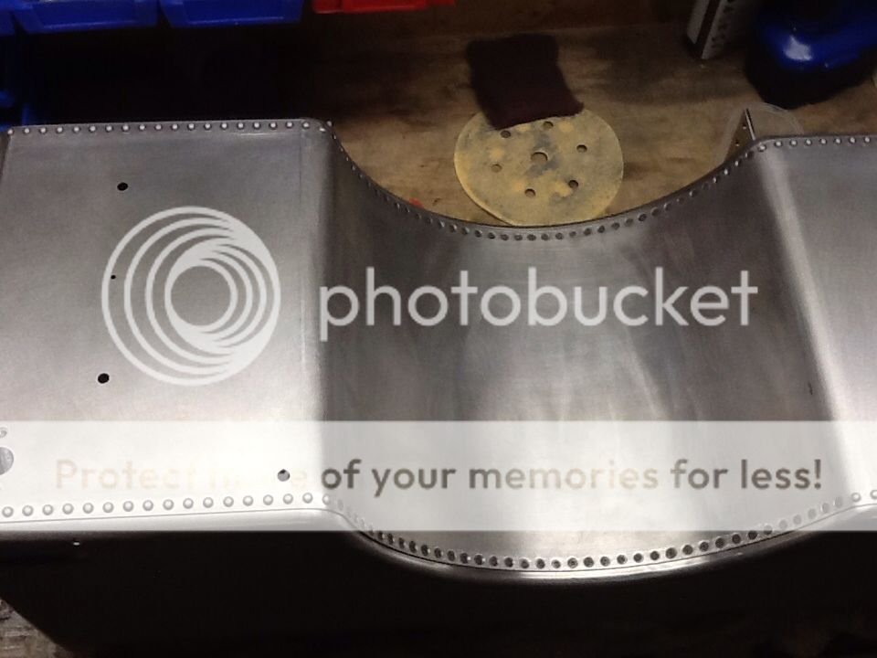

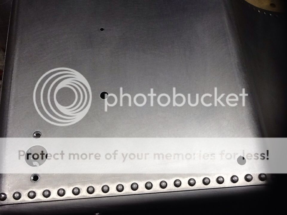

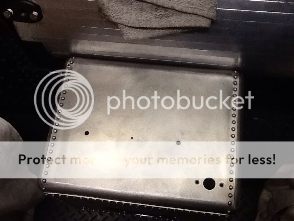

Post  the coleman on Sun 17 Mar 2013, 10:59 pm
Been busy at the weekend putting belly tank together have to say not as bad as I thought . So here's the problem the holes for the breather are wrong to iso drawing and the breather tubes fall straight threw . Also they should be at the back of belly tank . I'll give stw a ring tomorrow.
Number of posts : 214
Belly tank
Post  the coleman on Mon 18 Mar 2013, 9:30 pm
Spoke to stw today about the holes and they where willing to pick belly tank up and fix the problem thanks guys. But rather than send it back I'm going to weld up the holes myself I've already drilled out new holes and tapped the for the breathers .

Belly tank
Post  the coleman on Tue 19 Mar 2013, 8:05 pm
All welded I placed a piece of copper under neath the hole and filled with weld no destorsion .

Post  lynnr on Tue 19 Mar 2013, 8:16 pm
Very meet and well done Very Happy

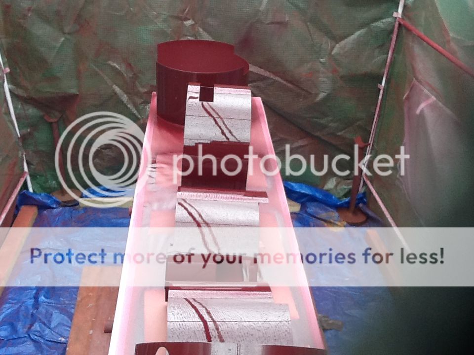

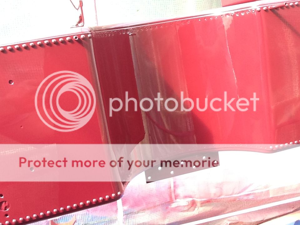

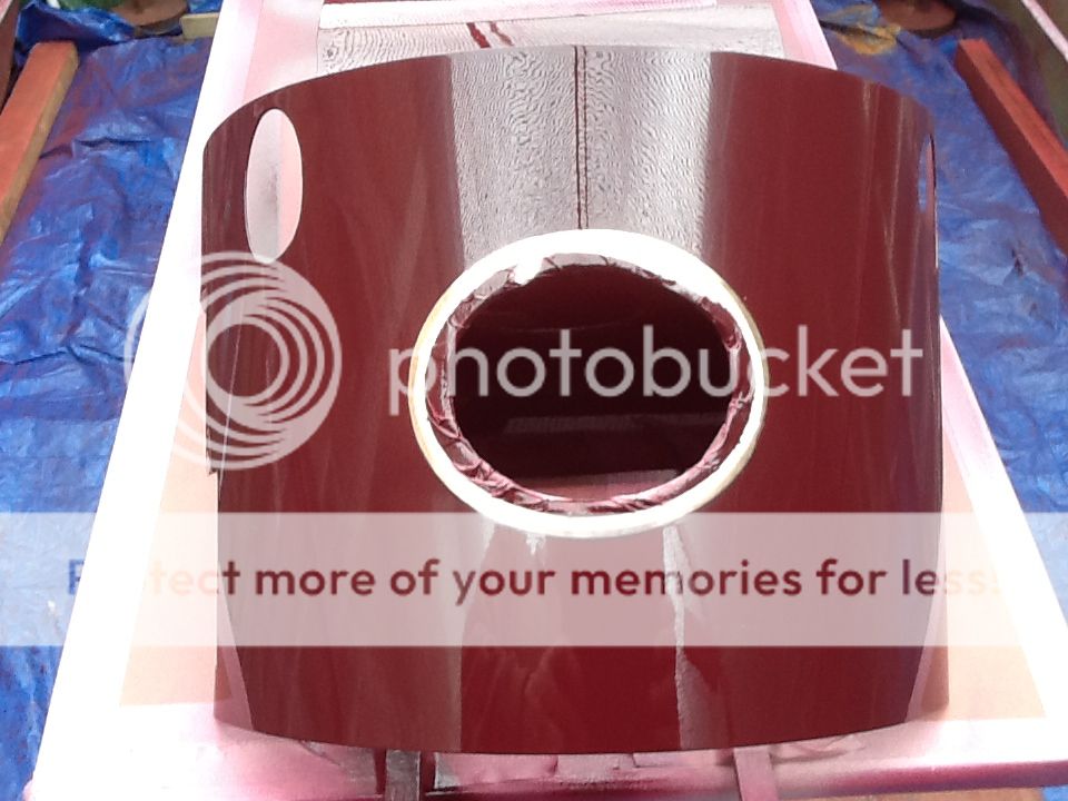

Post  the coleman on Sat 18 May 2013, 5:18 pm
Been spraying cleading today .belly tank tomorrow.

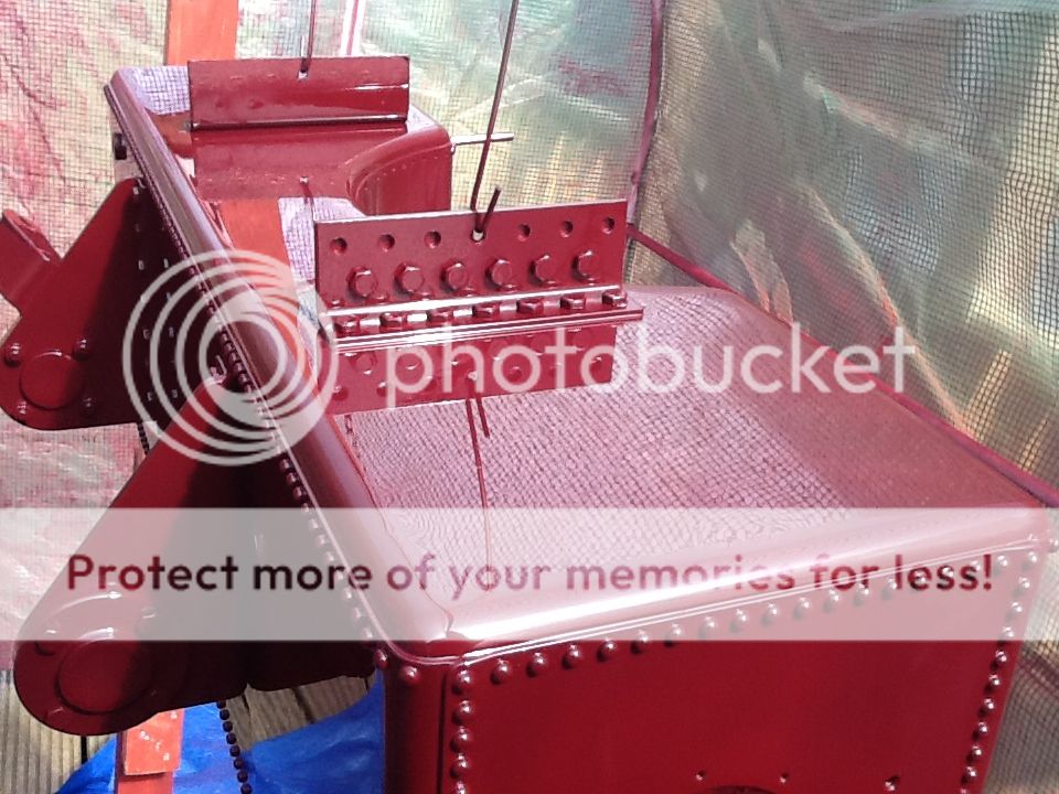

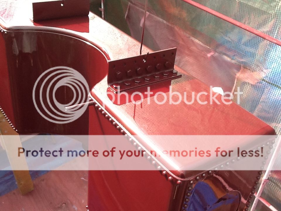

Re: Andy's 4"dcc road loco
Post  the coleman on Sun 19 May 2013, 3:59 pm
Sparyed belly tank today. It will be a shame to light a fire when it's finshed.

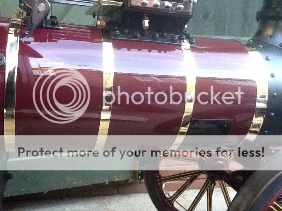

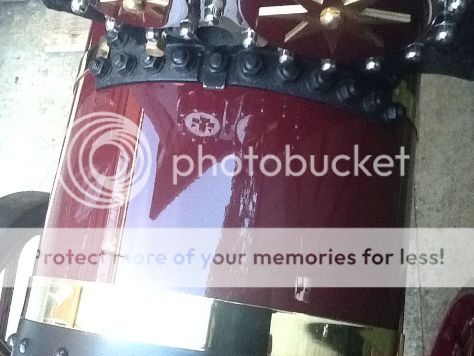

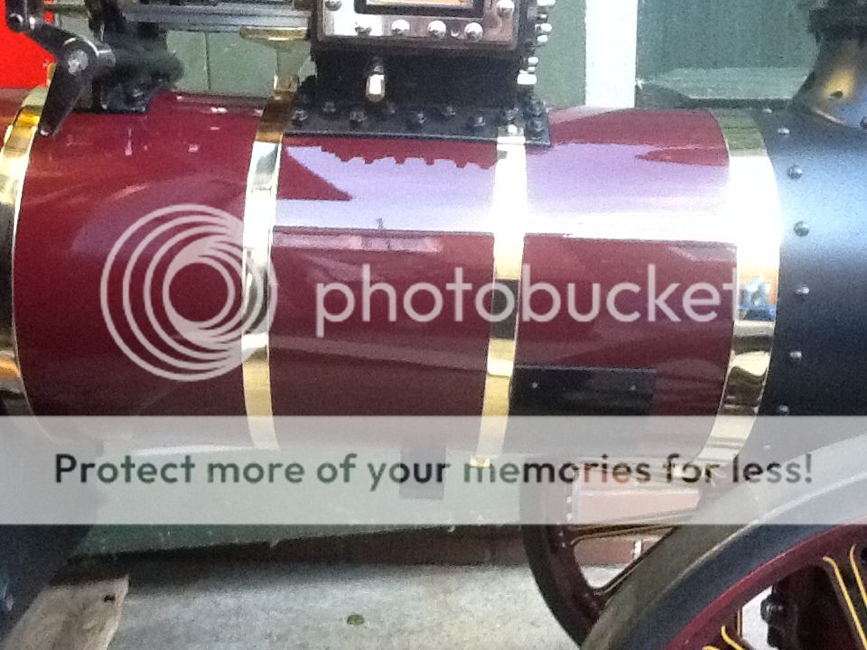

Post  the coleman on Tue 04 Jun 2013, 9:37 pm
Been busy the last month so only just started the putting the cleading on so here are the results. Going to start lining tomorrow.Will take better pictures tomorrow.
