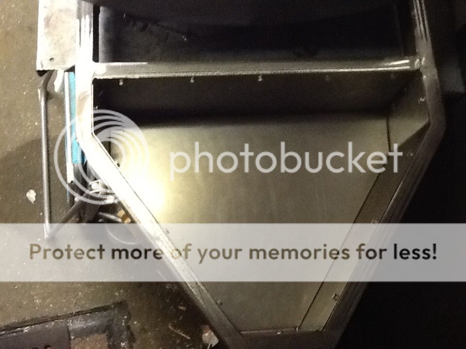

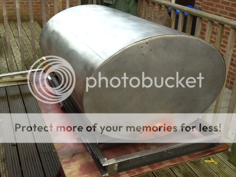

Now the engine is finished I been working on my water bowser. It's all most there need to fit baffles and a paint job the tank it self 33"L  24"w 16"H  the frame 2"x1" c section. Also  the front part I'm going  fold 1.5 mm steel and bolt it to the sides and use it for extra coal. The axle is 1"square which sits inside a nice piece of oak..

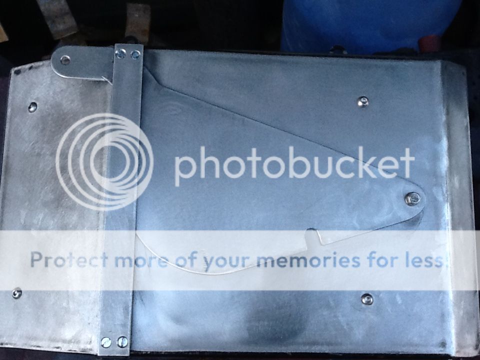

Post  the coleman on Sun 09 Nov 2014, 4:01 pm
Iv also been working on the ash pan  the same as steve trail. I plasma cut 120mm hole and used 3mm s steel for the door and hopefully will be a lot cleaner when raking  the ash pan ...

Post  bjwlancashire on Tue 11 Nov 2014, 11:03 pm
Nice sturdy bowser Andy, nice and different too as an oval one.
I see your innermost firebars are thinning with all that heavy haulage work. You might want to rearrange them, thinnest on outside and thickest inside. This will prolong the life of them and make them wear more evenly.

Post  the coleman on Tue 11 Nov 2014, 11:22 pm
The bowser was started before I started the engine I do know it's  getting heavy and that's with out any water. The fire bars will be changed be next rally season starts.

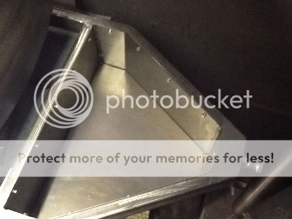

Post  the coleman on Thu 13 Nov 2014, 10:19 pm
Finished the front of the bowser I reckon it's going hold about 3/4to a full bag of coal.

Hey Andy, any chance you could do that to my ashpan if I run it over to you at some point please. I'm really fed up with all the crap floating allover the wheels and belly tank!! Good looking bowser too!!
