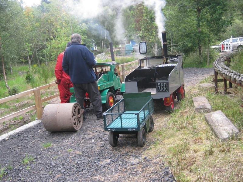

Just had another successful Open Day at our local club, SMET in Pertshire. Families come along for train rides (mostly) but we have built a track around a raised railway line and take kids for runs behind our wagons. I think I can have a claim for the first conversion of a Foden SWB to a "roller" (see first pic).
