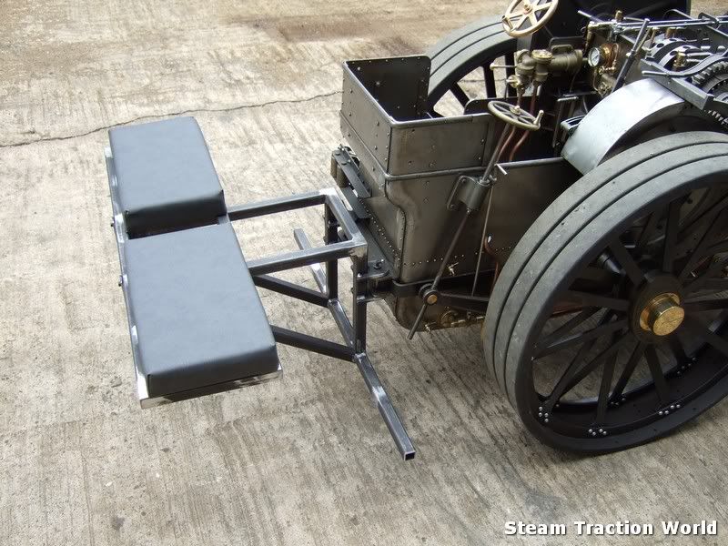

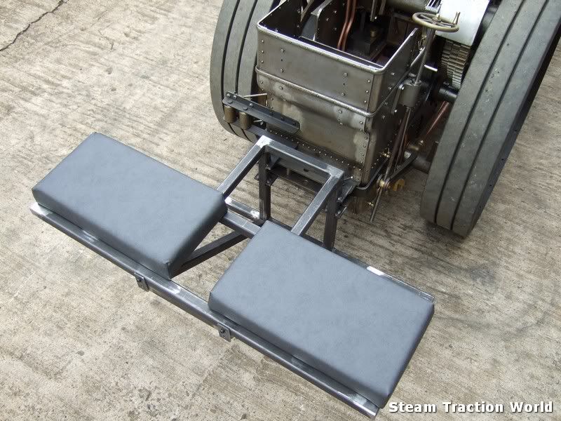

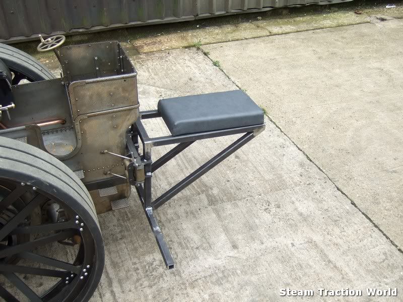

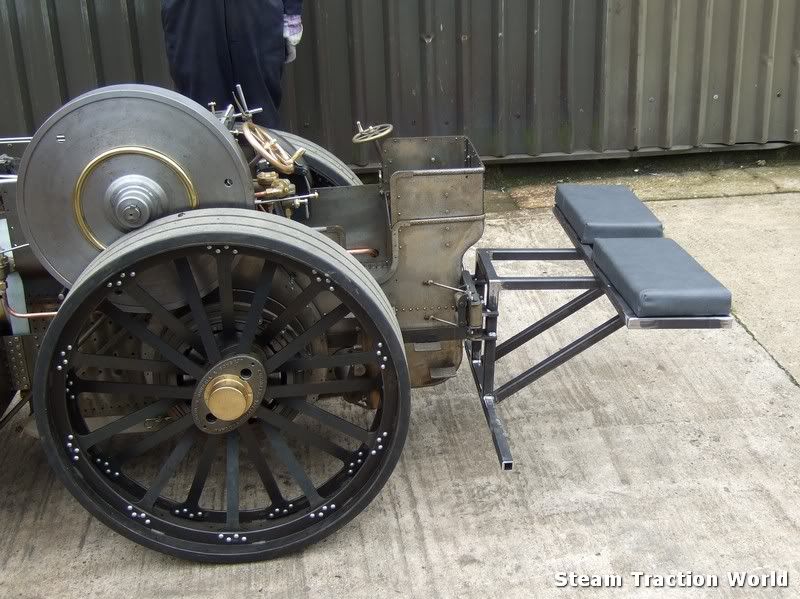

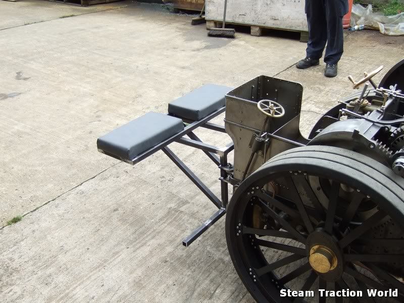

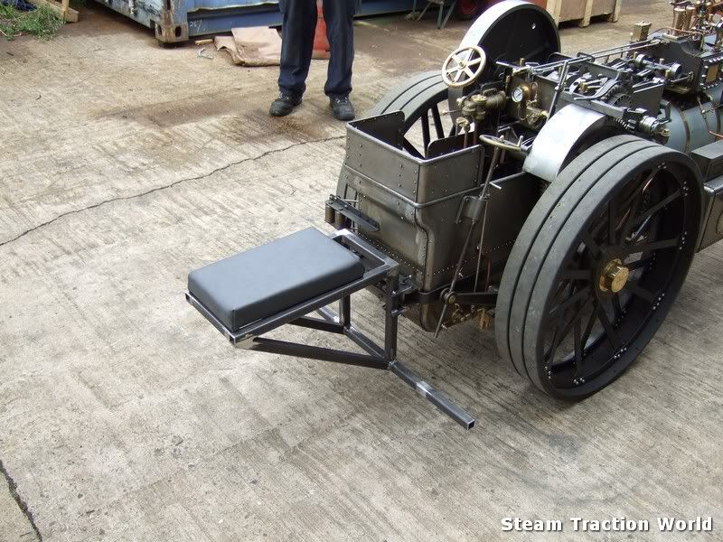

we have put together a prototype of the rear seat.
the basic design will be a single seat like this. the padded seats are temporary "water bowser" items...
you will also be able to buy an additional "ladder" cross section to turn it into a two seater...
there will be some adjustment front and rear and the foot pegs will be adjustable.

That's one hell of a twisting moment on the draw bar with two people on the seats................... I'd like to see a bit of support going under the tender to counter act it!! ................. But then what do I know, as I know you guys really know what'll work!!

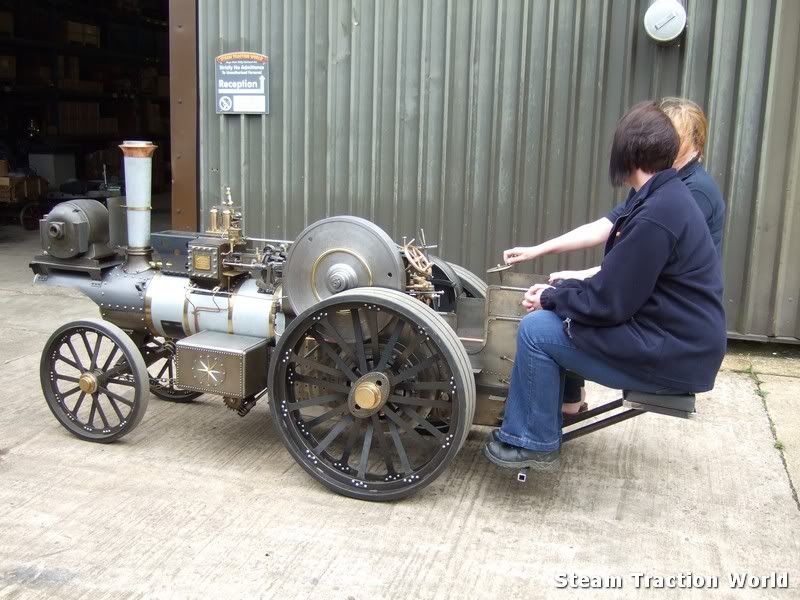

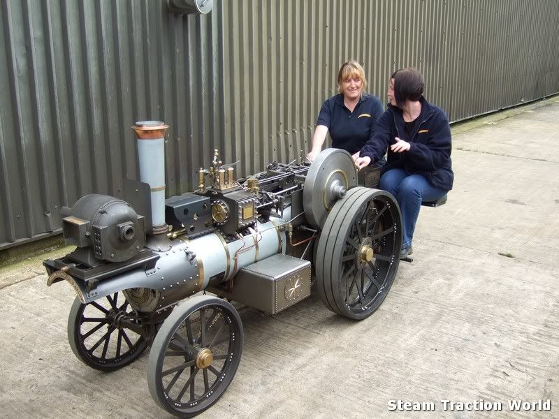

I note that Isabel has absolutely no chance of reaching the regulator from back there, you need to buil a car seat adjuster track into it for those with shorter arms Razz

Looking good, share some of the concern regarding leverage, especially if a couple of 'heavy weights' ride on the back. I've seen some with straps that hook over the top of the tender & others that get support from underneath. Also some sort of towing eye fixed to the seat would be good.

Post  sonick45 on Wed 01 Aug 2012, 5:53 pm
As mentioned above...
1. bars extending underneath, reaching to the end of the tender to share the load from the straps. Better than hanging off the tender extension as it is less intrusive to the operator and stronger.
2. The seats need to move way forward unless your Mr Tickle.. I for one will be seated with my knees almost rubbing on the rear wheels.
3. A tow bracket on the back of the seat to attack trailers too.
It's definitely heading in the right direction thou. The seated height is much better.

I would agree with the reaching position, I have a bad back and leaning forward all the time for controls or safe driving could remove the pleasure of using it. Some of us aren't able to afford the new trailer and will be using the old version, will the draw bar reach??

My only comment on the design now I gave it more thought is that the angled supports will be in the way of a draw bar when turning right or left unless there is a draw bar connection attatched to it further back. If I remember correctly the traction wagon design has an option for a longer drawbar for the connection to the engine than if it is a trailer to trailer connection. The fact the drawbar can reach past the seat frame will be useless if this low seat design requires the angled supports in their current position.

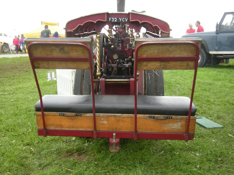

Post  Steve Traill on Sun 26 Aug 2012, 10:19 pm
Here's some pics of a very comfy seat
It's also pretty useful
The back rests are nice & springy & lift out for packing away
The engine is a 4" Fowler and is smaller than the Burrell we are building
