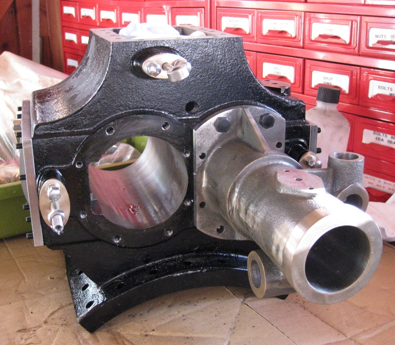

Post  burrell1 on Sun 03 Nov 2013, 8:37 pm
I have now collected the replacement cylinder block for my Foden lorry from the factory and have only two comments to make, it is very heavy and it is a fantastic piece of engineering.  This kit does not consist of many parts and due to the quality of the work it does not require very much cleaning up before painting.  (The pictures of the cylinder block were taken before any cleaning took place)  It seems a shame that the cylinder block will be hidden under a cover when the lorry is completed.  Having cleaned the surface of the casing, the first task that I completed was to fit the transfer port cover to the underside of the cylinder block.  This cover will not be seen when the cylinder block is fitted to the boiler but the heads of the bolts had to be reduced so that they did not protrude above the curve of the saddle.  The two remaining tasks were very much more important and needs more time spent on them.  The first was to remove the burrs from the valve faces and then to improve the faces without causing any dishing to the surfaces.  I spent quite a bit of time on the last task, which was to polish the regulator face plate before fitting it.
burrell1
Number of posts : 156
Location : Clacton, Essex
Re: Bill's 6" Foden SWB Lorry
Post  Robfishman on Sun 03 Nov 2013, 8:55 pm
Your right it looks lovely, and quite a lump. I can see why machining them took such a long time.

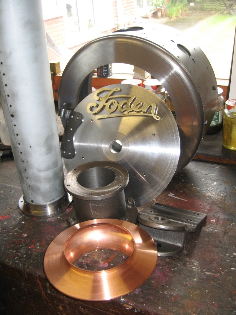

Foden Badge
Post  atomenter on Wed 05 Feb 2014, 3:44 pm
I have attached a pic of the Foden Badge that I bought from Barry at Pickering a couple of years ago.  At that time he was trying to get them with a bit more finer detail in them.

Foden Badge
Post  atomenter on Thu 06 Feb 2014, 6:21 pm
Hi there
There is a lot more detail on this badge than the one I bought for the 41/2" .  All it needs now is a bit of colour to save polishing!!
