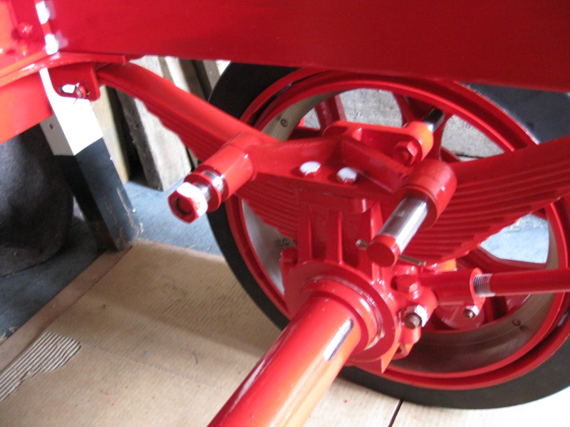

I have managed an interesting week-end assembling the new parts on my lorry. It is good at last to see it grow and it will be even better when we reach the stage where we can wheel it about, which will not be too far away. At the moment I feel more like a car mechanic than a steam engineer which is proving to be an interesting experience. The front axle of the lorry is going to be on show all the time and it really does look good. When we get further on with the build I will consider if I will have the front axle lined.
As the shed I am building my lorry in is a little bit cramped I had a problem photographing the rear springs and axle box. So I hope that this photo gives you some idea of what they look like.

Post  iain on Fri 09 Nov 2012, 9:50 pm
just noticed on the rear hub track rod bracket, you have an extra hole going through the chassis bracket? whats that for if you don't mind me asking?

Post  burrell1 on Sat 10 Nov 2012, 1:41 pm
I have to confess that I have no idea what the extra hole in the braket is for. When I fitted the tension bar I checked the plans, that we have so far but they give no idea. The extra hole is larger than the one used to secure one end of the tension bar so it is going to be a large bolt or bar.

Re: Bill's 6" Foden SWB Lorry
Post  iain on Sat 10 Nov 2012, 4:54 pm
just wonder what the difference would be between the lwb and swb.
Wonder if its support for the rear drawbar?
I want to fit a removeable towball on the back so need to think about some sort of bracing.

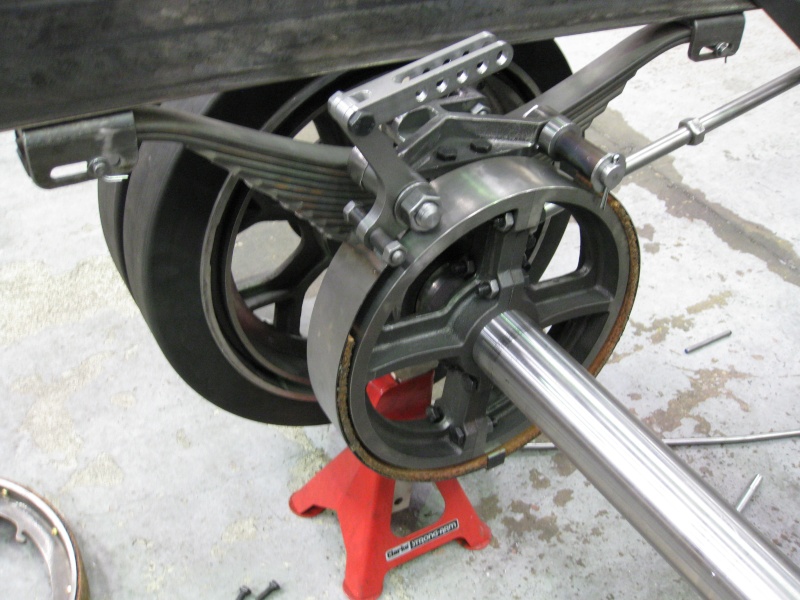

I have at last started to make some headway with kit 10 of my lorry. This kit is taking me longer than I expected to prepare even before I am able to start assembling it. The kit consists of the breaking system, which will be rather important as our lorries will be both heavy and capable of a good turn of speed. The lorry braking system will also make a nice change from my traction engine brakes that donít really work. The lorry has two breaking systems on the rear wheels and axle. The rear wheels have brake drums and shoes. Besides having to clean the brake shoe castings they need friction material bonded to them and then bolted in place with brass nuts and bolts. The second brake is a band brake onto a drum attached to the rear axle. All of these parts are very heavy and along with the rear axle they will hold the rear of the lorry on the ground when we are driving it.
This shows a brake shoe and the friction materiel that has to be bonded and bolted to the shoe. The rear brake shoe in the picture is completed.
This is the rear band brake and drum which will be attached to the rear axle when painted.
This is the foot brake lever which we have been told we will not be using when we are driving the lorry. I have blunted the ratchet teeth!!
This picture shows the rear wheel brake drums and the fitting bolted to the top of the axle box for the rear band brake. You can also see the key way in the rear axle for attaching the rear brake drum.

Post  iain on Mon 18 Feb 2013, 1:54 pm
looks good.
Did you go with JB weld for attaching the brake linings?
