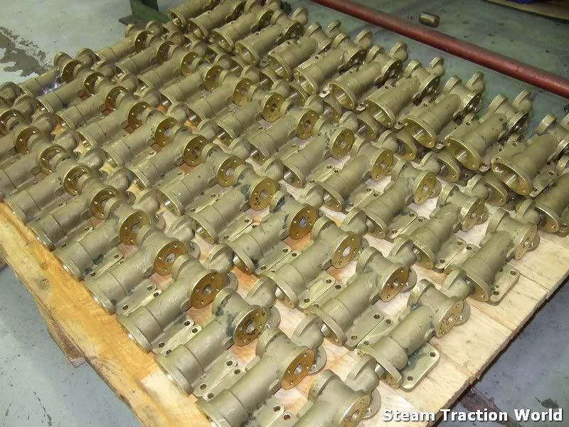

yeah, busy as usual. not much different from last week up till today, but... water pump castings arrived today so now we can knock this on the head. photos tomorrow when there's something worth seeing Cool
Number of posts : 1296
Re: next showmans/roadloco kit. water pump...
Post  craig@STW on Tue 03 Jul 2012, 10:16 pm
OK, some more photos. the pump castings...

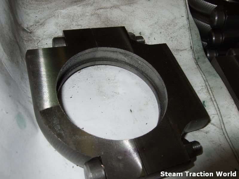

the eccentric straps with the groove cut in them...

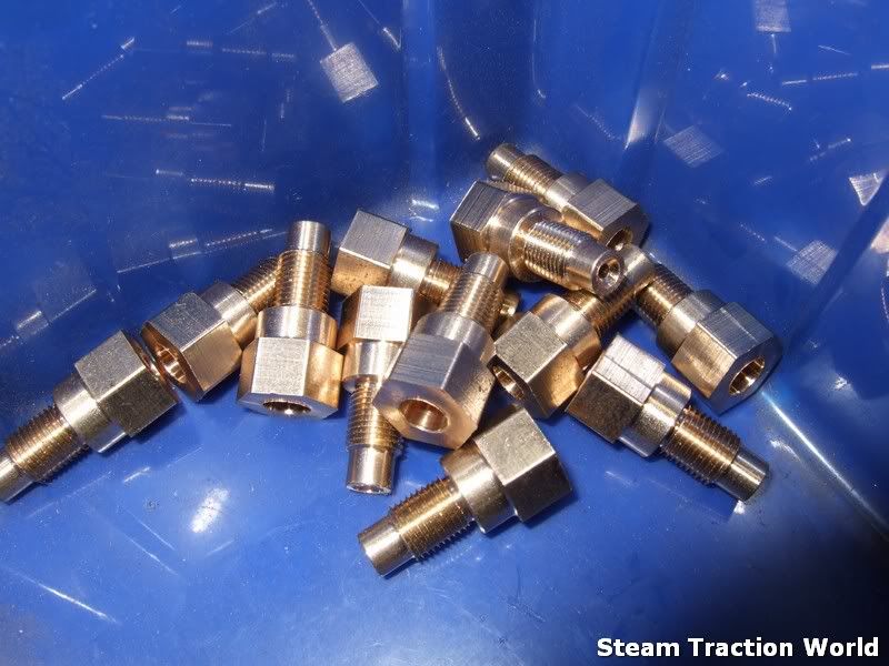

some fittings...

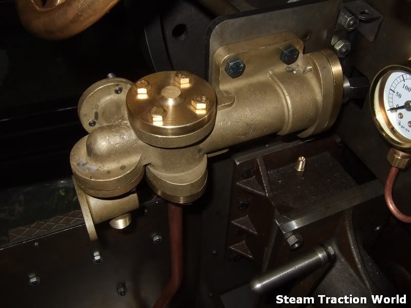

and the pump on the control model...
not very easy to get at !!!...

Ha Ha Will be for me, crank can still be taken out.... Very Happy tongue When's it leaving??

Suppose you can always take the bearing casting out of the hornplate with the crank if needs must.
Number of posts : 2957

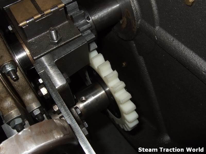

Post  Steam Traction World on Thu 05 Jul 2012, 9:14 am
The water pump and drive can be installed with the crank in place. It is a bit awkward particularly getting to the nut holding the connecting rod to the eccentric strap but as long as you've got a long extension to your 1/4" drive socket its okay. I'll cover the way we put our control model together in the instructions. Would it be easier with the crank out? Yes it would without a doubt, but I for one wouldn't bother.
Number of posts : 904
Post  highpressure on Thu 05 Jul 2012, 5:49 pm
I was only gloating because I have held on for what seems like forever to fit the pump easily Embarassed .... I know its possible to put it in with the crank in place, I just happen to be fortunate, but for those following a few kits behind it might be something to consider, after all it simply meant holding on to fix the third speed gear in place and I have still been able to run the engine anyway. As you know fitting and patience are not the best of friends here so I wanted to make my life a little simpler.
