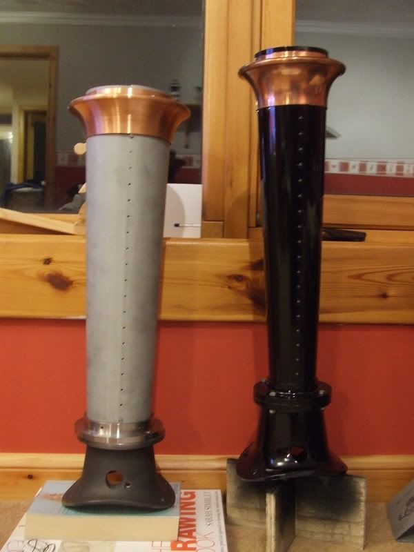

Post  tef 20 on Sun 01 Feb 2009, 10:55 pm
If Steve has done the same as me it will be the chimney from the second batch of 4" burrell which is wider, i ended up paying about 269 for mine but i think it is cheaper than that now. So if you have the second batch you will be ok i have included a picture of my 2 chimneys i think you will spot the diference.
Hope this helps
mark
