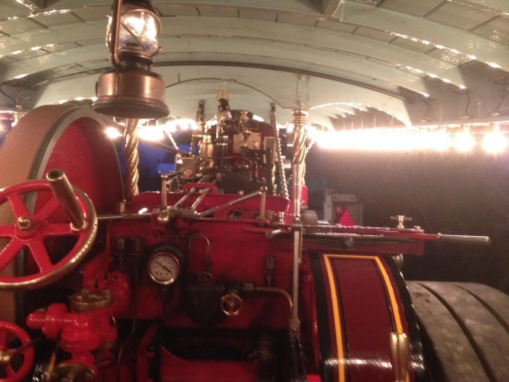

Post  Brian M on Thu 28 Nov 2013, 2:08 pm

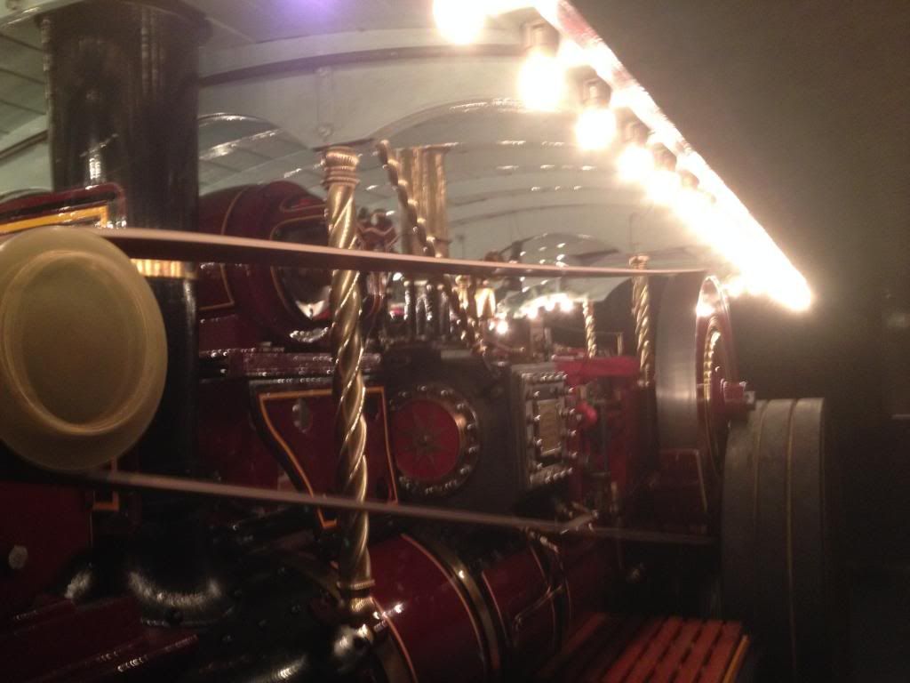

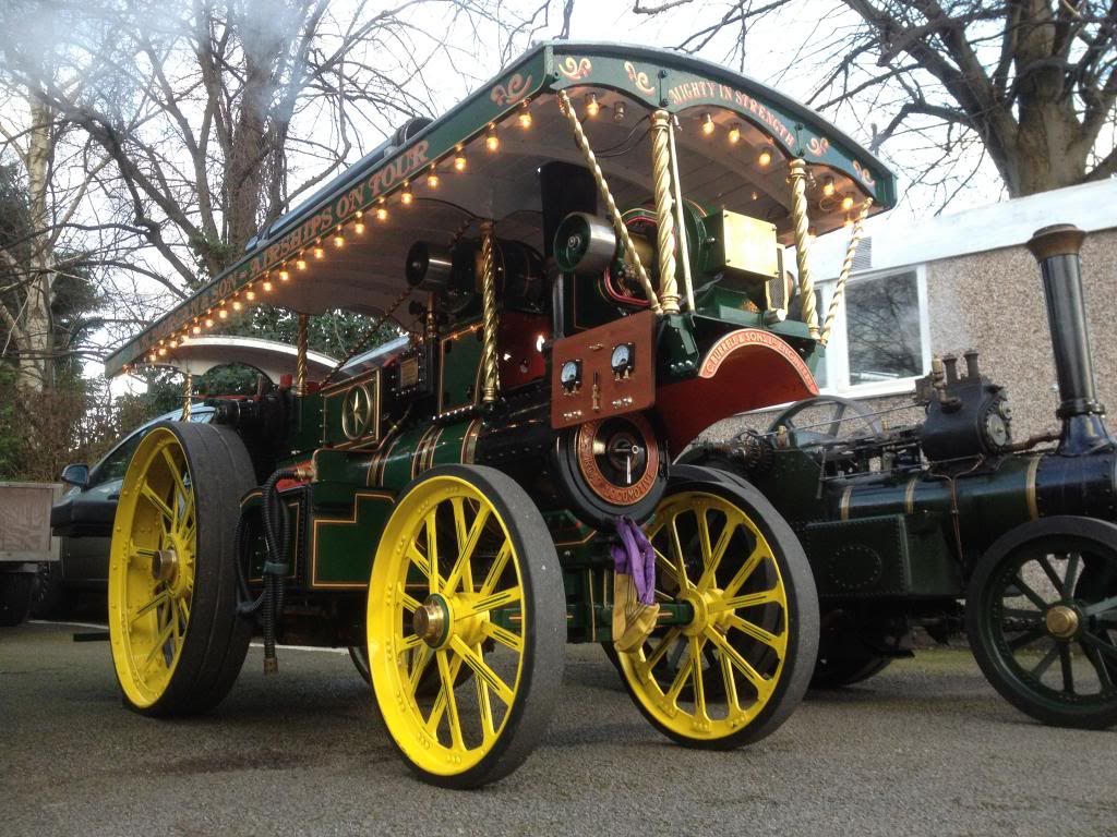

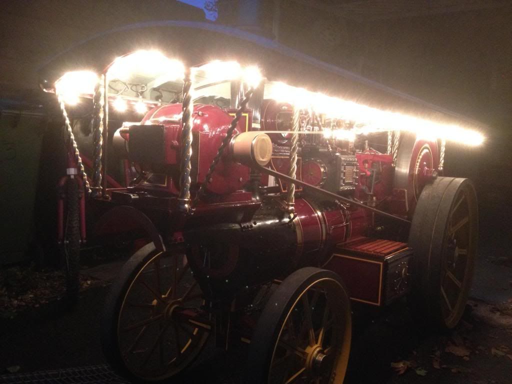

Just getting the engine ready for the last outing before Christmas and thought I would post a few pictures of it generating. We had several engines getting together at a local pub a fortnight ago, which was fun Smile. Hopefully, we will have a picture of both mine and Dwain's engine together over the next few weeks.

Those first two pictures are almost impossible to tell from full size with nothing to reference scale, excellent job!! Reminds me of the nights at Dorset this year. Warmer, Happier days......

Now that's a lovely sight to see, a Showmans at its best, fantastic!! Even them road loco guys can't fail to be impressed!!
Where on earth did you get those dinky little Tilly lamps hanging from the roof?

Post  Brian M on Thu 28 Nov 2013, 5:42 pm
Hi Tony,
They are converted to use LEDs from a pencil sharpener. They only cost 20 each and look the part Smile
I have one spare (if you want one), so PM me your address and I will send you one over, as it will look good on your engine.

Engine looking very good indeed, could be fullsize if you didnt know

Post  Robfishman on Thu 28 Nov 2013, 9:37 pm
Looks fantastic, I bet you are very pleased with the result. Like the lamp as well, where did you find it?

Hi Rob,
They were made by a chap in the local club I am in. I can ask him if he has any more (or planning on making any, they are about 20 each). Let me know if you want any and I will put him in touch with you.

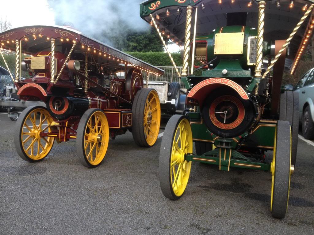

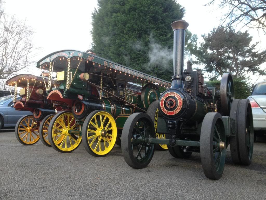

Pics from today's play of three of the engines, we had a good day and the weather held off until the end. Initially, a small issue with a few bulbs not playing on one of the showman engines (put problem quickly resolved Smile).
A special thanks has to go to the pub for looking after us all.
