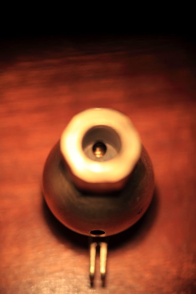

Post  craig@STW on Tue 03 Apr 2012, 5:36 pm
just a quick word before you start on the new kit...
it would seem that the whistle body has been sent out with a hole missing. Embarassed but don't panic, we do have the holes in stock. Wink
we could send the holes out for you to fit yourselves but to be honest its a bit fiddly so probably best to return the bodies to us to sort out. Rolling Eyes
this will only apply to any kits sent out in the first dispatch on Monday. the rest will already have been sorted.
sorry about this folks Neutral
if anyone does want to try fixing this themselves I'll get some details on hole size etc. Cool

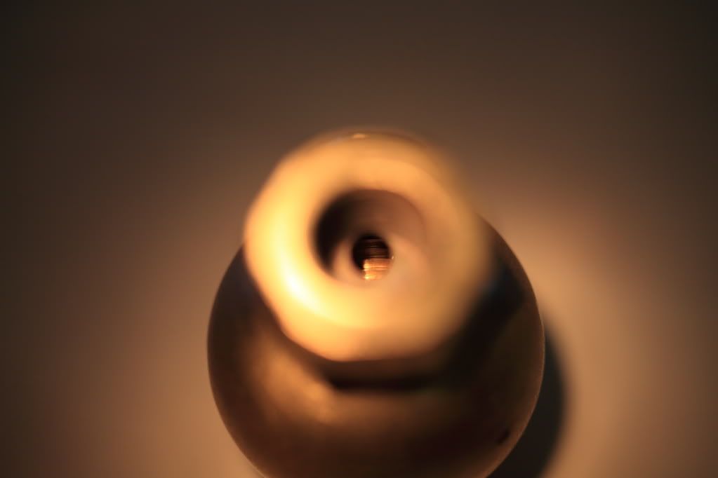

Post  lynnr on Tue 03 Apr 2012, 6:22 pm
Found the location for the missing hole. Screwed in fitting in the valve housing. Looks like a simple drill trough from the bottom.
Whats the postage on the missing part?
The missing hole

Post  sonick45 on Tue 03 Apr 2012, 7:18 pm
you need to practice your macro photography.........
That looks like a right skreeeecher at full pressure...

It was a quick macro shot Twisted Evil using hand held and a 40w bulb.
