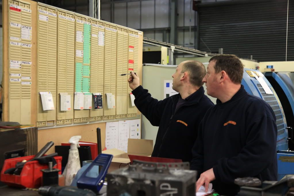

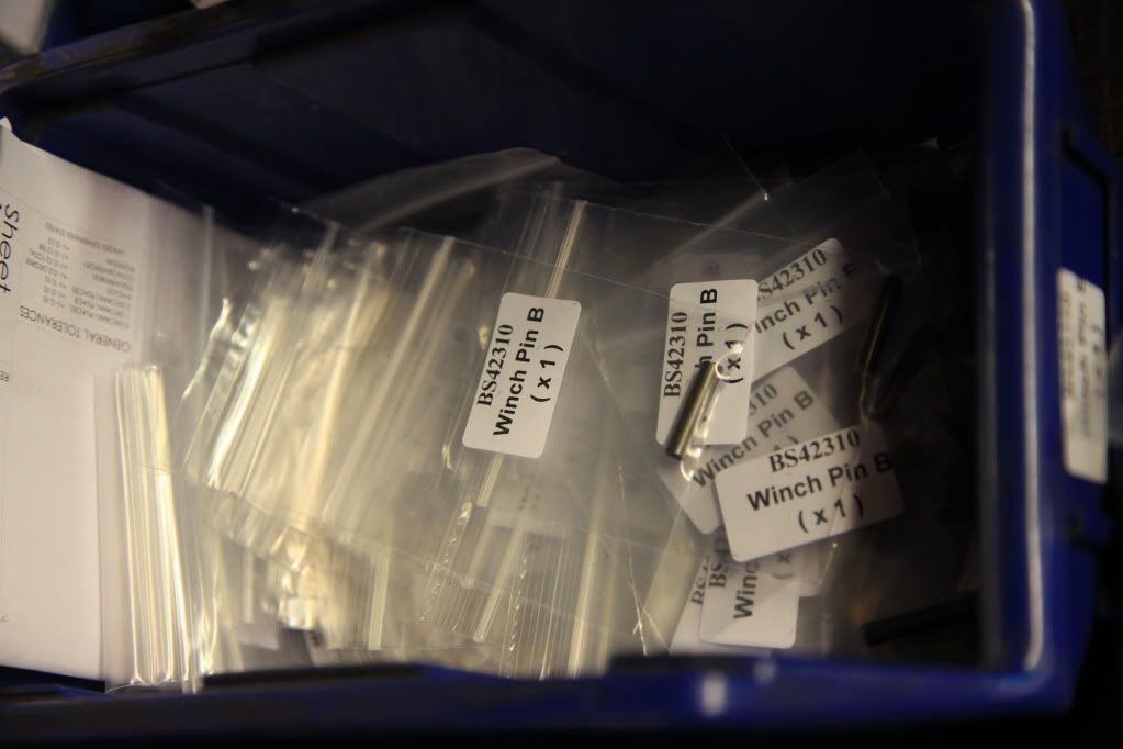

Production "T" card system. Makes sure all the machines and workers are kept busy and a good track is kept on activities.
Job done included. Bending the lugs on the winch drum safety catch for the drive pin and bending the laser cut for the latching handle for the same part. I also cut and cleaned up all the locking and limiting pins for the winch drum assembly. Takes a while to cut and clean 55 little pins 3mm x 30mm approx for one pin and 5mm for the second. This small activity took a couple of hours to complete and that is for just 2 little pins. While I was proceeding with these simple but essential tasks Ian was shaping the springs for the winch drive pin and silver soldering the flanges on the starting steam valve. Once items started coming from the CNC machines Ian also checked these items on the control model to make sure all is good.

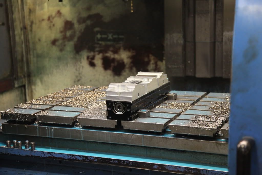

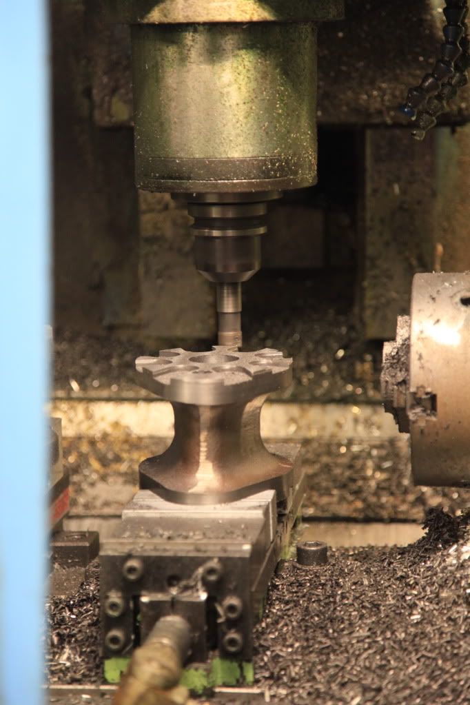

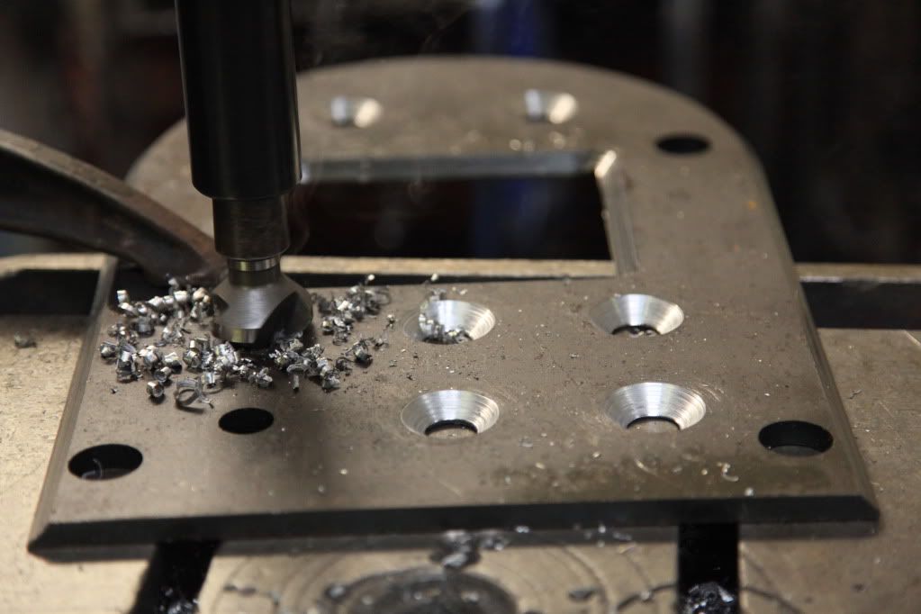

Today was spent with Craig, David and Mark in CNCland. Craig demonstrated how the CNC was programmed and them set the program up for the valve insert for the starting valve.
Getting the drill bit ready to cut the flutes on the start valve.

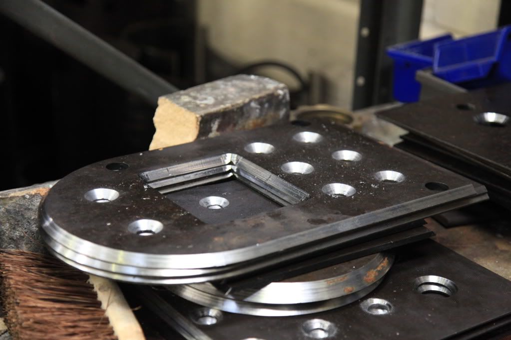

One part of a spring hanger cut and flanged ready for welding.
Yes the machines also need cleaned out once in a while.
Cutting the hole for the steam supply to the starting valve.

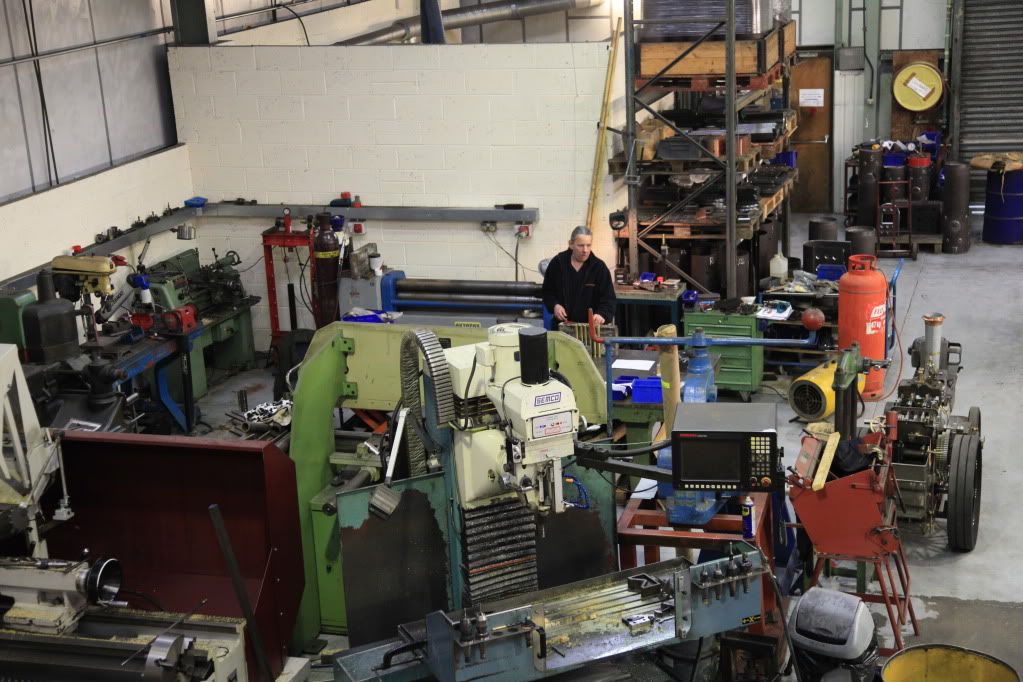

Ian working away in the manual area

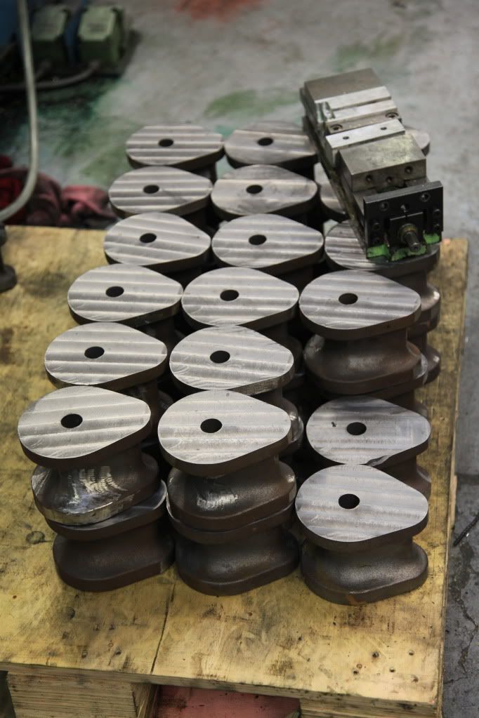

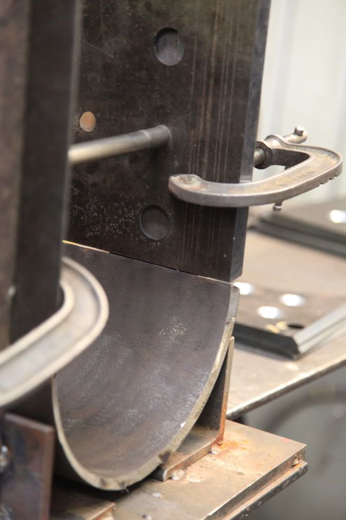

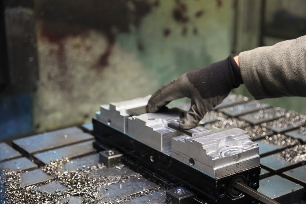

4" burrell hub casting getting ready for CNCing.
Each hub takes about 1 hour to machine. There is 40 of them to do.
Once the CNC is finished the hubs need hole tapping. This is faster using a manual machine.

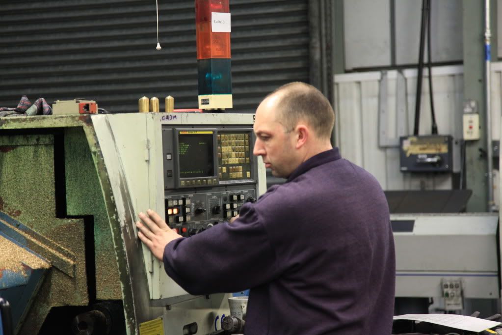

Mark setting the CNC lathe for profiling the steam lifter venturie tube.

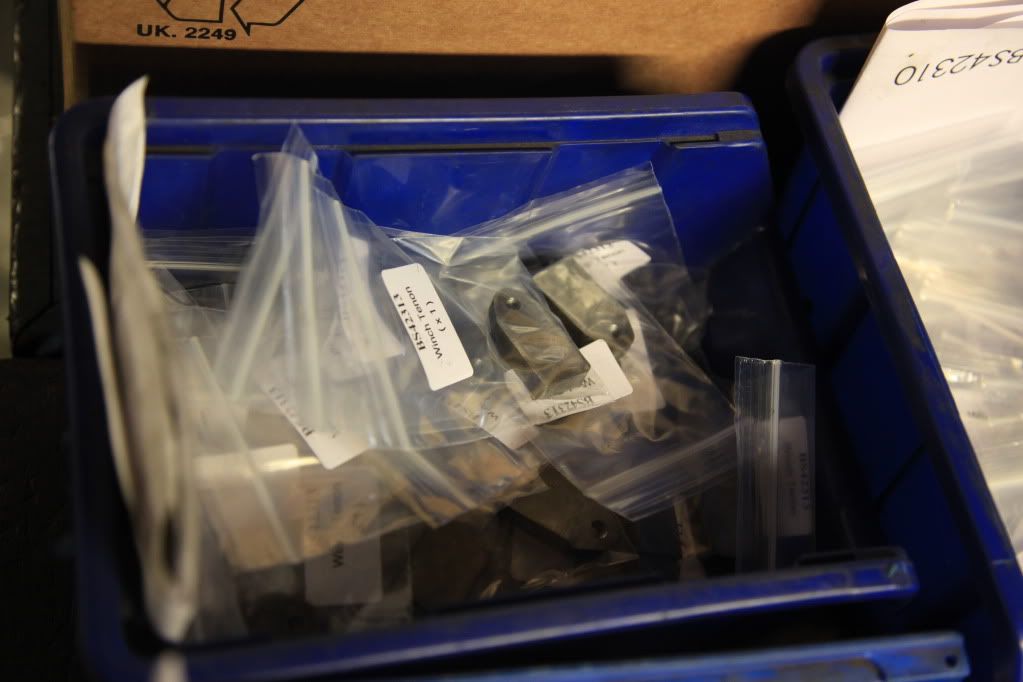

Had a look in the packing area while tending my CNC machine.

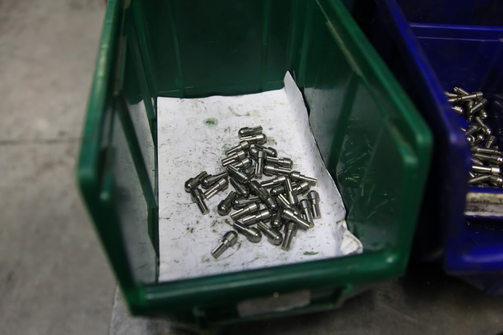

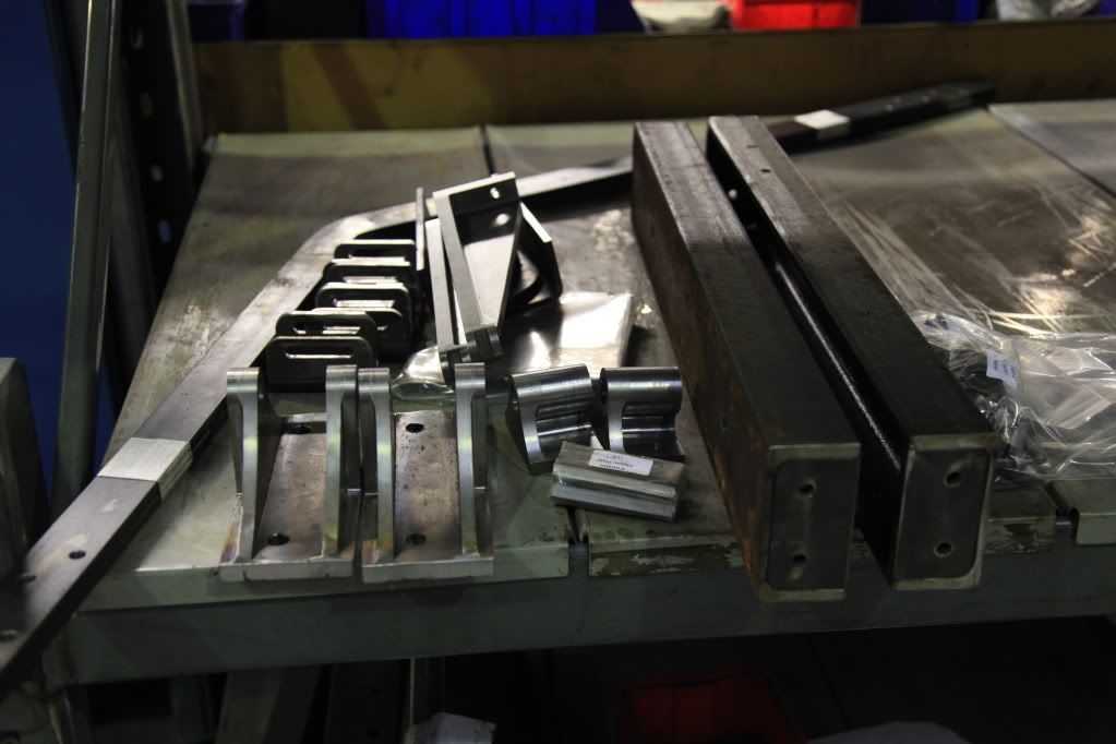

These are the items I was bending and cutting yesterday.

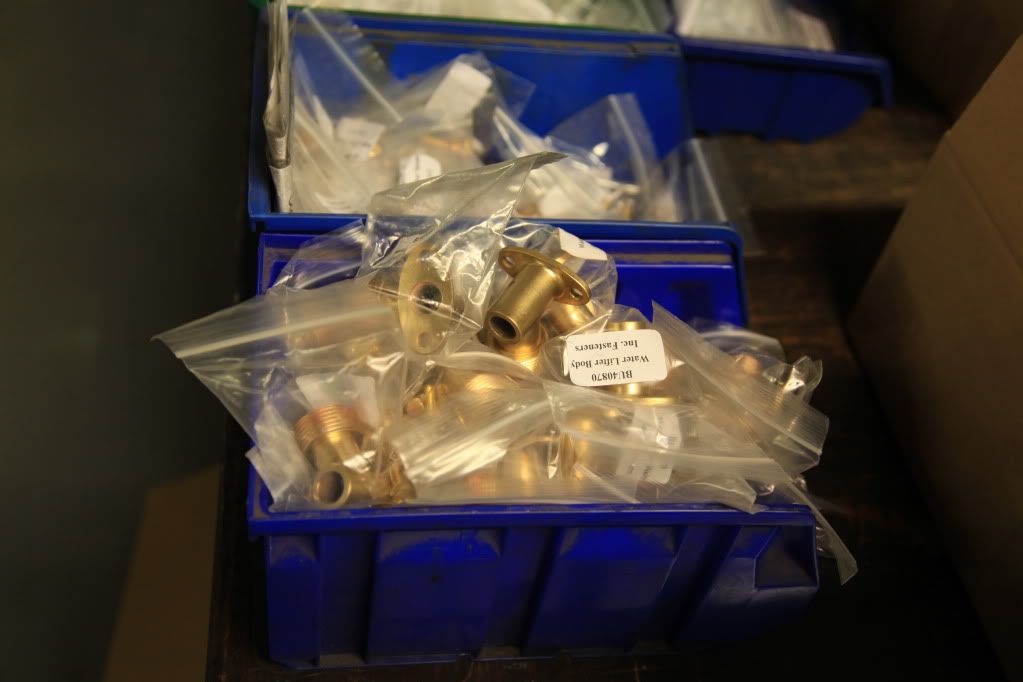

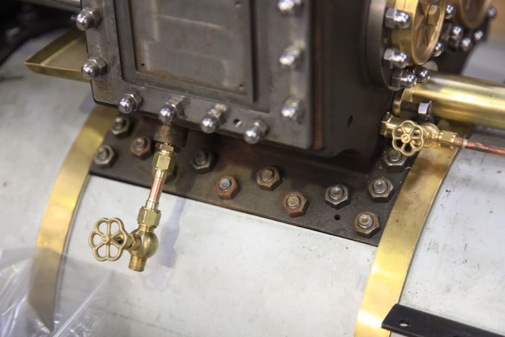

Steam valve inside I have been spending the last 5 hours producing.
lots more to do.
It may be a small part but it does take a long time to produce.

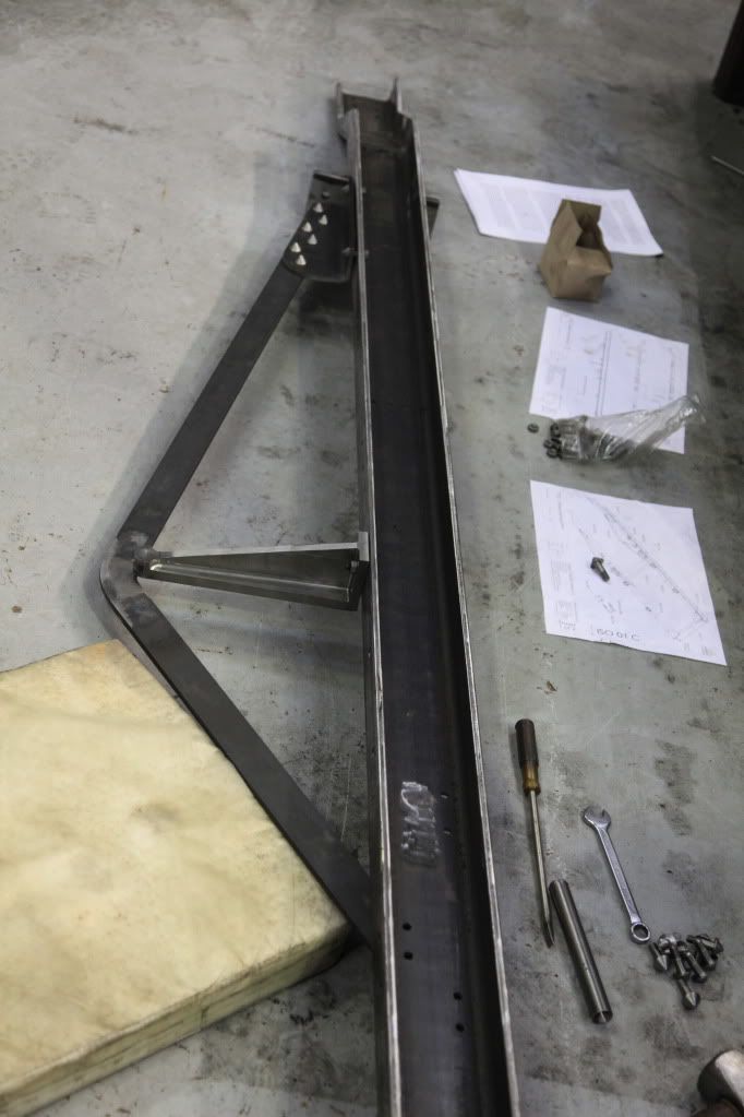

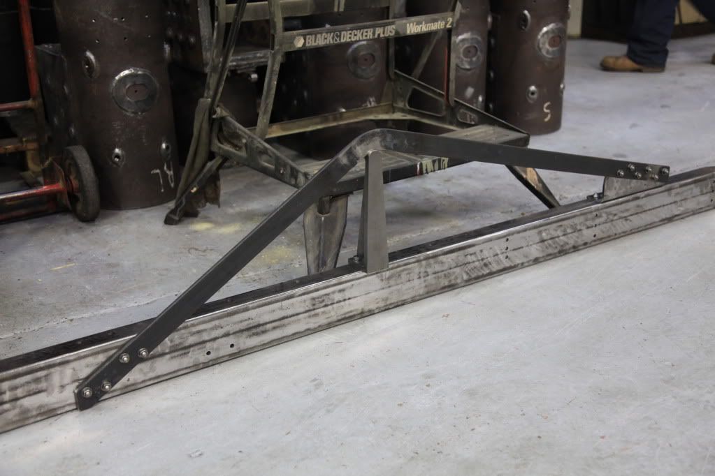

Building a Foden 6" LWB kit 1 was todays task. This kit is HEAVY so be very carefull if you have not started it. First task was to clean the rather industrial mess called the main rails. This took 3 hours or there abouts. I then spent a while at the belt sander smoothing down the end of the conical rivits. I must get one of these bench belt sanders, so so usefull and convenient. Now to start heavy engineering. Well not quite yet. I always spend at least 30 minutes reading and studying the drawings before starting. With each rail upside down I started to install the parts as per the instructions. This progressed well. All holes and fittings were very precise and no fettling being required.
Once parts were being attached onto the rails I now required assistance moving the rails.
parts checked in to my building area.
needed help with lifting these parts

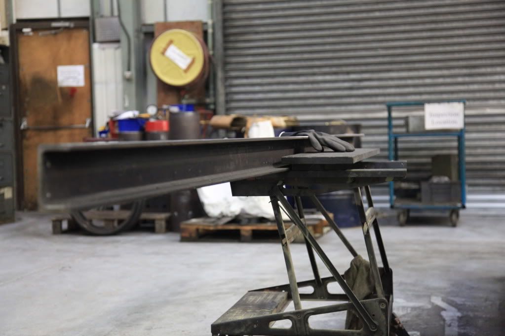

Chassis rail being cleaned with a flap wheel.

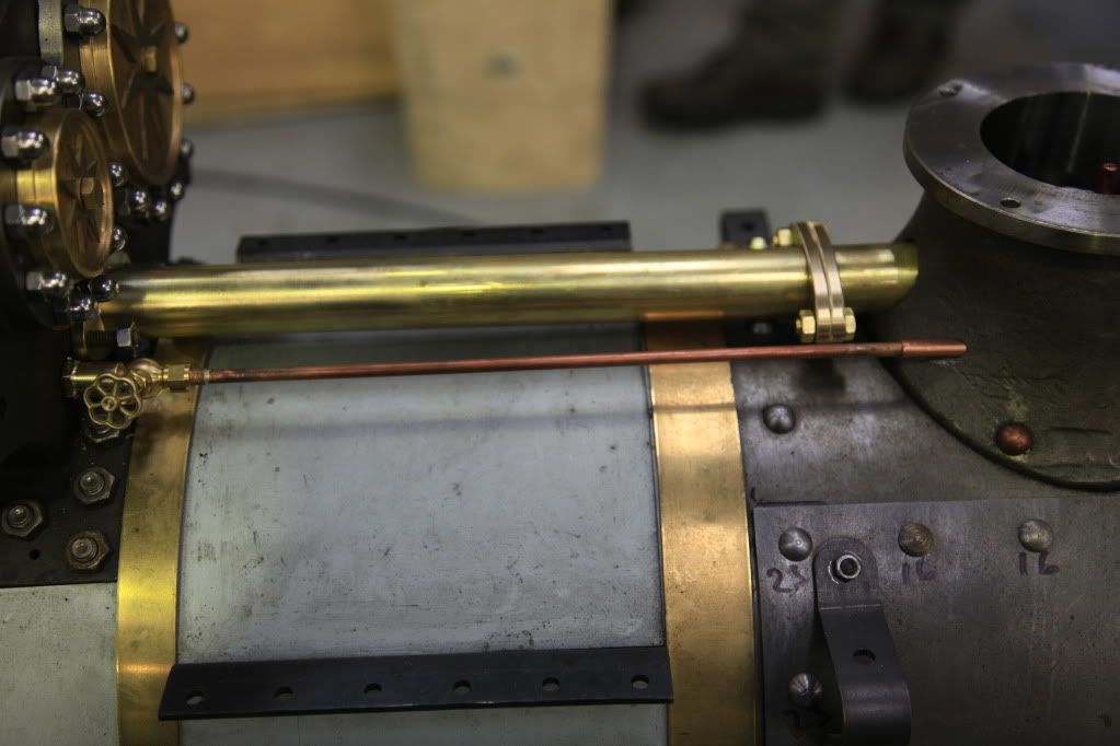

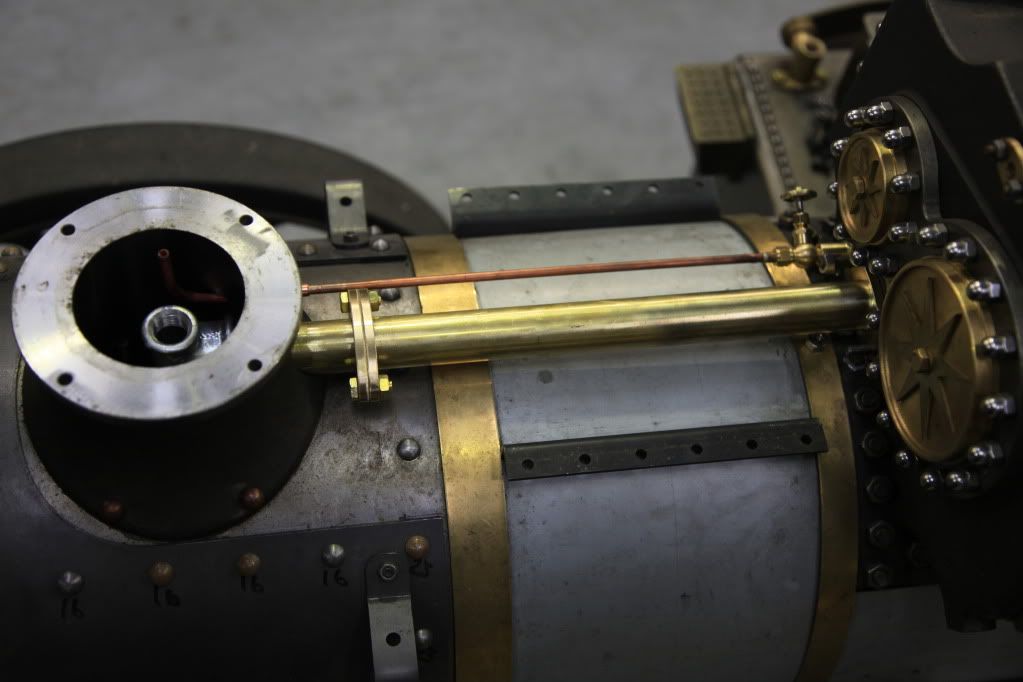

New parts on the control model. Hot out of production

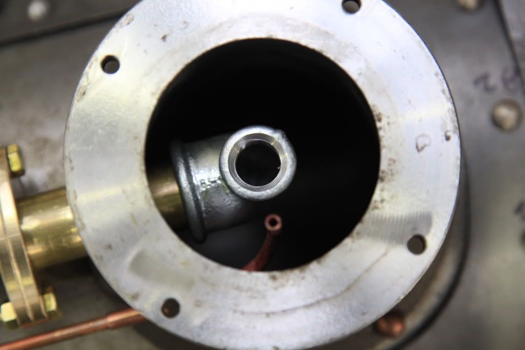

Do not worry you will not have to take the chimney saddle off or split the smokebox from the boiler to fit the blast pipe. Insert the part into the chimney then attach the longer part from the Block. No problem.
What does that valve do?

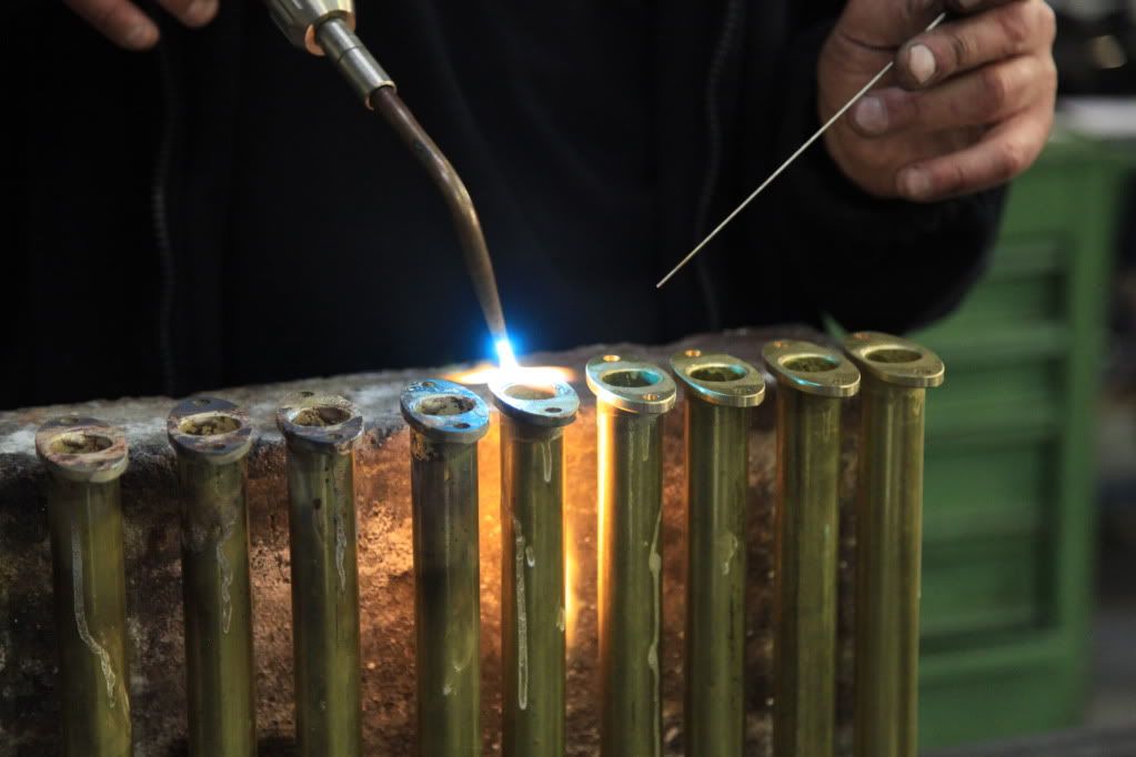

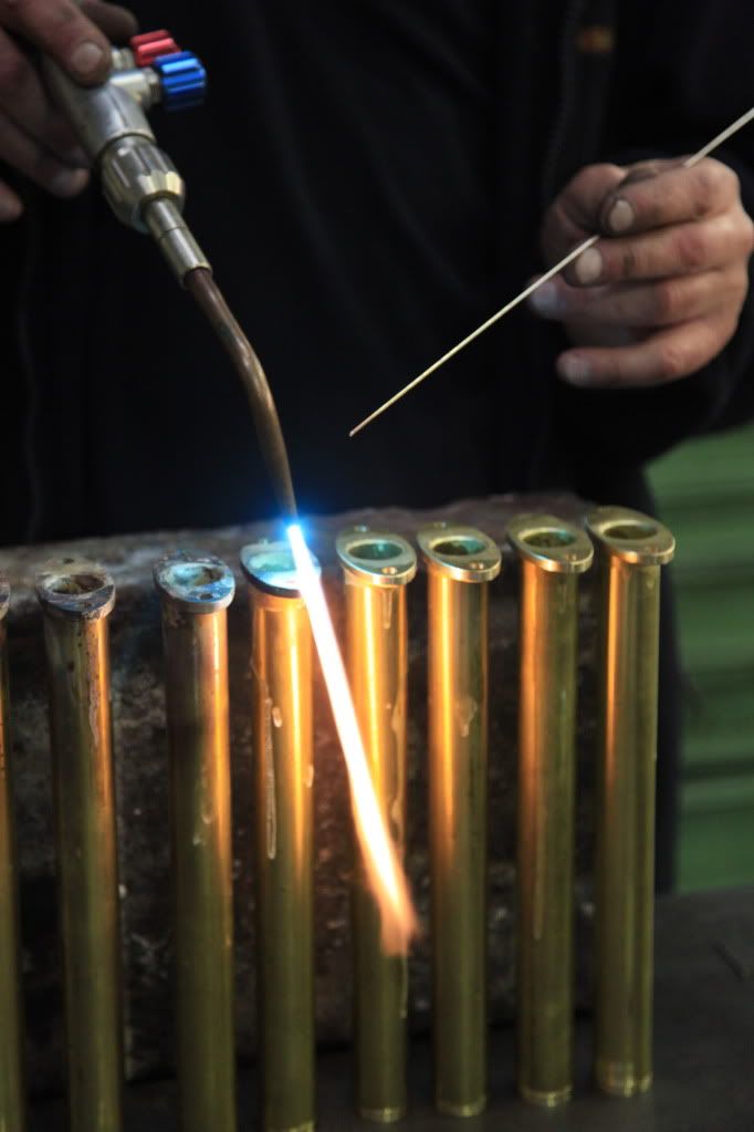

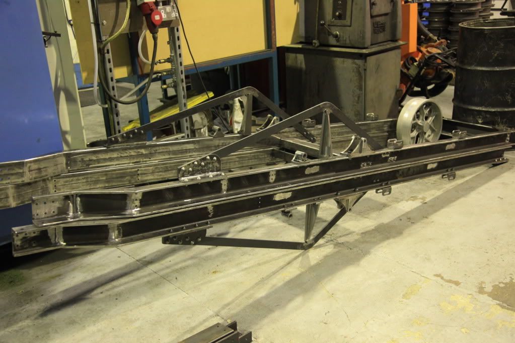

STW have got me on my knees with this task. Need to have a stand up. So snapped Ian producing the blast pipes.
A very skilled activity as the stick is quite a high melting point and you do not want to cook out the tin from the brass.
The chassis kit 1 now complete.

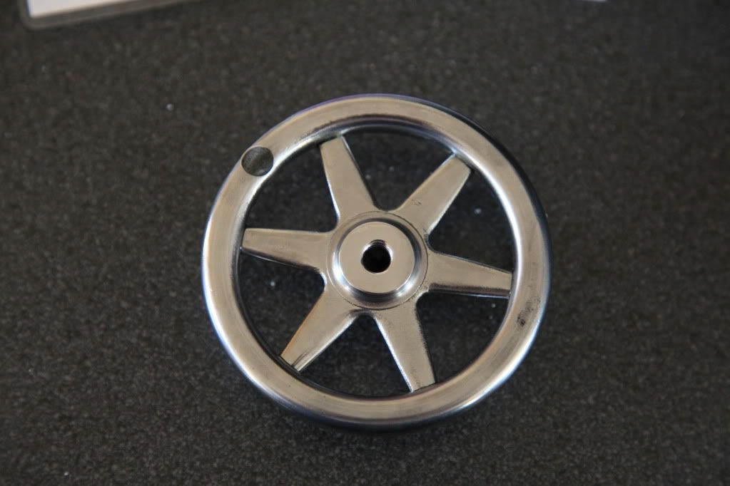

Some of today was spent shaping and polishing a brake handle ready to be sent off for lost wax casting in bronze.
Need to get it nice and smooth for the casting.

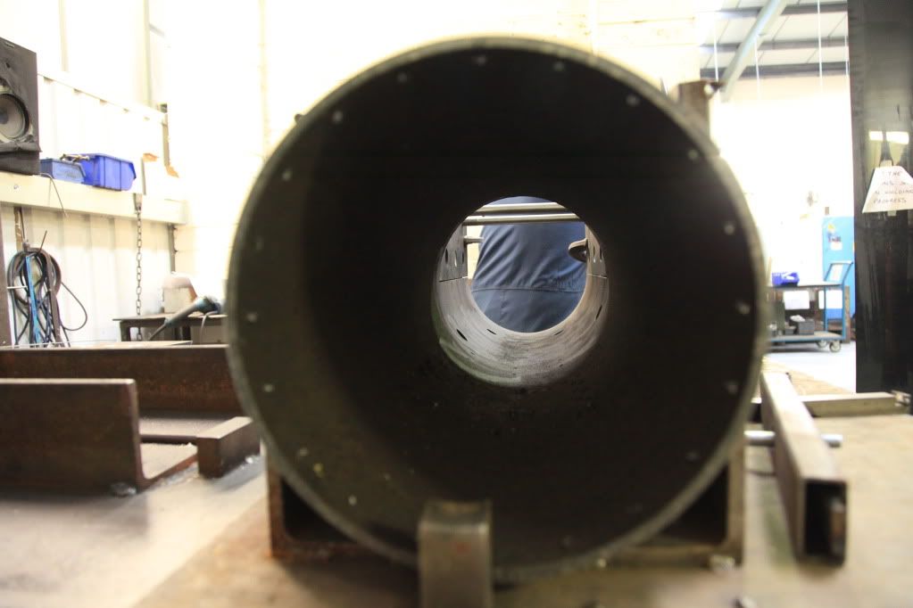

popped into the boiler shop today since the welder was not going. Got a few pictures of a 4" Road loco boiler on the jig and weld prepping plates.
Is it a boiler barrel or supergun

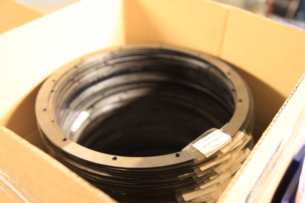

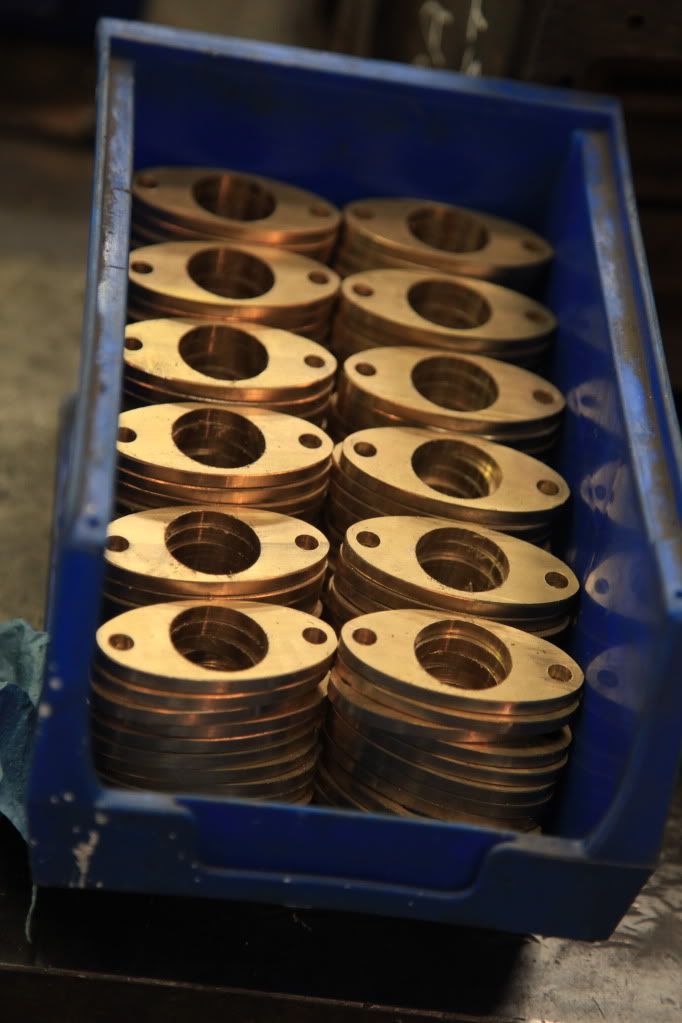

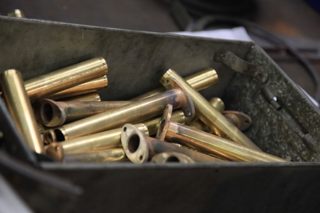

Ian been busy again making the blast tubes.
Plenty more flanges to go.

Well Thursday afternoon was spent shaping and polishing the brake wheel as shown in the pictures above. Then helping Steve with some housekeeping in the factory in the early evening.

Good to see the cyclinder connected to the chimney via the blastpipe and blowwer pipe plus the water lifter parts coming together.
