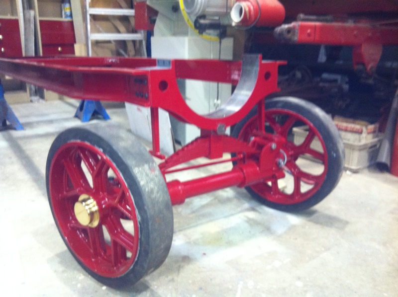

Post  Adam Brown on Sun 06 Jan 2013, 9:08 pm
Well a fairly productive Christmas break has led us to the completion of the front end (ish) Next stop back axle!
