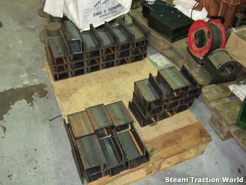

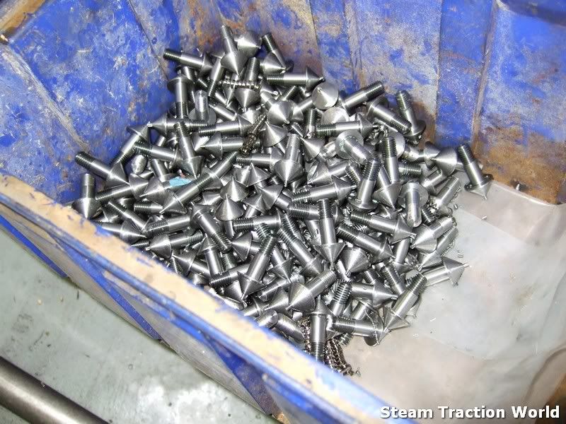

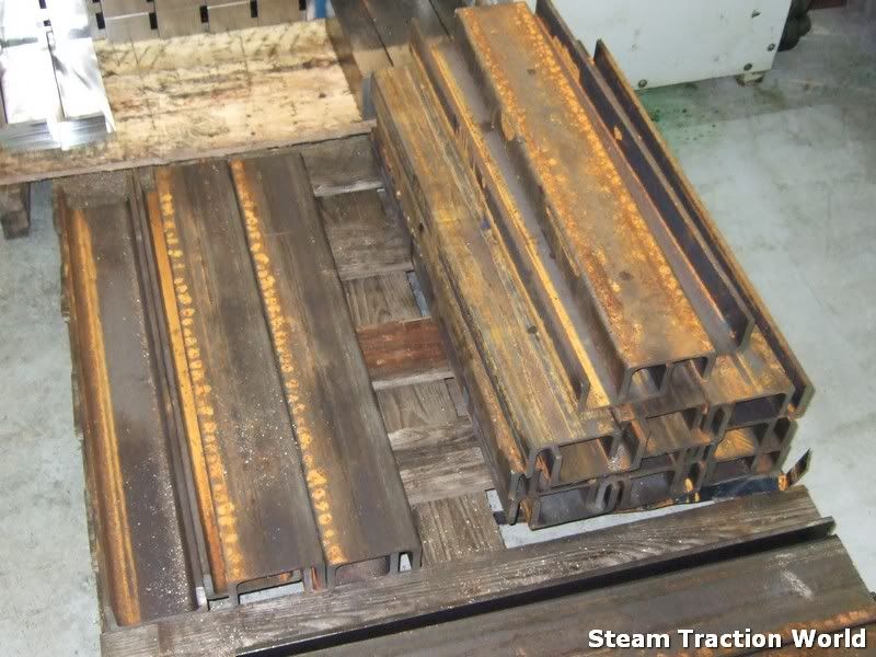

we have started work on this kit now. we have some rivet bolts on one of the lathes and i have just started on some of the channel sections.
we are still waiting for delivery of the third attempt to cut the main channel sections (due tomorrow).

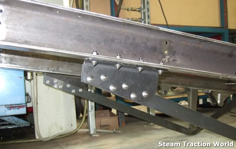

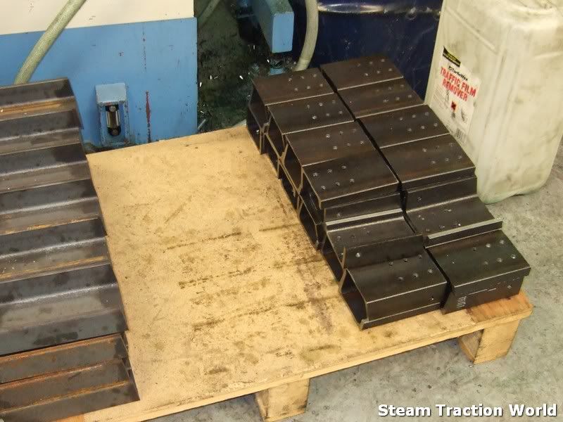

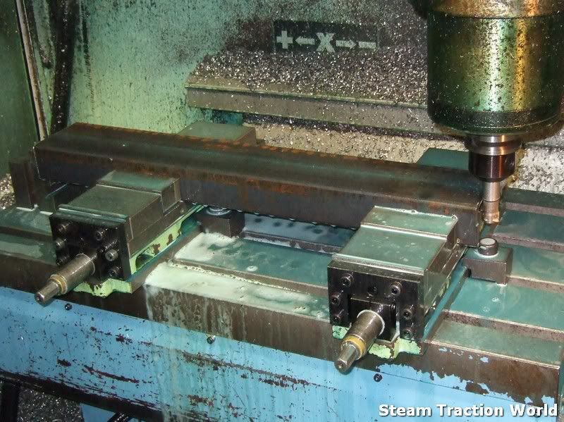

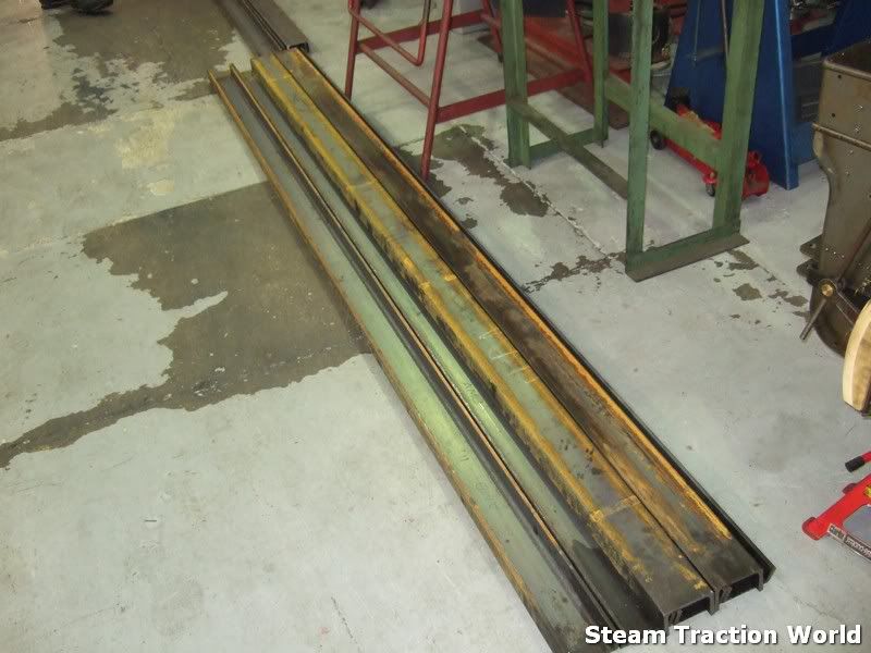

work is coming on well now.

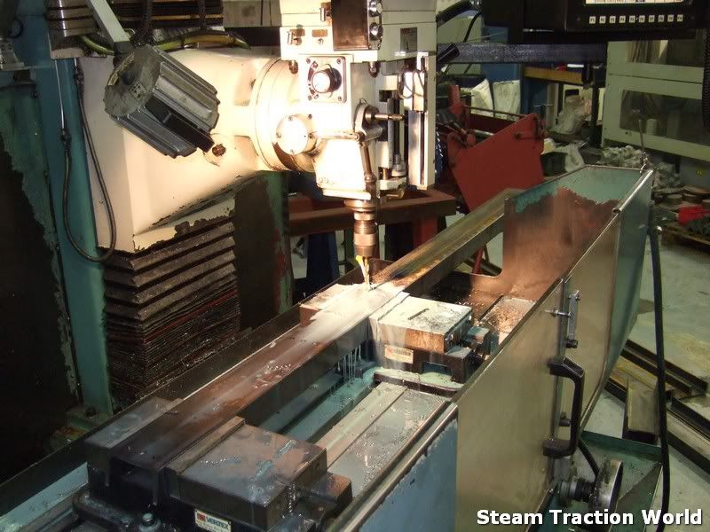

the main chassis sections have been started, although steve is having to do them on his "open" machine as they wont fit in our CNC's...
cross members are on the machines...
and the mounting plates for the ends are done...
still lots of brackets to do...

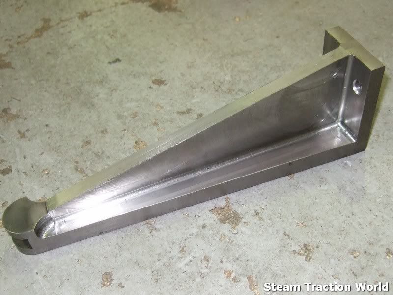

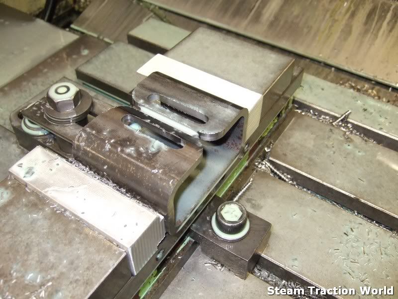

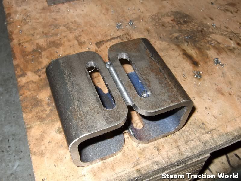

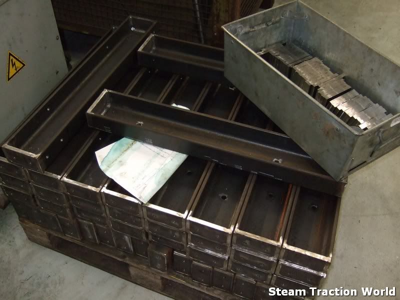

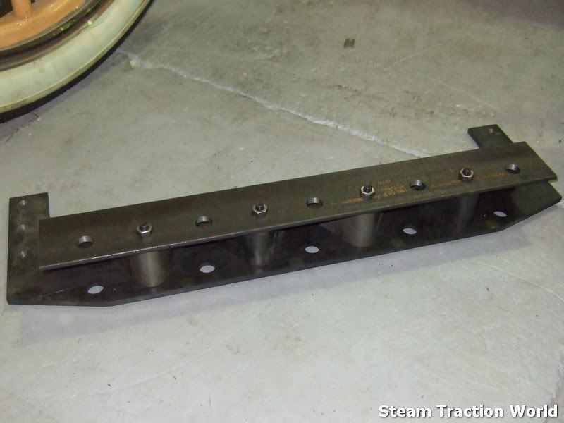

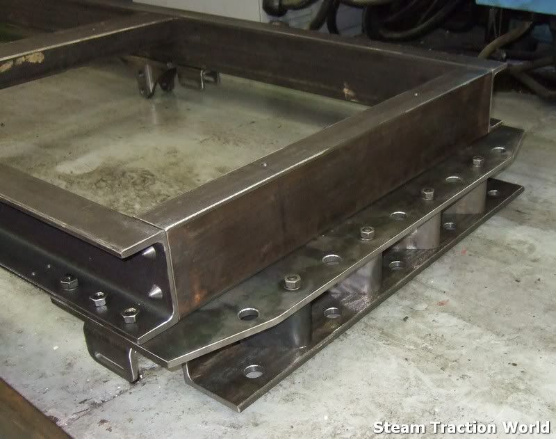

more progress...
cross members are ready...
two brackets from one piece of steel...

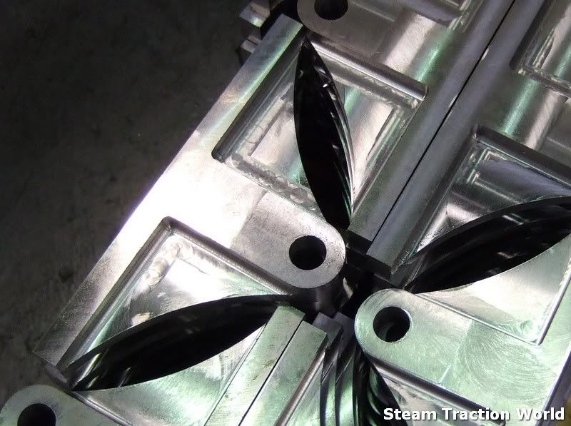

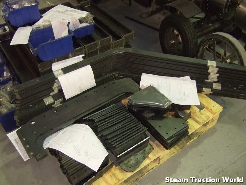

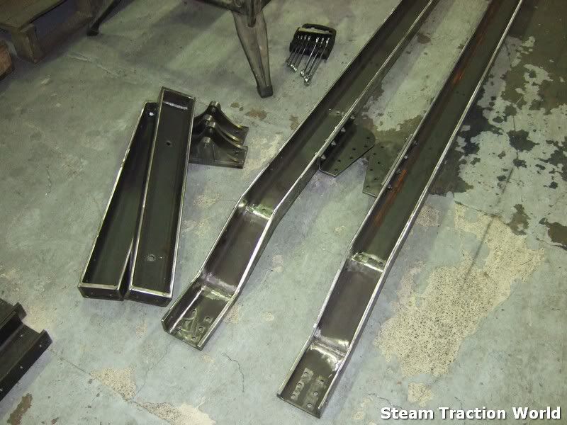

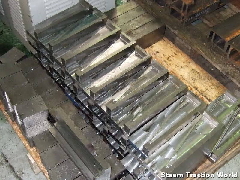

OK, the long awaited photos...

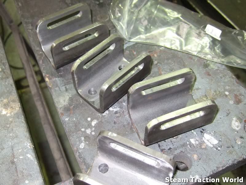

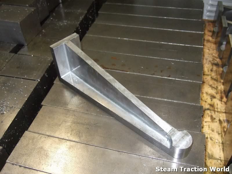

we have done a lot of work on this over the last week. remember that a lot of these parts are cut from solid steel, and the size of the chassis channels means they have to be machined in sections due to the limit of travel on the machine. i hope you will all be happy with our efforts...

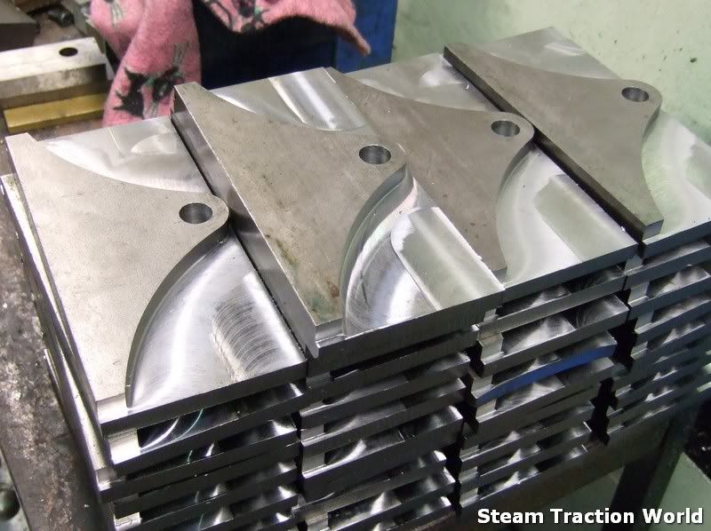

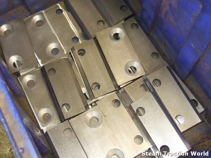

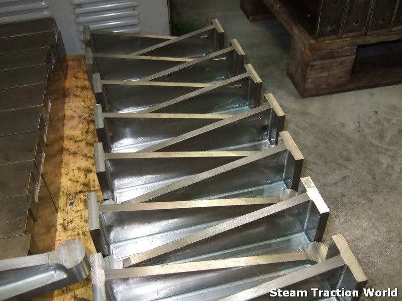

OK, first off, remember those brackets above (two brackets from one box section). these are the spring guides and are now done...

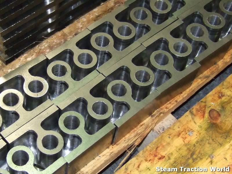

these slipper plates will sit inside the spring guides...

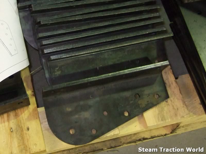

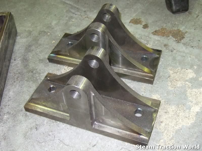

radius rod brackets are a fabricated part, from this...
to this...
and then finally this...

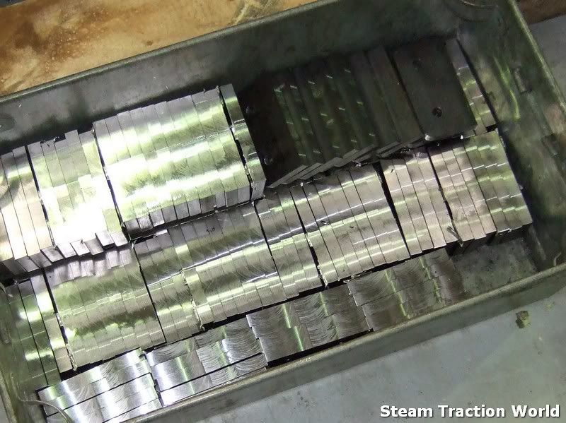

these are the brake shaft brackets/bearings...
to this...

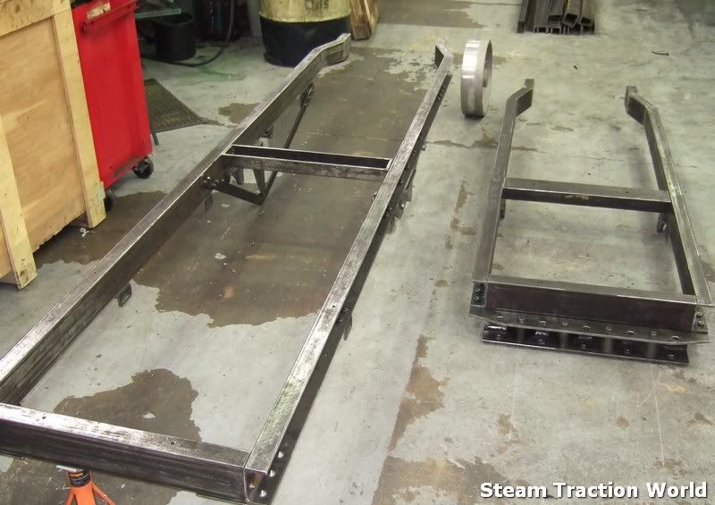

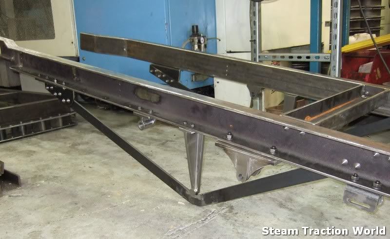

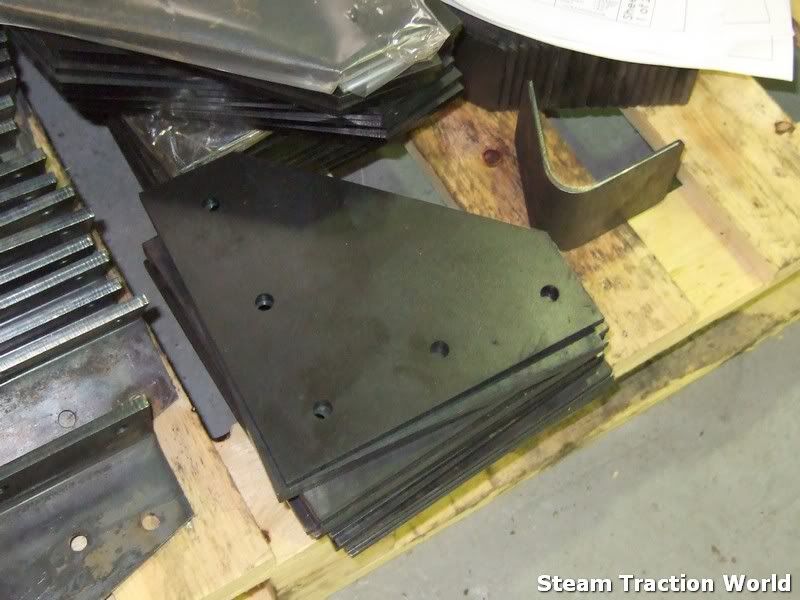

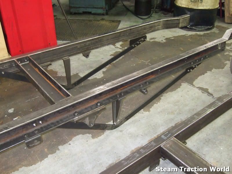

on here we have a few laser cut parts, the long truss at the back is a C-type part...
mounted on these brackets...
these are the corner gussets...
and the SWB will have this tow bar arrangement...

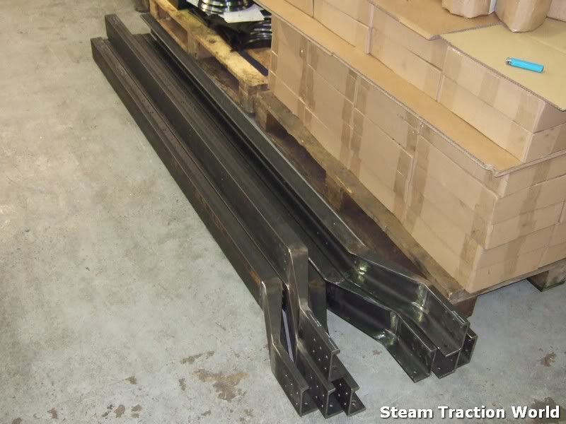

these are finished SWB chassis rails...
and the C-type rails from our control model...

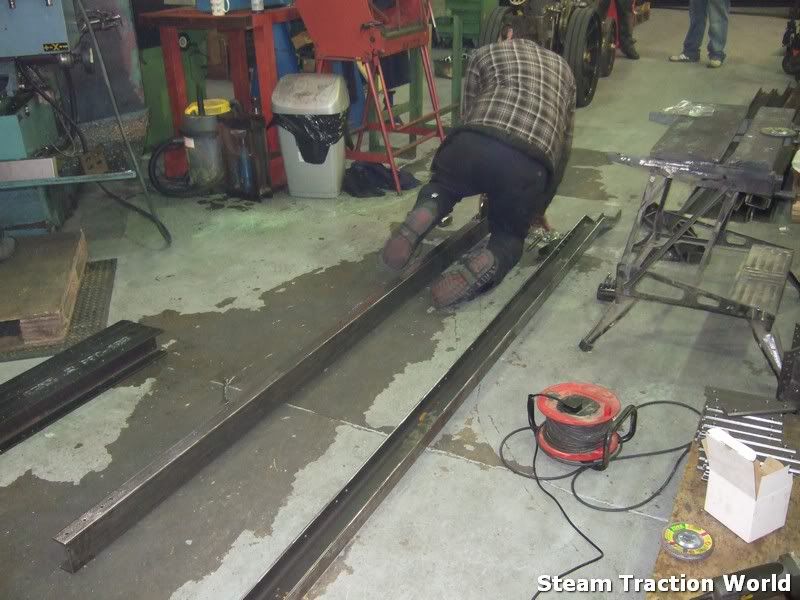

not a very flattering photo, but here you can see Steve working on the control model. at this point he's just finished cleaning up the parts and is laying them out on the floor...

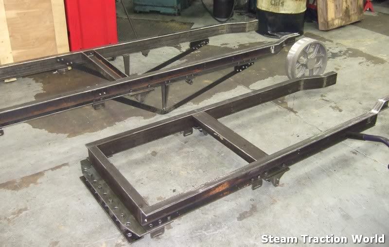

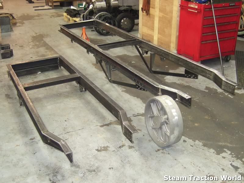

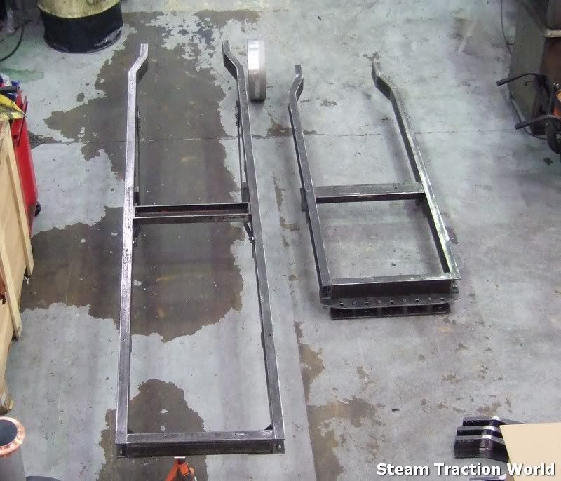

OK, photos of the finished (as in kit-1 being finished) control "models". To sort of quote a famous film featuring a big rubber shark...
I think your gonna need a bigger shed !!!!!![]()
