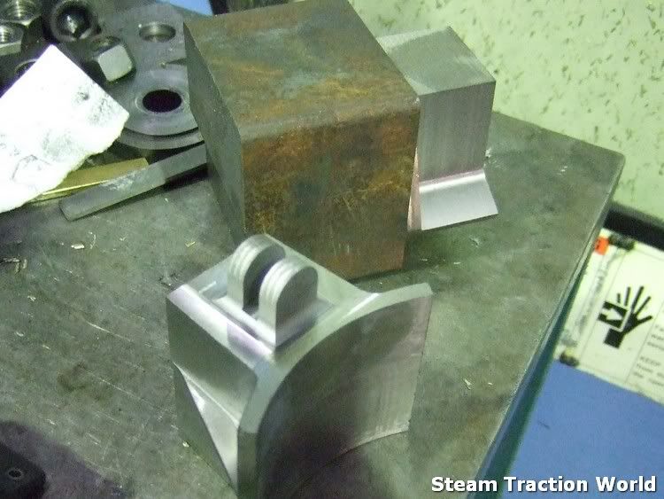

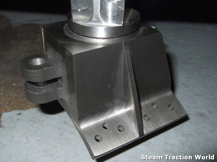

kits 1 and 2 were quite simple and the only thing we needed to improve on was the perch bracket. we didn't have enough of the cast ones that we were happy with so we made some out of solid !!!

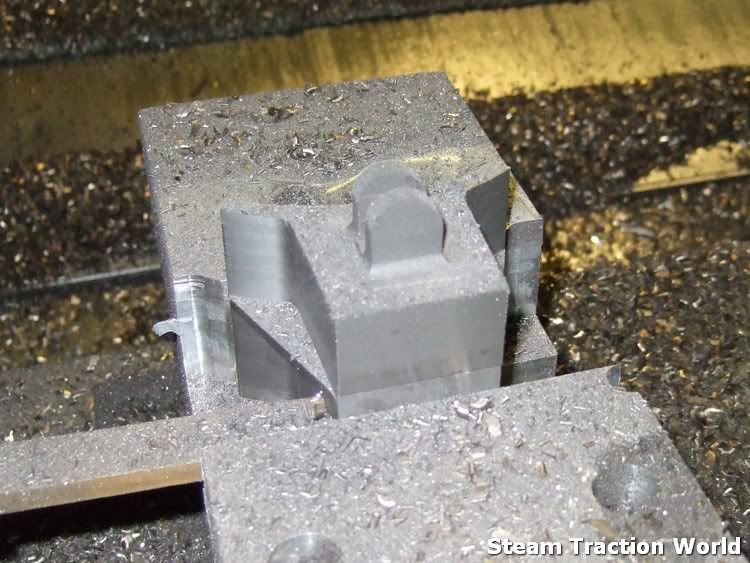

here you can see the first and second ops making the general shape from the solid block...

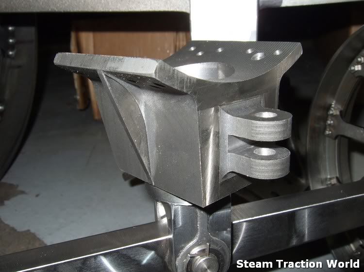

from this point on we just ran it through all the ops that the casting would get...

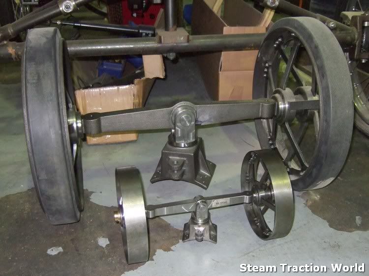

and here we have kits 1 and 2 in front of the 4inch model...
