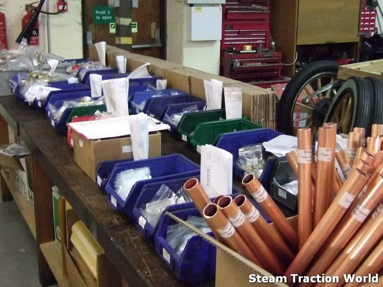

I've got a few basic photos of the "water fittings" kit that we sent out to fill the gap. most of this stuff is standard 4 inch parts and not very interesting to see in production...

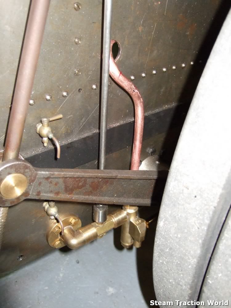

Post  lynnr on Fri 23 Dec 2011, 8:21 am
Just noticed on the picture with the clack valve. There appears to be an extra brass fitting between the valve and the boiler?
Is this an error on the control model or an omission from our kit list?
Number of posts : 3022
Spacer!
Post  Tony King on Fri 23 Dec 2011, 8:40 am
I think you'll find the control model had the cut outs in the boiler "mirror imaged", when sent for lazor cutting, along with a couple that went out to customers, so to overcome the this, STW have obviously put an adaptor plate in to correct to difference in angle, so a standard check valve can be used!!

yes, that is correct regarding the clack valves. if anyone finds their "angles" are incorrect we have the adaptor plates ready and waiting.
